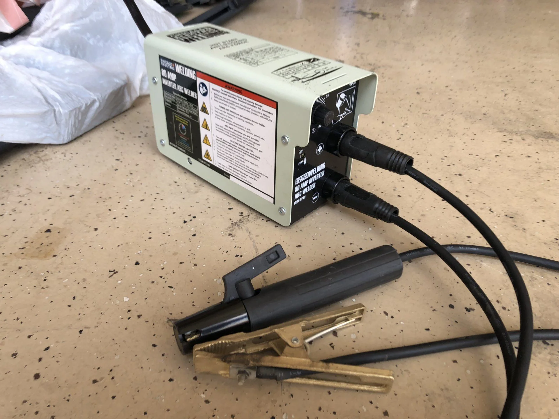

First things first, I got a fresh grinder wheel, cutting wheels for the angle grinder, and a wire brush cup for the angle grinder. I also bought this BADA$$ little 120v arc/stick welder from harbor freight that is an amazing little machine. It was something like $130 with coupons, and cafe with both leads. I already had a good and gloves and such, and a box of sticks is about $5. REALLY came in handy.

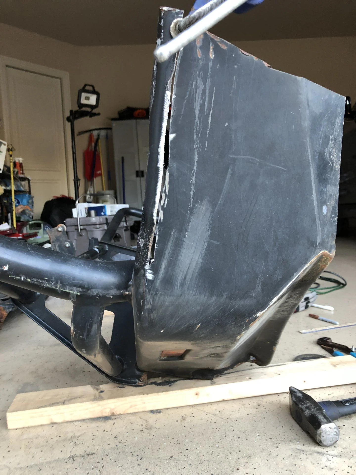

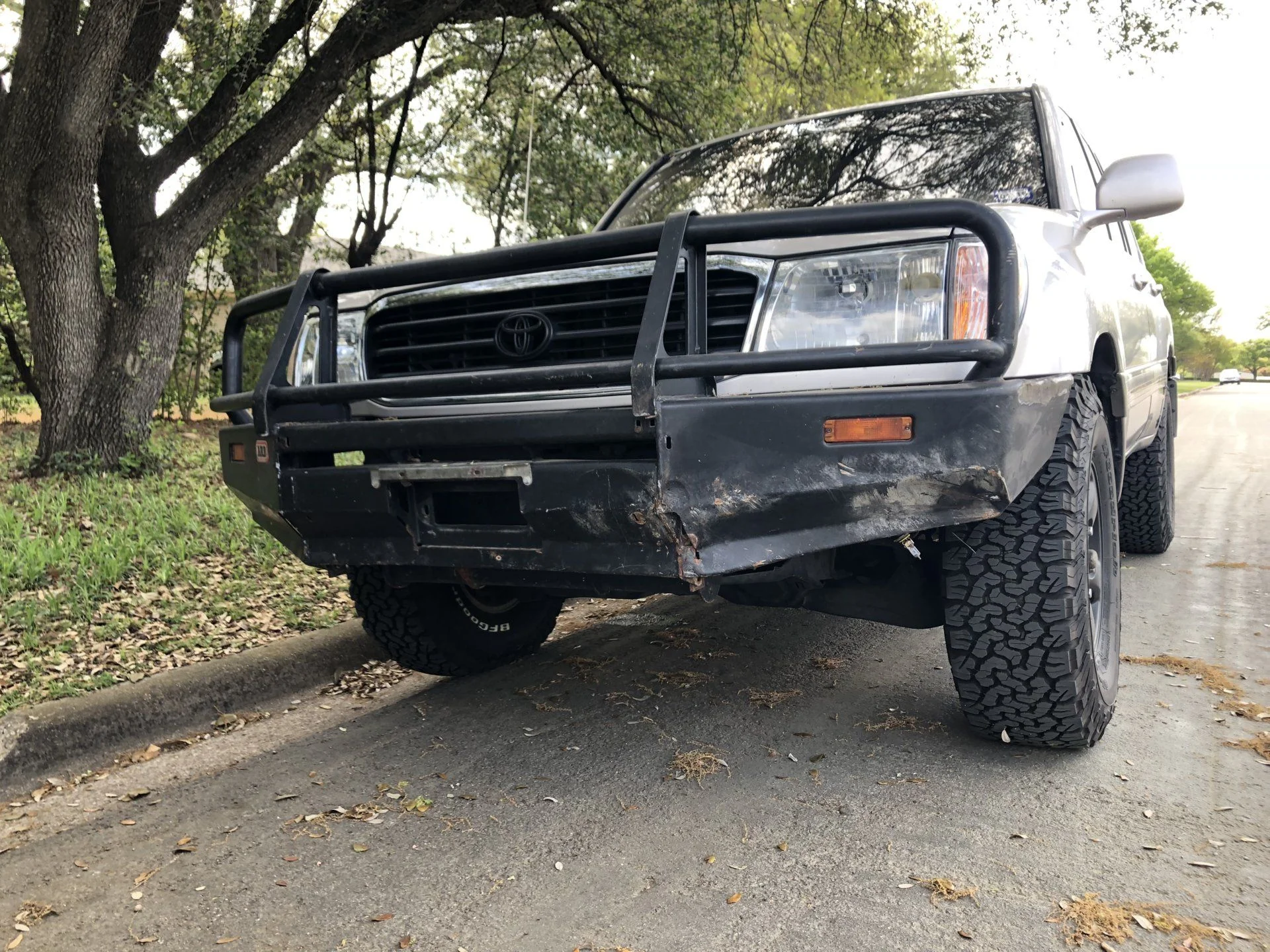

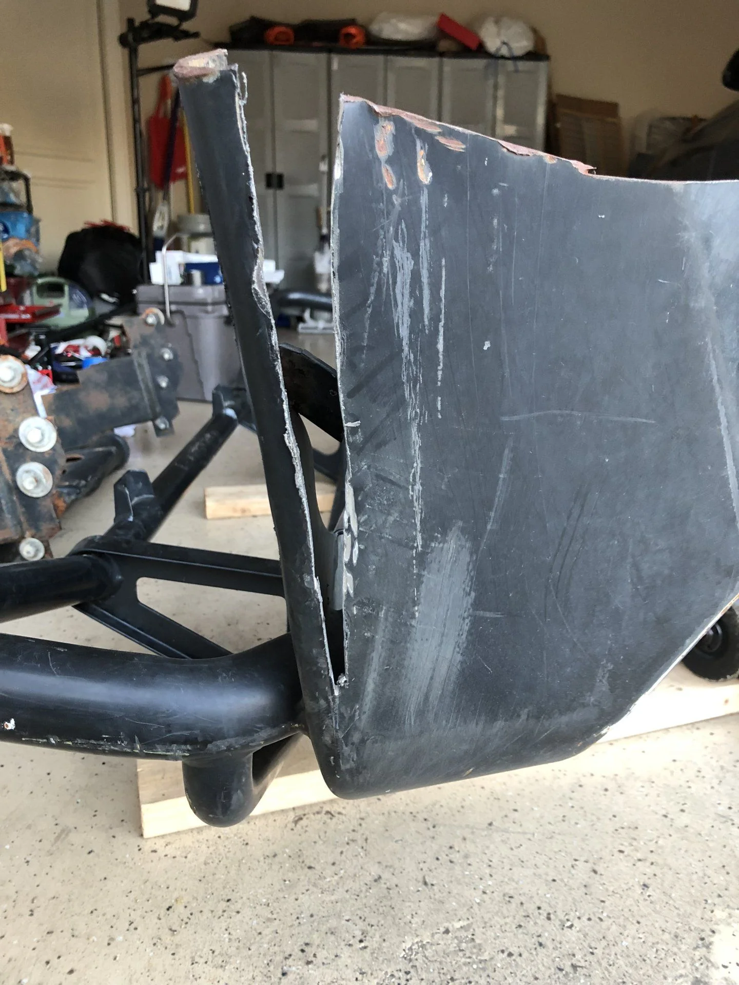

The entire drivers side of the bumper was twisted up and back toward the vehicle. The PO cut the last 3-4” off the end of the bumper to get home then just took it off. To the eye it’s just not all that far off, but it couldn’t be mounted with the top plate bent up towards the fender. Rather than twist the entire thing back, which I believe would be really hard to home brew, I came up with a simpler solution.

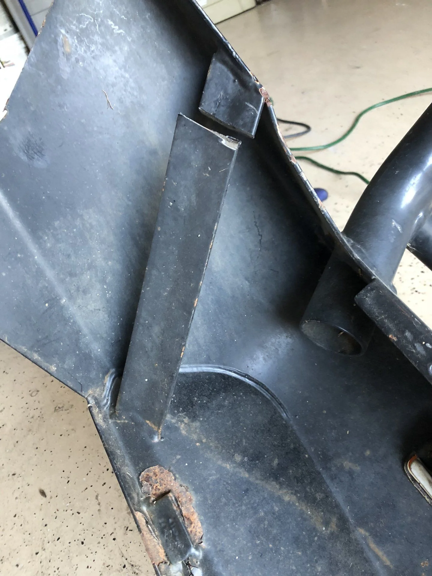

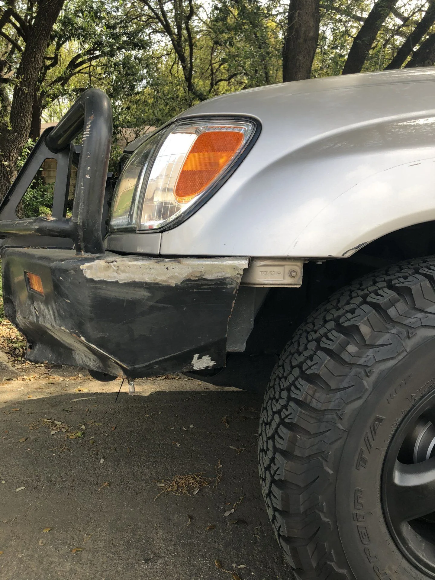

I cut a tapered wedge from the top line of the bumper, which I then bent downward to take that upward angle away. This is hard to describe but the pics are below.
I then welded this seam and smoothed it out with a grinder. This little 120 volt welder is really impressive. It only runs up to 80 volts so really couldn’t handle any thick metals like drill pipe of heavy schedule pipe. But for this sheet metal, it runs 80 volts with a 3/32 rod really smoothly. It’s better than any of those Lincoln tombstone welders I’ve used, of course those are 240v and can run well over 200 amps. I’m not a very good welder but after some touch up you can see this thing cleaned up pretty good. It’s also literally smaller than a shoebox, just plug it in your normal GFCI outlet and you have up to 80 amps at your disposal. TBC....
I also banged the holes on the front a bit, and I have plenty of dents to bang out and seems to weld, but I think this is a good start.

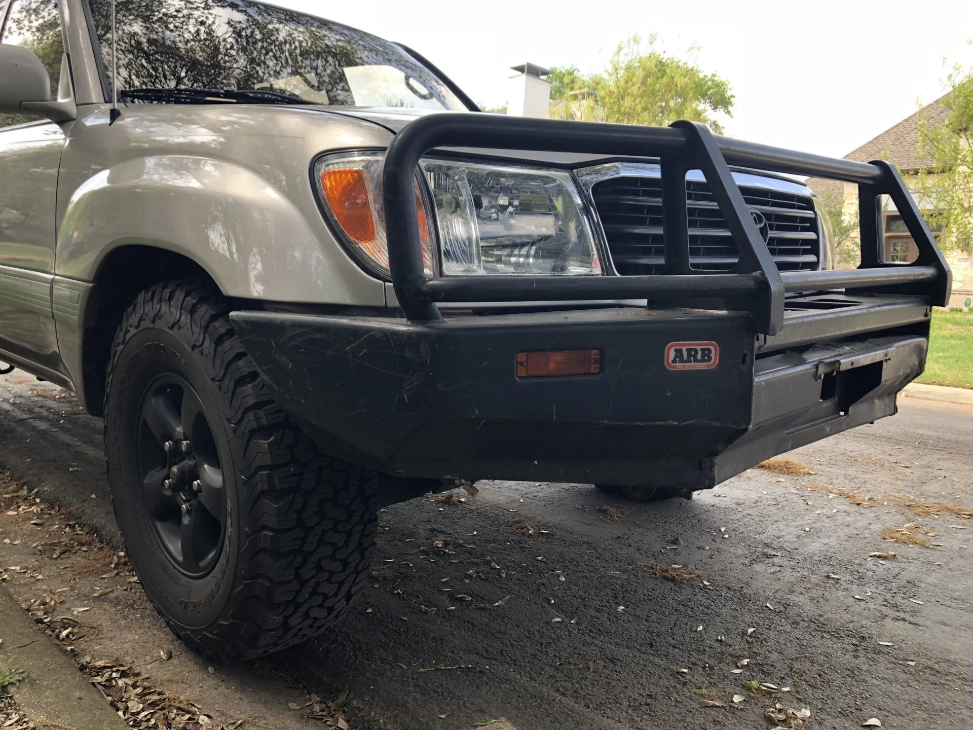

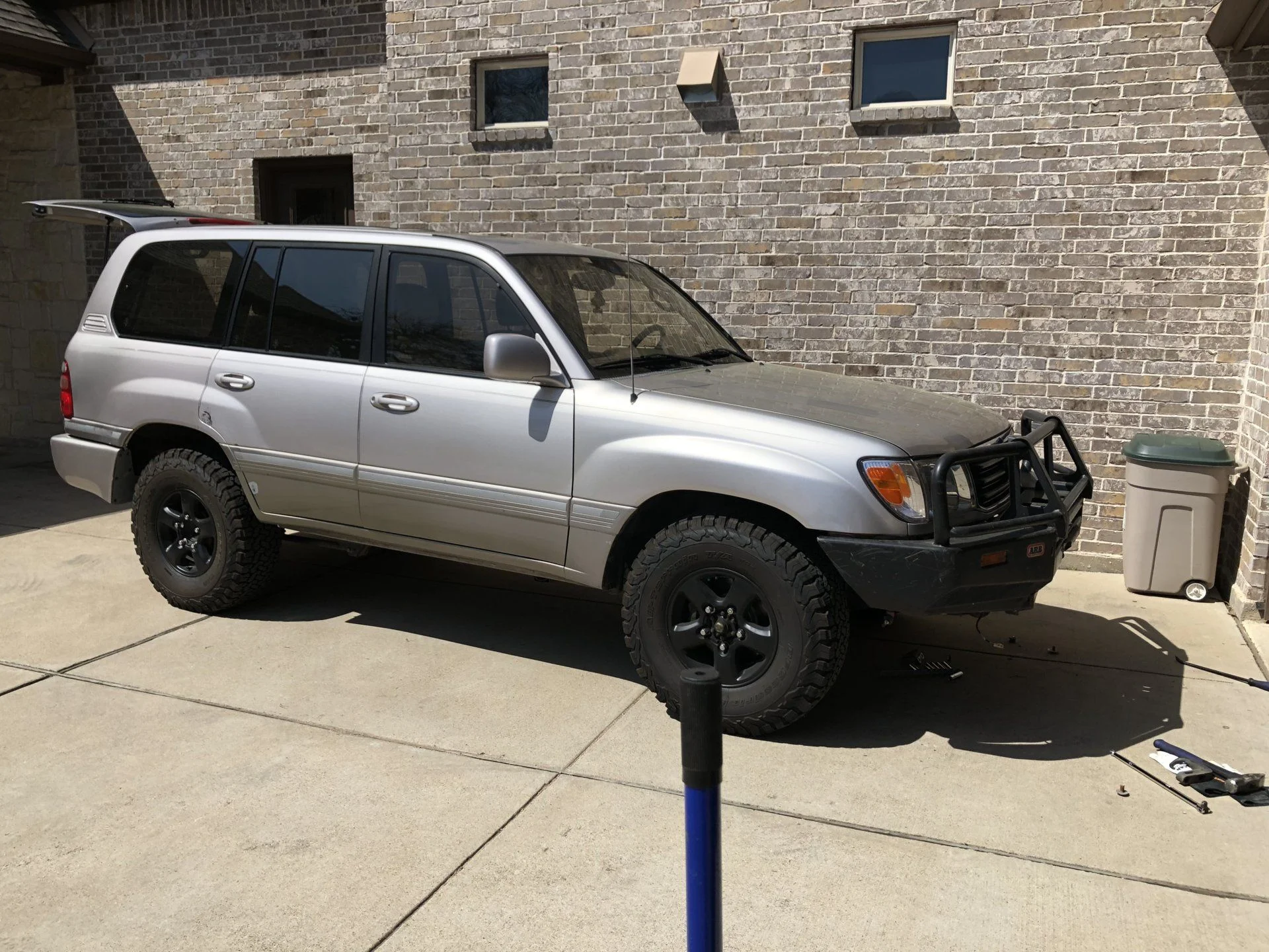

After I finished these items I decided to test fit to see the progress I’d made. To my genuine surprise, It bolted right up. I need a little bit more hardware to secure it 100% and be comfortable winching off it. The passengers side looks great, the drivers side really looks fine, with the exception of that end lopped off. I will need to reshape the top plate a little more since it’s really really close to the fender. But this will work for now. I may play with it tonight if I have time.
The plan is to possibly trim the lower lip, refinish the far end on the drivers side, work out some of the dents, and refinish the entire bumper in black. Again, definitely a long way to go but happy so far that it actually bolted up! I was a little worried that it would be too twisted up.
I think this bumper will get me by for a while, but addicted off-road just posted their new 100 series bumper and I really really hope to buy one at some point they look amazing.

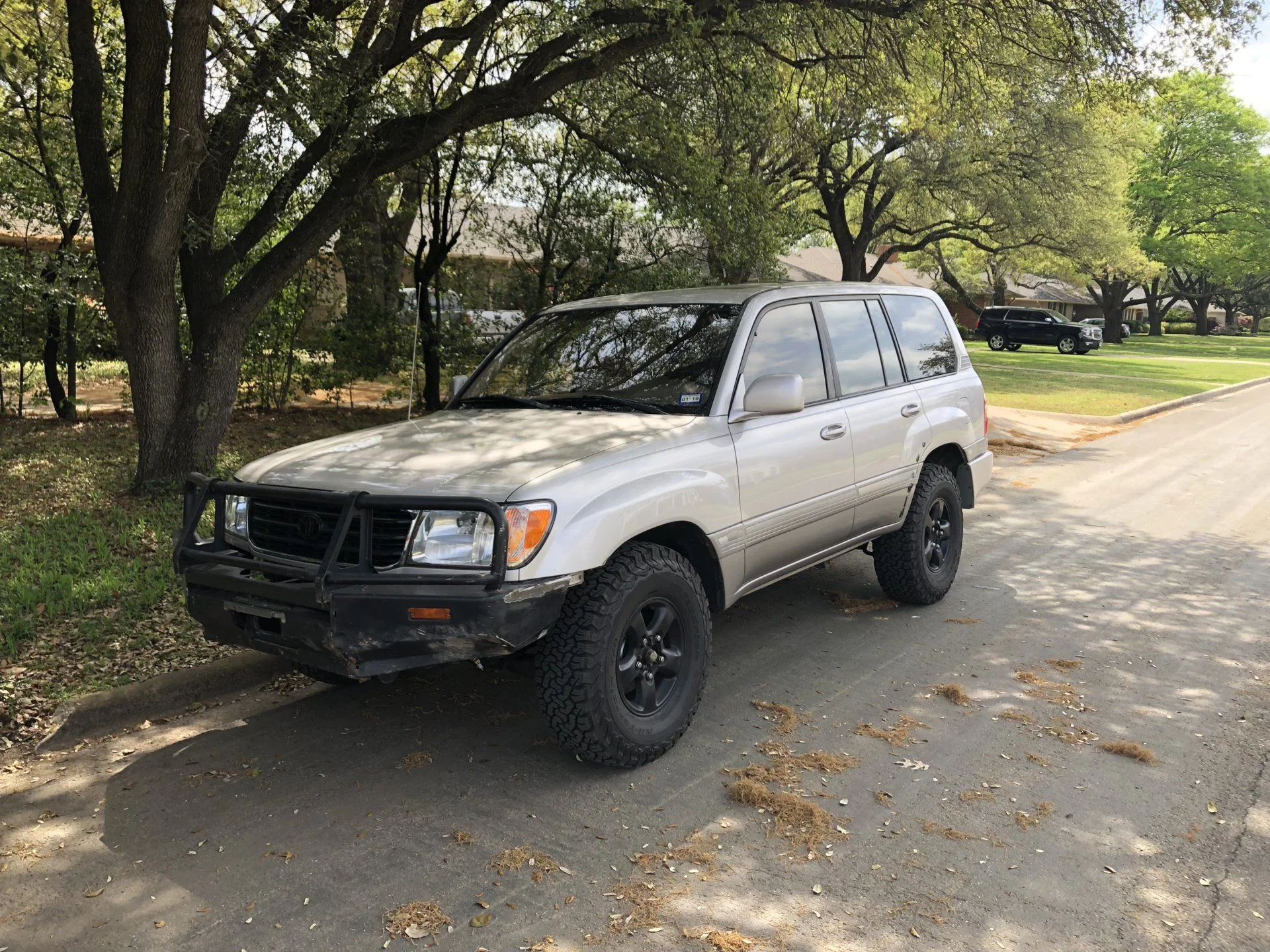

A few pics of how she sits now. And a bonus pick of the Nolan Family silver vehicles! (Working on a GX470 for the wife, she’s interested in the idea)

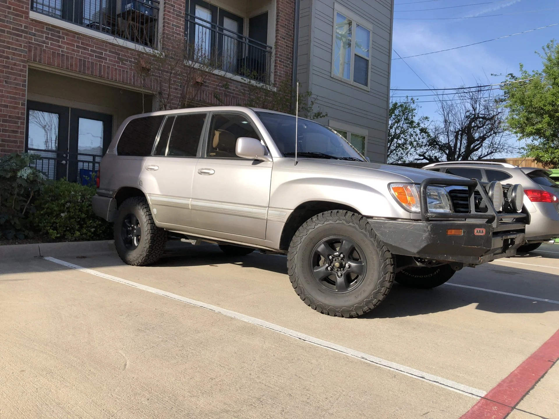

Below is a pic of the cruiser with the passenger TB cranked to the max, and the drivers side cranked to match. I have about an inch of rake, and I think I will keep it this way for when I load down on weekend trips, etc. So the TB re-index may wait for another day when I actually need it. The plan is still to do a Tough Dog lift, but I want to address my steering and CV's before heading down that road.
