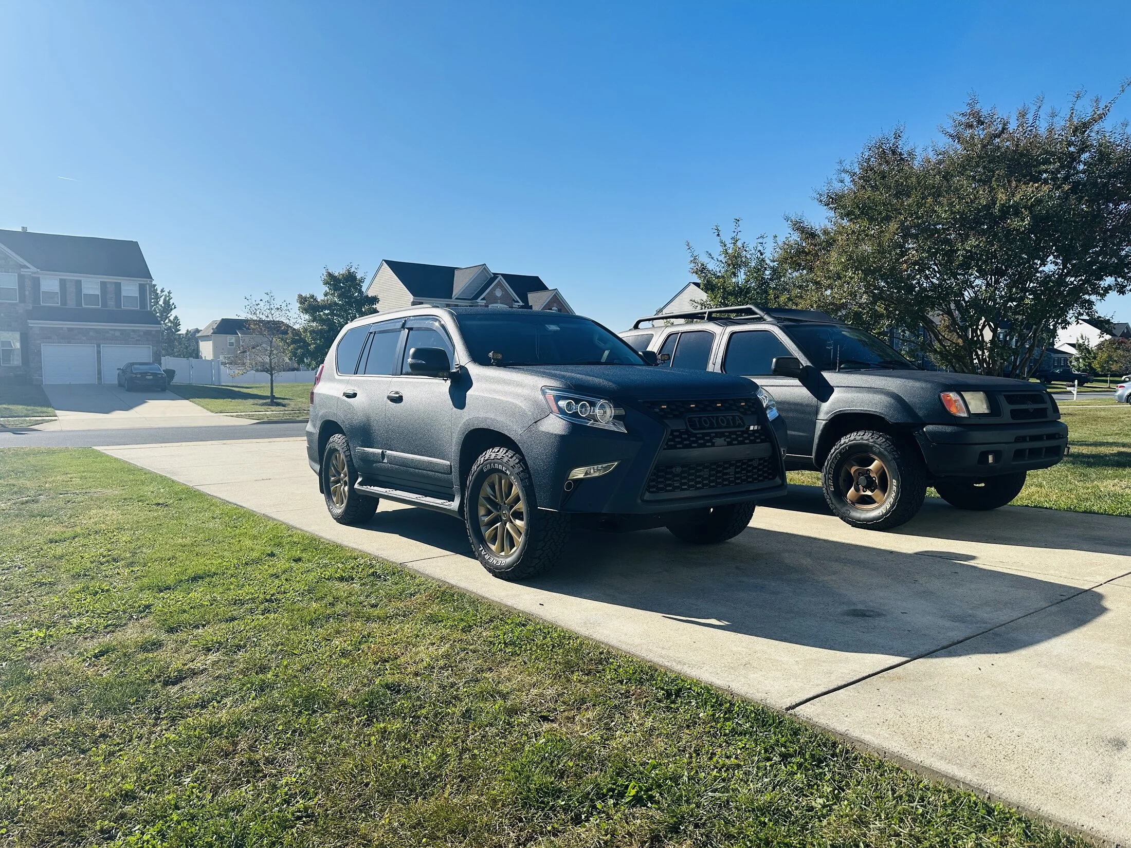

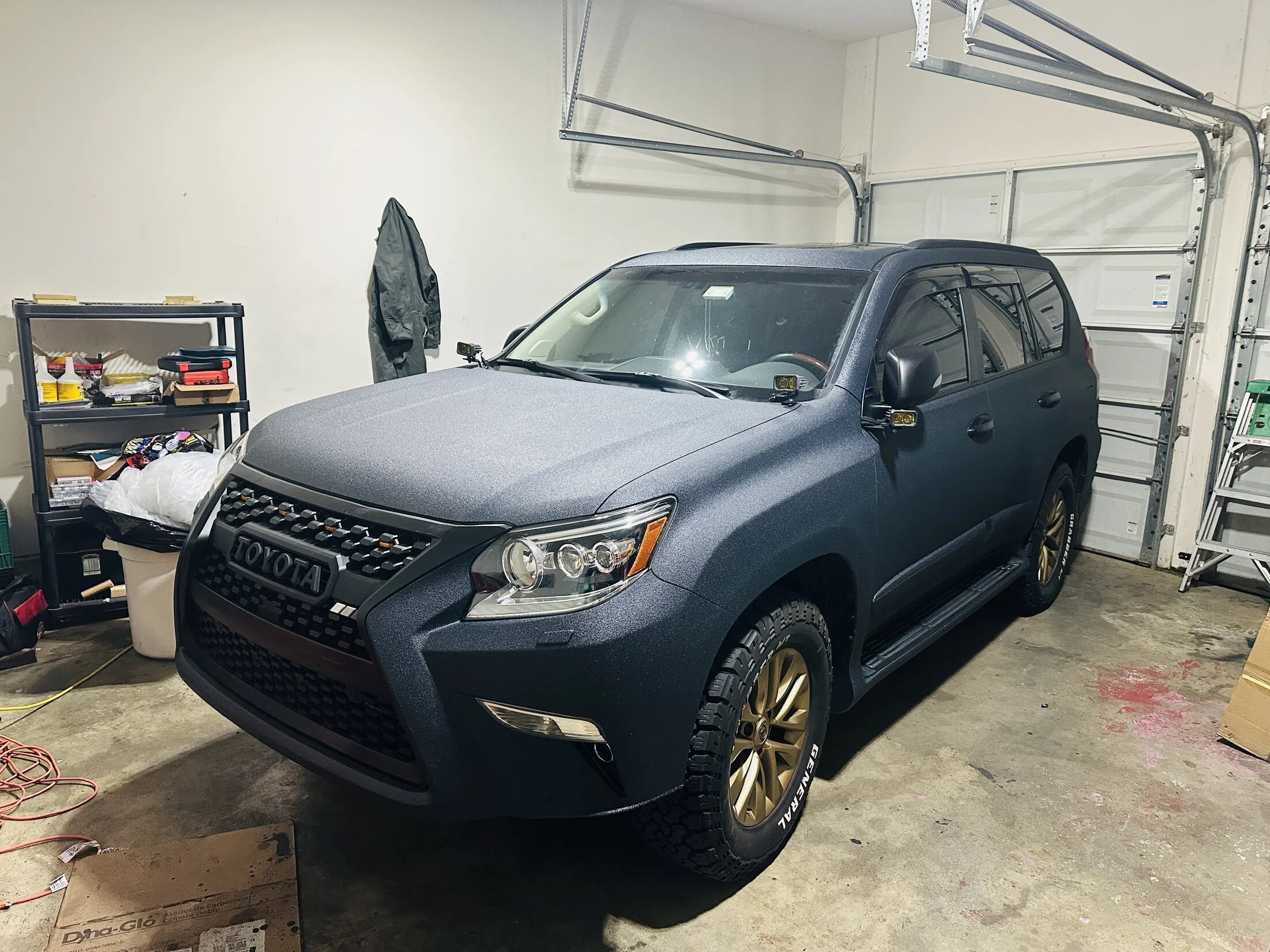

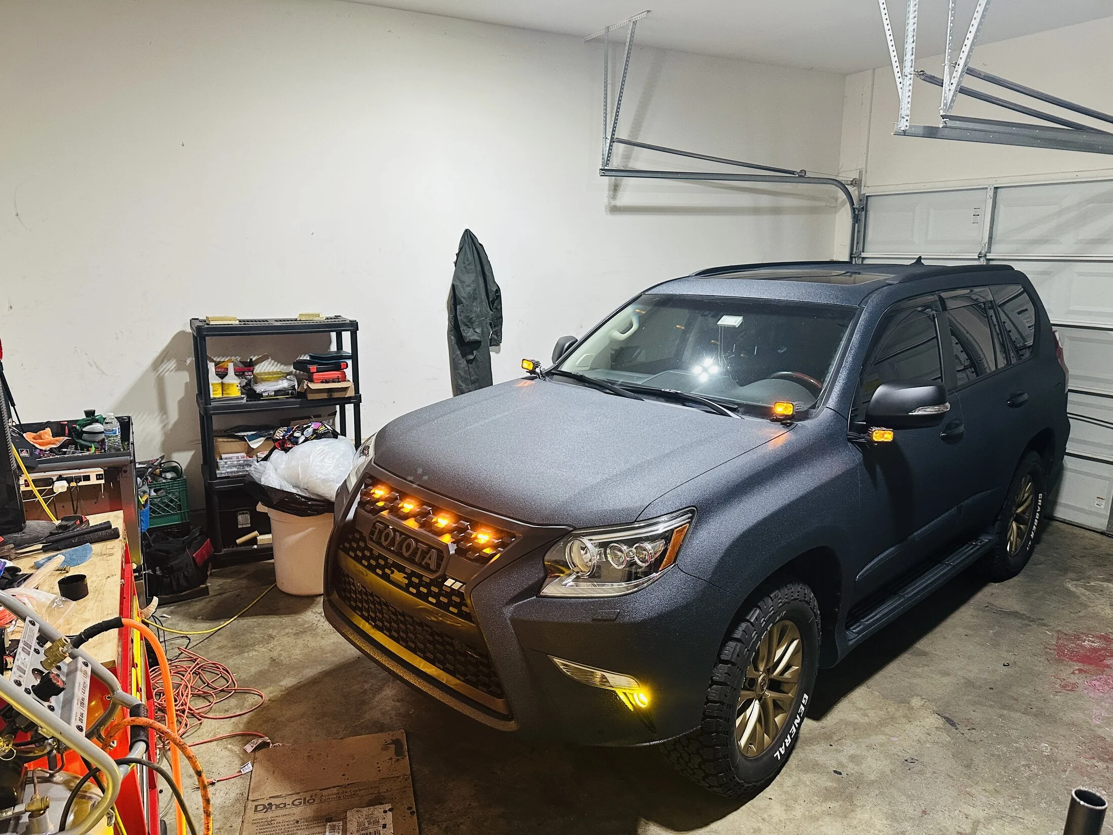

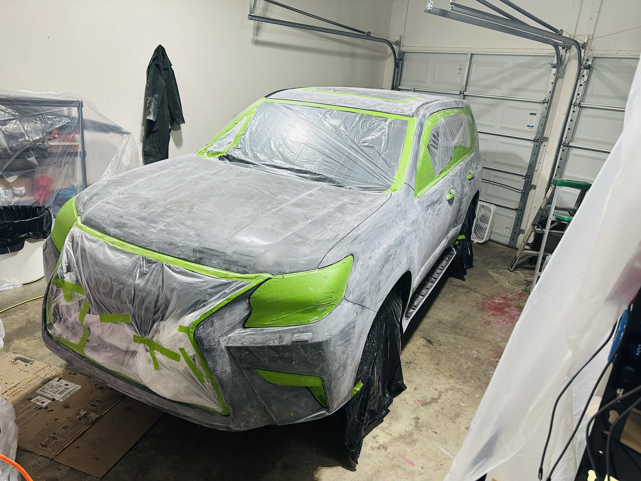

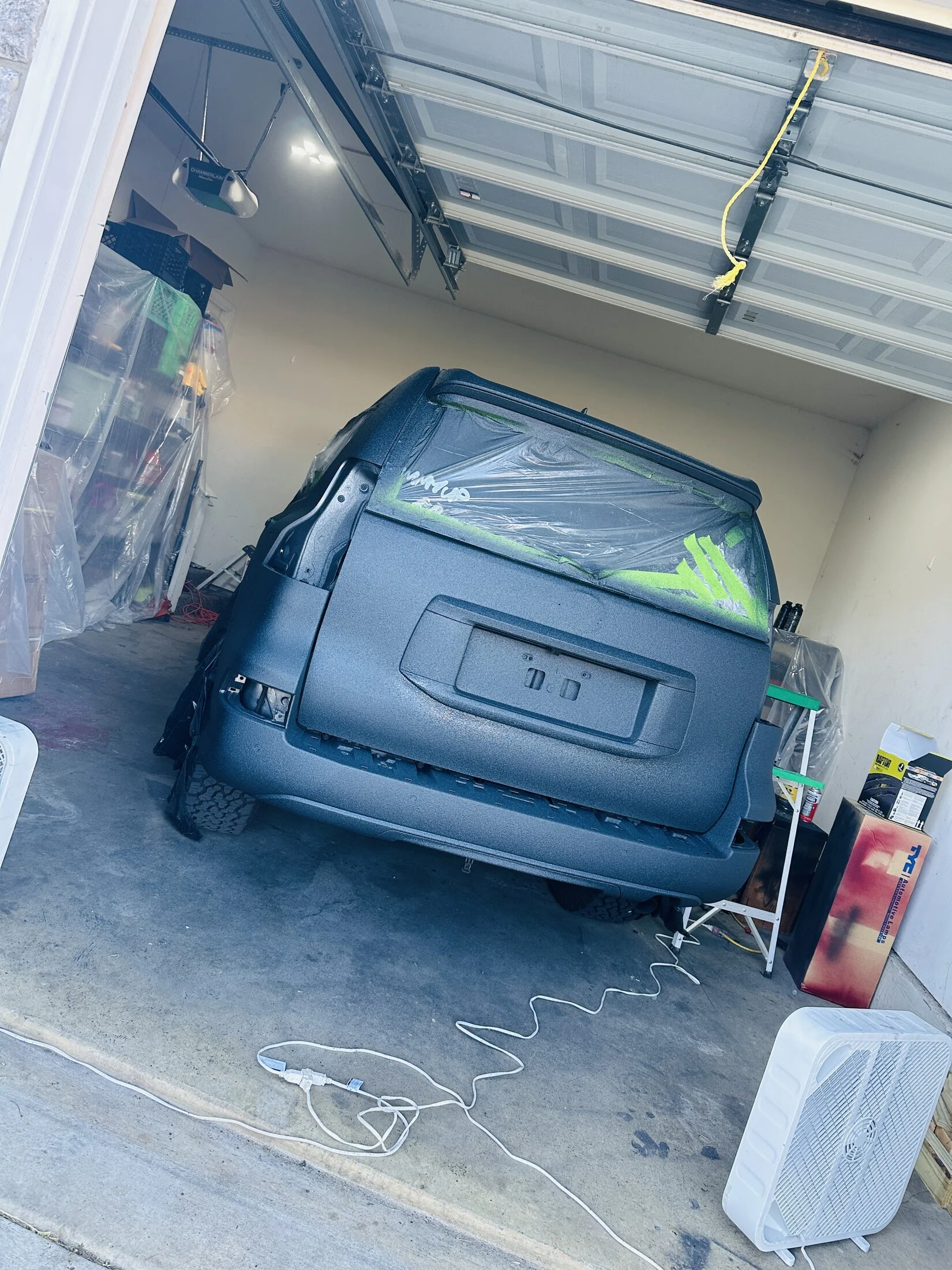

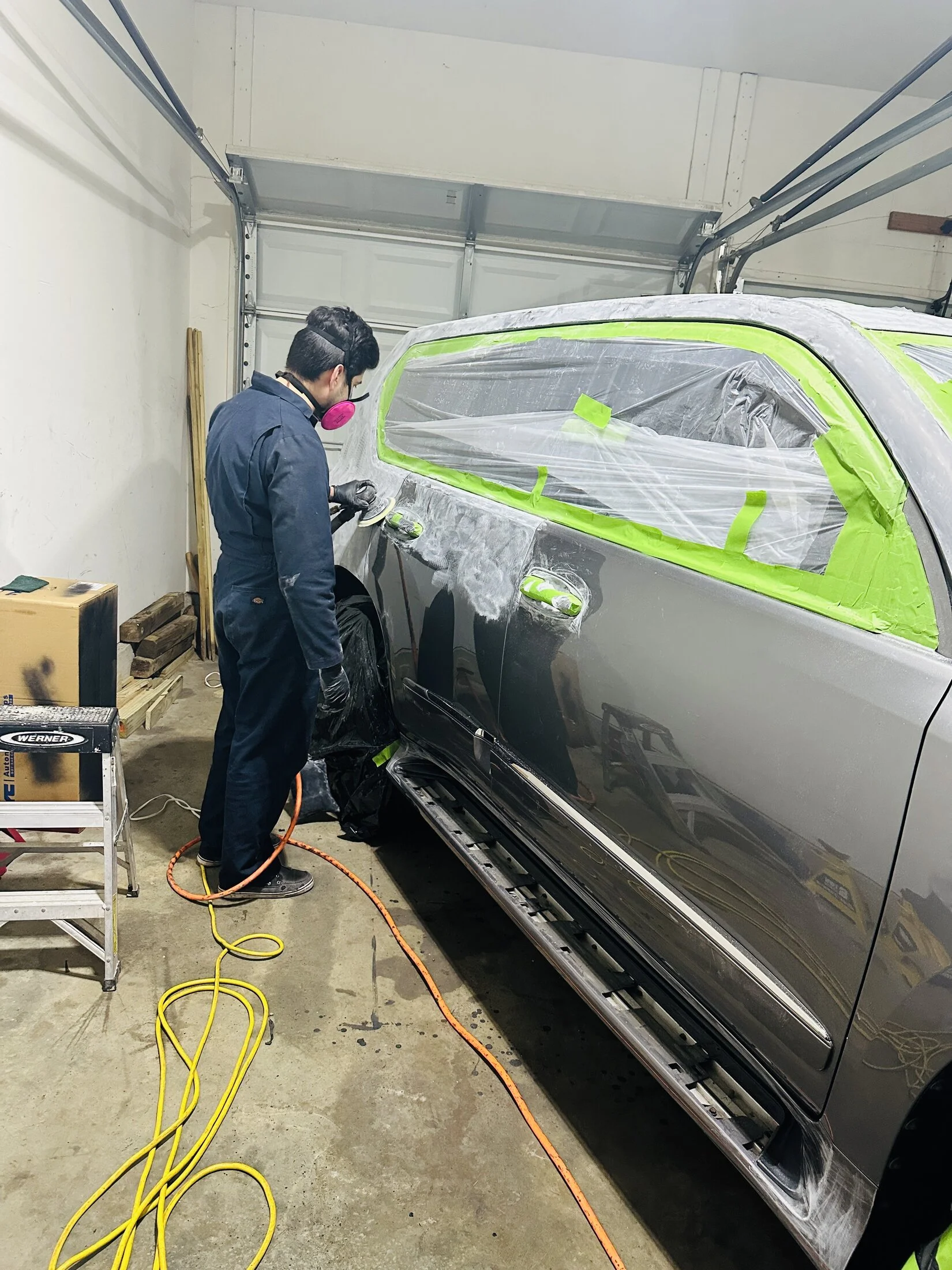

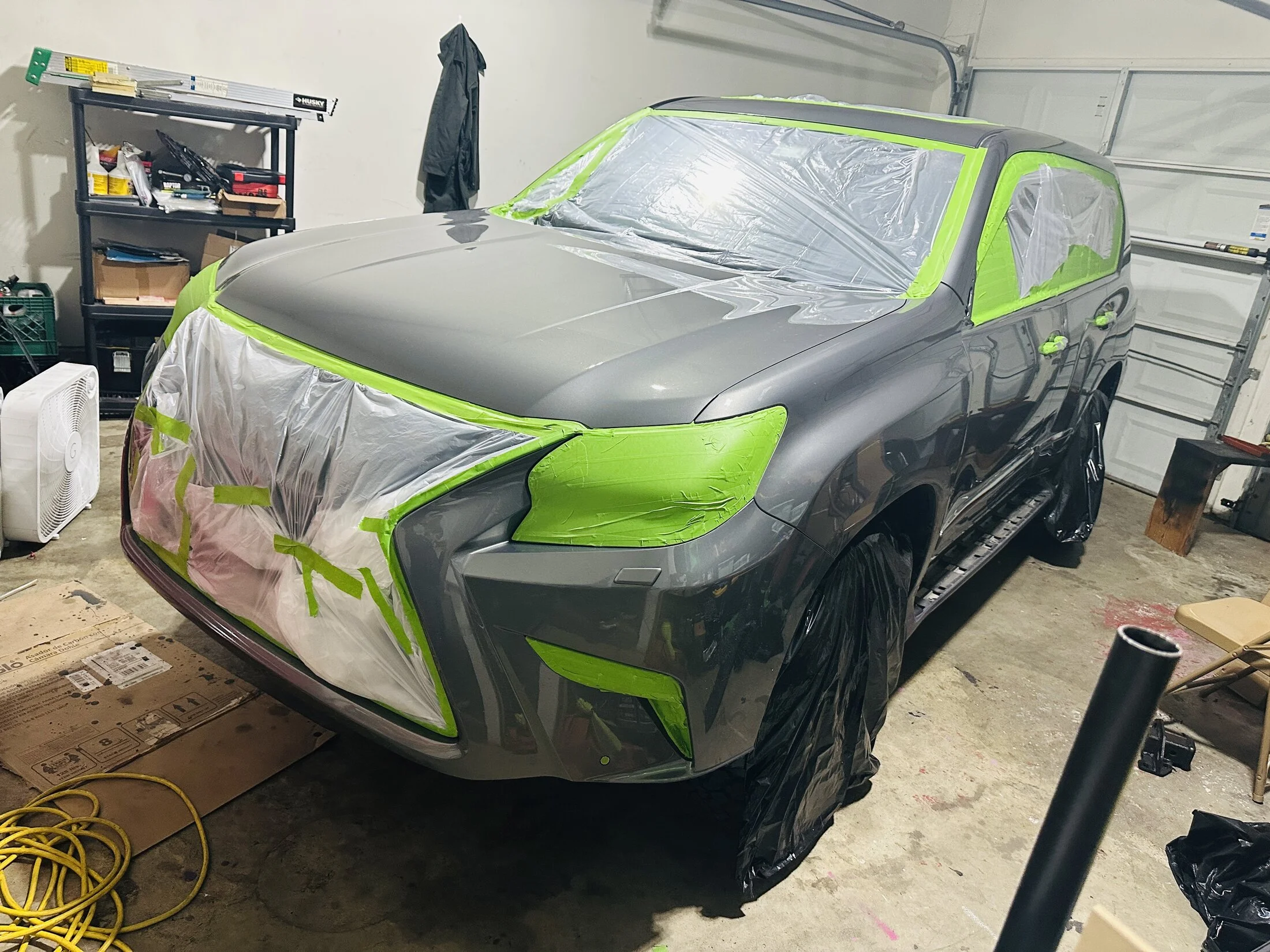

went with Toyota Blueprint mixed with the raptor liner. It came out a lot darker than i was hoping but it appears to be lightening up as it dries so hopefully tomorrow in the sun i’ll get a real idea of the color. it got too dark before i could get it back together to take some better pics.
overall i’m pretty happy with the results so far

Looks great! Will it be easy to touch up?
You'll have to do an MPG test to see how much that surface affects your MPG compared to a smooth, waxed surface.
touching up shouldn’t be bad at all just pretty much spraying over what’s there when needed. from what i’ve read MPGs don’t change much but i’ll keep an eye on it

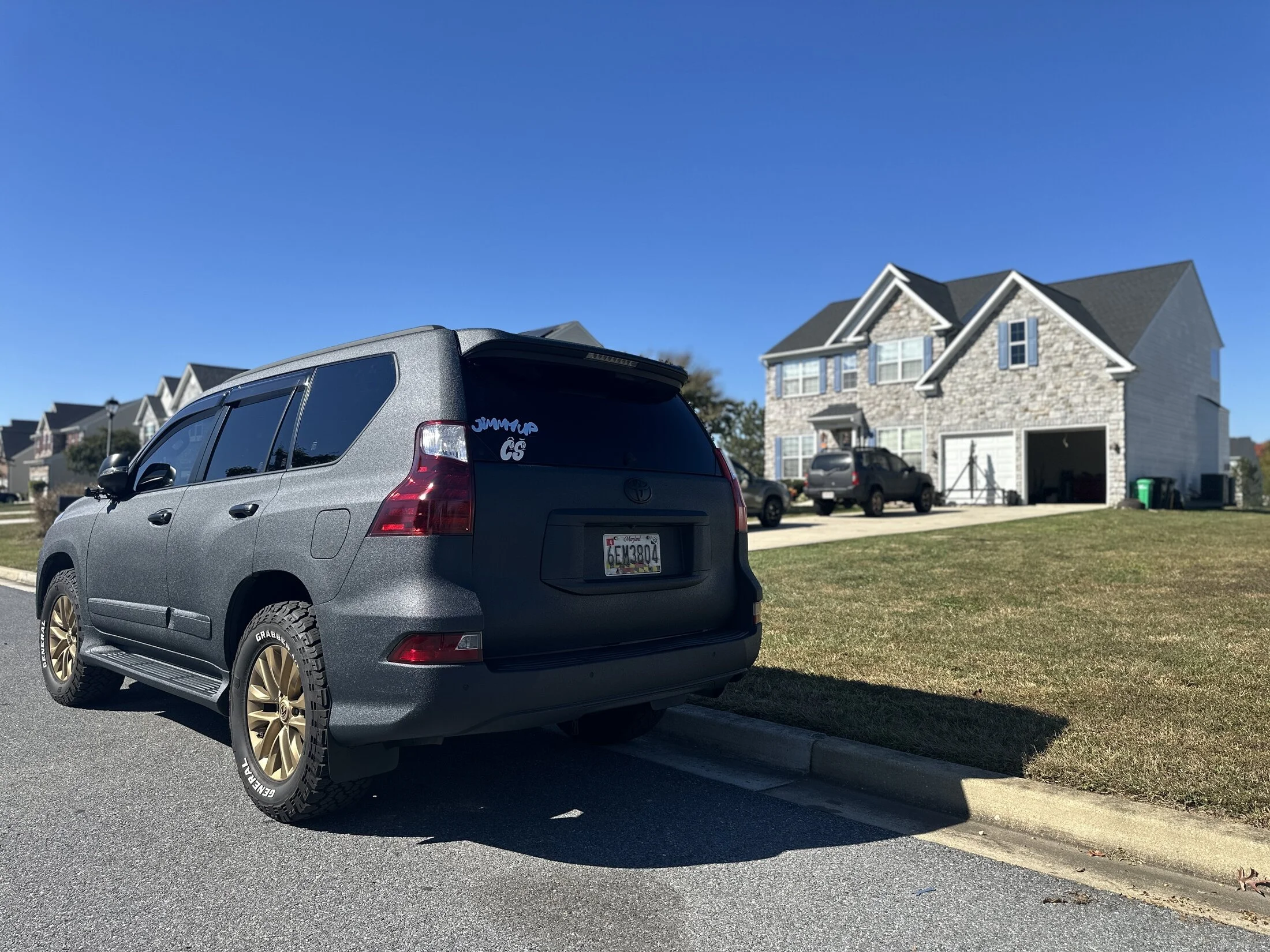

Pattern came out very good without streaks/splotches for a DIY job.
How hard is this to keep clean? My 470 is going to need a re-paint in the next few years. Unsure if it will get just a new paint job in the OEM color (which is an awesome color), a wrap, or Raptor Liner. Raptor would seem to be the cheapest and easiest to DIY. I do see a lot of dirt in my rig and woudl be curious on if it's possible to keep it clean-ish with all of the texture.
Thanks! with my brothers xterra he hasn’t washed it in a year and just hoses it down every so often and it’s still looks as fresh as the day we did it to be honest.
the key to no striping is a final dusting coat to make sure it’s even but raptor is super forgiving
i just didn’t want total because everyone does it now a days i love that the raptor stands out

Thanks! I may consider it when that time gets closer. My rig still looks great at 20 ft, but the roof clear is peeling and the paint has a lot of scratches/swirls. It would be hard to spend $5-7K on a Cypress Green respray and then scratch it it off-road.
Can you use any color/pigment with Raptor or are they limited to their "stock" pigments? Ideally I'd keep the OEM Cypress Green pigment.

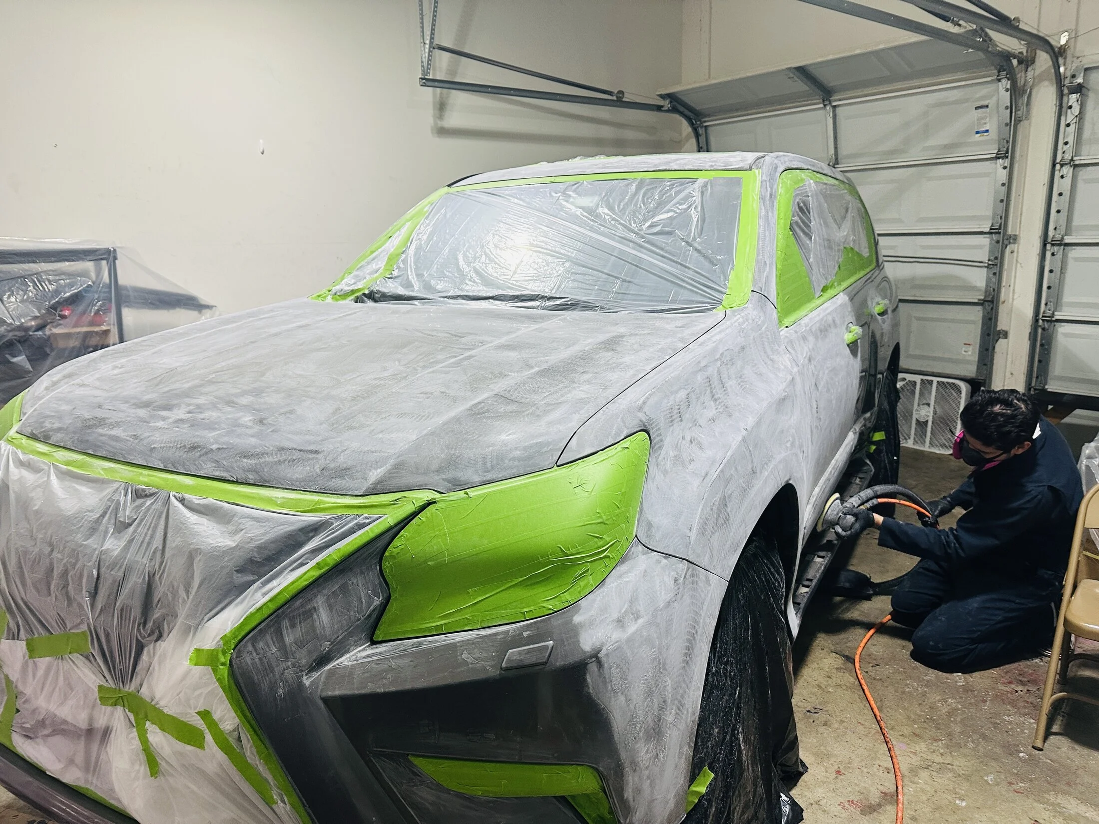

I went with Toyota 8X8 which is called blueprint, you can use any non-water based paint from everything i read but when its mixed you have to specify that it is mixed without binders.
Thats what the documentation says, me myself, i just went to automotivetouchup.com and ordered a quart of the color i wanted and mixed in 4 oz of paint into each bottle and that was the result, idk if it came out darker because i didnt specify the no binders aspect or if thats just how it is, but it seems to be not an exact science to get your shade right when going custom instead of their prepackaged stuff. i just didnt want to spend another $300 bucks for 32 oz paint
