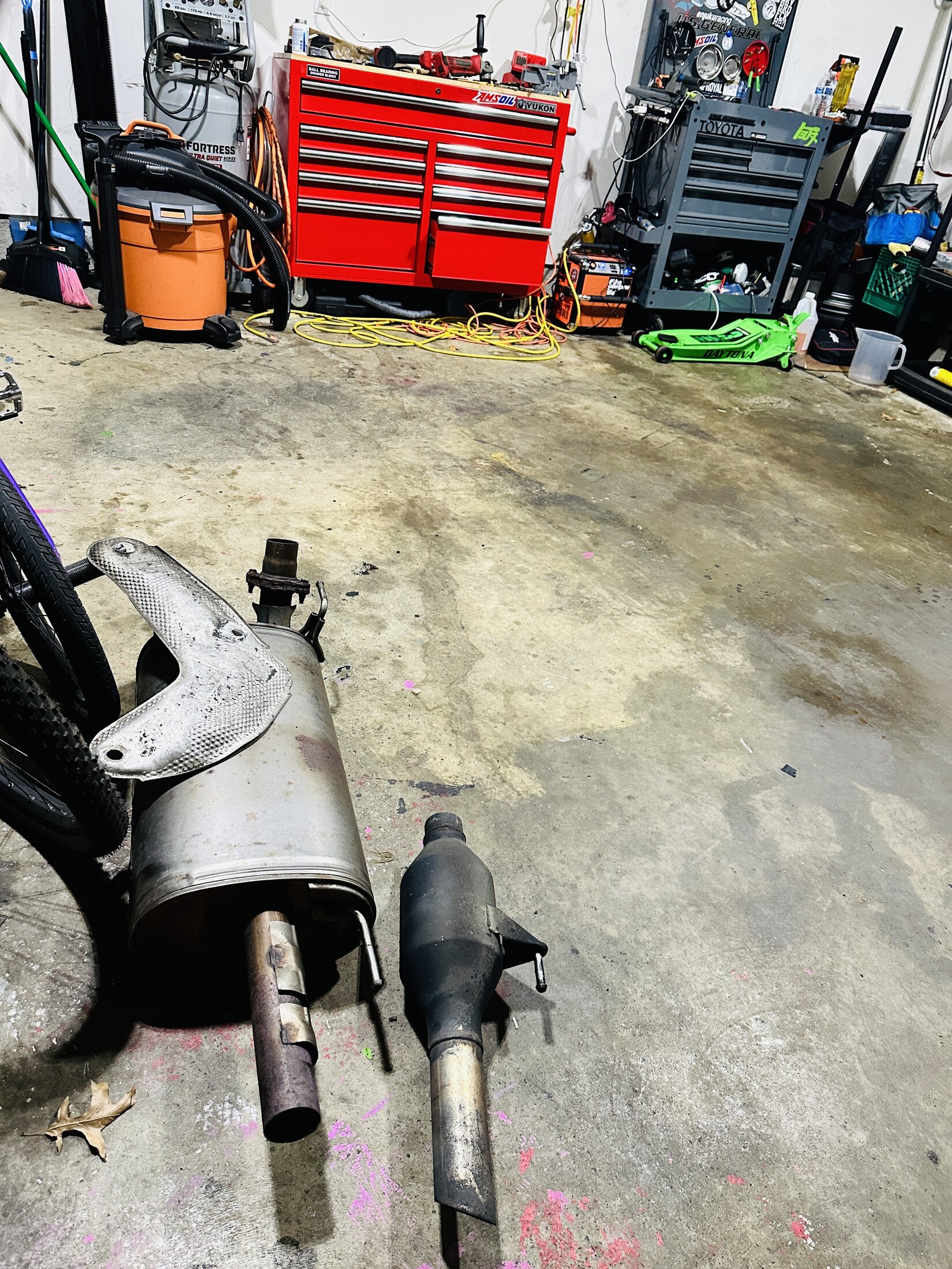

welp got bored and decided to go all in.
cut the muffler and resonator off
started with the resonator and notice 0 change so kept going
definitely a noticeable difference without the muffler
i missed the throaty sound of an exhaust so it’s definitely appealing to me but since this is a “luxury” car i know im in the minority and will get a bunch of flack but im happy with it so far.
will see this week how the highway/everyday driving feels

Prepare for DROOOOOOOOOONE!!!!!!
A nice Borla muffler in place of those two would give you a nice rumble but cut down on some of the drone. Cutting the mid muffler and rear resonator is just gonna suck for highway driving.
Also, any speedy accelerations with police next to you.

Are you going to weld on a short turnout toward the side? It'll help direct exhaust out the side instead of up into the cab.
Have you noticed any odor with windows down yet?
When I jettisoned my resonator, I had a short turnout welded to the end of the muffler and has been great for the past couple years!

I'm finally getting time to install my Dissent rear bumper this weekend and have been thinking about chopping off the exhaust tip and resonator since I think it will hang down too far below the new bumper and look dumb. I've been trying to figure out if there really isn't a sound difference or if people just ignore it...also if the chopped tip will somehow pull fumes back into the cabin if it just dumps after the rear axle.
I've seen (not on GX460 examples yet) where someone had cut short and removed heat shields nearby. Insulation (through floor plugs) got warm, then eventually carpet, and finally back seats.😮
Watching the guy drive by with smoke pouring out the windows was hilarious only because he survived without injury. Headliner, back glass, back seat, back and b-pillar plastics, etc. were torched. He had chopped the exhaust right behind the cats recently. Could be coincidence...I am not an authority on the subject.

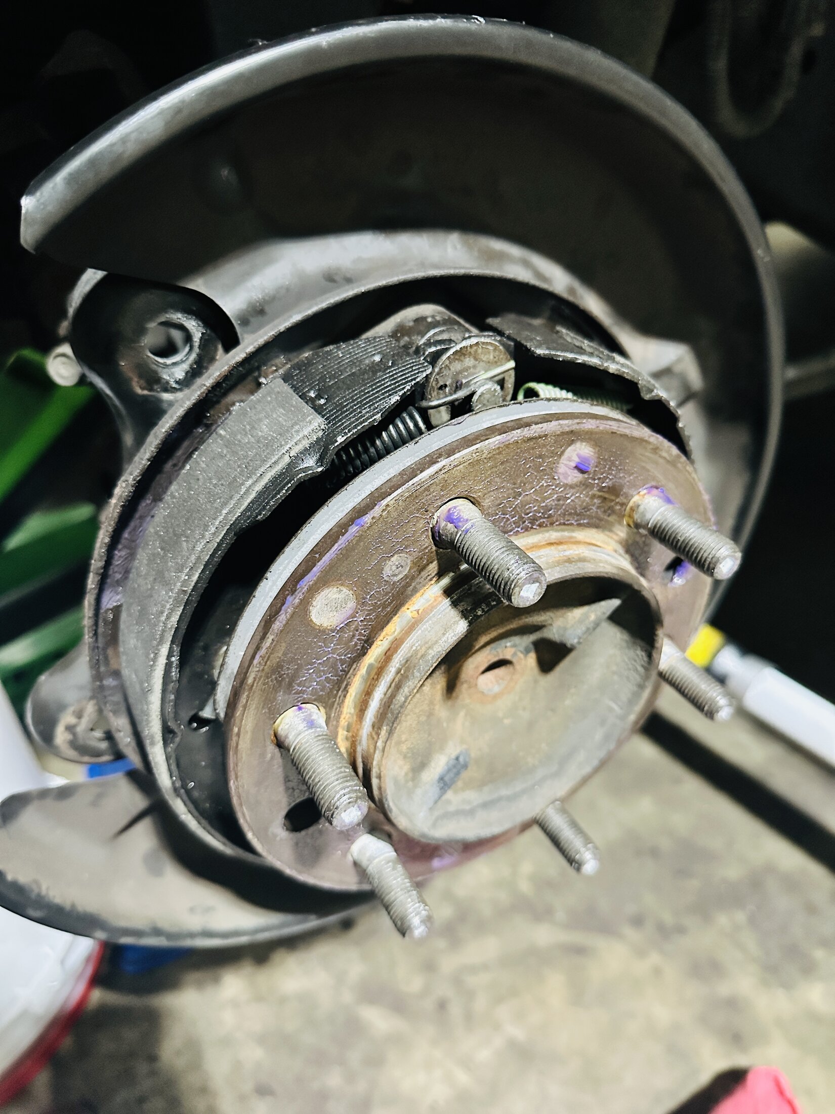

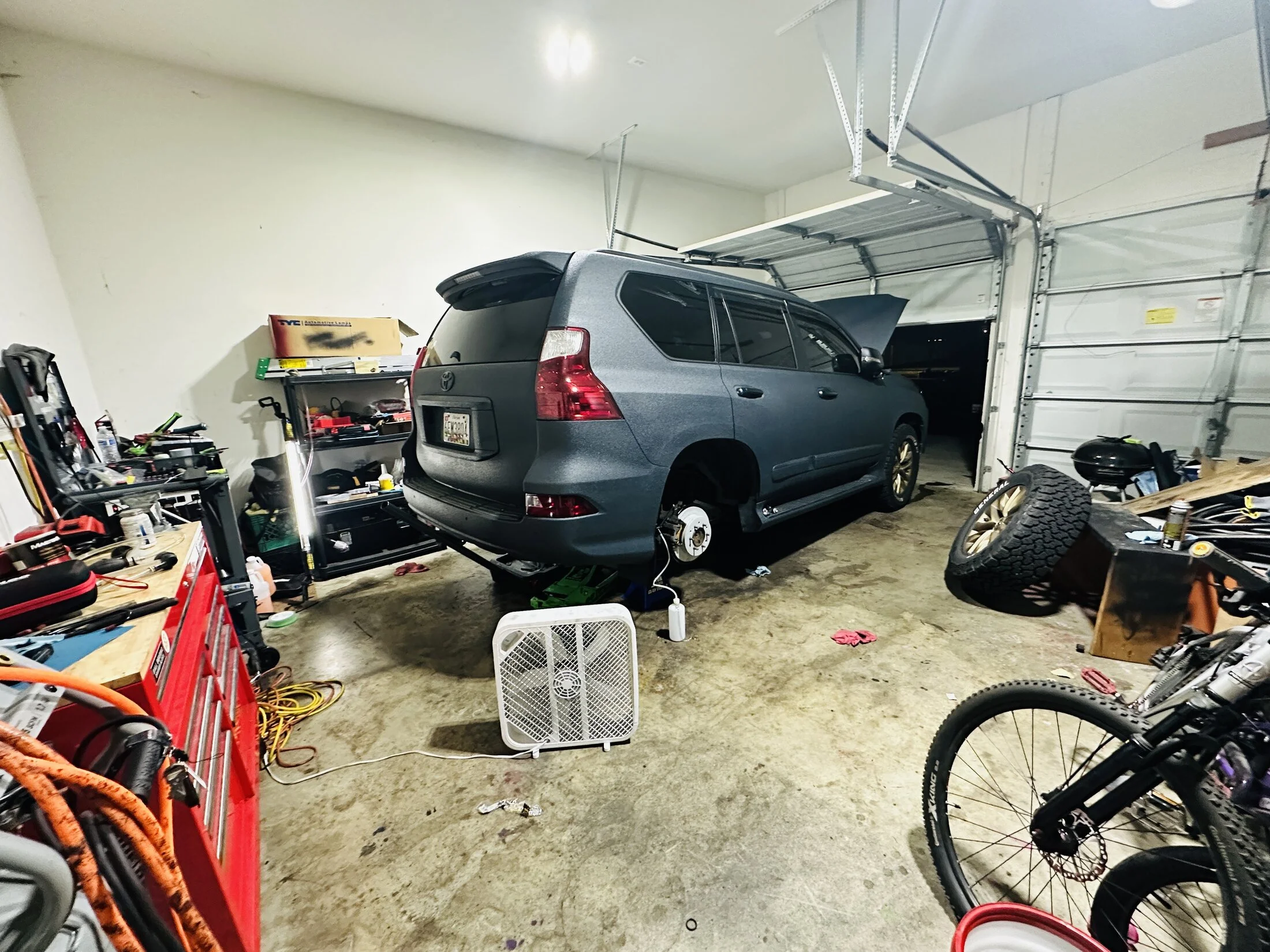

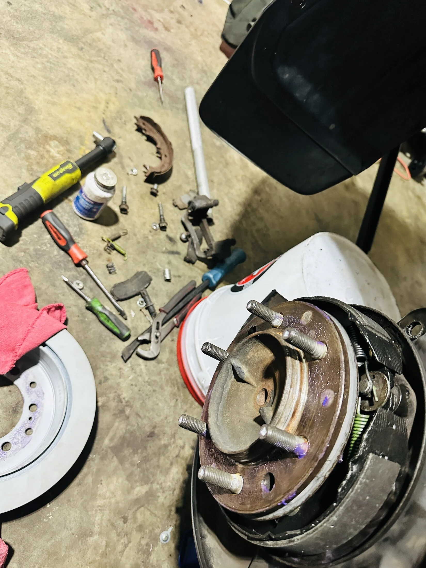

nothing special lately but did change all 4 brake pads, rotors and shoes/hatdware
doing the shoes is the biggest PITA everywhere but on the plus side this will hopefully be the only time i ever have to do it
yeah it def sucked, worst part is i think the parking brake still isn’t adjusted correctly even though i took it off and made sure to get that “drag” when putting the rotors back on. I still feel it creep if i put the parking brake on before putting in park

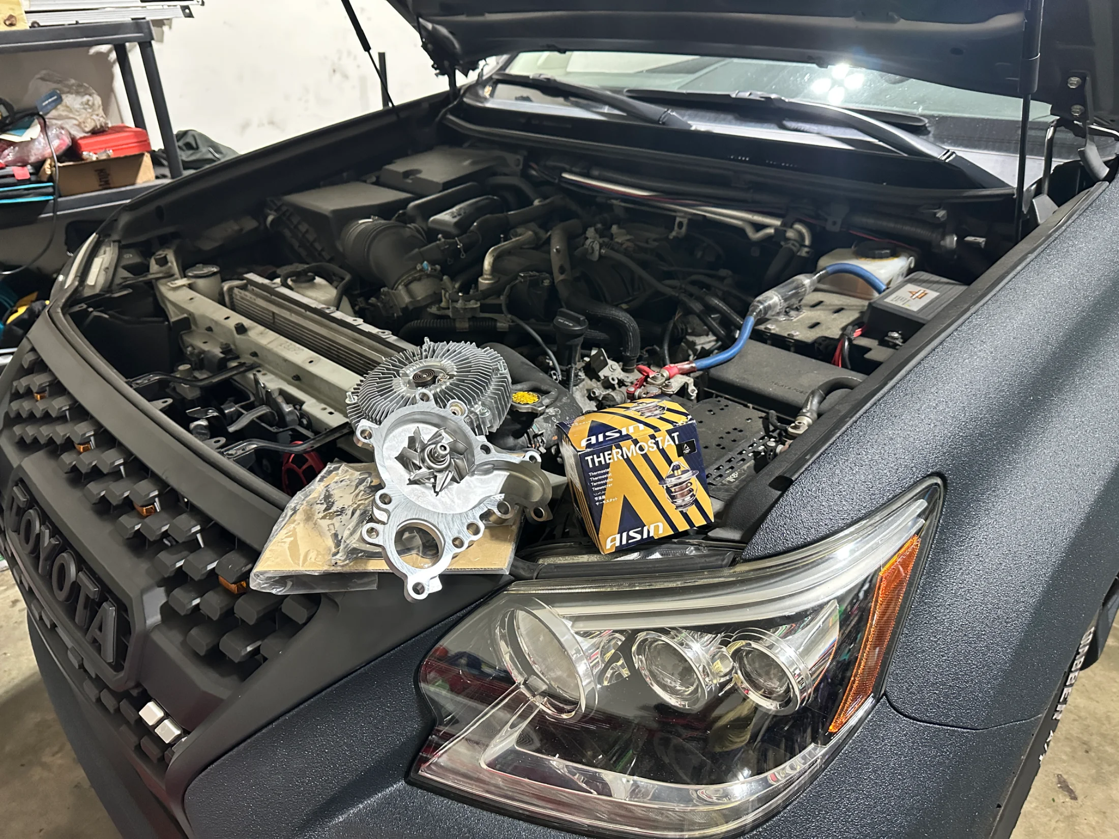

discovered some weird clicking noise that i heard at idle. took me about a week of listening trying to figure out where it came from.
at first i thought it was the fan but couldn’t be sure
then i thought i have 130k and never changed the water pump maybe the propeller was rattling
ended up buying the fan clutch and WP and thermostat (Aisin brand is exact OE (replica or supplier) of Toyota. Water pump even has the Toyota label scratched off for some reason)
changed the fan clutch first and luckily that appeared to be the source of the noise
returning the WP and Tstat for now and maybe circle back to that job in the the next 10-20 k
My fan clutch got replaced at around 80k miles on my '12 a few years back.
It was sticking on when cold
I was doubtful it was the fan clutch because i’ve never seen or heard one go bad before but it seems like it was the culprit.
the fan noise has def gone down after replacing
My buddy just replaced the fan clutch in his FJ after having very similar attempted overheating behavior that I had with a bad thermostat. His fan was running at idle, but I guess the bad clutch meant it wouldn't actually spin fast enough to move enough air at low speed.
It probably didn't help that both of us also had to wash like 30lbs of mud out of the radiator fins...
