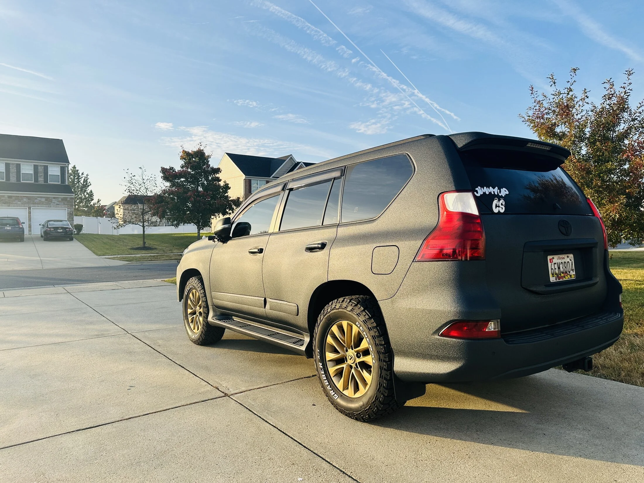

Thanks. If i end up going this route in the future it's good to know that any color can be used. Again, way cheaper than $5-7K for a "real" paint job.
Also did you paint over the Toyota emblem on the back? Or it is able to be masked or re-installed over the Raptor liner?
I had removed it to paint just reinstalled it today with the little pegs and some 3M emblem adhesive
but you can either mask it or paint over it as well we painted over the nissan emblem on my brothers xterra no issue
i recommend for any chrome pieces to spray some adhesion promoter to ensure it sticks well
Thanks. I was definitely skeptical, but again your rig looks great! We'll see which way I go in a few years. Until then, I'll probably survive by getting a black wrap on my roof and giving the rest of the rig a cut-and-polish.
Pattern came out very good without streaks/splotches for a DIY job.

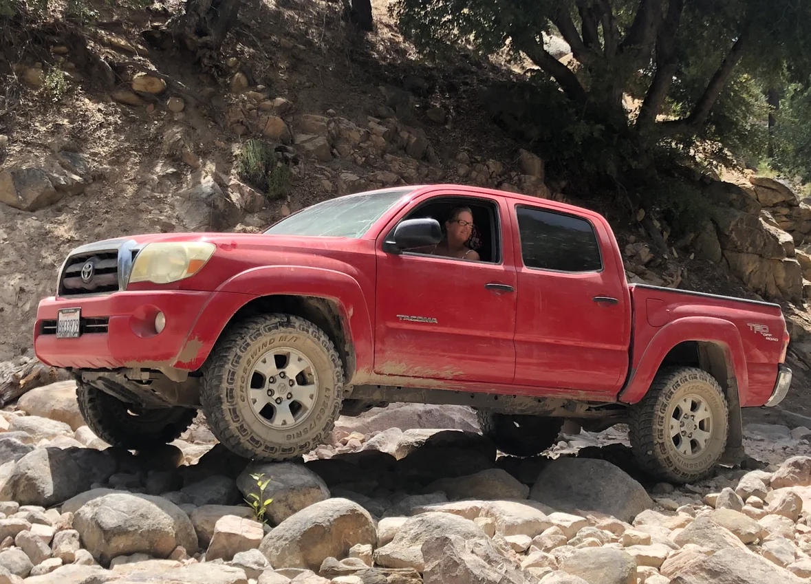

My wife's 2007 red 4x4 crewcab Taco was getting pretty bad. Rust along the upper right windshield to the point it would drip into the cab and the clear coat was pretty much gone.
For a Christmas present (it was not a surprise), took it to Maaco paint (in your area: Missouri Auto Body Paint Shop Locations - https://www.maaco.com/locations/mo/ ) and did the deluxe everything paint that included the rust repair and 5 year warranty. It's been 2 or 3 years now and still looks good!
I know Maaco are the cheap guys for paint jobs, and yes I had to take it back to the them because the hood had some, what looked like painted dust specs and orange peel, but they repainted the hood, no problem. There's a little over spray on some of the under carriage and we purchased our own Toyota 4x4 large labels that those trucks have on the rear quarter panels from Amazon. That was way cheaper than factory Toyota labels.
But other than that, we're pretty pleased with how it came out.
Ear-to-ear grins on my wife while she takes "Rosie" (the name of her truck) through a little rock garden. If you look at the rear quarter panel, you'll notice the photo has the original Toyota 4x4 label before the repaint and the top photo has the TRD label from Amazon.

Kind of like you, had to evaluate how old the truck is vs. how long we'll probably keep it and it's use, so yeah, we didn't want to go to a high end shop. The Maaco was "good enough" for what we wanted and if we need to sell it, we should be able to get a good price with the way it looks, especially with the WetOkole seat covers. The seat covers are still in great shape after almost 6 years, not to mention how good the factory seats look from being covered ever since we've had it!

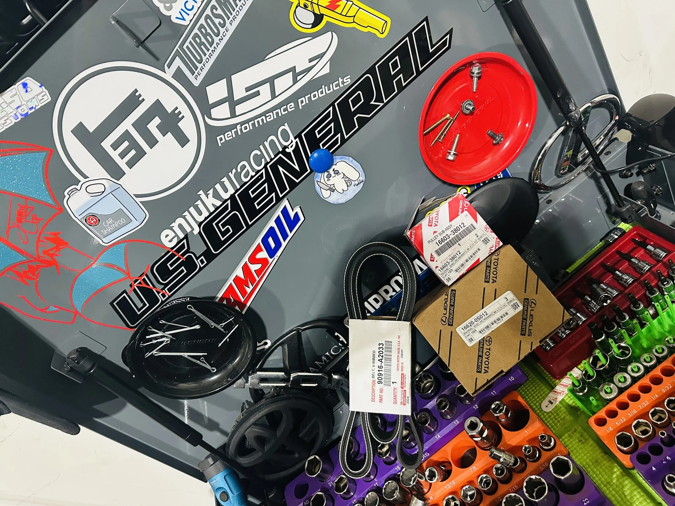

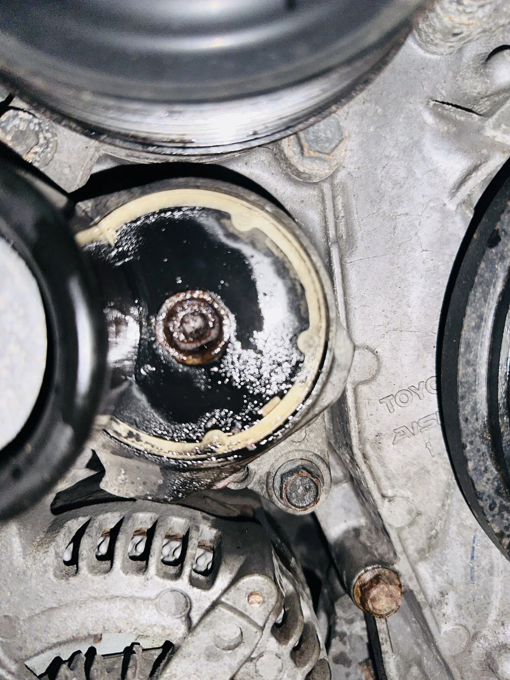

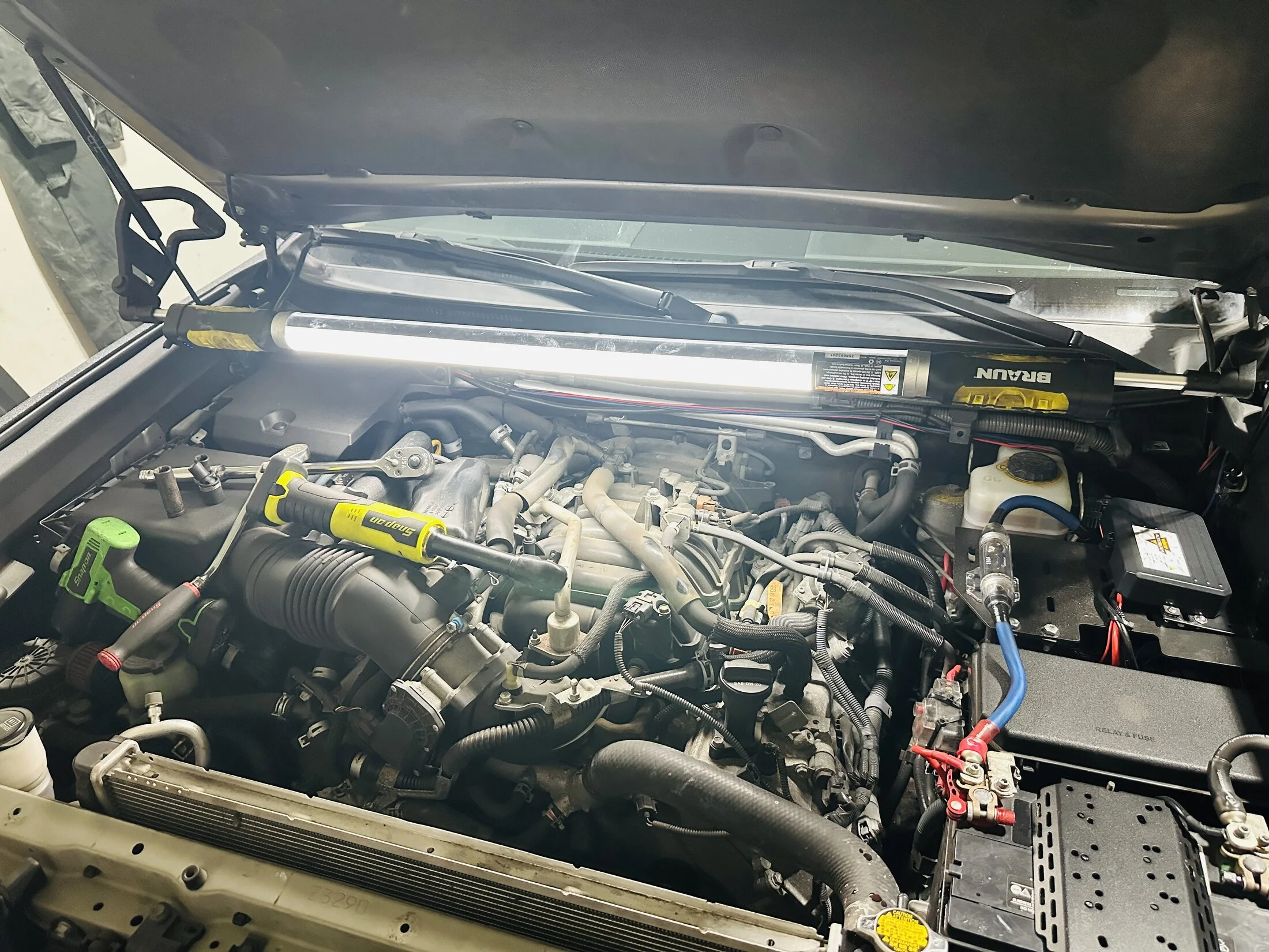

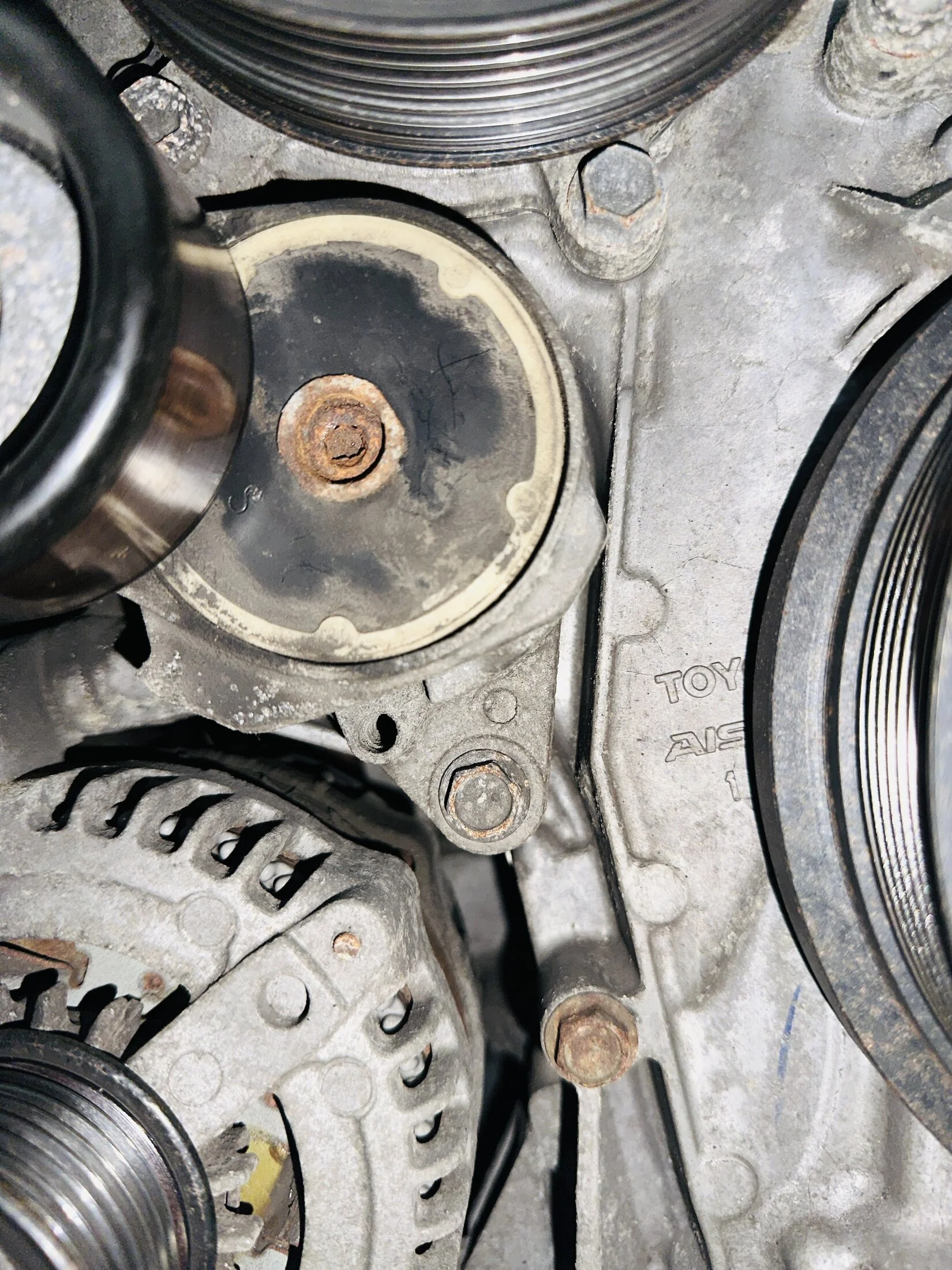

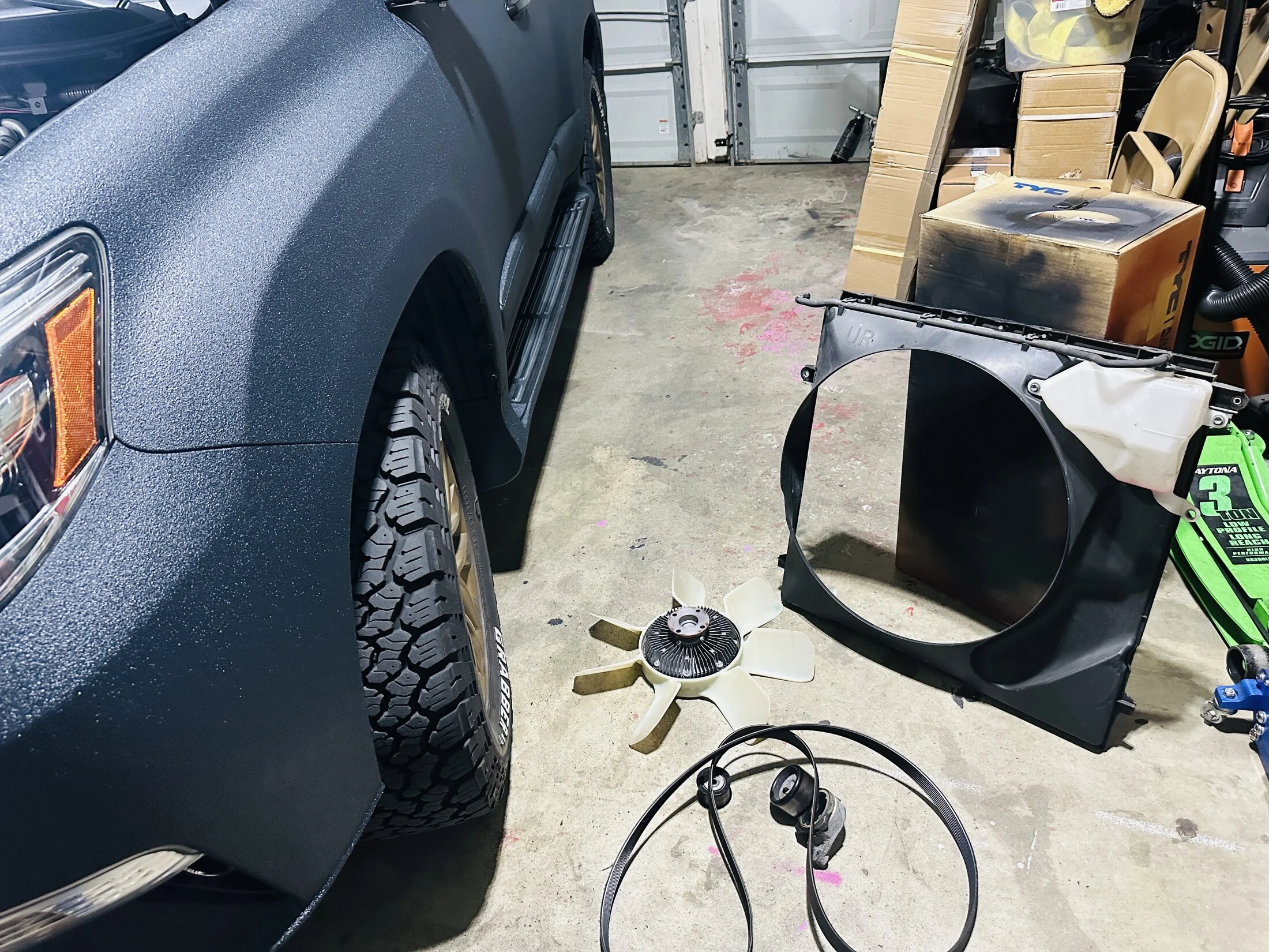

Replacing the tensioner and idler in hopes that will solve my growling problems if not i think water pump is next
The hex head bolt had to be ordered so i should be finishing up with the reinstall tomorrow
Toyota part numbers for anyone in need
90916-A2033 Belt
16620-0S012 Tensioner
16603-38012 Idler
90110-A0005 Rusty Tensioner Hex head bolt

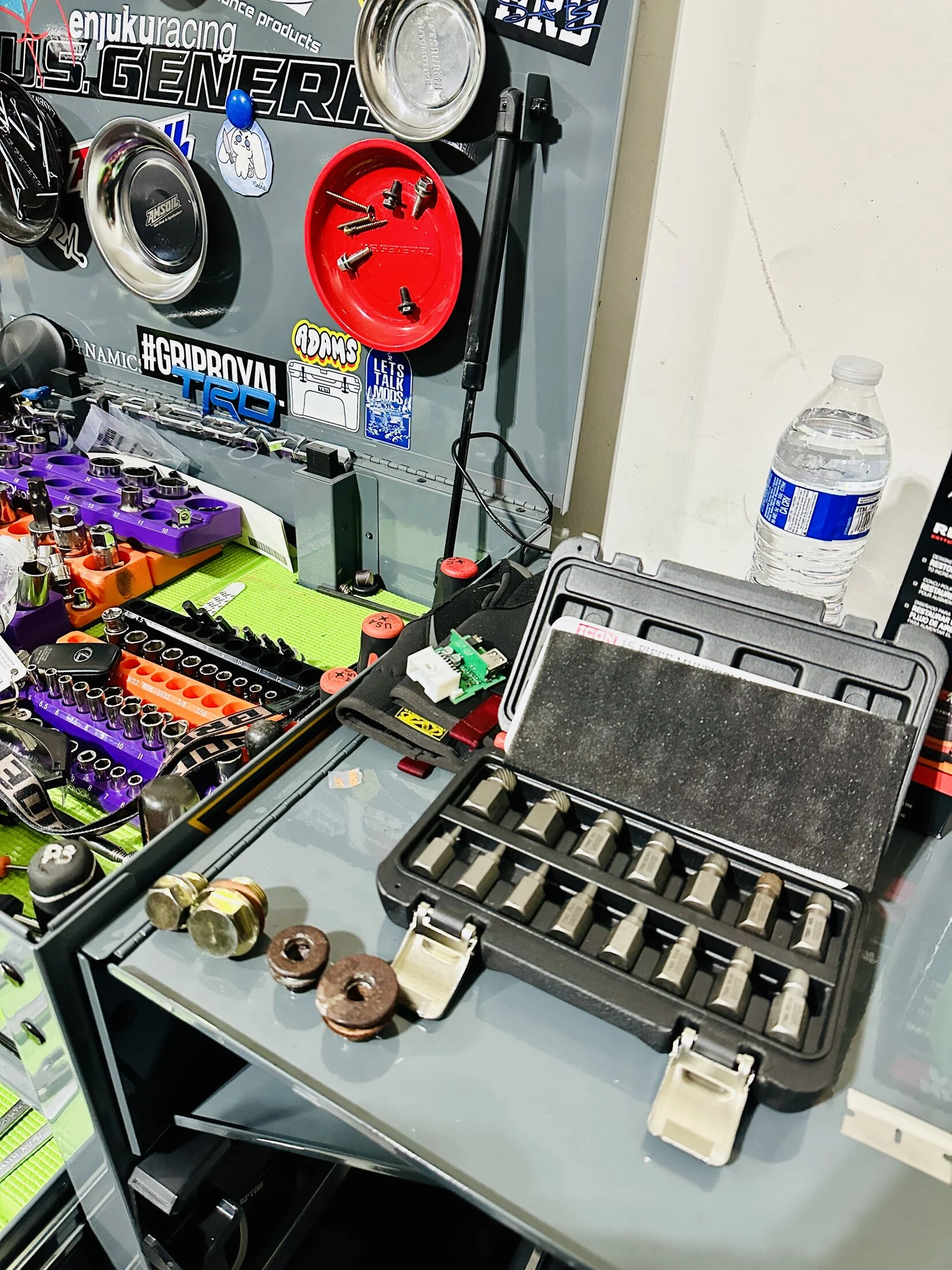

Changed the fluid in the front differential as i had procrastinated taking off the skid.
I was greeted by 2 super rusty plugs for the drain and fill.
This Icon 15 pc extractor set was definitely worth every penny i spent on it. a little bit of hammering and the extractor got the fill plug out. the drain was a little more of a pain but with some heat and the next size up extractor made it a lot easier.
I was able to get it done in about 1 hour thanks to the extractors. Fluid wasn’t even super dirty surprisingly. I replaced both bolts with the hex version from Kaon

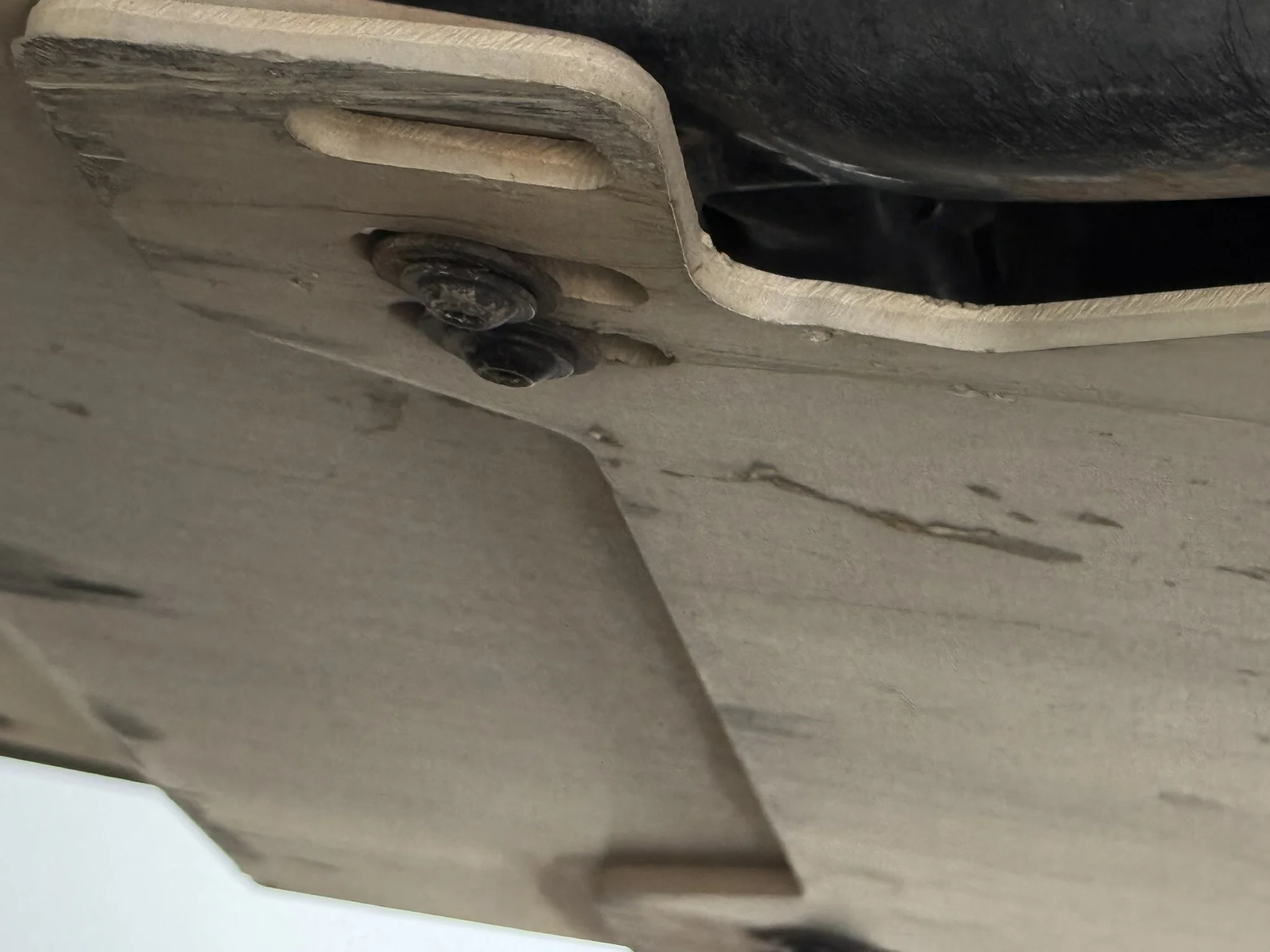

definitely worth it. I had smashed and smeared all my hex button head skid plate bolts to a point where they were all stripped. I hard to drill the holes a little deeper and the HF Icon extraction tool made it a breeze to remove 8 bolts.
exactly why I just ordered some new external hex head bolts from McMaster to replace the hex button head bolts my skid plate came with, I hate bolts like that I always end up stripping them even if I have the right key
great idea, I may try that the next time I have to replace bolts.do the external hex bolts heads just shear off since it's not as smooth as button head? my skid plates have a silly design--there is no ramp to protect the heads when you slide over things.
im not 100% sure but I think id have a better time trying to grab one of those than a stripped out button head
