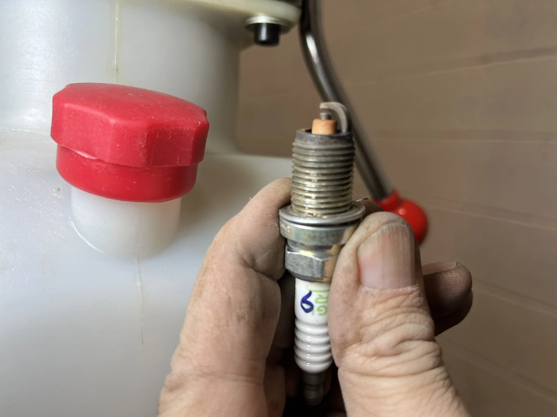

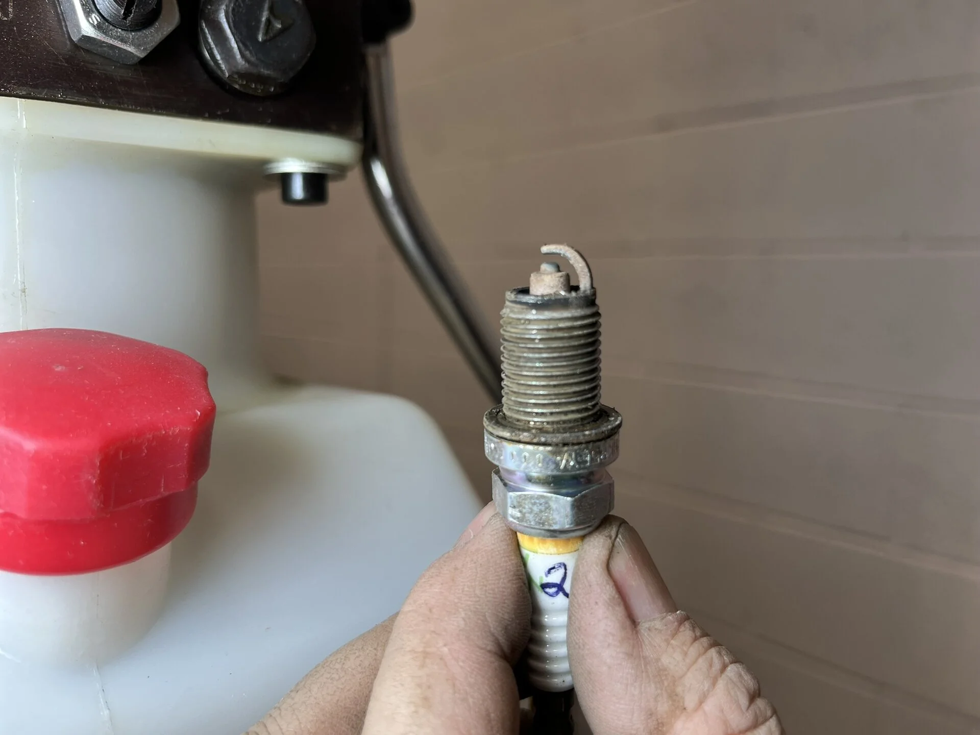

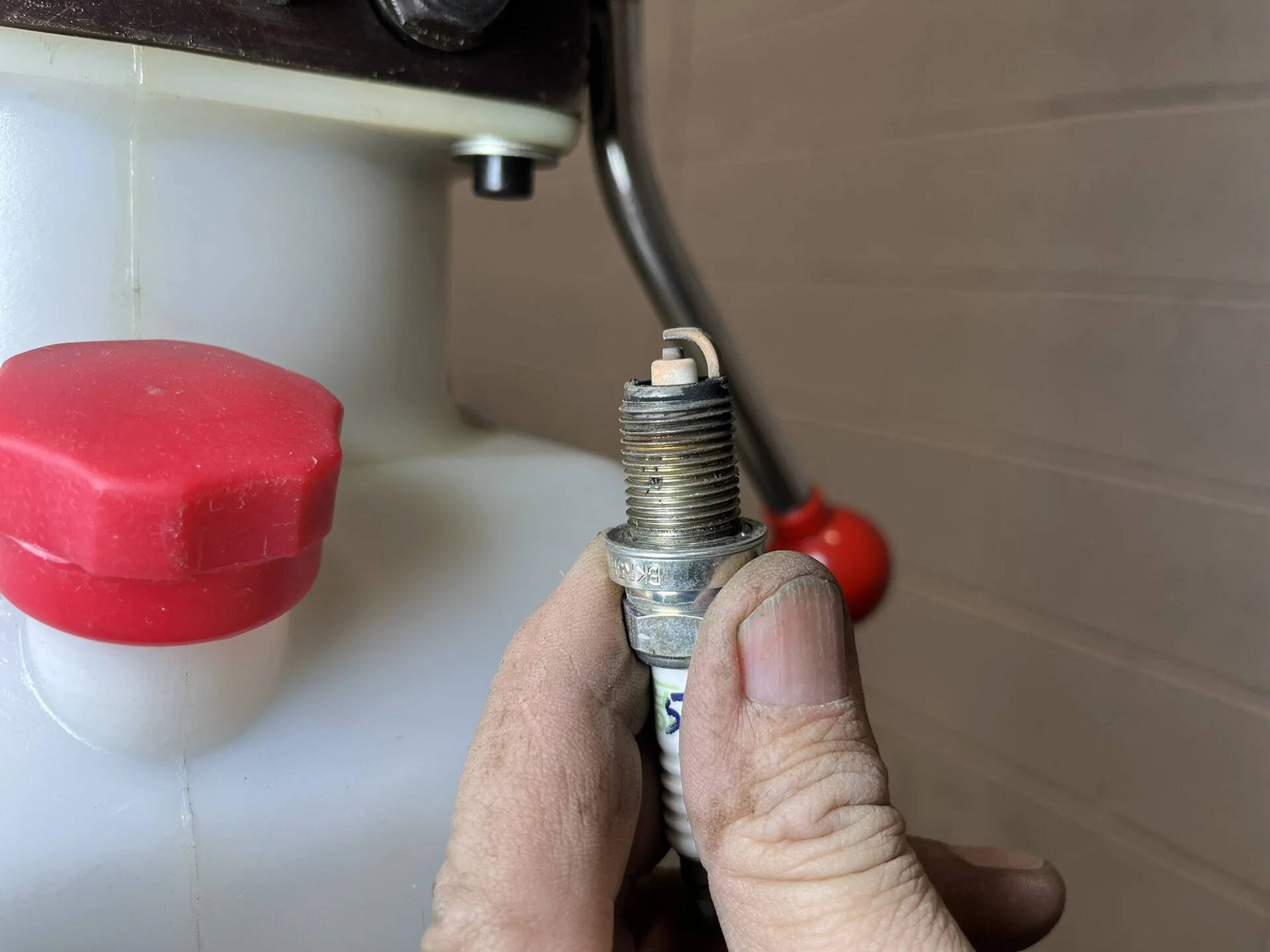

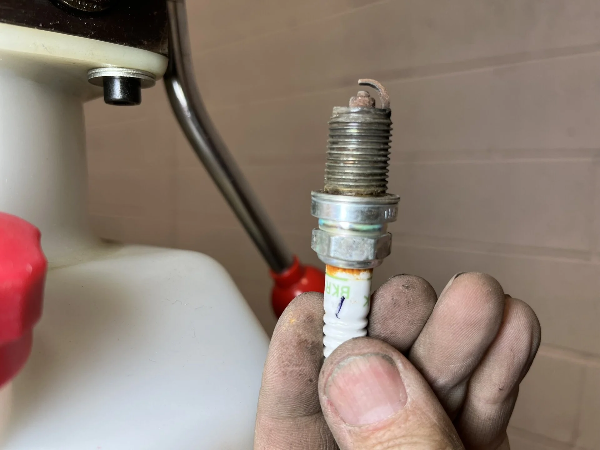

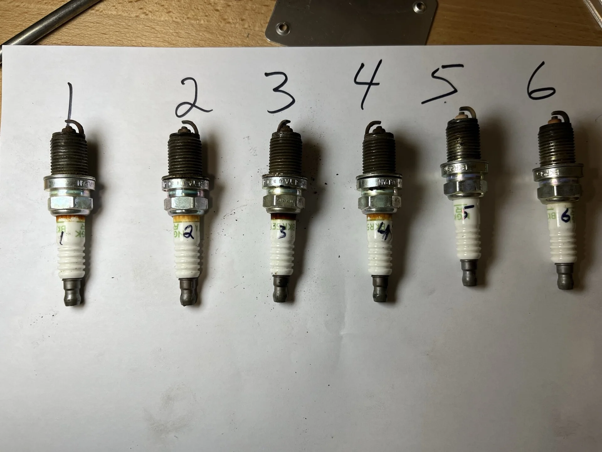

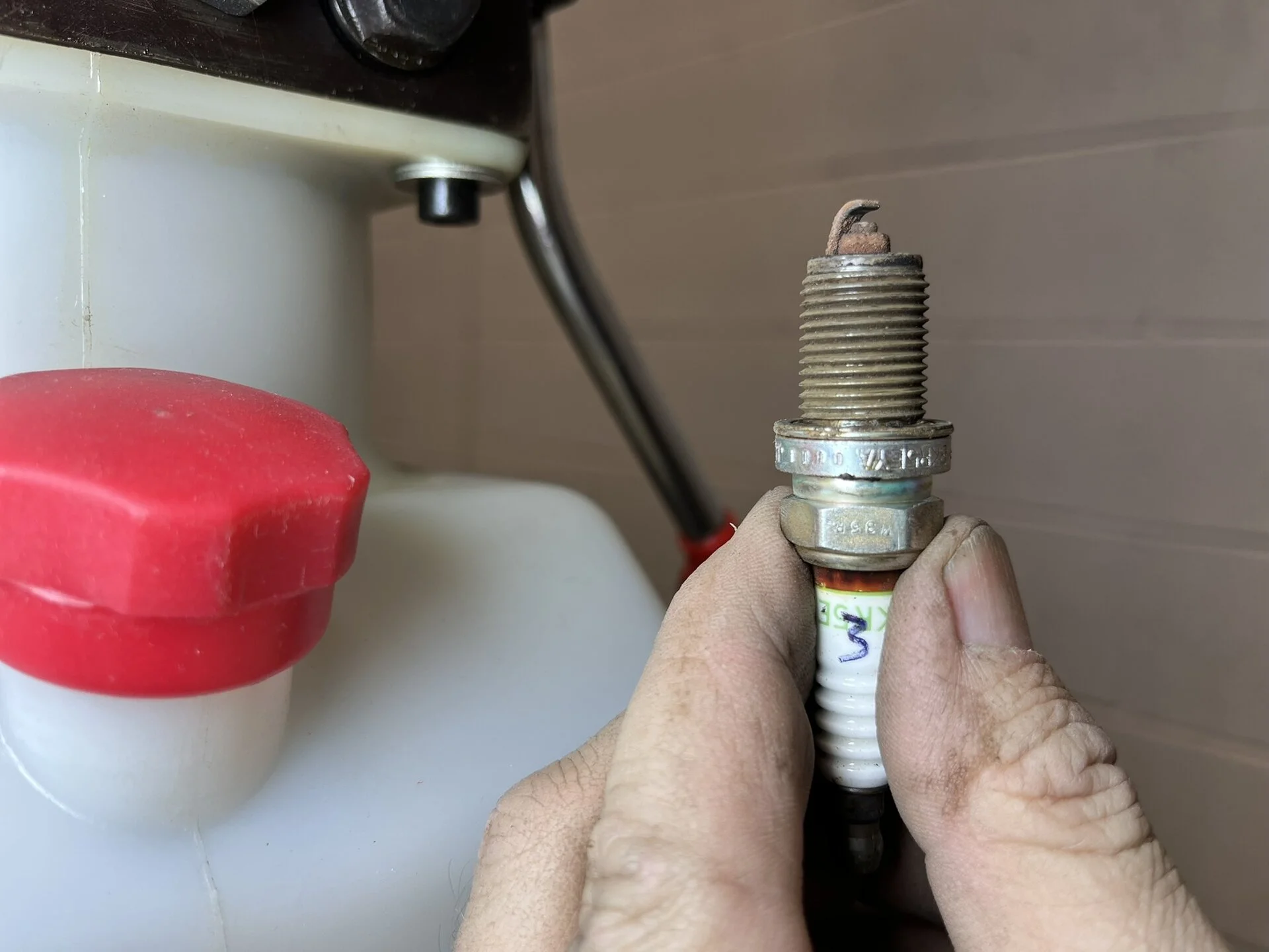

Replaced my plugs. 160k miles. I think these have around 50k miles on them but I can't remember for sure if I changed them since base lining. When I look at others plugs on the forum many of them seem to show stronger wear on the front cylinders and less wear on the rear cylinders. A
nyone know why? Here's how mine looked:

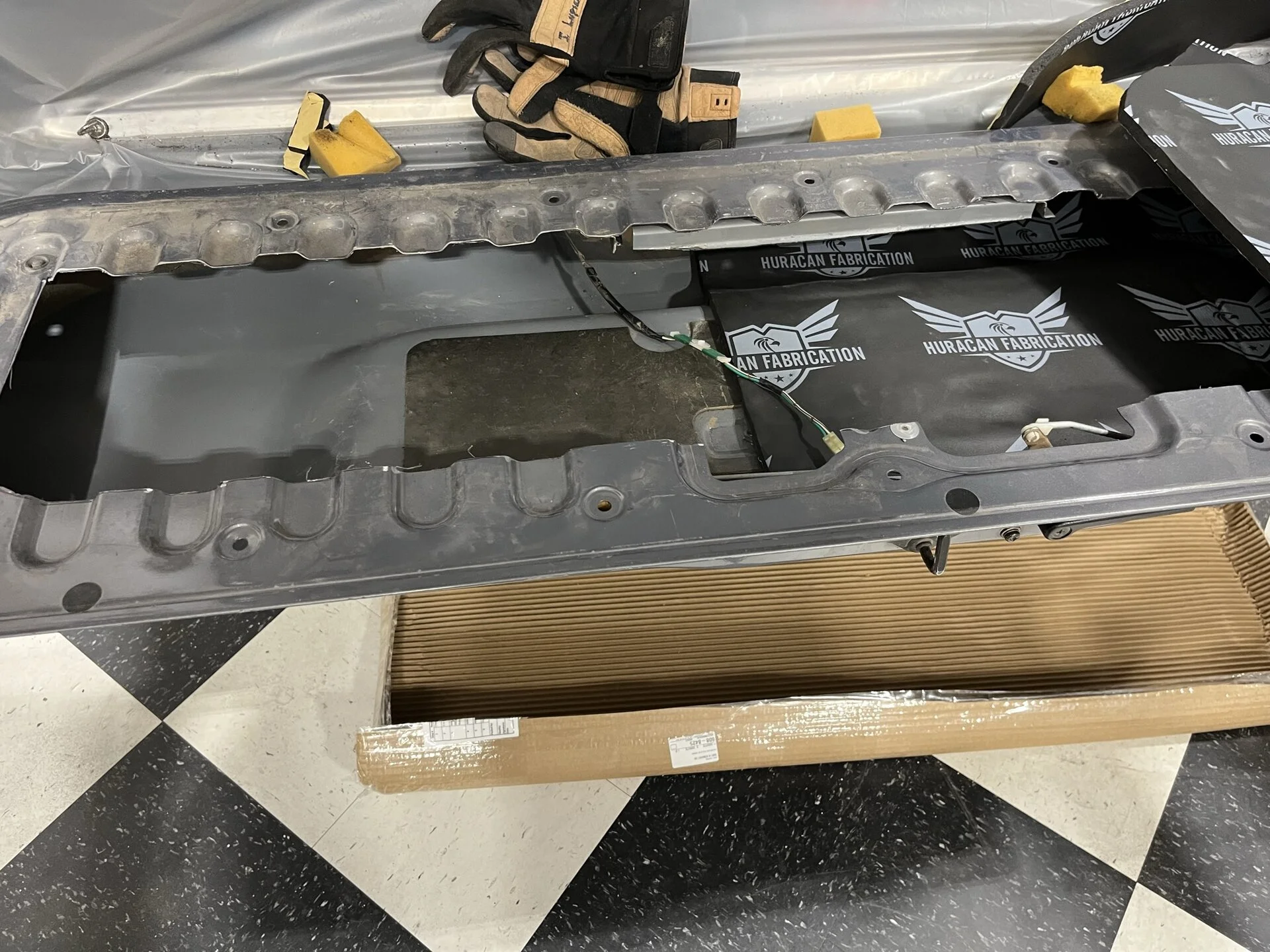

Picked up this tailgate hatch from Hurricane Fabrication. Way cool!
It comes with nice padding which was tricky to get stuck in place properly.

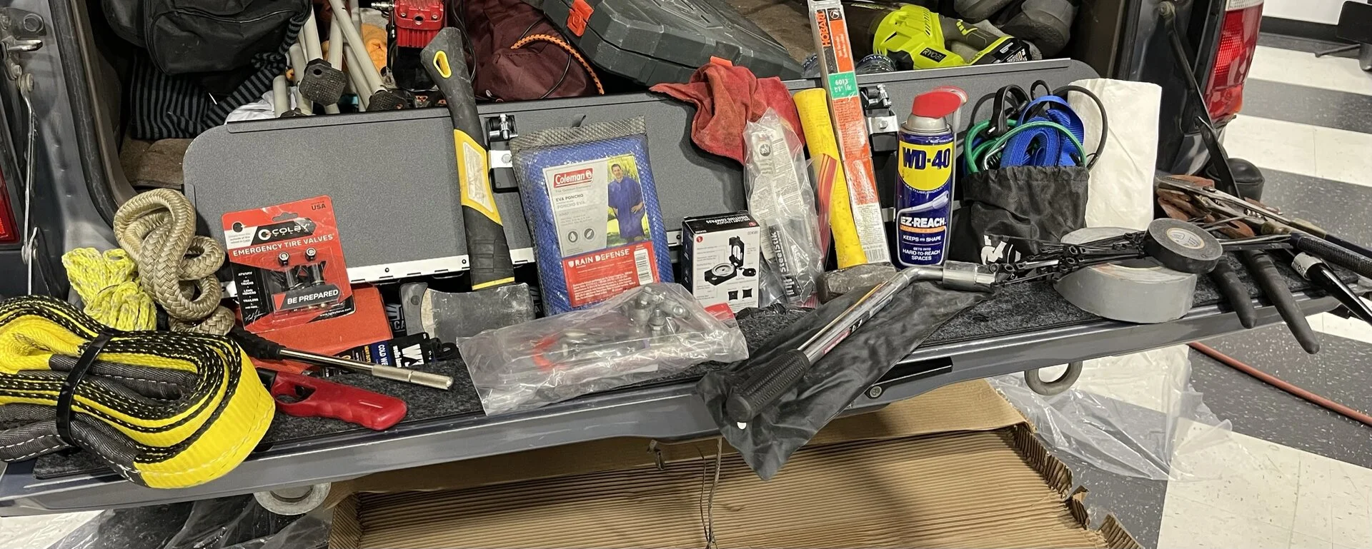

I'm able to fit almost all of this stuff in here!

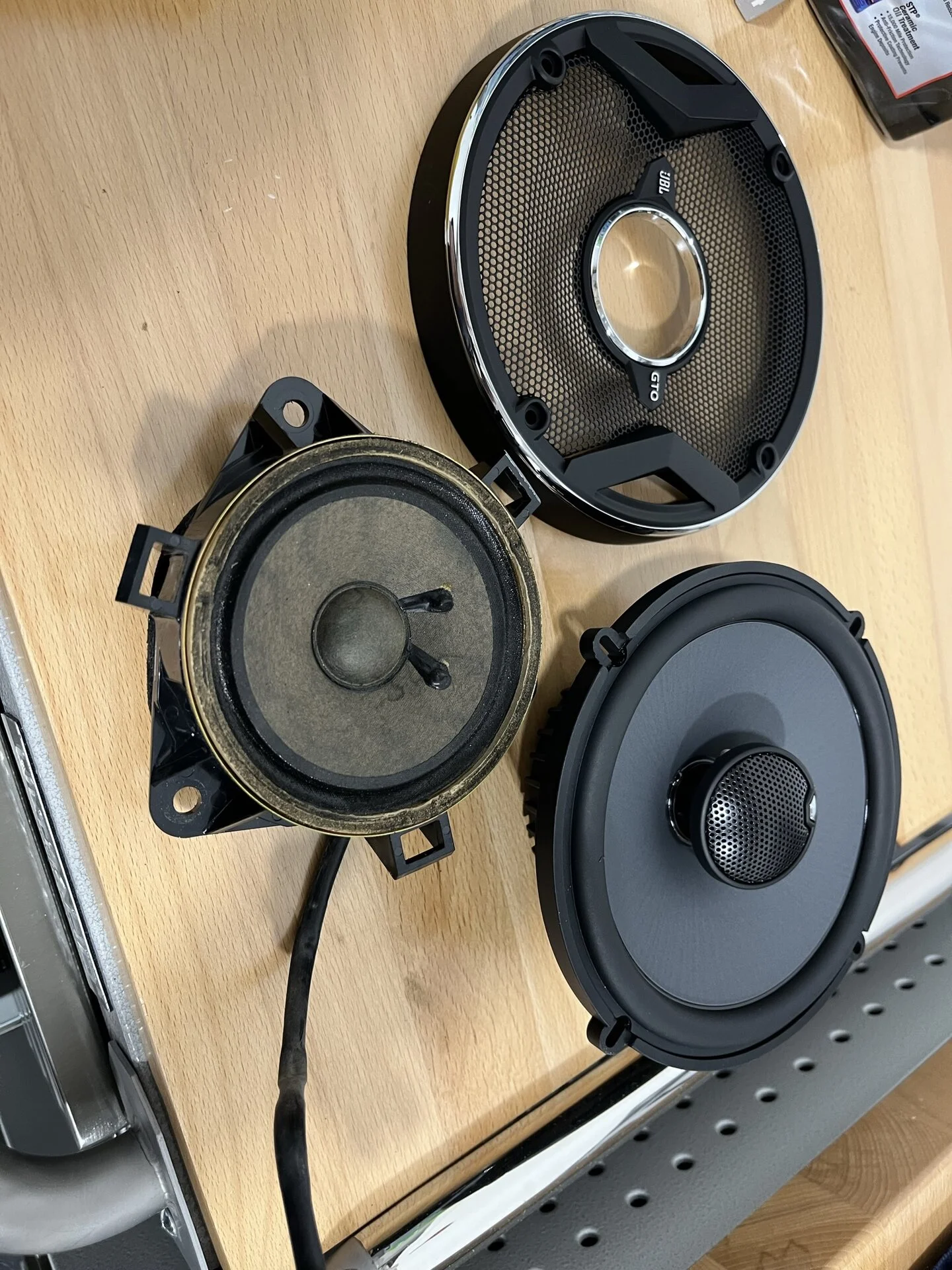

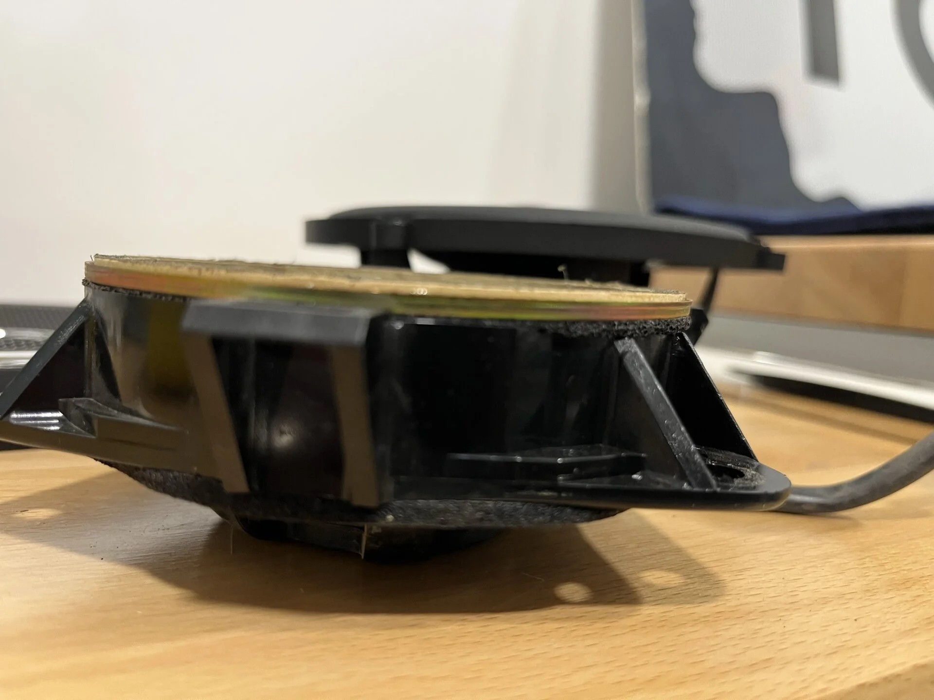

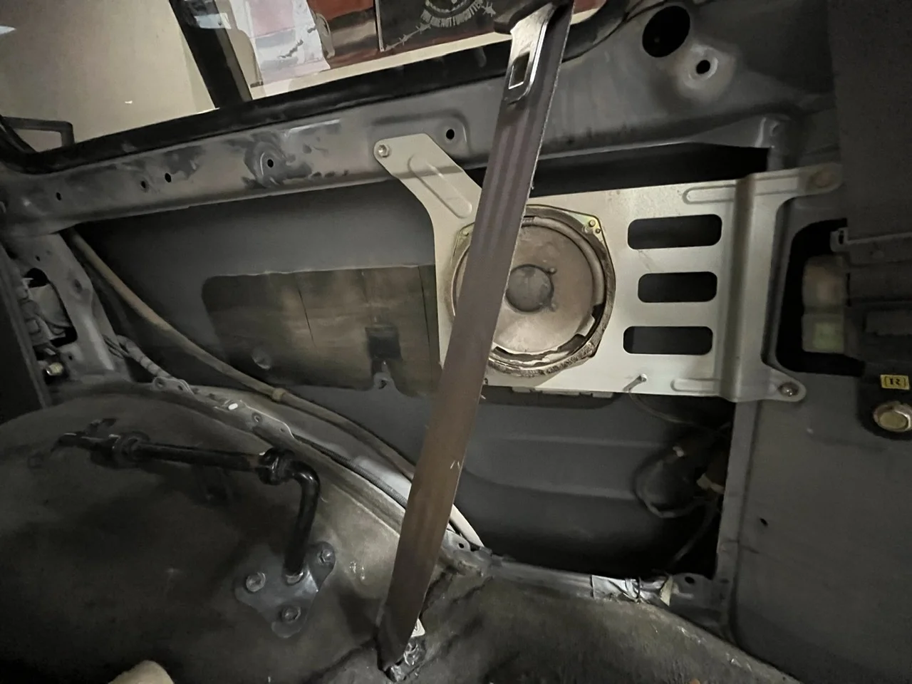

Next up - rear door speakers
Original vs. New. I will have to cut the door a little to allow for the bigger magnet and use a small spacer but these are pretty shallow.

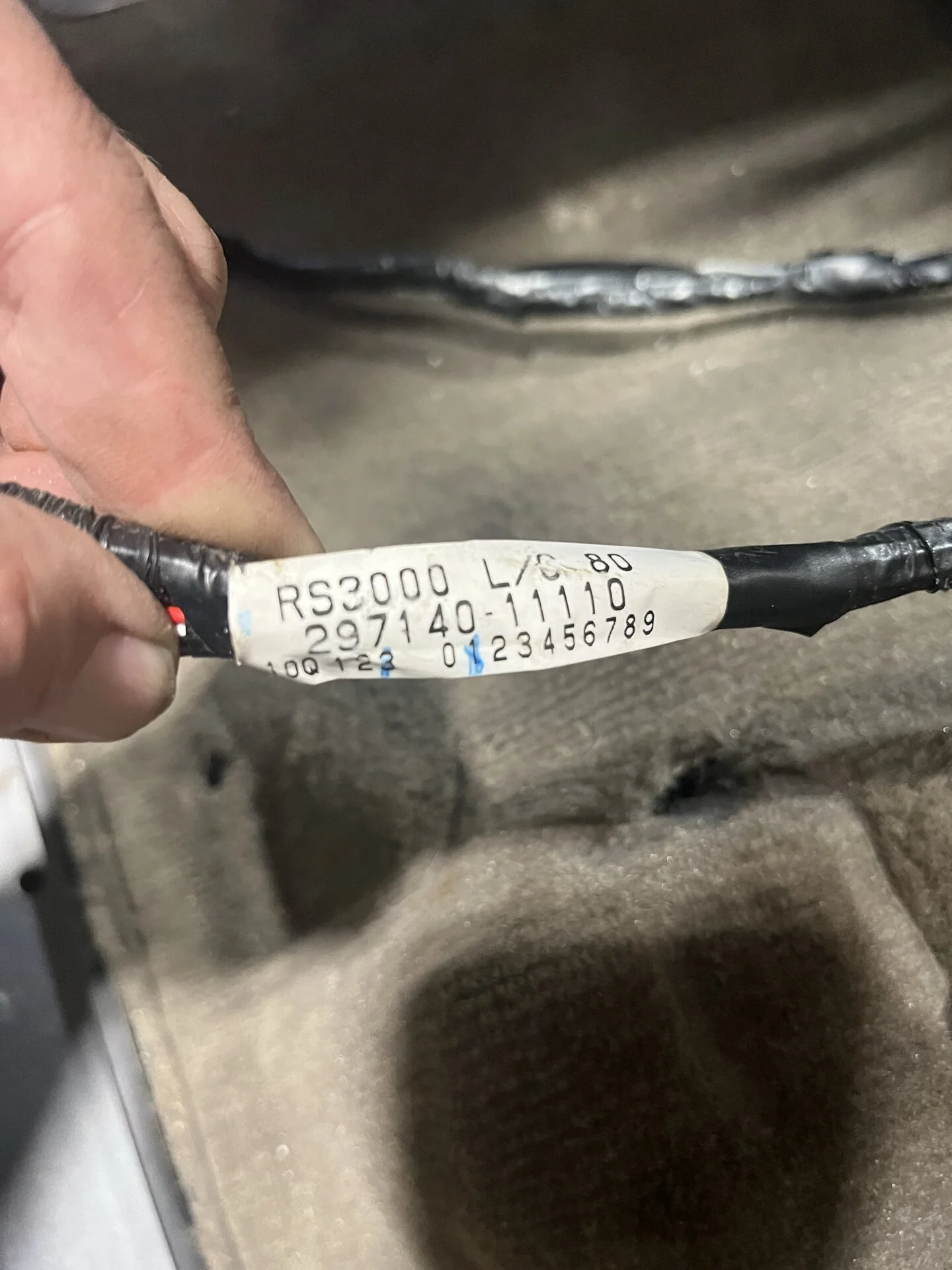

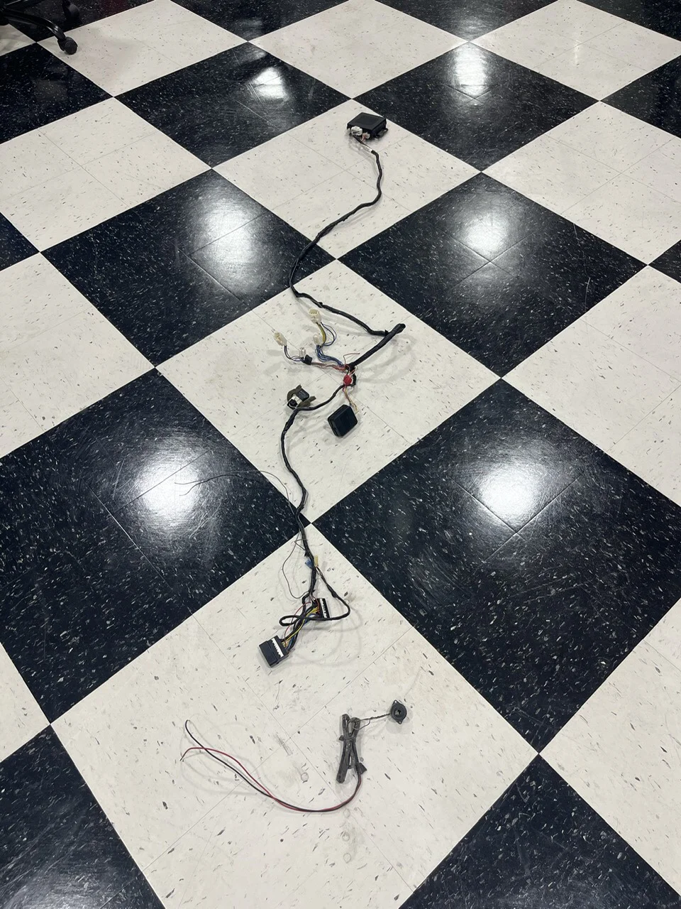

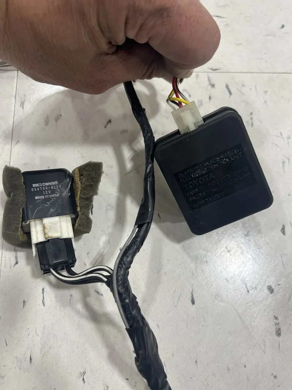

Got rid of the RS3000 alarm. I’ve had water up to my seats once before and the alarm system went haywire and I couldn’t start the rig for an hour or so. It happened again so instead of risking it in the future I put in the several hours of misery to remove this.

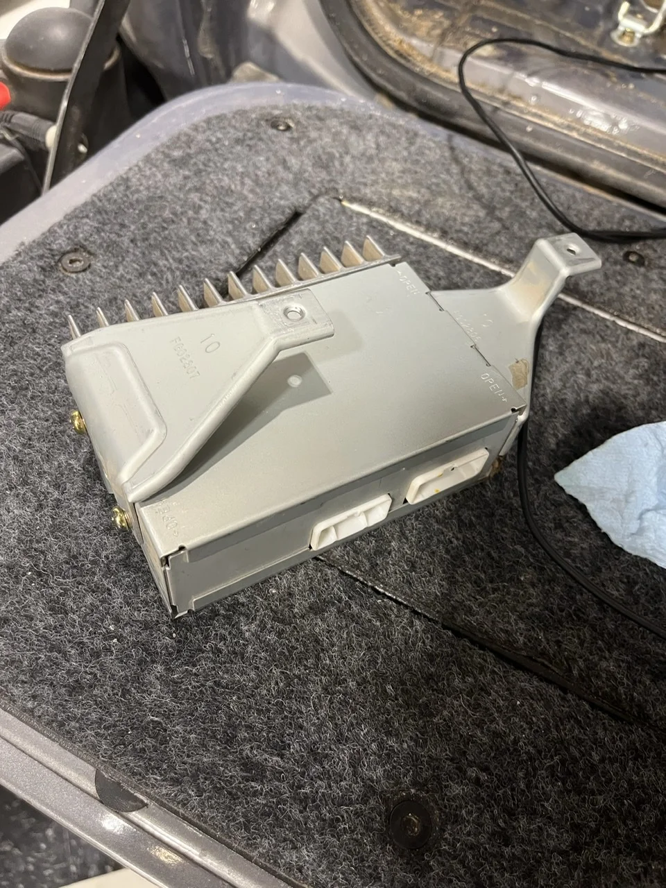

Shed some extra weight. This should help with the mileage. Old amp and rear “subwoofer“ LOL. The amp is hidden behind the speaker next to the glovebox. I got rid of those speakers too.
Can u post a pic of the fob? Mine has it but no fob. There’s a aftermarket one laying I. The door when I picked it up.

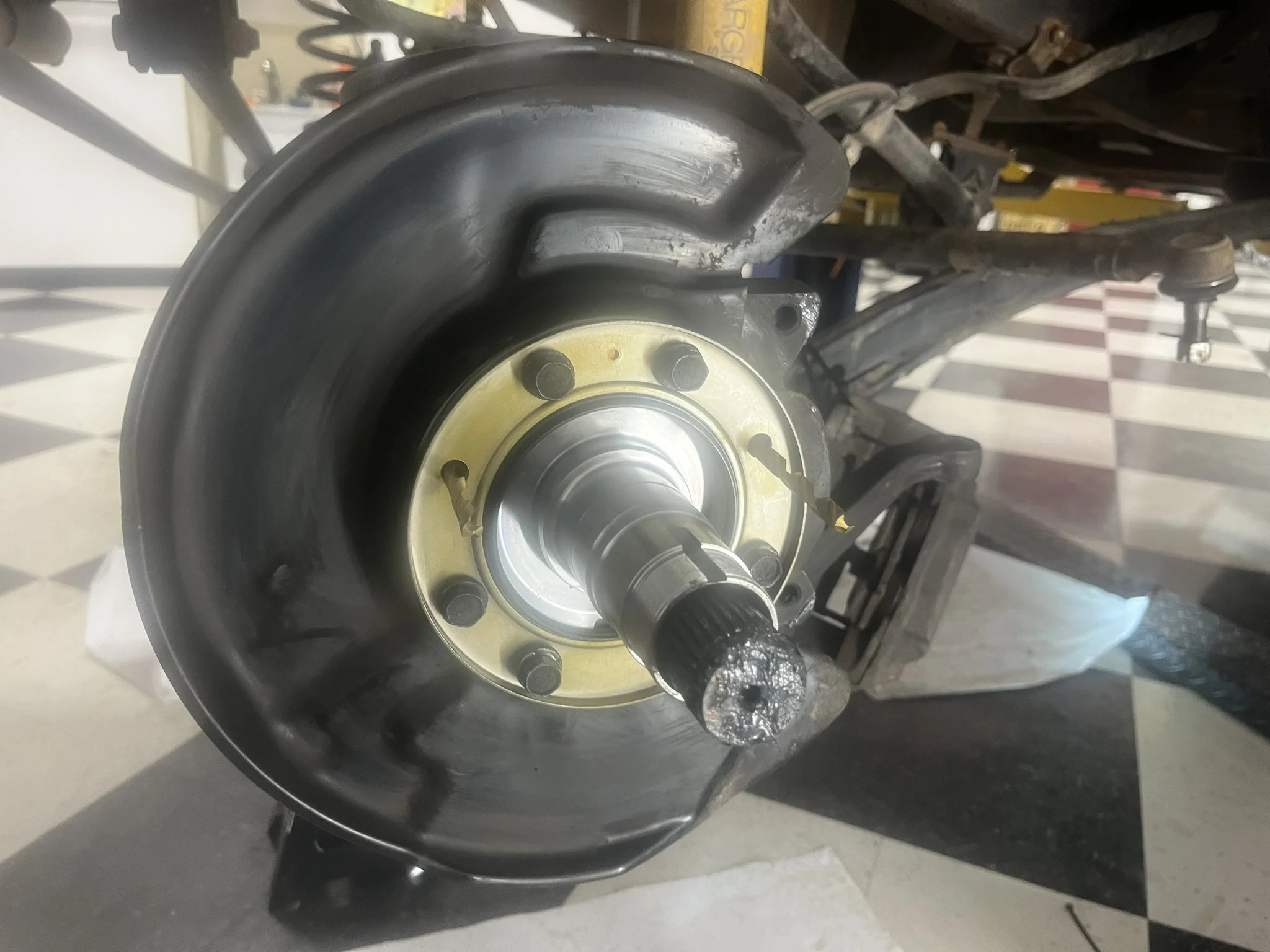

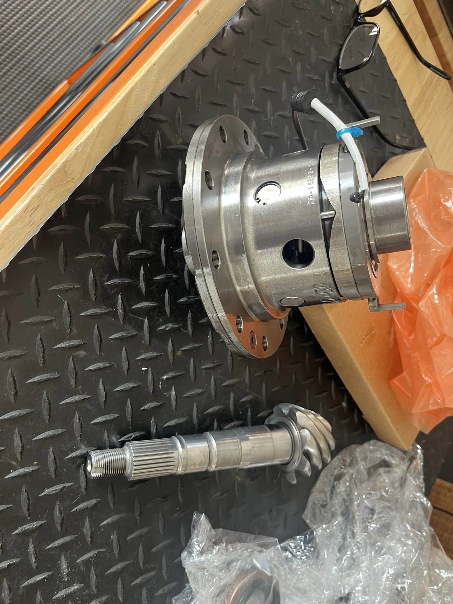

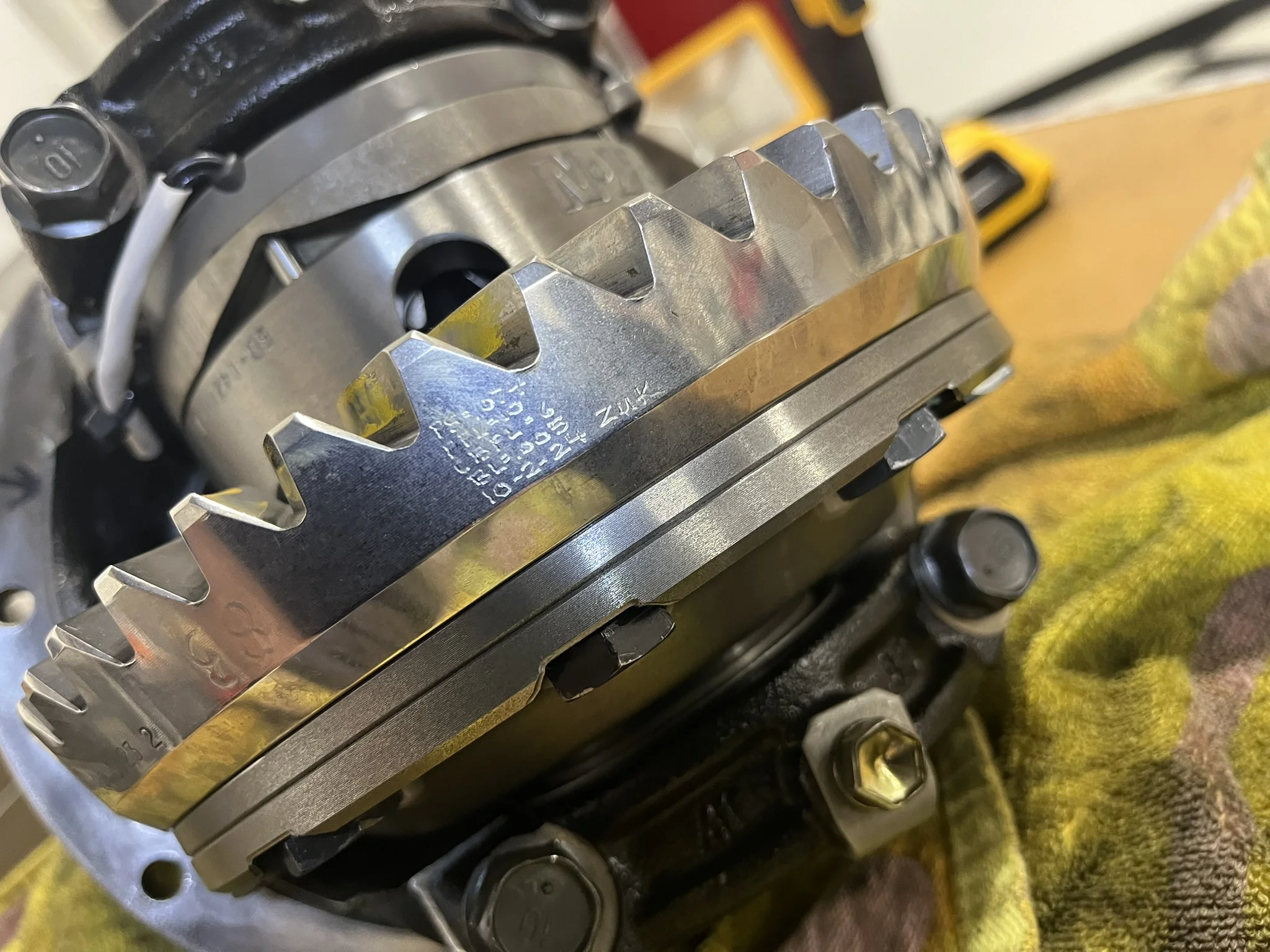

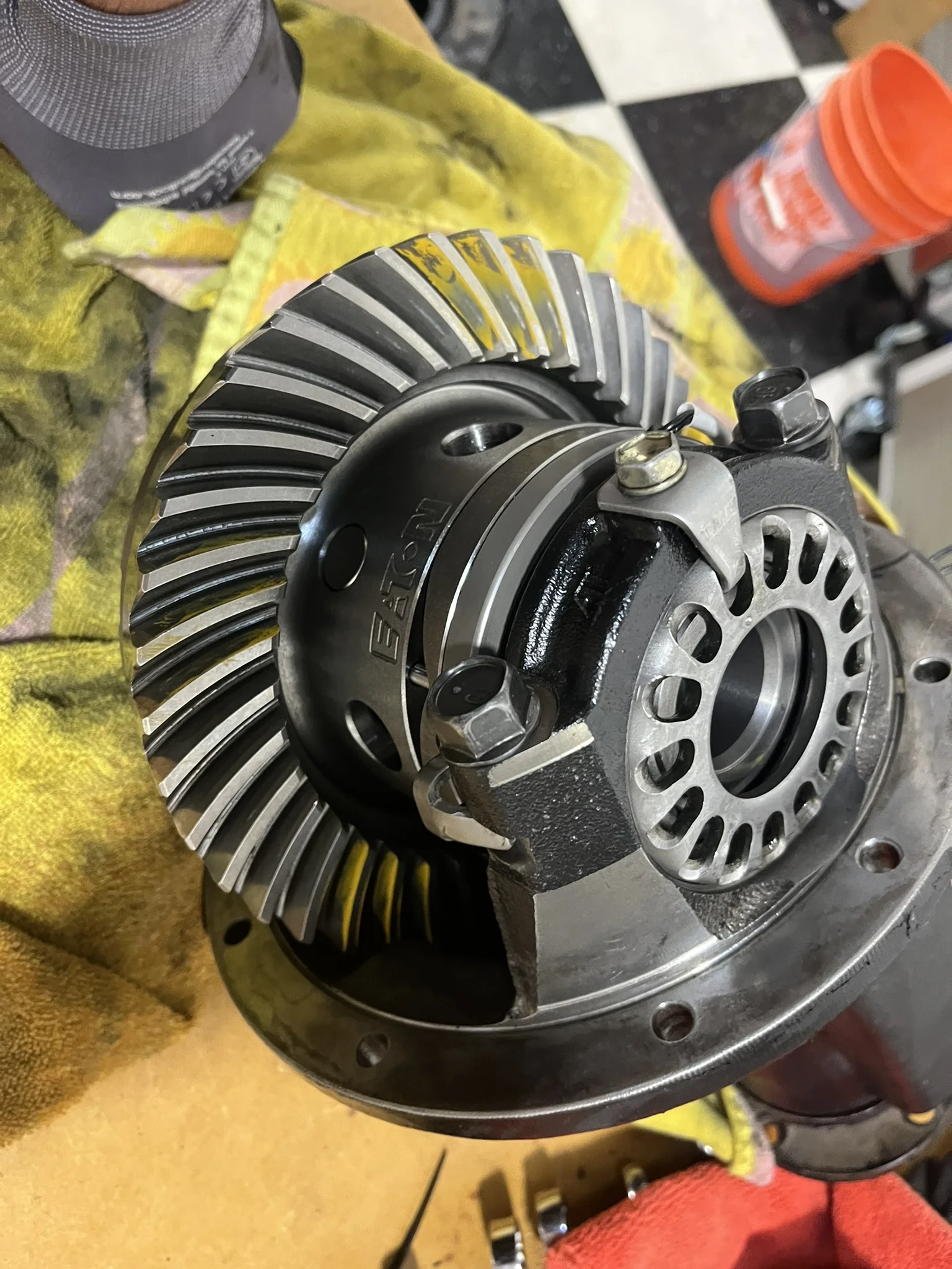

I'm behind on my updates! I had my transfer case re-geared in March with the 3.1:1 low range reduction and the 10% Underdrive gear set from Cruiser Outfitters. Then a couple of weeks ago I had everyone's best friend Zuk hook me up with some sweet gears for the 3rd members. Went with 4.88's. These are from www.revolutiongear.com and have the optional "super polish". I already had an Aussie Locker in the rear and added an Eaton E-Locker to the front. Finally got it all put back together with a fresh birf setup as well. Excited to wheel a bit this weekend.
Birfs back together with new spindles. I replaced one of the hubs as there were some scratches in the metal where the bearing races go. I didn't want to chance it.
Lots of parts and pieces. I never want to do this job again but I also wouldn't trust most to do it. It just takes patience. Lots of good youtube videos on this procedure.

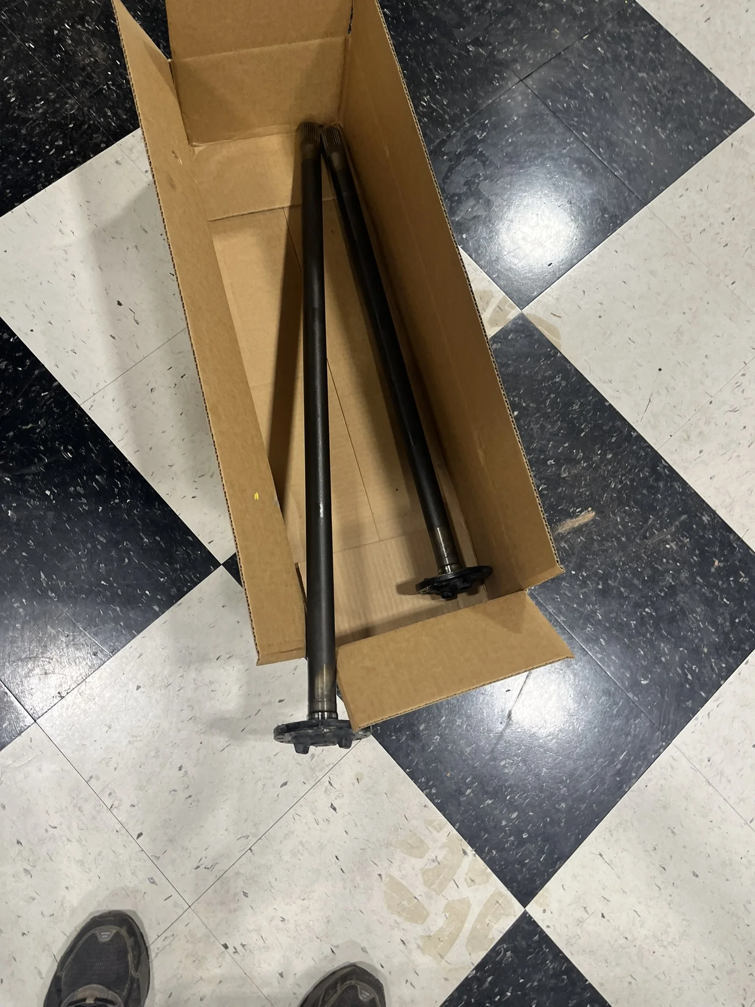

My front and rear axles looked good. No wear or twisting on the splines. I don't have good pics of this.
