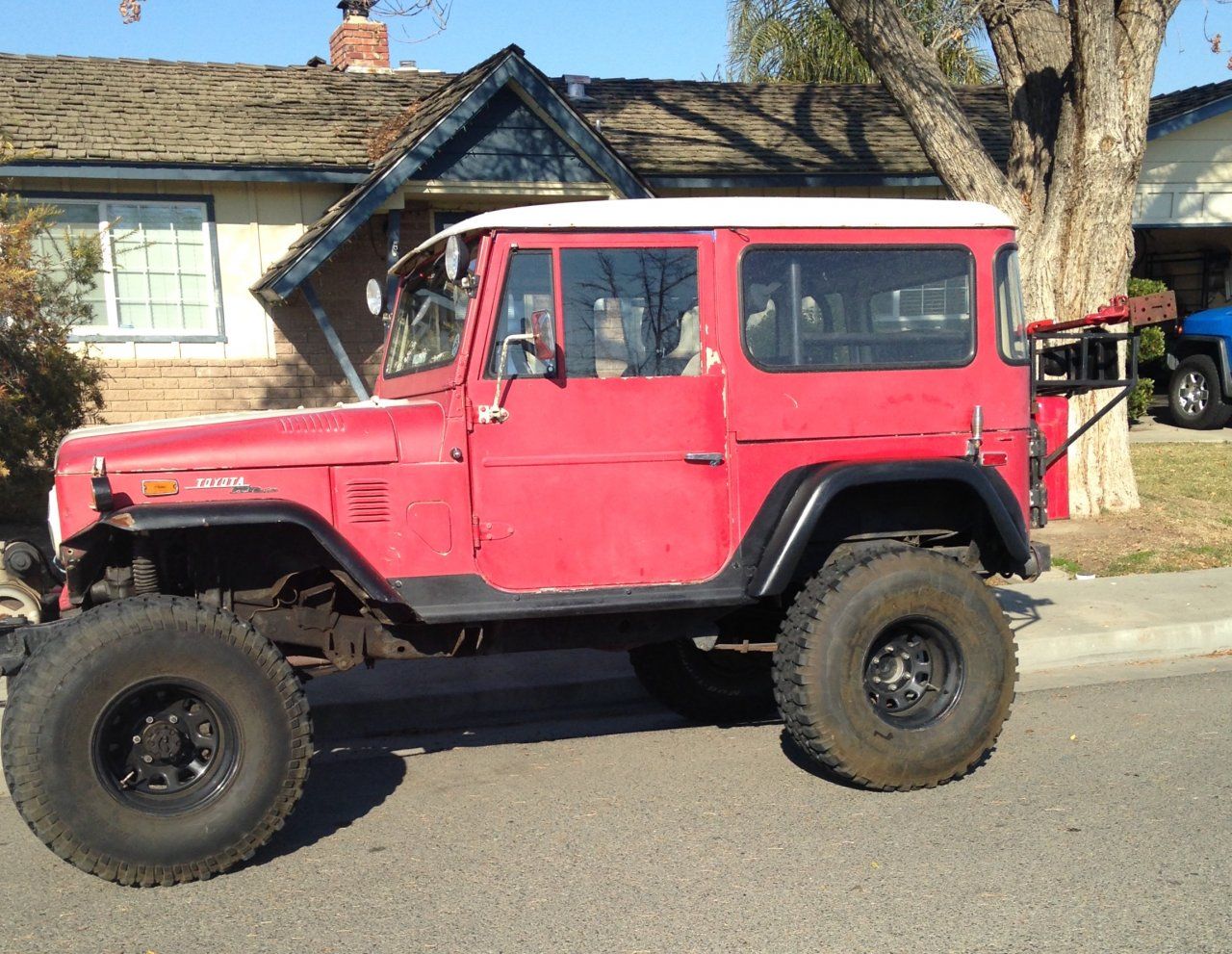

Give you an idea. Flipped and Flat SOA with leaf removed and TJ flares I put on today got tired of rooster-tailing.
I also run 37s but they are bias super swampers. Not great for on road. Usually only run them in the summer for trails and so I fits in the garage. Your seeing 35s in the pic.
