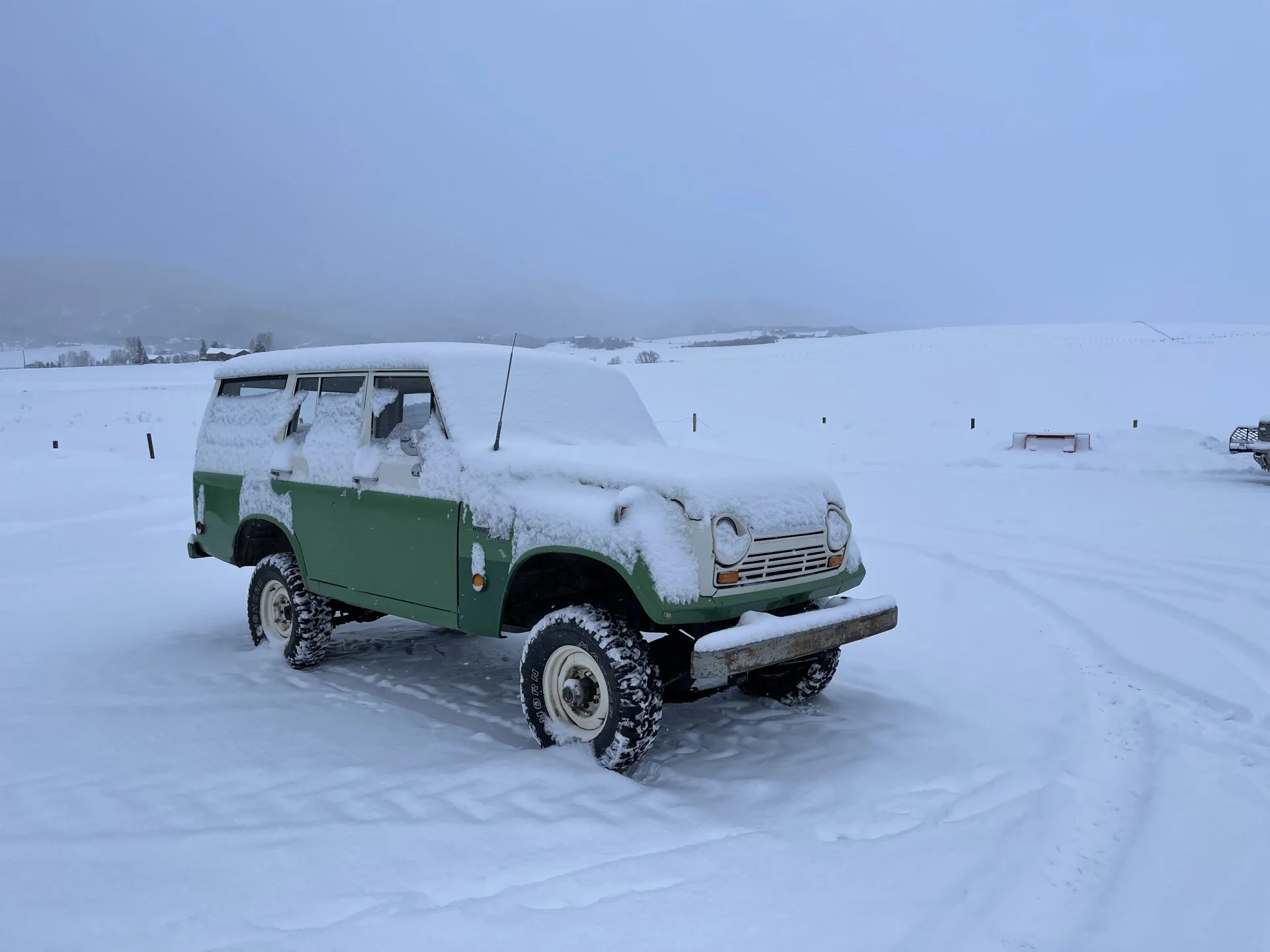

Sadly I had to leave the 69 PIG outside last night due to son working on his truck in my shop.
I hardly slept thinking how it wasn’t right to leave her outside. Well then in the cold this evening and charger on battery for several hours (after failed starting attempt) she wouldn’t start.
Who knows how far off the original carb is coming from South of Bend Oregon to 6800’. Battery on charger and gonna give her try tomorrow but it gonna snow tomorrow and I’ve got to work.
These F engines normally little finicky in the cold?
