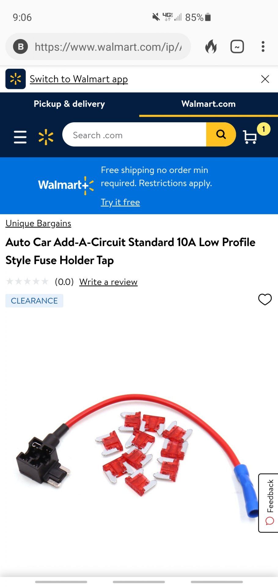

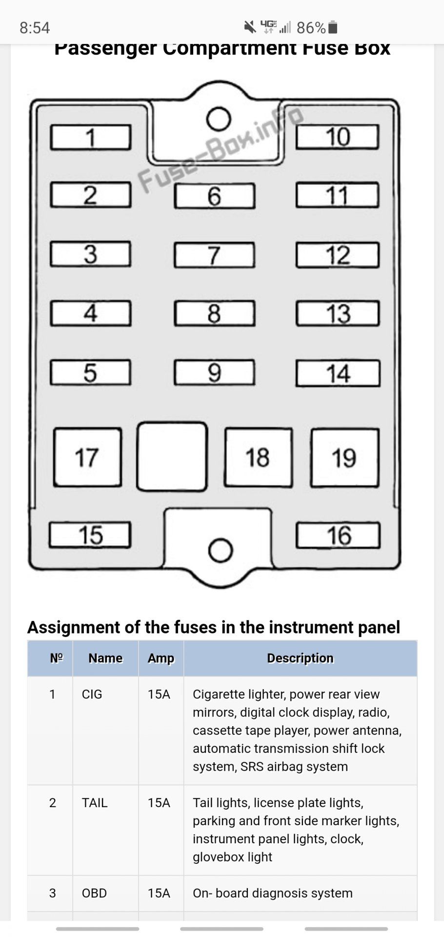

Hey all,
Thanks for the great info so far. I am attempting to wire up my "light (blue wire)" and "Ignition (orange/yellow stripe wire)" for my arb compressor switch. Curious what sources people tapped into. Maybe the dimmer switch or mirror adjustment panel. Or is it better to just use a fuse tap and go straight out of the fuse panel? I was thinking either 15/16 empty fuse slots or 1/2 fuse slots.
Thanks in advance.
