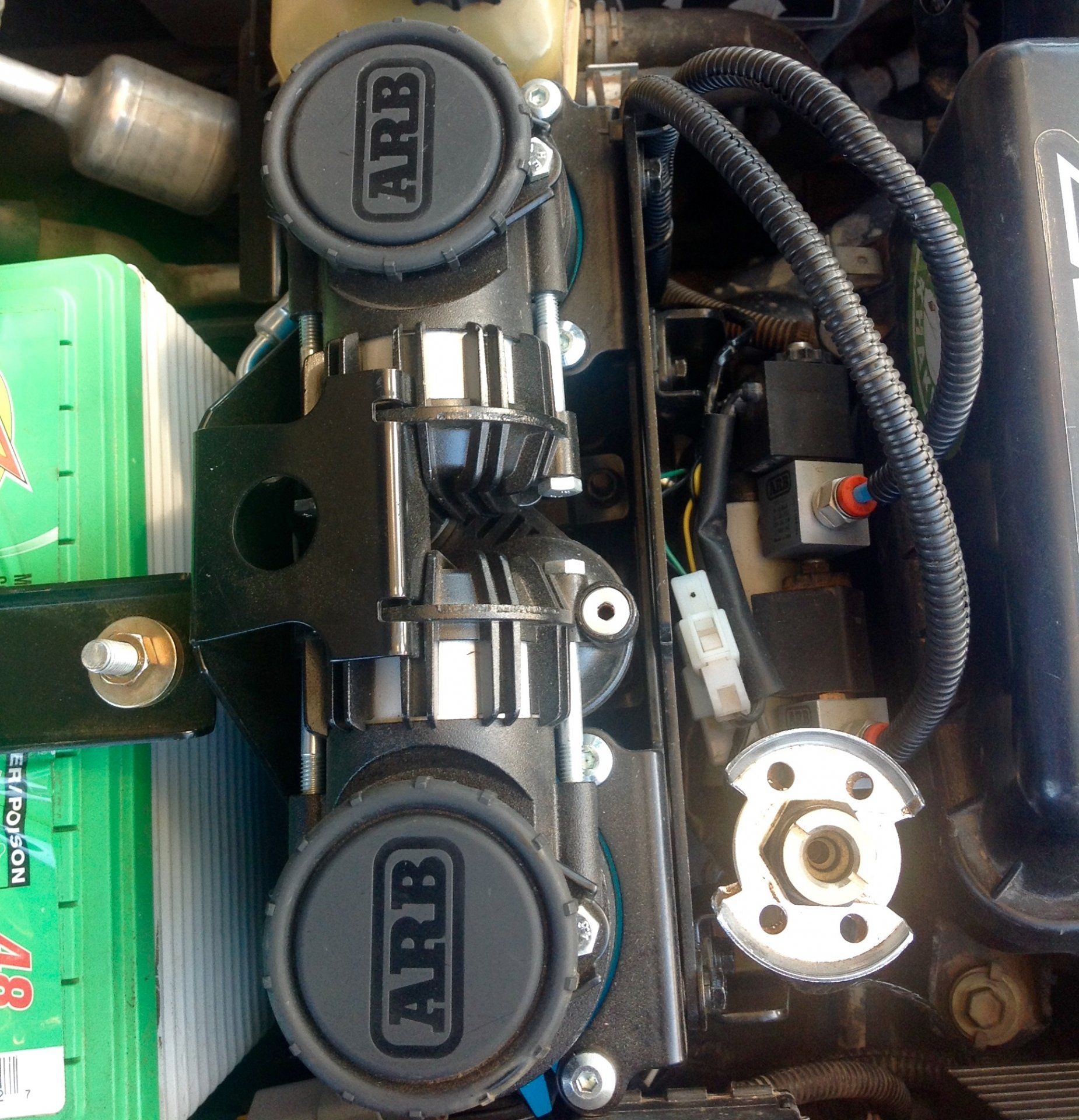

It is a tight fit with the manifold and both solenoid switches for the lockers, but once it's in, it's very rigid and not going anywhere. Haven't had any issues.
I'm sure glad I remembered your post on this thread. I don't know if or when I'll do air lockers but if I do, the solenoids and switches will be in place.
