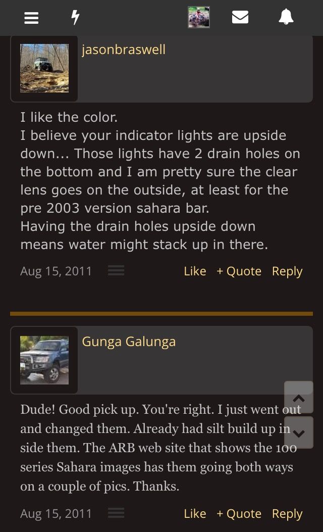

BTW
I was looking closely at your signal lights and then checked mine - I think we both have ours upside down !
I compared ours to the ARB photos and did some googling and came across this:
BTW
Haha! Excellent catch. I actually choose to put them in that way. I figured it made better sense to have the signal on the outside and the running light on the inside, similar to the layout of the headlights.

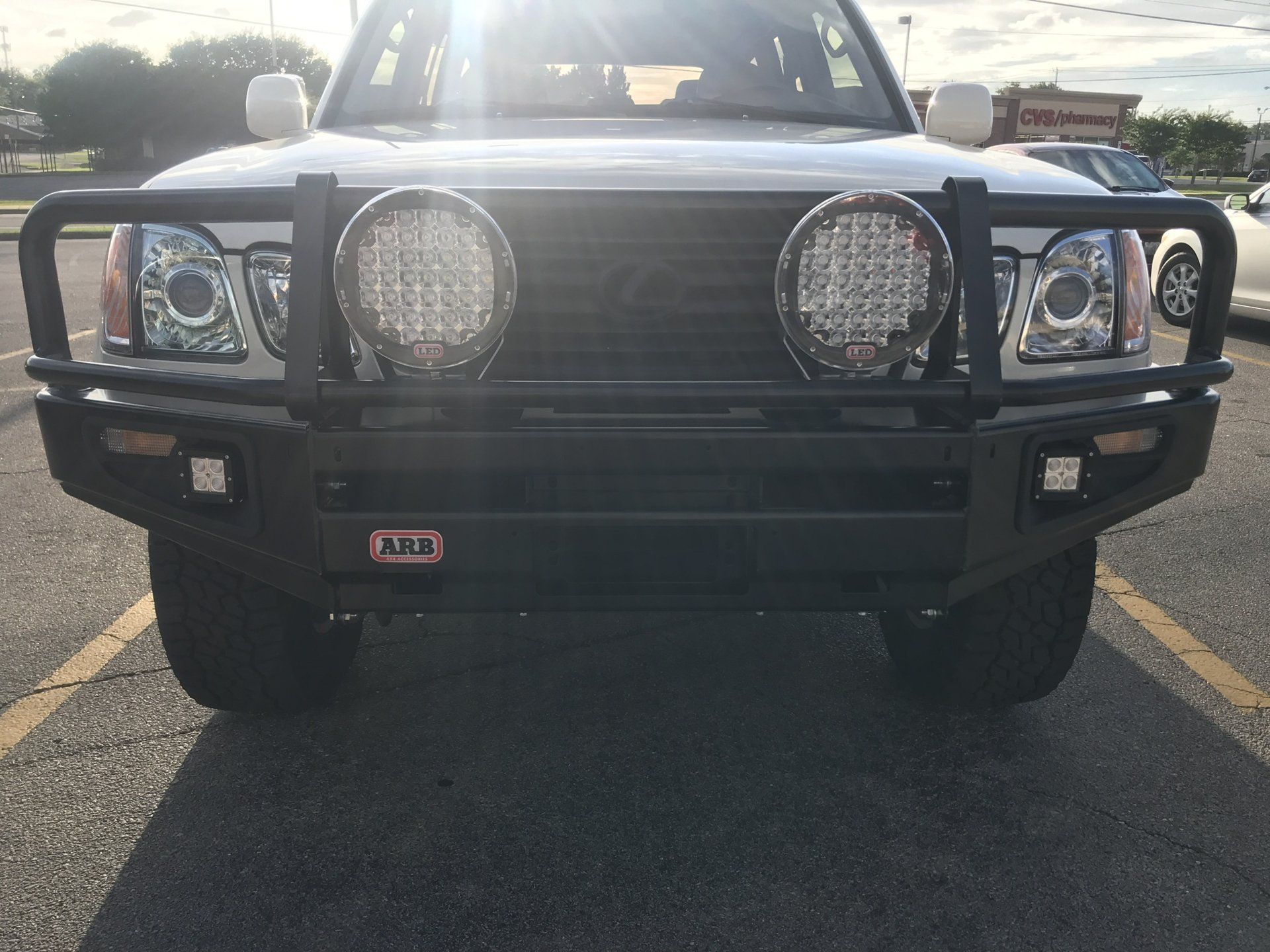

Here you go. I just trimmed the light housing and drilled some holes. The arb side is completely unmodifed and there’s no glue should I ever decide to change lights in the future. It looks like that glue method allows them to sit more flush however.
View attachment 1635022 View attachment 1635023
Please post pics from the front. Getting this done this weekend. Thank you.

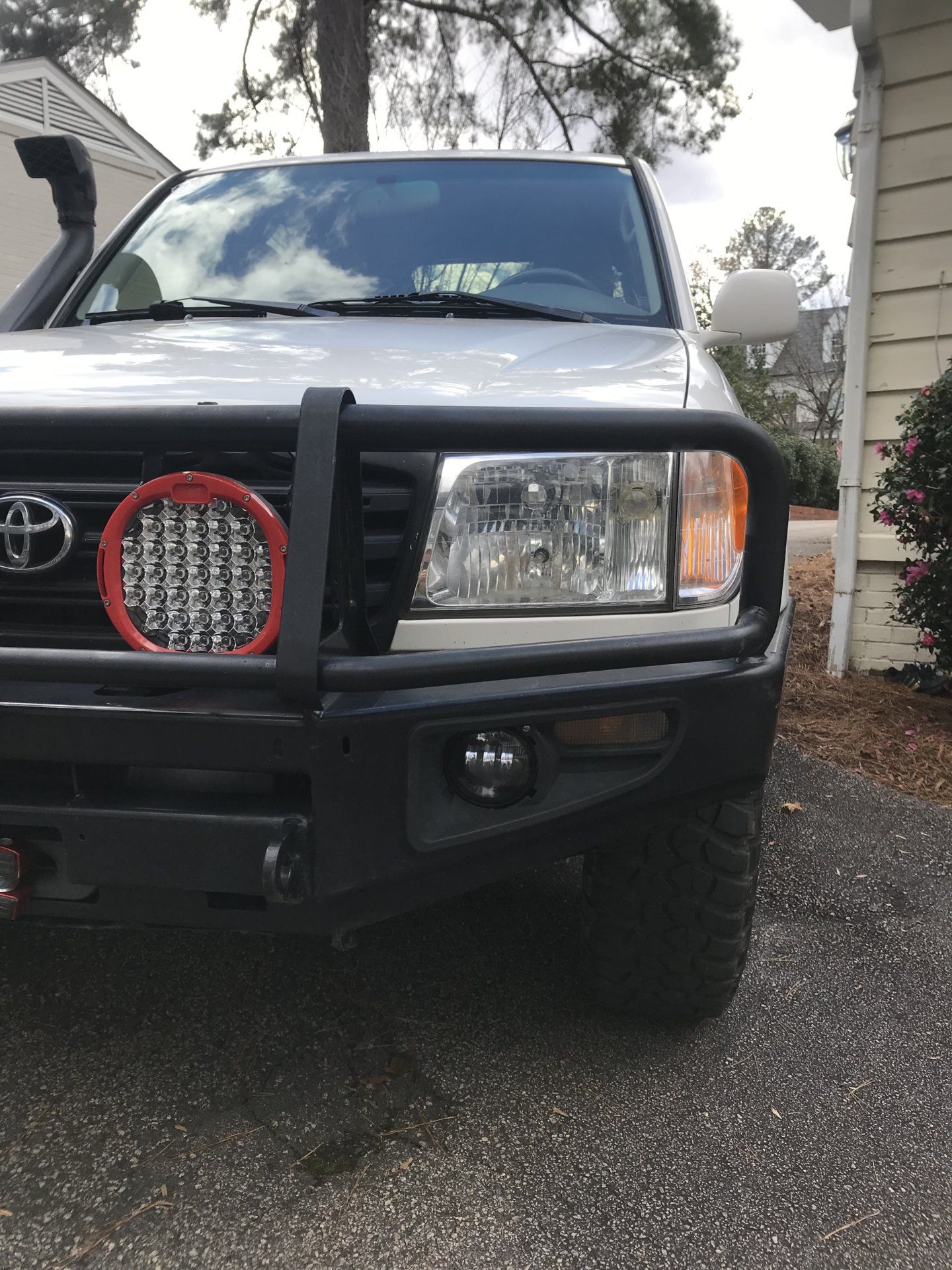

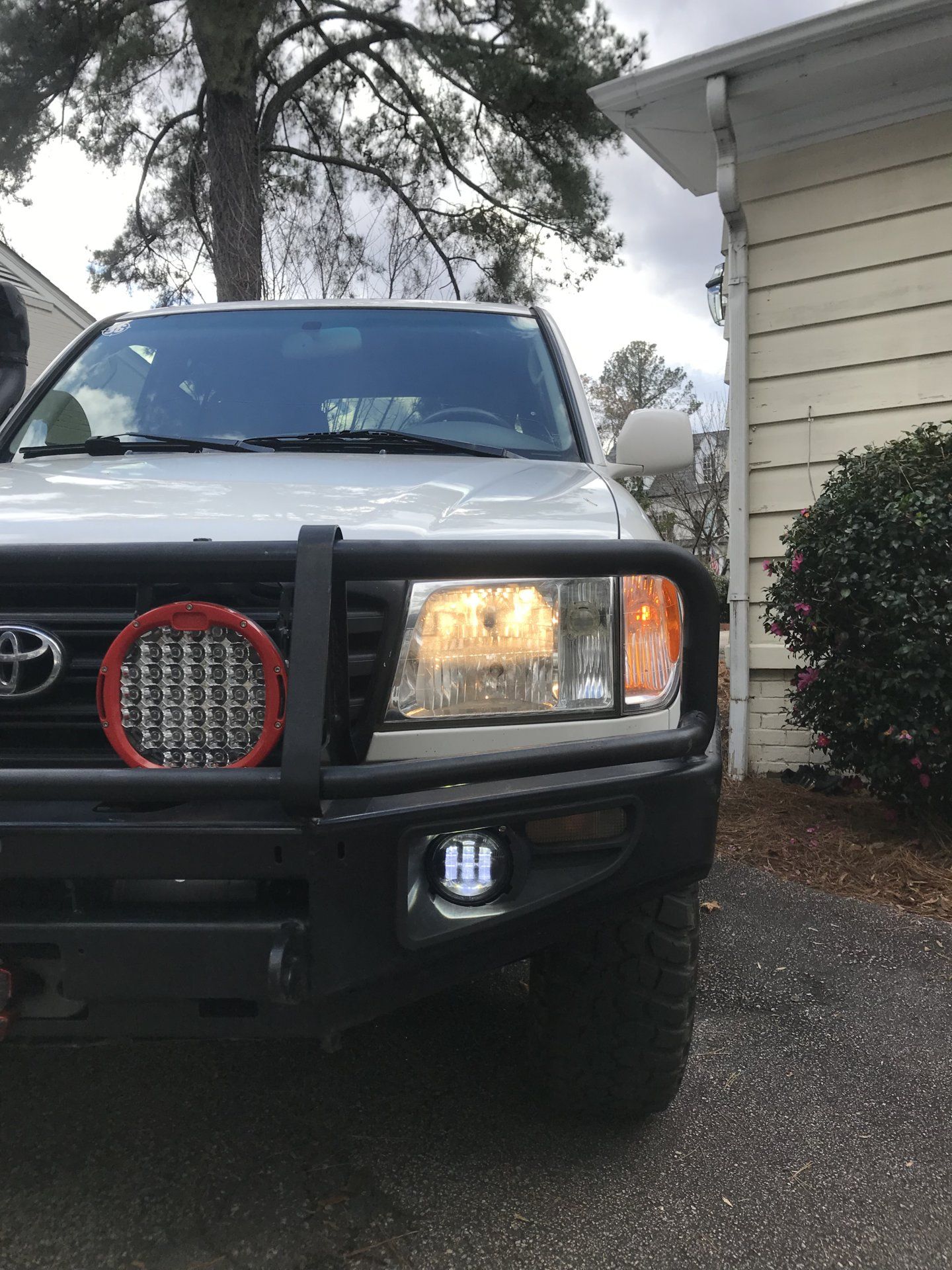

@FranceJohnson thank you for this suggestion. Installed today and look incredible. Ready for night time.
I used the @Xetabur install Method found a few posts back. Thank you for the ideas. Lines up nicely.
Best 30 dollar mod available.

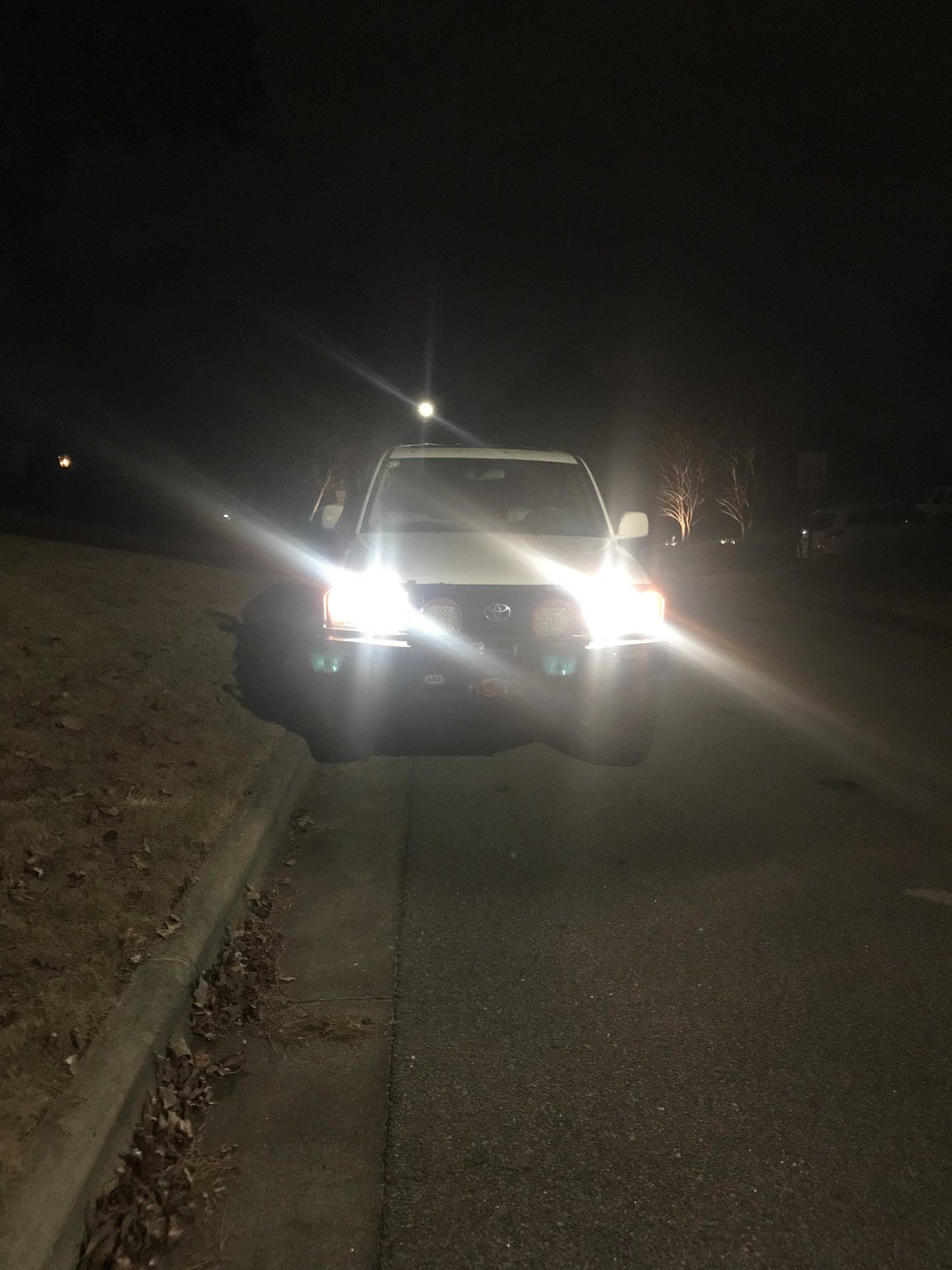

looks good. output shots for others looking to do the same?
edit:
I realized I never posted pics of mine after I used the nut and bolt method.
Do you have any night time pictures? I installed this other set of cheap Amazon LED lights and their light output was pathetic.

Two more
Pretty good for 30 bucks.
