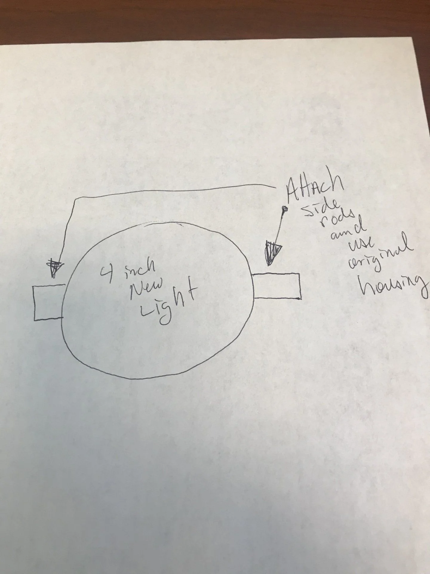

I looked at these last night. Could u mount two side rods on the new lights (like the original) and use the original housing?

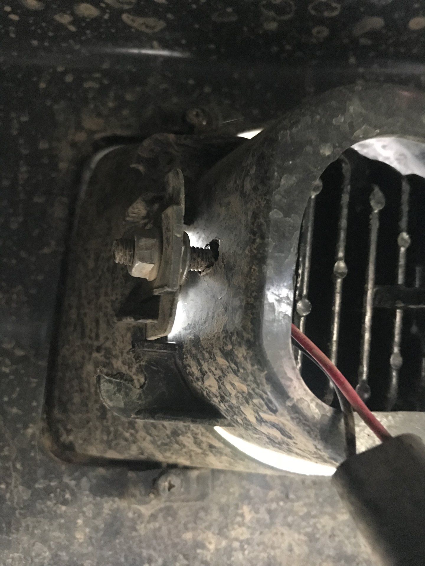

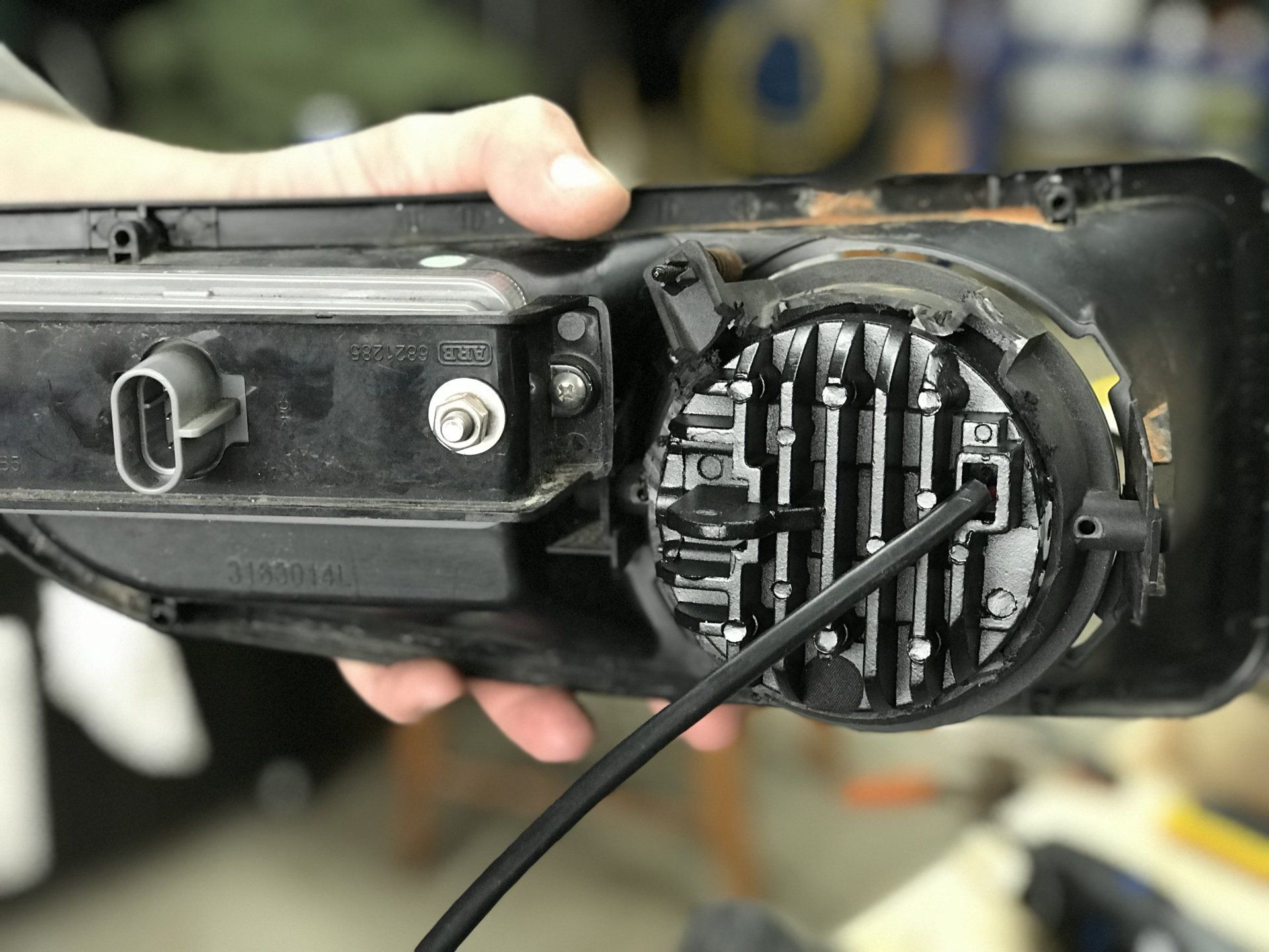

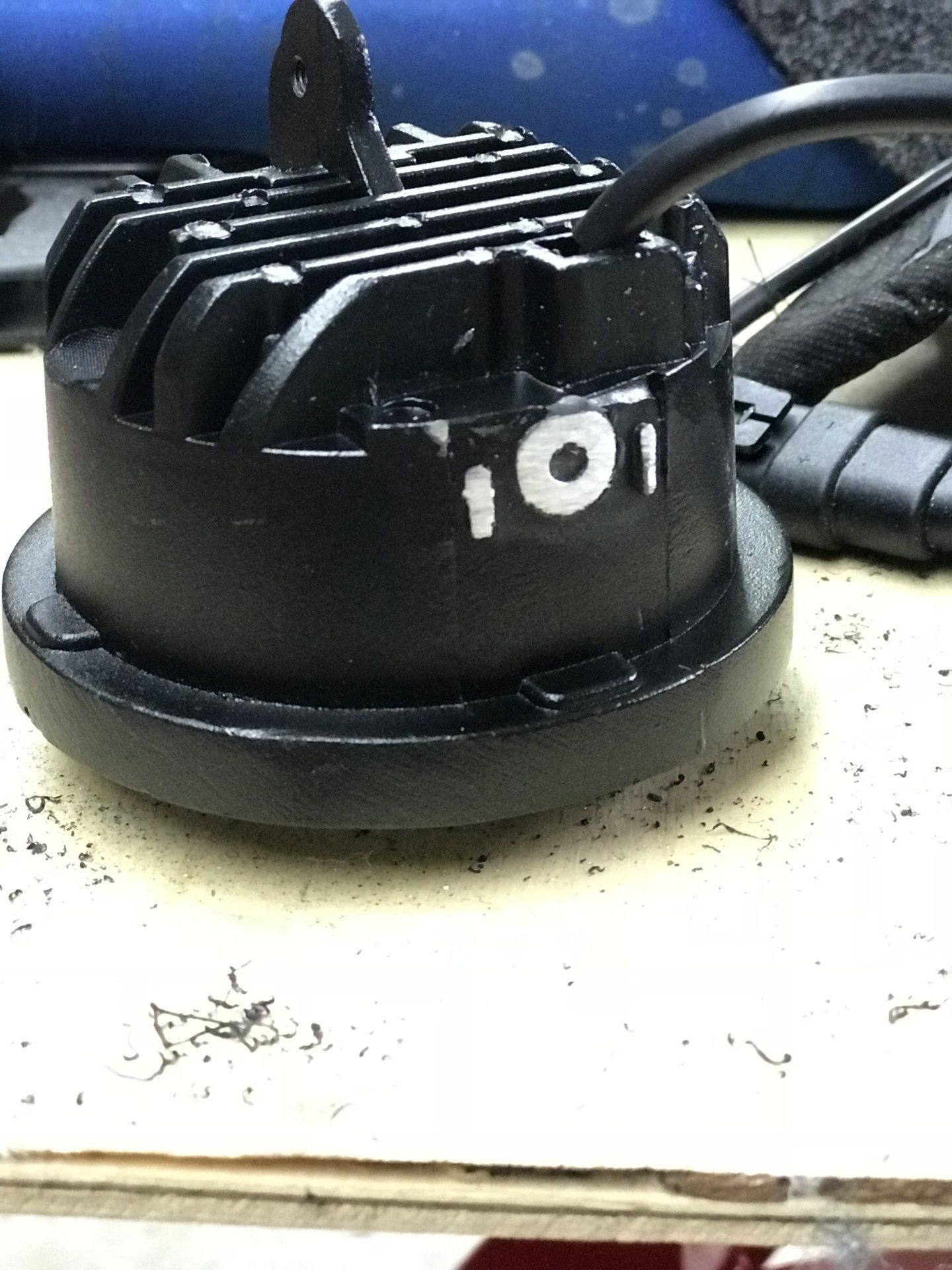

I like the lights, so I got a pair. Then I removed all the plastic junk and drilled a 3/8” hole through the heat exchanger. An all thread bolt through the ARB light holes and through the new hole in the lights, a few nuts to keep the lights from turning down, and now the lights are solidly in place.

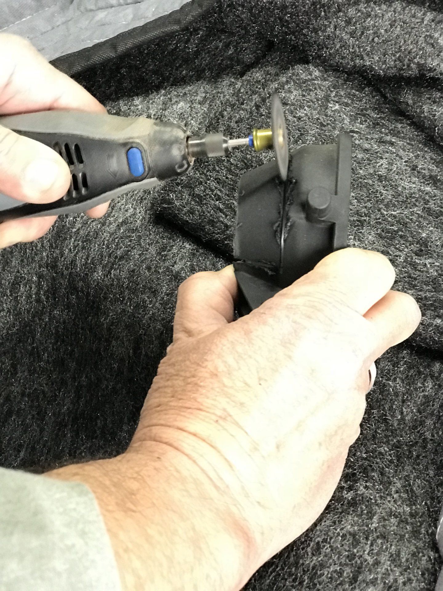

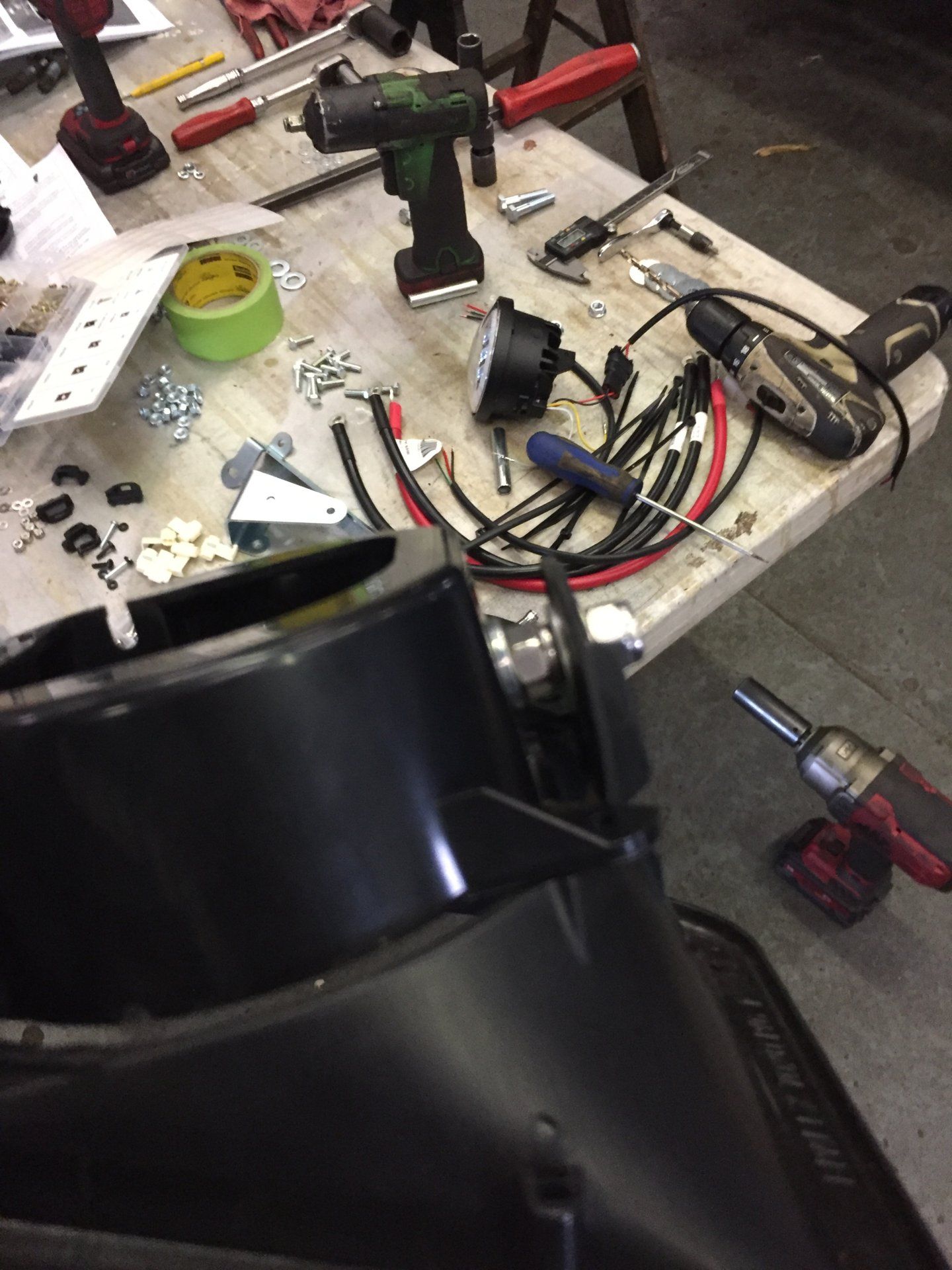

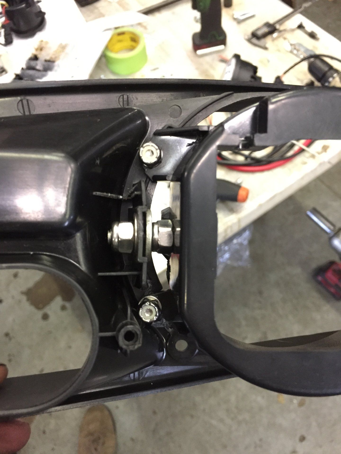

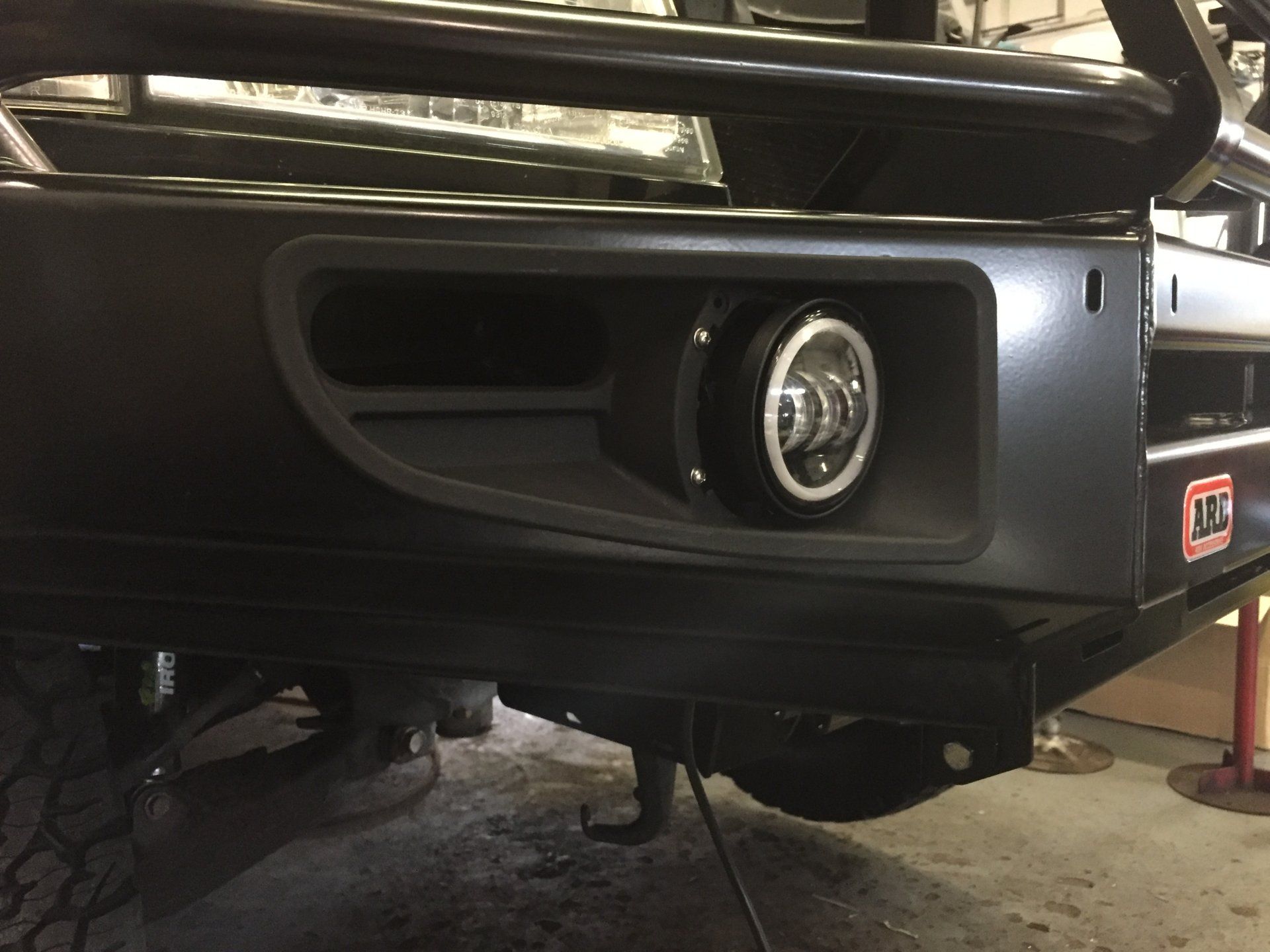

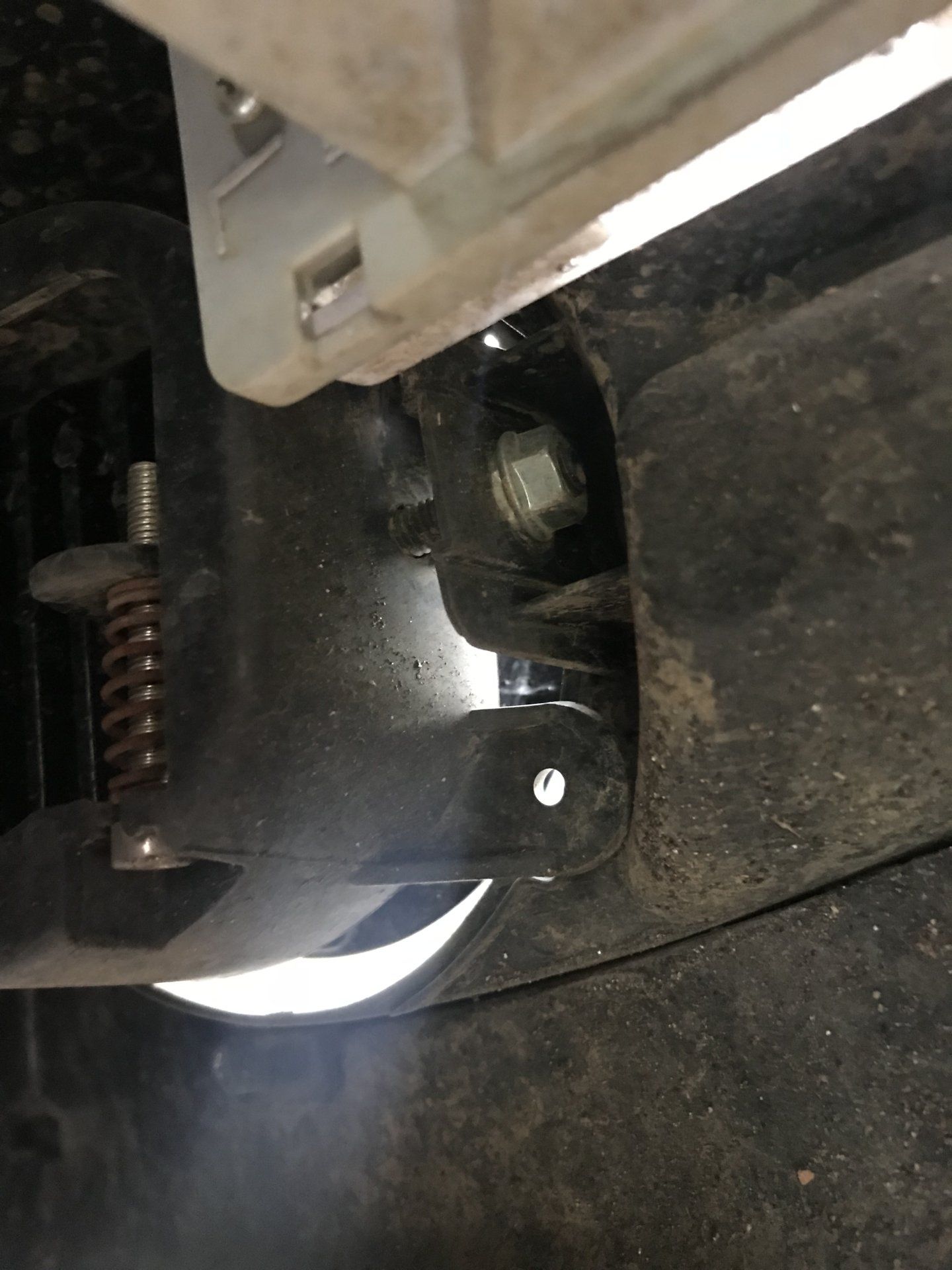

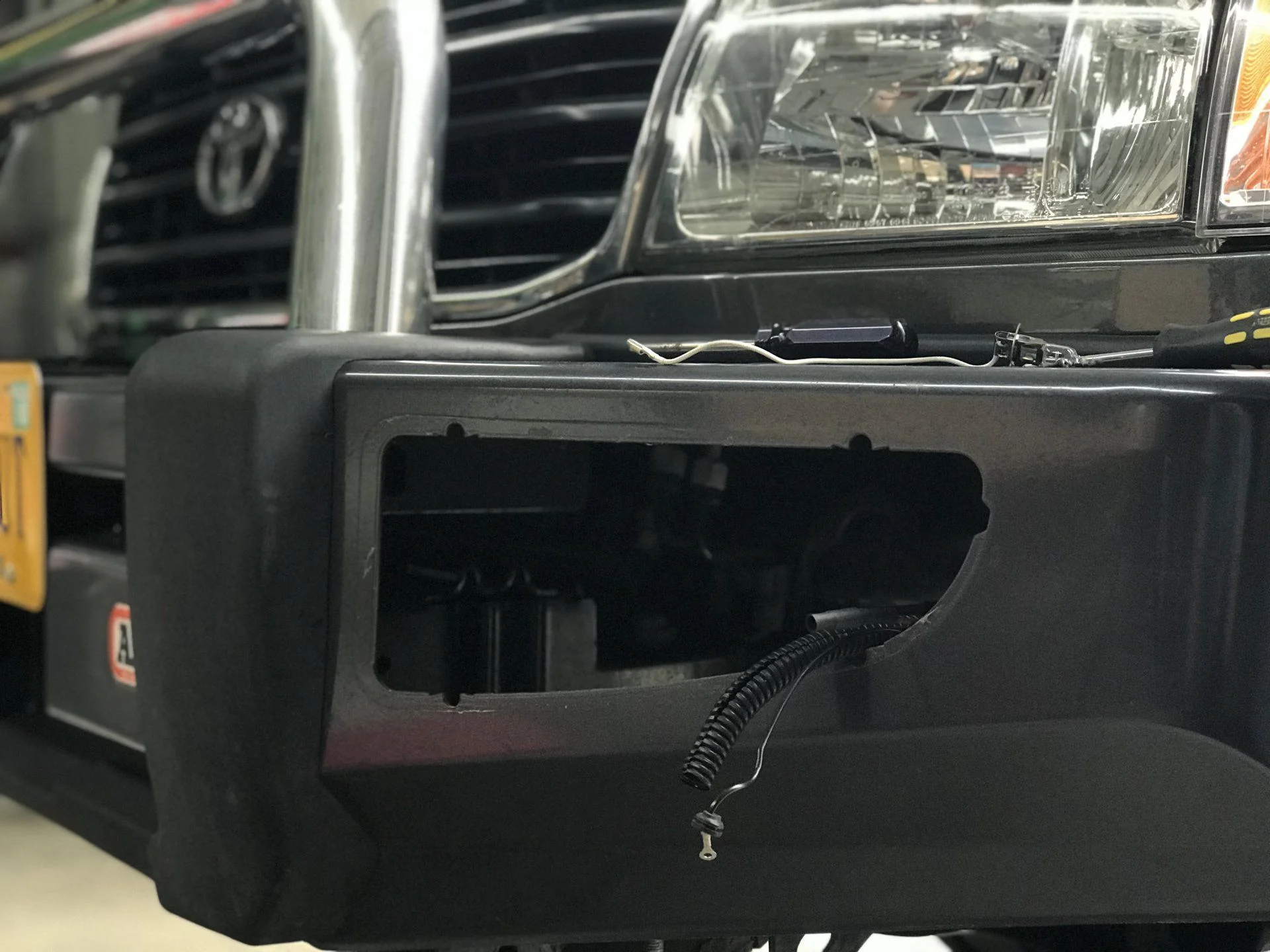

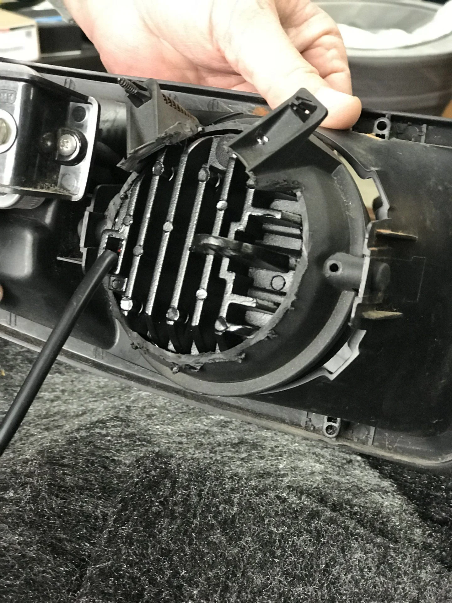

Here you go. I just trimmed the light housing and drilled some holes. The arb side is completely unmodifed and there’s no glue should I ever decide to change lights in the future. It looks like that glue method allows them to sit more flush however.
View attachment 1635022 View attachment 1635023
Do you have a pic from the front? I was thinking about taking the tabs off that were used to mount to the j**p bumpers and the light as flush mounted as possible.

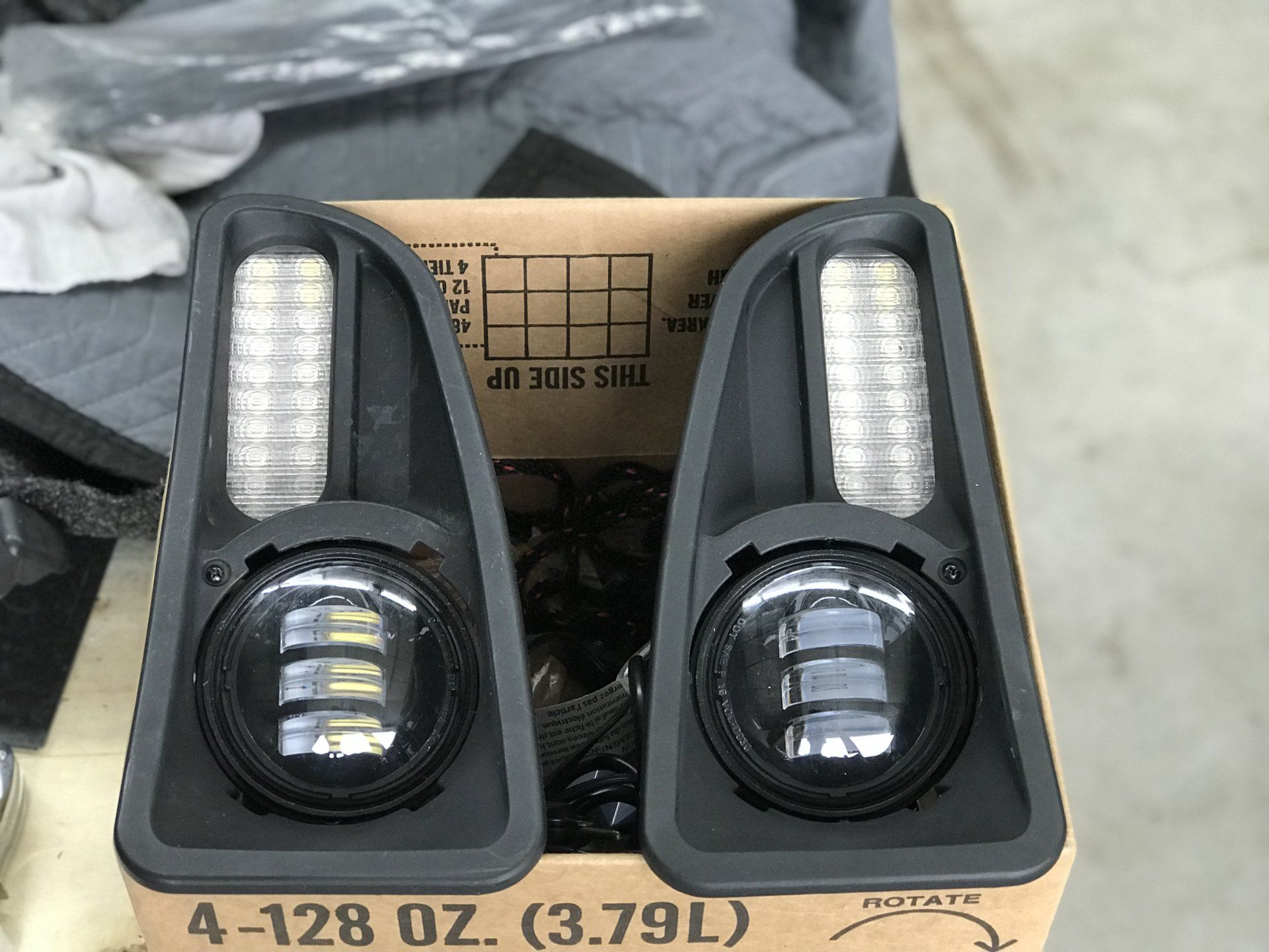

Found this while searching for a solution. Figured I would share. For $25 it looks like a good solution that will provide other options to mount a light with a stud in this spot. I am going to give it a try. I really like the Slee brackets but $165 without the required ARB LED Turn Signals is ridiculous.
ARB fog light mounting bracket
I would be interesting to see what the light pattern is out of these. They look like they might be some nice compact off road lights, but it is hard to imagine you could aim those very well to not blind oncoming traffic as "driving/fog lights". You'll have to post up a photo of what you find out.
Thanks so much for sharing this, I just ordered a pair.
