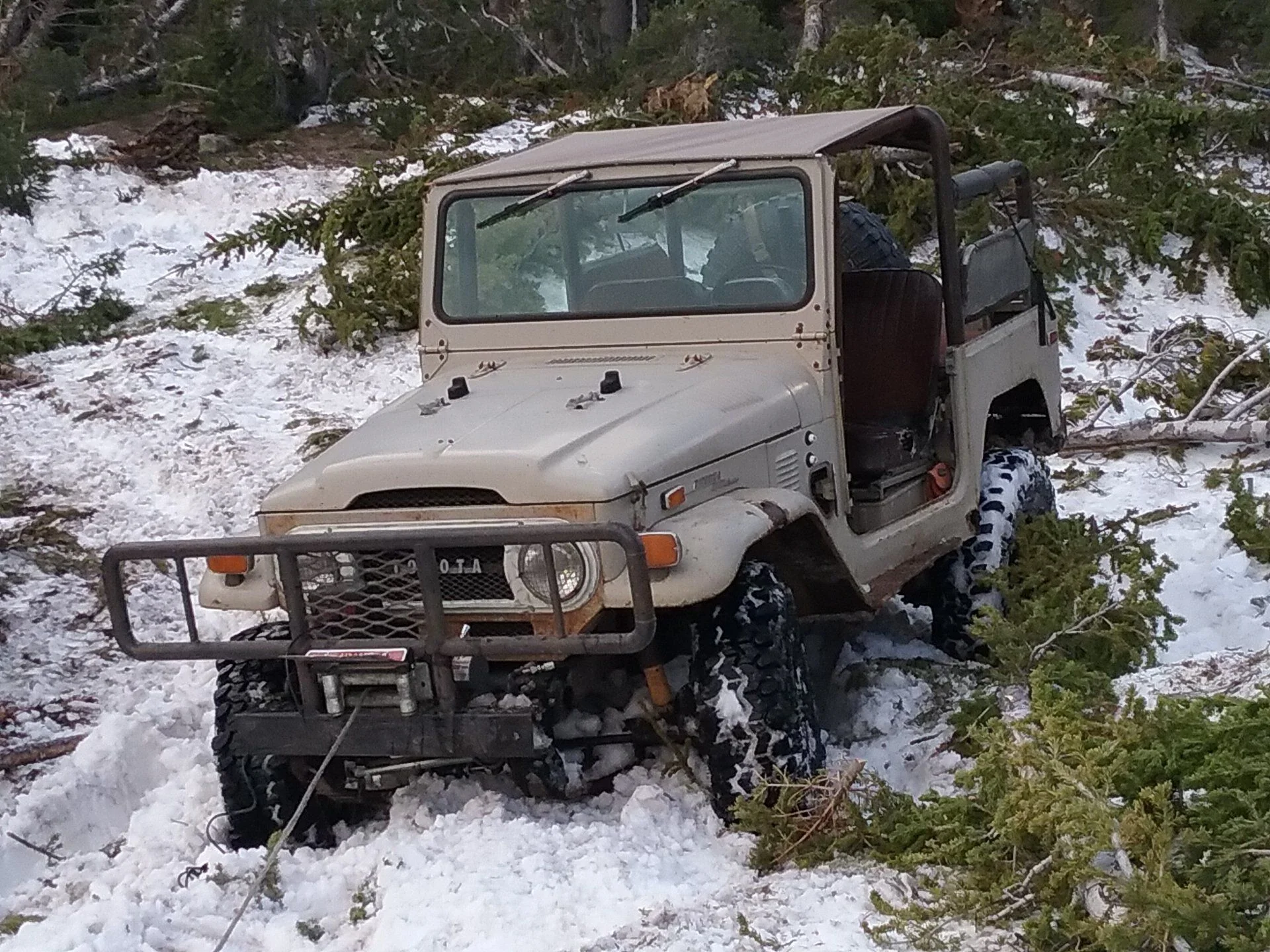

The 35x10.00-16 SX2's have been awesome on my 40, I want a set of the 37x12.00 for the 80 next.
