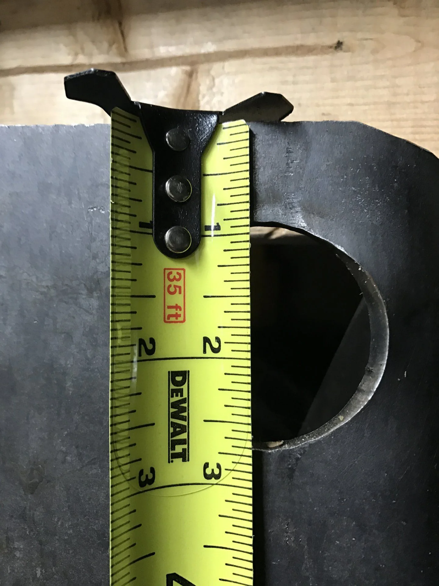

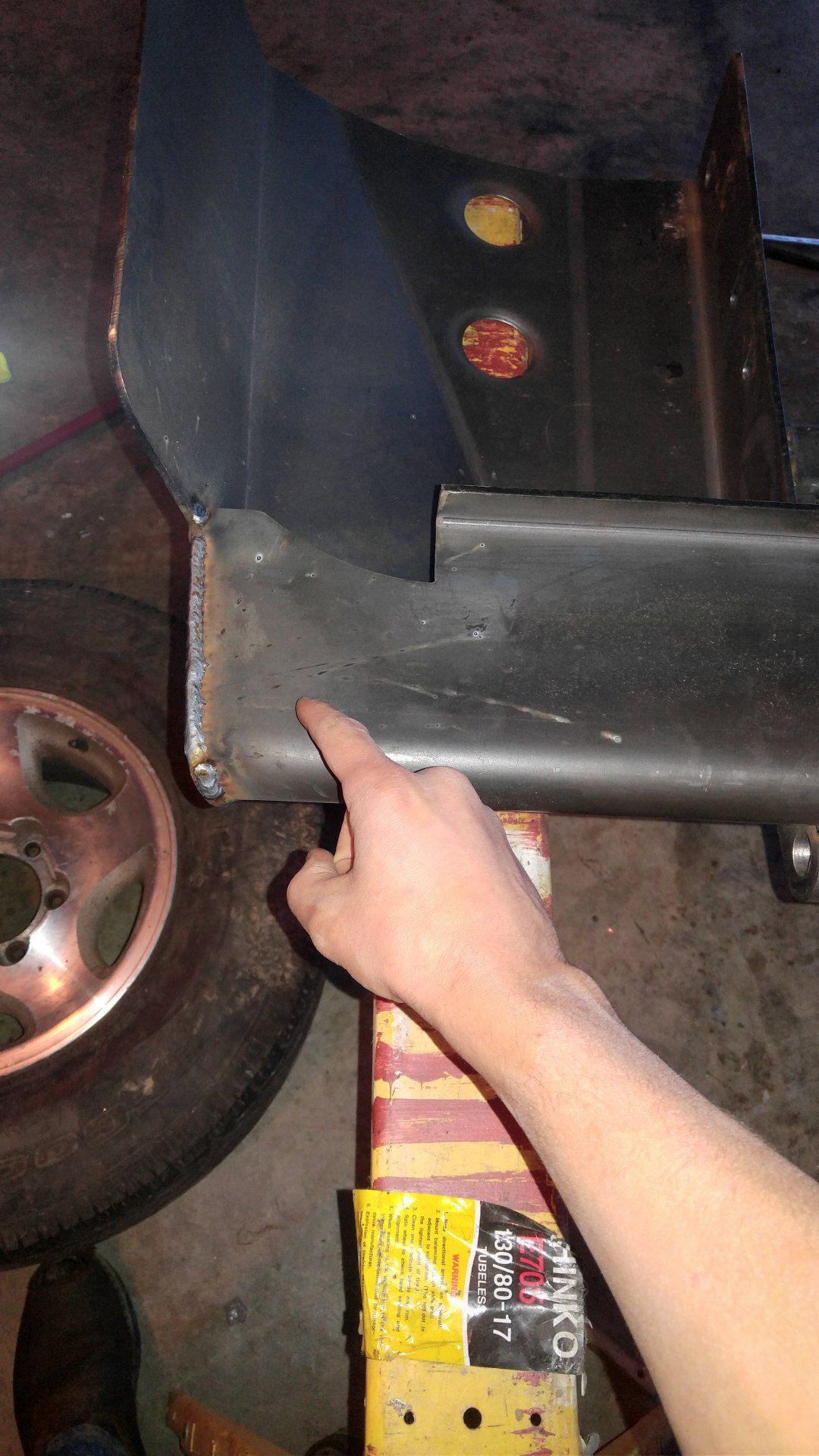

Anyone who has the 4x4 Labs rear bumper on their 80 willing to send me a few measurments? I need to know where the spindles go.
Exactly how far from the corner of the outside of the bumper. Mine didn't come with pre-drilled holes. If I am off a little on the width, I can fix that when I build my tire carrier, but I don't want to drill a hole and end up too close to the hatch and have the swing out touch the truck.
Thanks in advance.
Thanks in advance.View attachment 1384589
If you weren't welded up, Luke would have sent you a new shell with holes in it. I didn't have a way of cutting a clean hole in 3/16" plate so I contacted him about a solution. His shipping guy was screwing up with the orders. I was also missing the stop for the swingarms on the shell. I just happen to have some thick bar stock and used that instead.

No, talking to @96Cruiser13 !! Your pics were excellent Del.

I found the old thread Free was talking about and cut some holes last night. Del, those pictures were AMAZING and EXACTLY what I needed. Thanks
Jonny, you'll see it tomorrow morning, but I will post more pics once I get the spindles welded in. Been drinking, but I'm going to give it a go... lol
