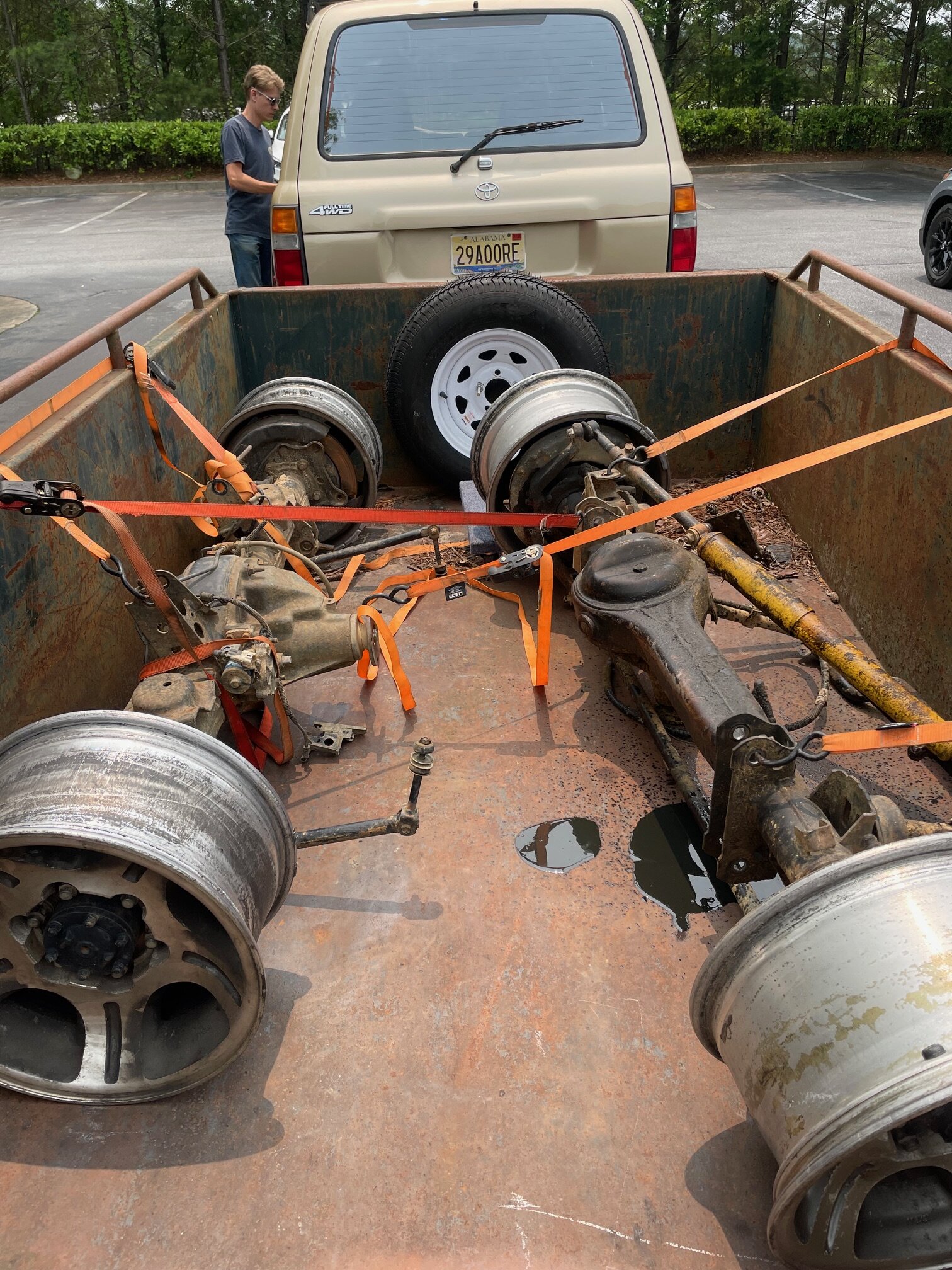

Picked up a set of locked axles today. I don't know when I'll have time to install them. Probably not until I've been stuck a few times with open diffs. Drove N of Atlanta to get the axle and had a very brief spaitiotemporal encounter with @spazzyfry123 but not enough to make contact. @cruiserinsanity and I were at a station buying gas and he drove by in a 200.
One more item to add to the mix to make this 80 more trail capable.
Two ships passing in the night by happenchance. That QT is still an hour south of the homestead. Wouldn’t have even seen you had I not made a lap of the lot to check out the Plum Crazy 440 ‘Cuda filling up a few stalls next to you.

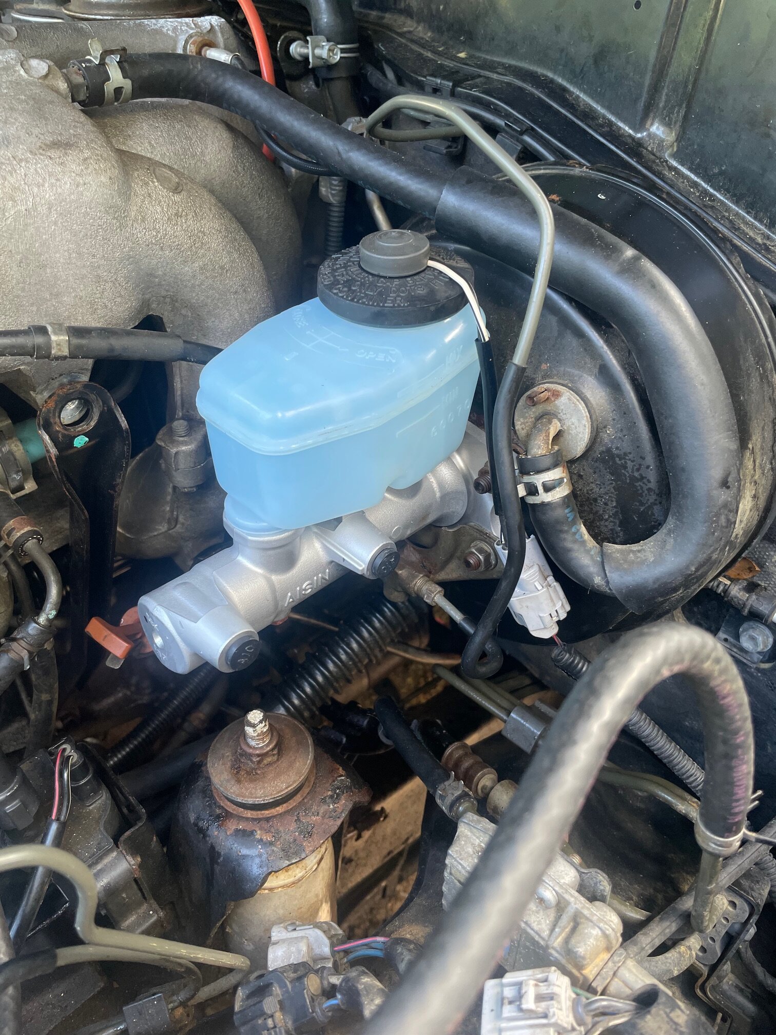

Since I yanked the ABS unit and I have no idea how old the MC is on this rig I decided to replace the MC but go with a non-ABS unit (Advics AZ BMT-090). The brake booster rod had to be adjusted out ca. 1 mm (eyeball measurement). I'm having to make new lines so I'm using this opportunity to clean up the routing of the lines. More on this later as I get into it.
