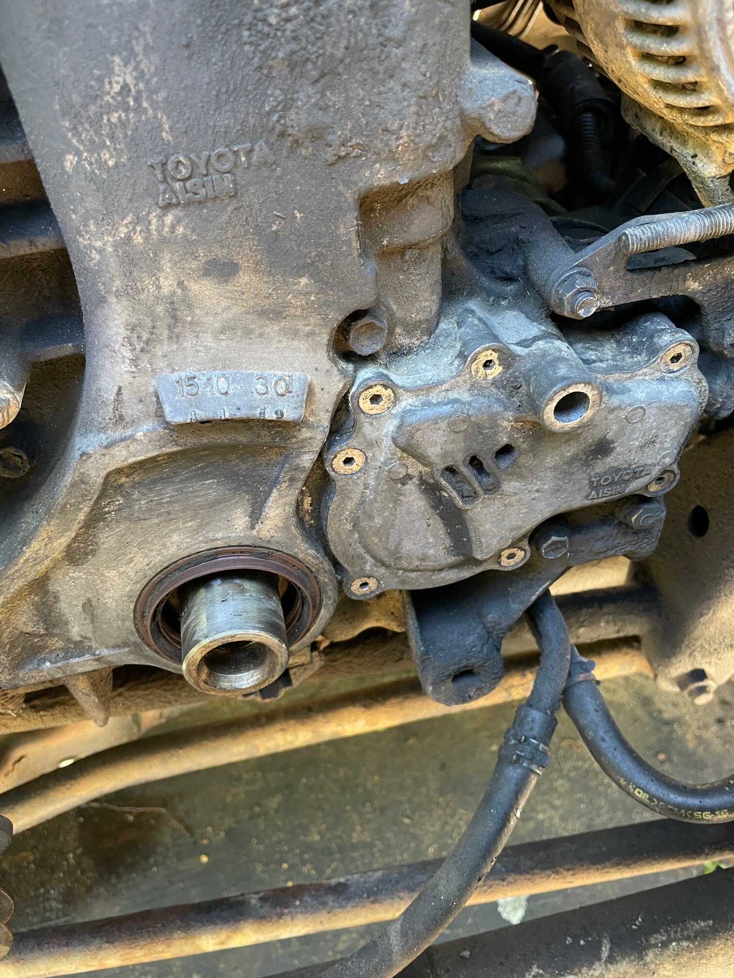

Today was pulling out cheap radiator and all the blue silicone heater hoses, and as long as I'm in that far I'll be replacing the crank seal. I was also planning on doing the oil pump cover seal but it's already been done. I was still going to do it but 5 of the allen head bolts stripped so I retorqued to two that did loosen. If the cover leaks in the future I go back in and drill out the bolts.

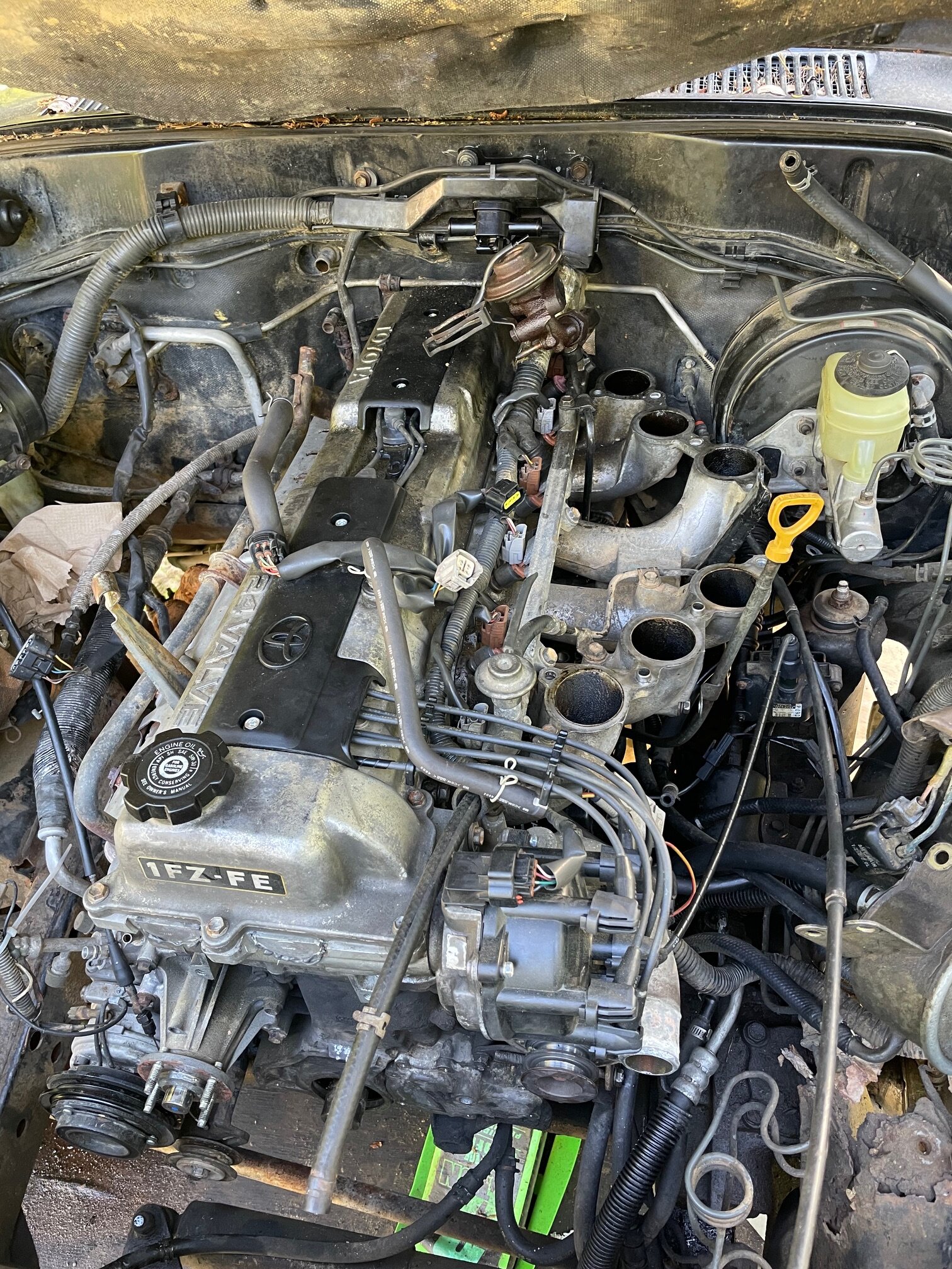

The engine runs like it has a vacuum leak at idle and since I had a spare intake I decided to clean up the spare throttle body and refresh all the vacuum lines and other hoses under the intake. Removed the upper intake today. I know it's going to be a pain reinstalling with the rear bolts difficult to access.

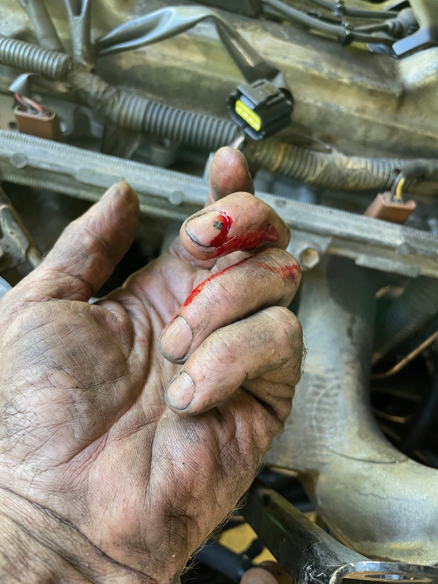

Small injury but first good blood letting while working on this Cruiser. A major step toward bonding with it :lol: . I've often said that the most important material holding my Cruisers together has been my blood.

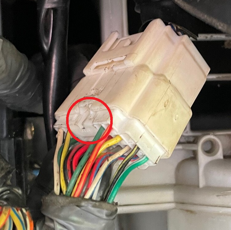

I'm also replacing the bolts on the lower intake since the shop that worked on it a couple of years ago did a sloppy job allowing for a massive vacuum leak. I want to pull the ECU harness through the firewall and pass the wiring down through the lower intake but an having a lot trouble splitting a wiring connector. I cannot see how to release any tabs to pull the halves apart. I think there is one more smaller connector above this one that needs to also be separated. I'm not sure how deep I'm going to have to dig under the dash the free the wiring harness. I did this a few years ago doing an engine swap on our other 80 and I don't recall these steps being that difficult.

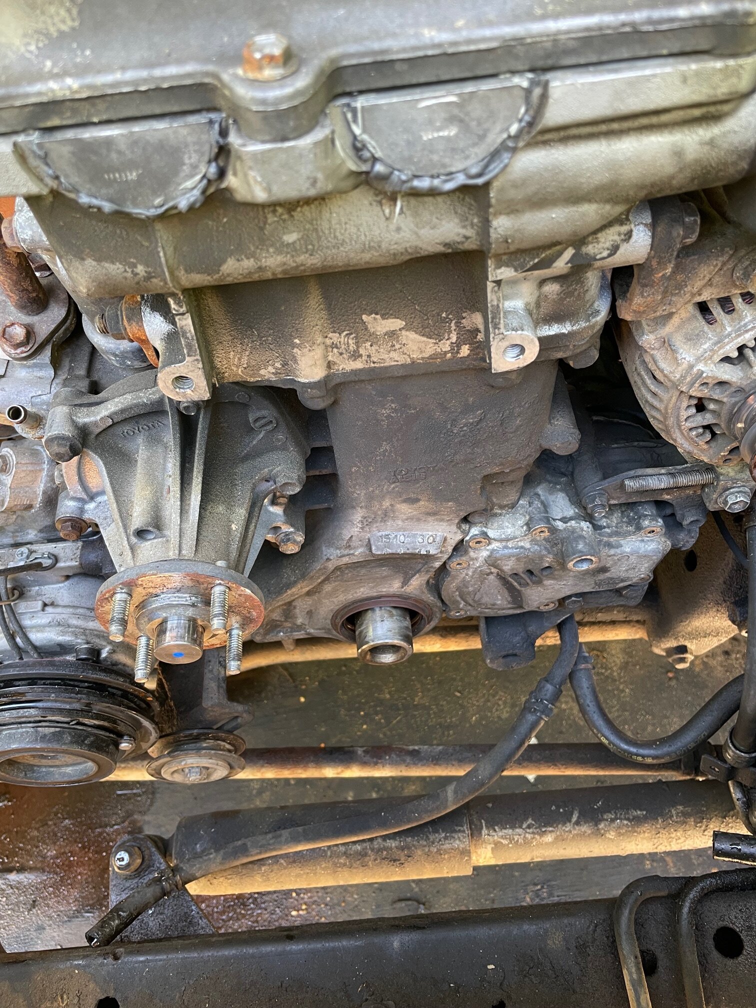

Wiring harness has been pulled through the firewall and lower intake removed. One item I wanted to deal with was the long small hose routed around the front of the engine. In this photo you can see where it connects to the side of the head; has the yellow tab on the hose clamp. It's now out.

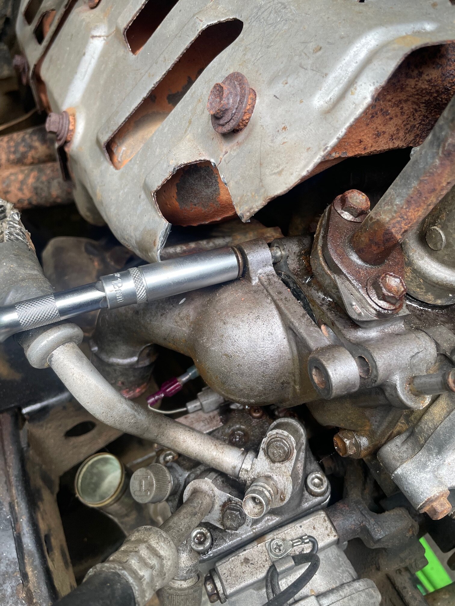

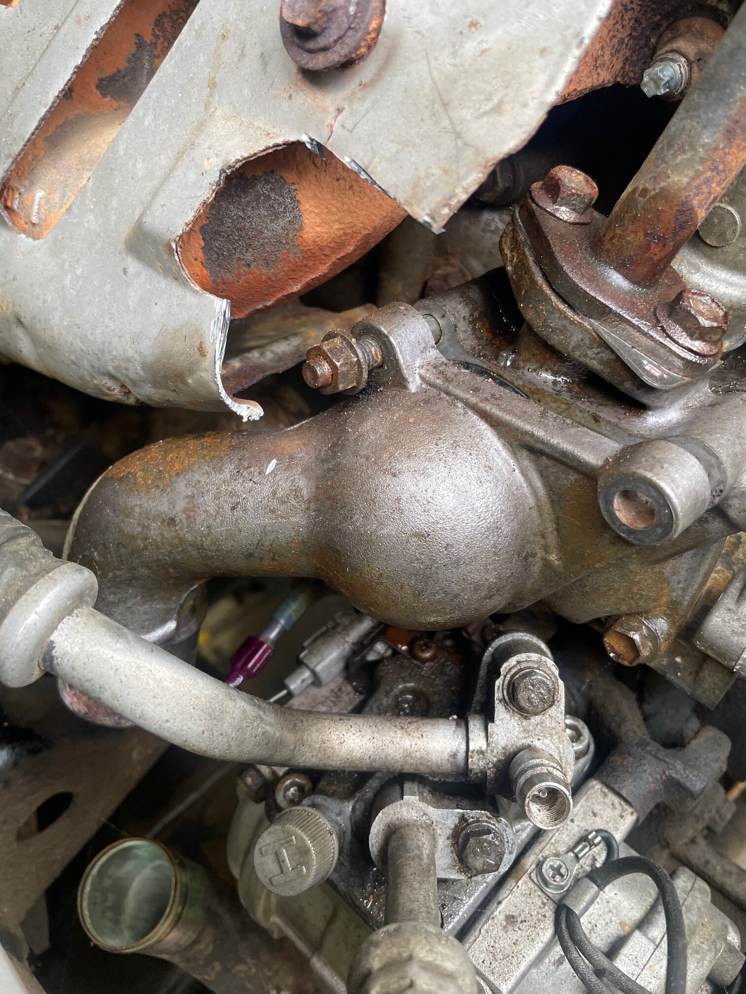

Since this had a head gasket replacement and I don't know the history of the issue I'm replacing cooling system items that could have contributed. Today was the thermostat. The upper rear nut hides behind a heat shield, or did until I notched the corner of the shield.

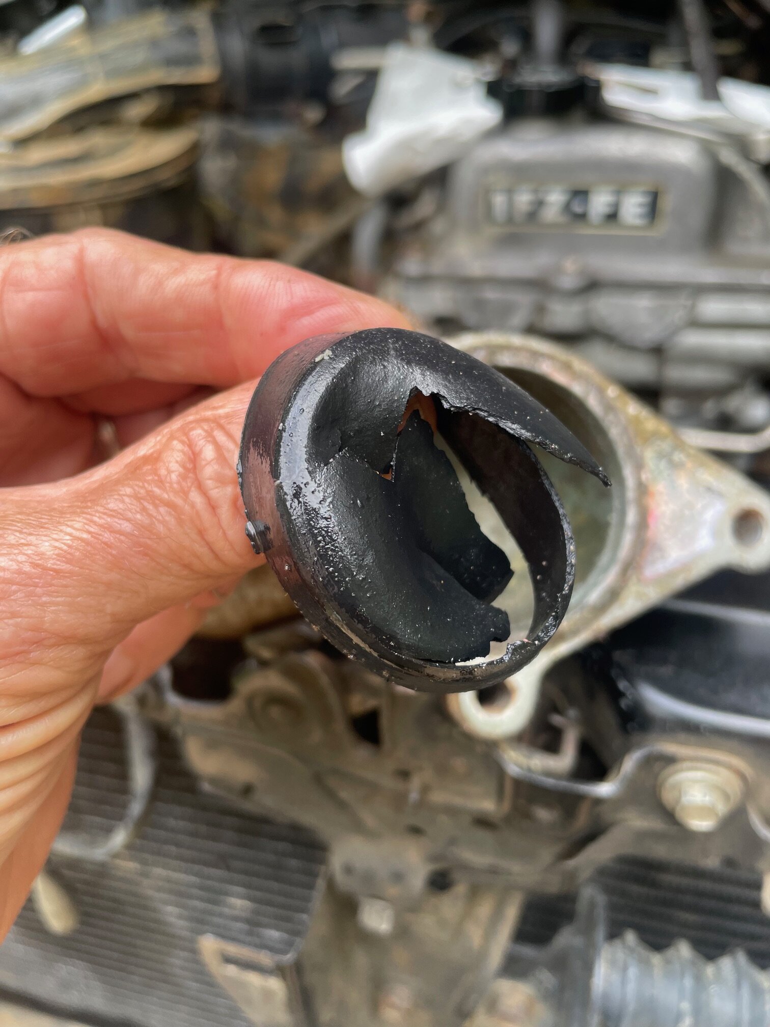

Once I pulled off the thermostat housing neck I found a torn rubber cap inside. ???? What sort of clownage allowed this to happen? That's been rectified and leads me to wonder if the cap impeded water flowing leading to overheating and the head gasket blowing.

What’s up with the plastic cap? Did it have holes in it? Was there a thermo stat in there as well? Crazy.
