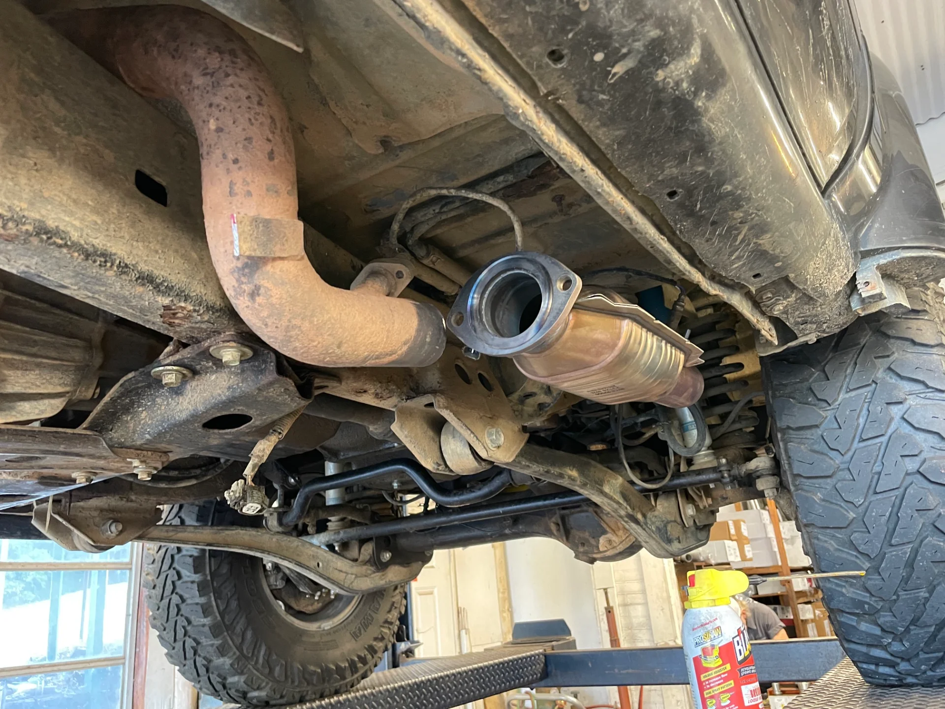

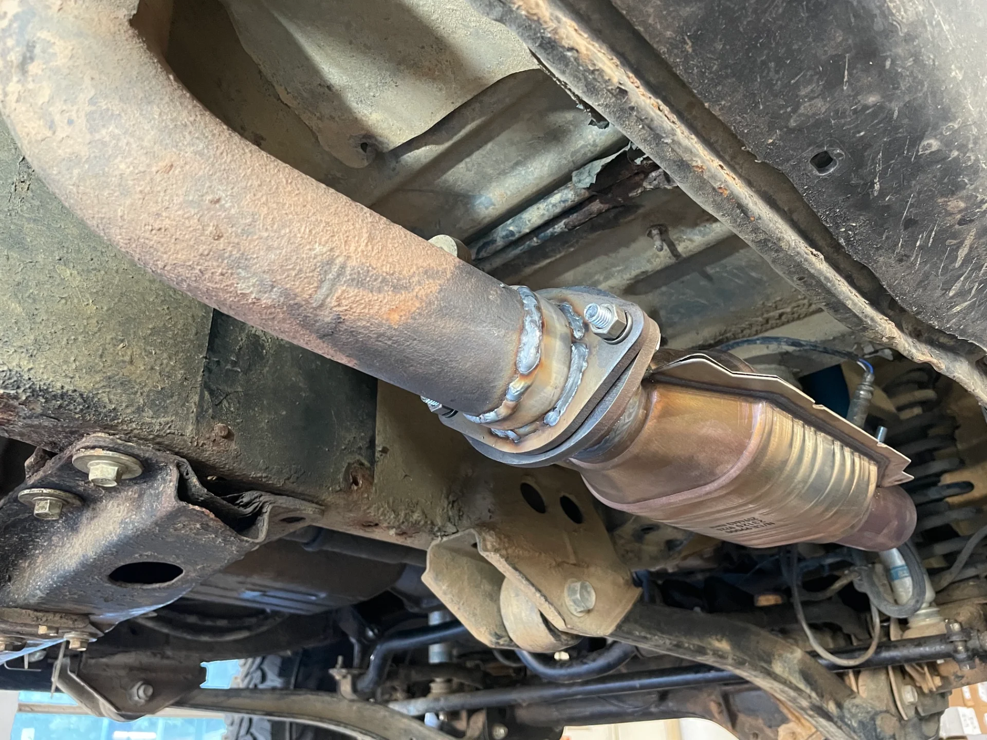

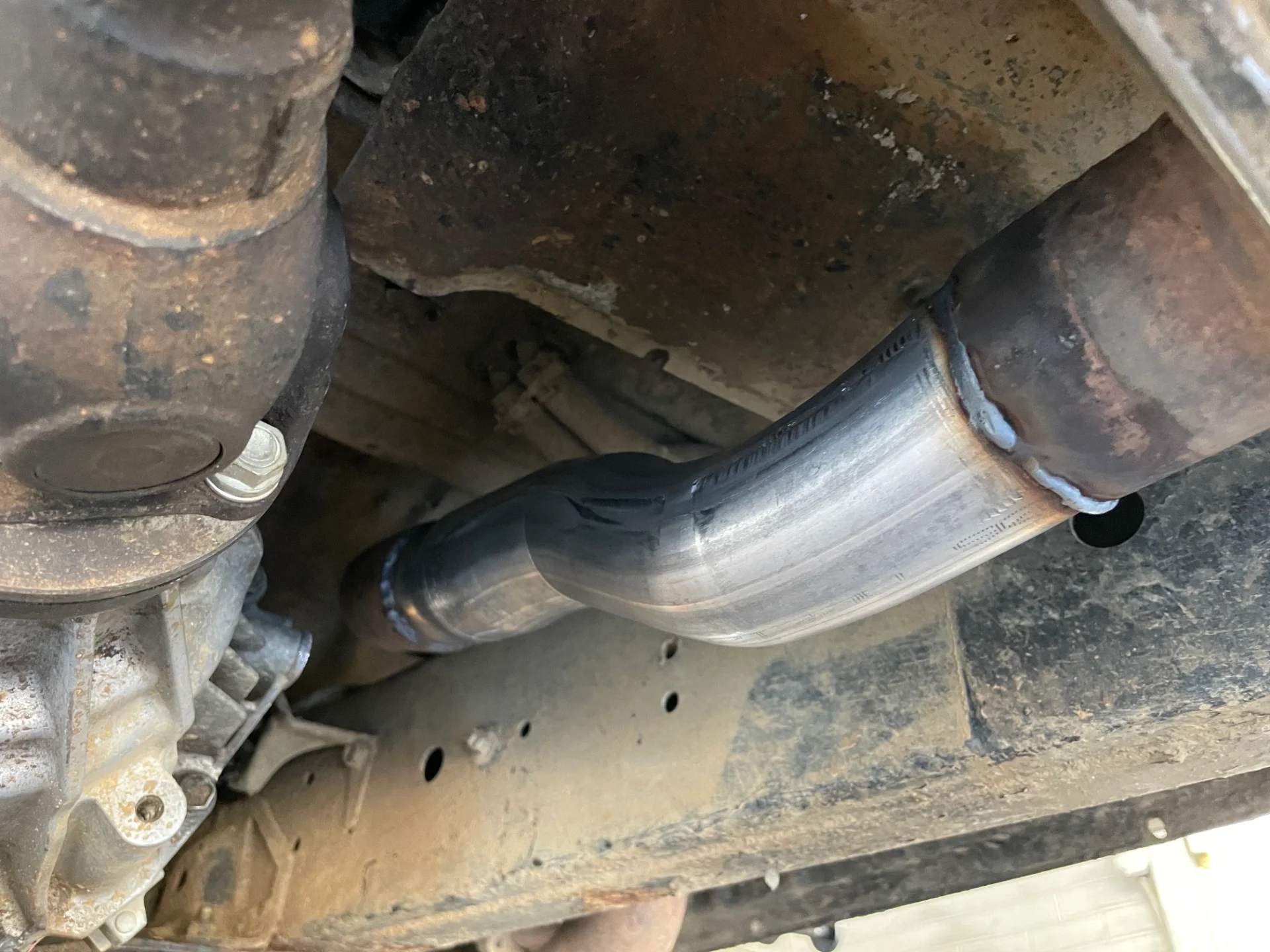

Exhaust fixed. An open 1FZ exhaust dumping under the passenger side has a cool sound for about - 0.01 seconds. I installed the Magnaflow down pipes with cat using new studs and nuts at the exhaust flanges. The entire exhaust system on this 80 was some custom fab job and the Magnaflow piece did not align with the older pipe. The owner of the local muffler shop did a good job connecting pipes.

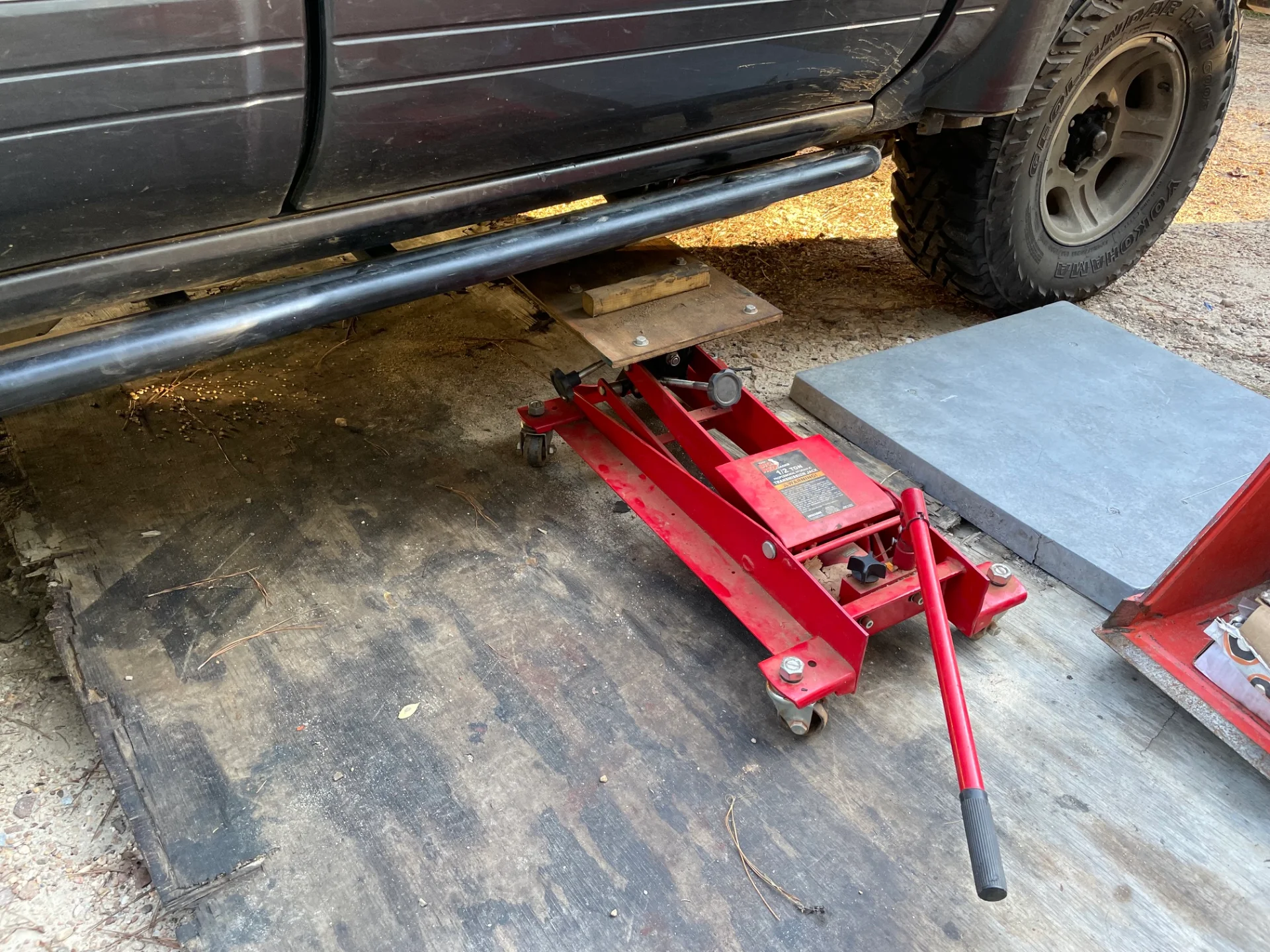

A transmission jack made easy work with slider reinstallation.
