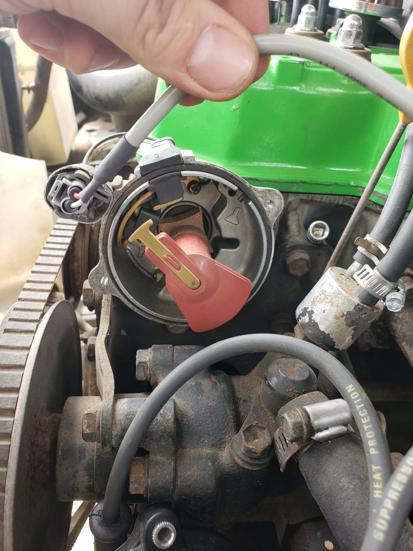

Easiest way to check timing is to set the motor to TDC and then pull the distributor cap off. The rotor should be pointing to the number 1 spark plug (11 oclock)
No.1 cylinder set to TDC and this is the position of my dizzy. I haven't moved it. Does it look right to you?

Looks like 11 oclock to me!
When I did the timing chain on my 20R I set it to TDC. I've just read that the 22RE does require it to be at 5° BTDC. I think it looks really close isn't off enough to really cause any issues. If you're worried about it, you can follow the following instructions on how to reset it, but I think you're fine.
Install with engine at TDC for a 22R or 5° BTDC for a 22RE/REC/RETSet the distributor at the 12 o-clock position

It's not that I'm worried about it, so much as I just don't know what else to do Haha! I'll reset the dizzy because I've got it apart and the engine set properly. Might as well, maybe I screwed it up the first time. ¯\_(ツ)_/¯

My first thought is that looks right.
