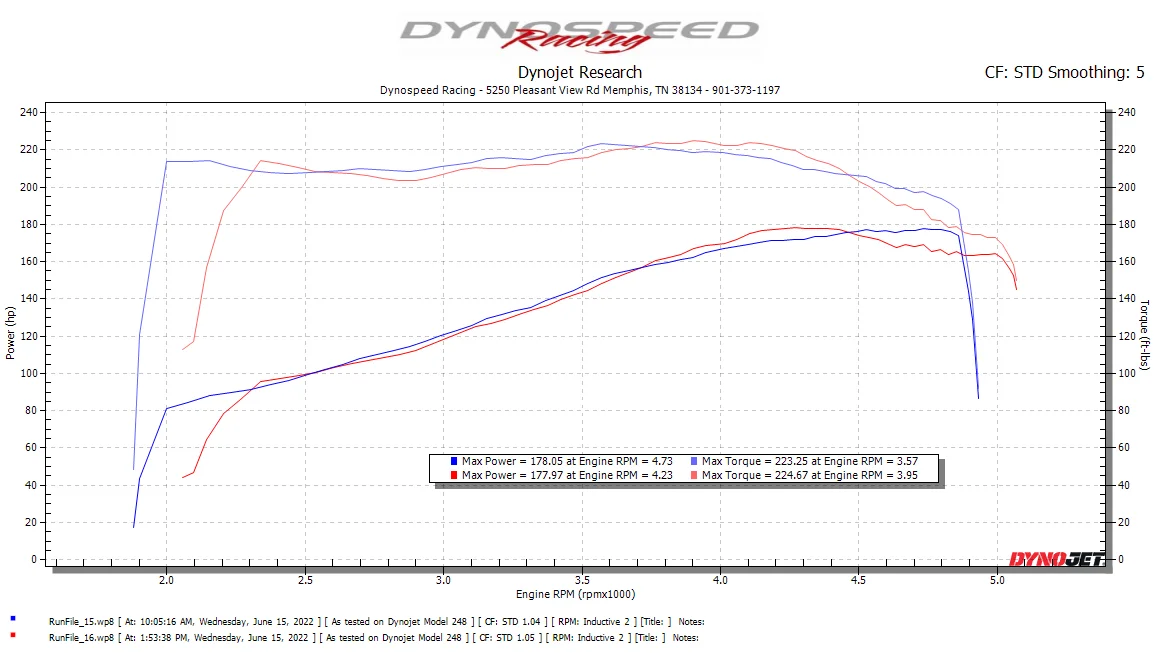

It's been a long time since I started the thread, but the 1fz-fe is still my favorite Toyota engine ever. Haltech (like @justinlyman said) has upped the game for the 1fz. They are heavily invested in it and there are great discussions in AU on this engine, especially with boost. I swear Mr T made this engine with boost in mind, because ot begs for it. You go deep going those route- turbo, ecu, injectors, exhaust, intercooler.

Full disclosure: We are a Haltech dealer, do have a little experience with them, and want to do more with them. They can be a high maintenance sale from our perspective or even cost us $$$ if we have to assist troubleshoot the final product. There is not a ton of margin for us to spend much time w/tech support, so we have not pushed this at all yet. That said, we'd love to find a way to add value and offer a few different solutions for the 1FZ, both manual & auto, NA and turbo or supercharged.
Just changing to the Haltech over stock ECU is a potential gain of 25-ish HP*, due to being able to better tune the timing. You do have to dyne tune it to realize the full potential.
The Haltech has unlimited power expansion potential if you buy the right model. Note that the 750 does NOT have the capability to control the factory idle air stepper motor. You will have to convert to an aftermarket IAC and potentially spend more in time & $$$ learning this the hard way instead of just going for the 2500 or the newer S3 (we had to learn the hard way). As a shop, time is very expensive and it is less expensive for us to go straight to the better model that just works.
You can do the plug & play if you have the factory harness. It is relatively plug & play tho requires a few bananas skill level to end up with a running truck. Especially in a swap. We can assist with piggybacking the OEM computer to keep the auto trans and all of the inside the cabin functions
We also the Sniper option for folks with carb'd motors/manifolds. We have done those with both the vac advance distributor and also converting to timing control.
The absolute best way to reach out for something like this is to text our shop number (901) 213-6373 or send us a work request from the work request tab on our website.
:beer:
* There is a thread here somewhere that someone Haltech'd a stock, used, 1FZ (believe it was manual, outside of the US) and gained around 25 HP just from switching to the OEM computer to Haltech.

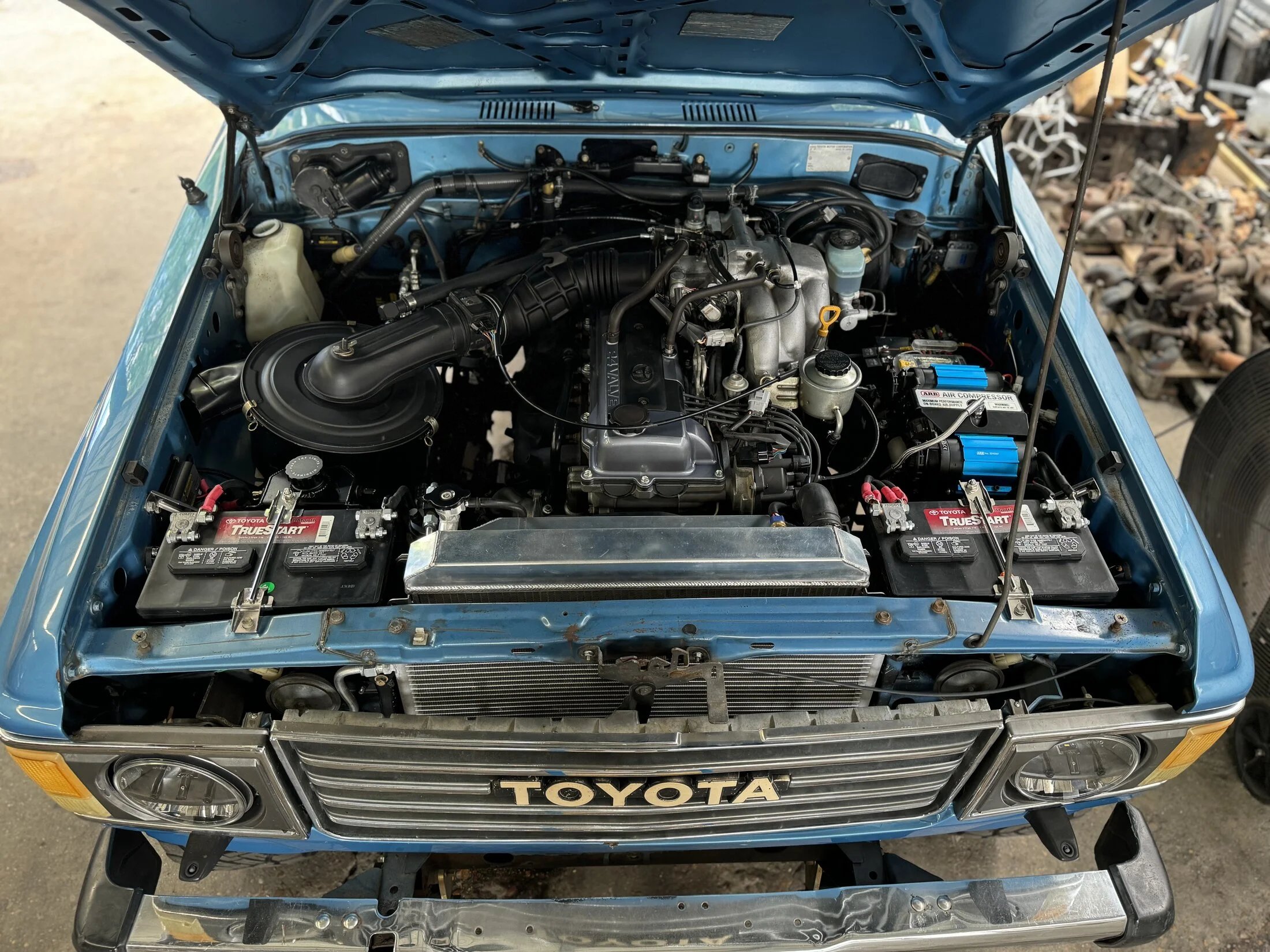

This is a plug & play Haltech kit for a manual transmission. This has an H55 mated using an FJ Co bellhousing. The motor was an OEM style rebuild. Very smooth driver. No dyno results unfortunately

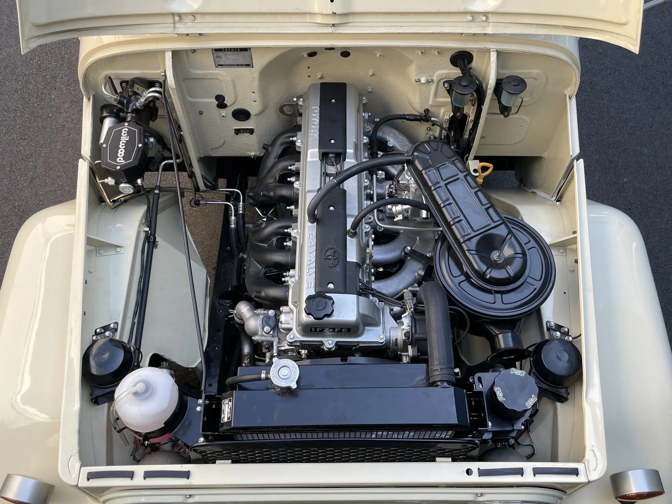

This is a Sniper’d carb motor. It was built with high compression pistons (10:1 I think) and had timing control. That was a lot of fun to drive
