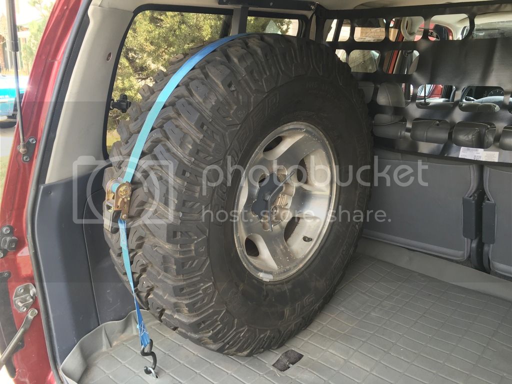

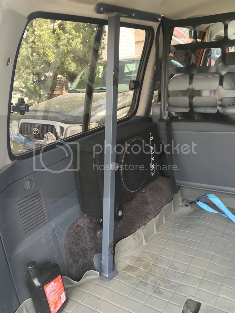

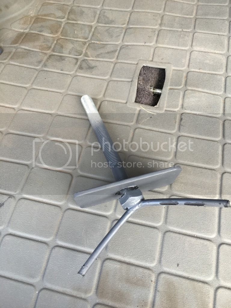

Here is my tire carrier. I like this design because I can take my tire out and have most of my cargo space available to haul large items. The pole just stabilizes the tire vertically. The strap is really what holds the tire securely. I installed it on the drivers side so it would not block my view when changing to the the right lane.
