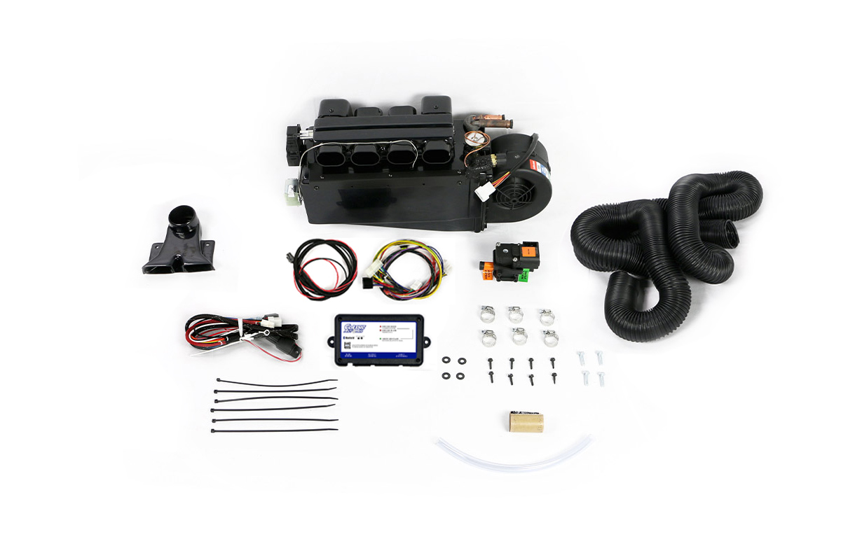

I went with the Classic Auto Air unit Street Rod Cooler III (which I believe is equivalent to the RestoMod unit).
