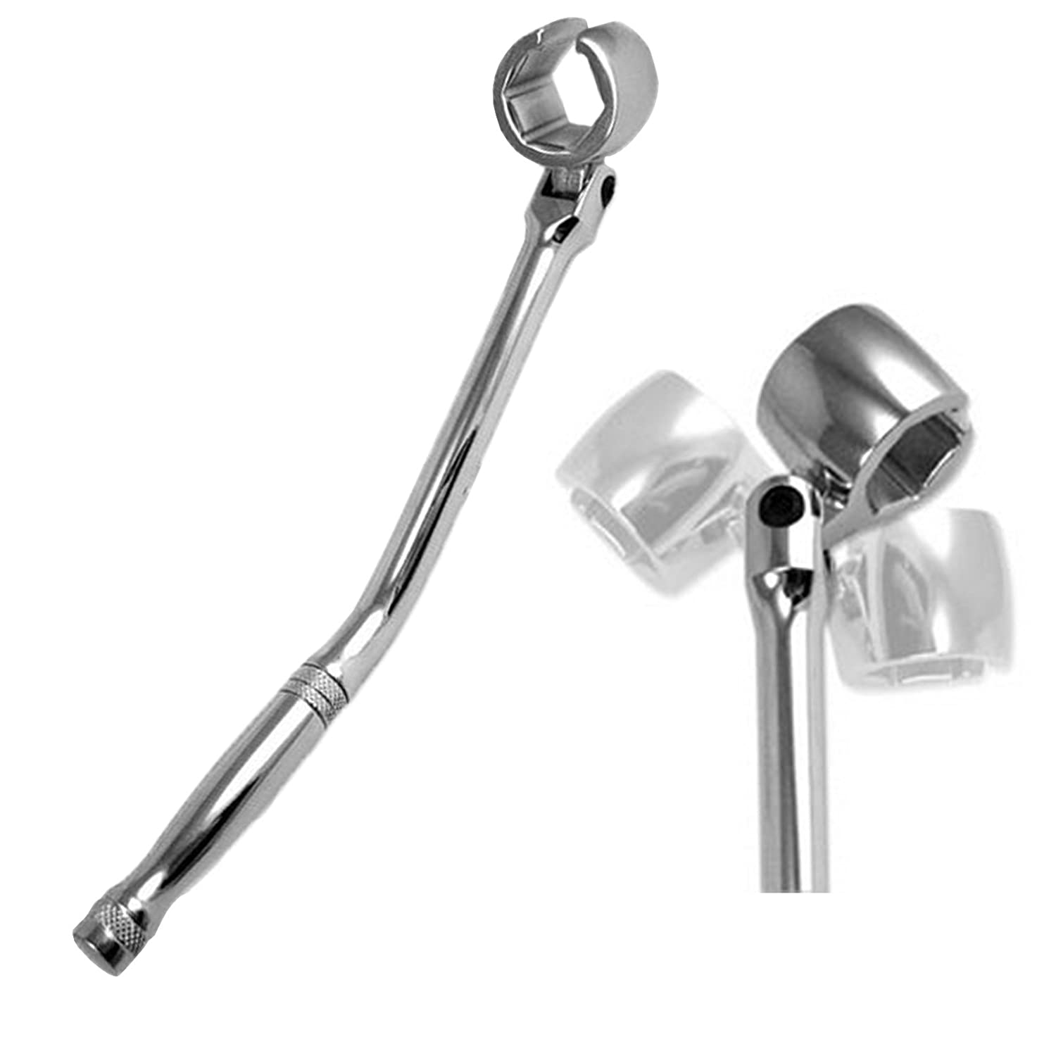

Anyone got one of these I can borrow?

I have the OX socket that you can put a breaker bar on. Sort of the same idea.
I do too but no room for a socket
:bang::bang::bang::bang::bang::bang::bang::bang::bang::bang::deadhorse::deadhorse::deadhorse::deadhorse::deadhorse::deadhorse:
Dude-It's $14. You are saving her hundreds by doing this for her. Have her buy you the tool. Just sayin'
:slap:

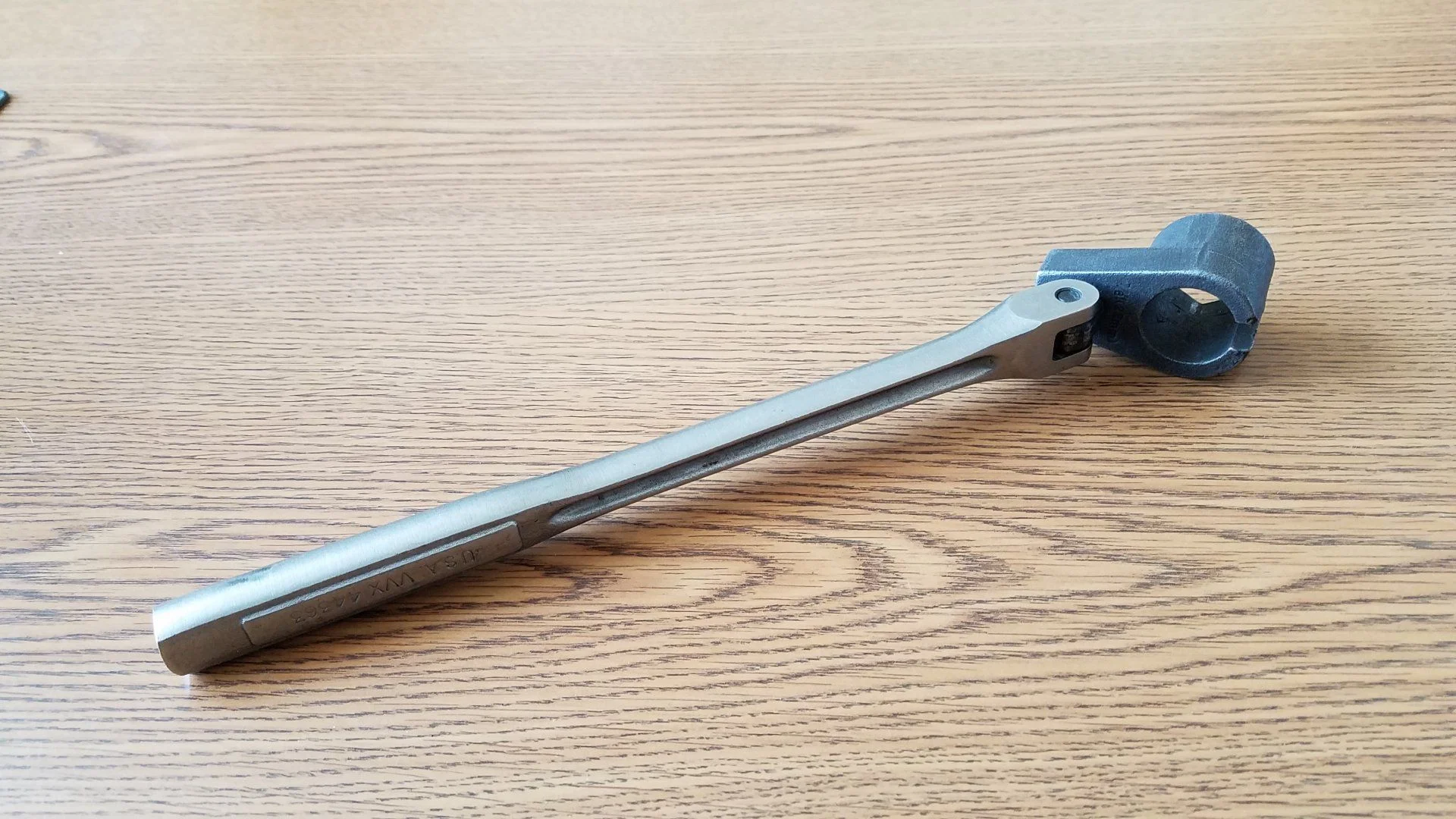

So how is an Ox sensor socket, on a flex head breaker bar different from what is in the picture? Or using a flex head ratchet on the ox sensor socket?

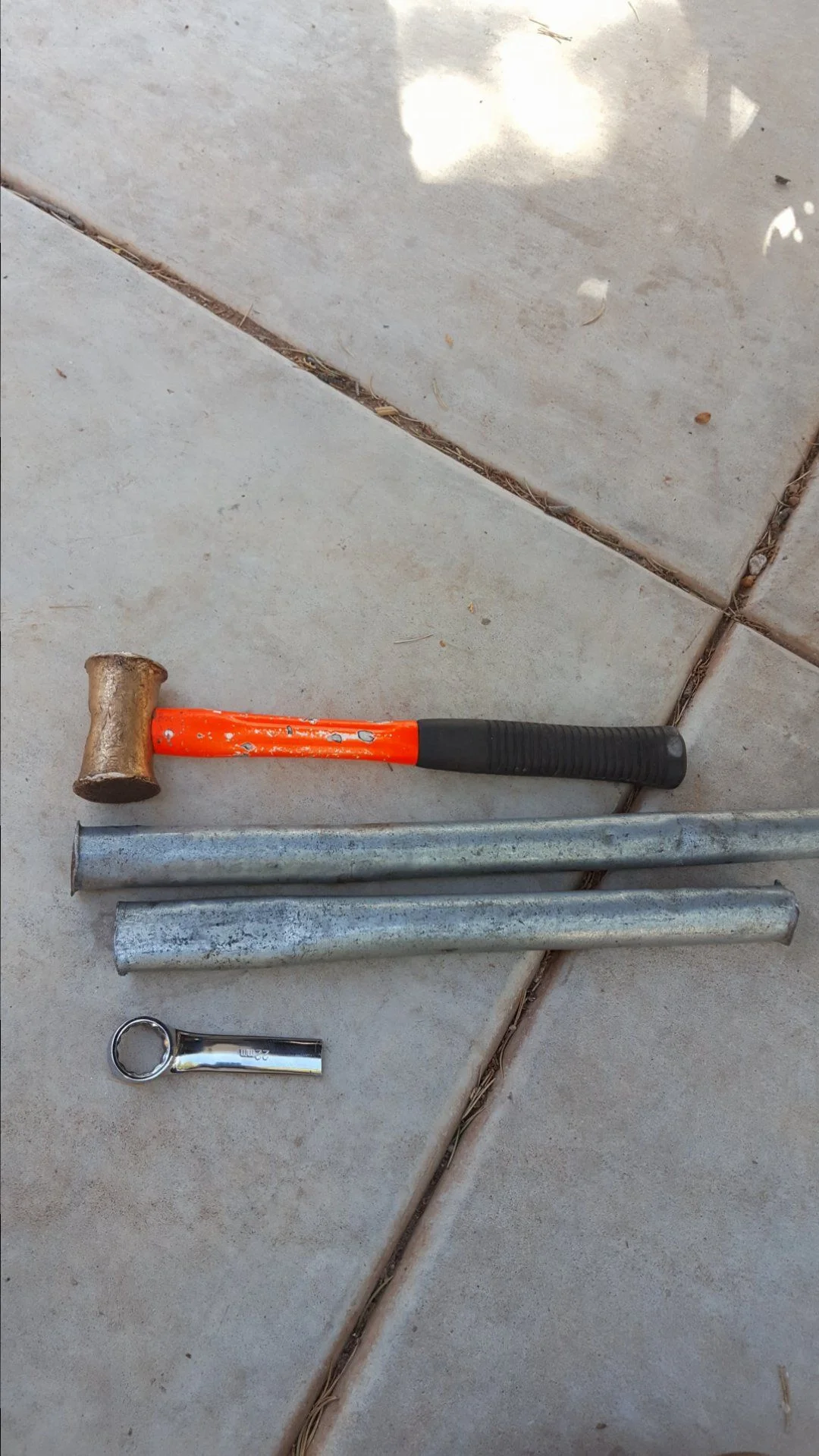

Alright, figured I'd close out this thread. The above Amazon tool didn't work either due to extreme lack of space. I'd very much like to slap the Toyota engineers with a scaly dead fish for coming up with this asinine angle for the front AFR (not technically O2) sensors when they could've simply placed them at a more desirable angle. I feel for the folks who have to r/r their AFR sensors on the V8 VVTI engines in the 4runners. Again, just for clarification, the VVTI engine uses from AFR (air fuel ratio) sensors to control engine management and rear O2 sensors for catalytic converter efficiency checking.
But, fear not, we rallied and was able to swap them out with some head scratching and only ONE trip to the hardware store for a 7/8" 12 point box end wrench. It had to 12 point because a 6 point wouldn't have allowed me to rotate small increments. The driver side AFR sensor was easy to remove, just break it loose with one whack and remove with fingers. But, the passenger side sensor was galled up when it went in the first time and my guess that's because the Dorman exh manifold sensor hole was probably not manufactured within the proper tolerance. Hey, it's Chinese, you get what you pay for Amazon.com: Dorman 674-797 Exhaust Manifold with Integrated Catalytic Converter (Non-CARB Compliant): Automotive So that one required, a tap on the wrench, re-position the wrench, hold, tap, re-position wrench, hold, tap.....for about ten minutes. Of course, the installation was "simply reverse the removal procedure" - tap, re-position wrench, hold, tap.....for five min.
