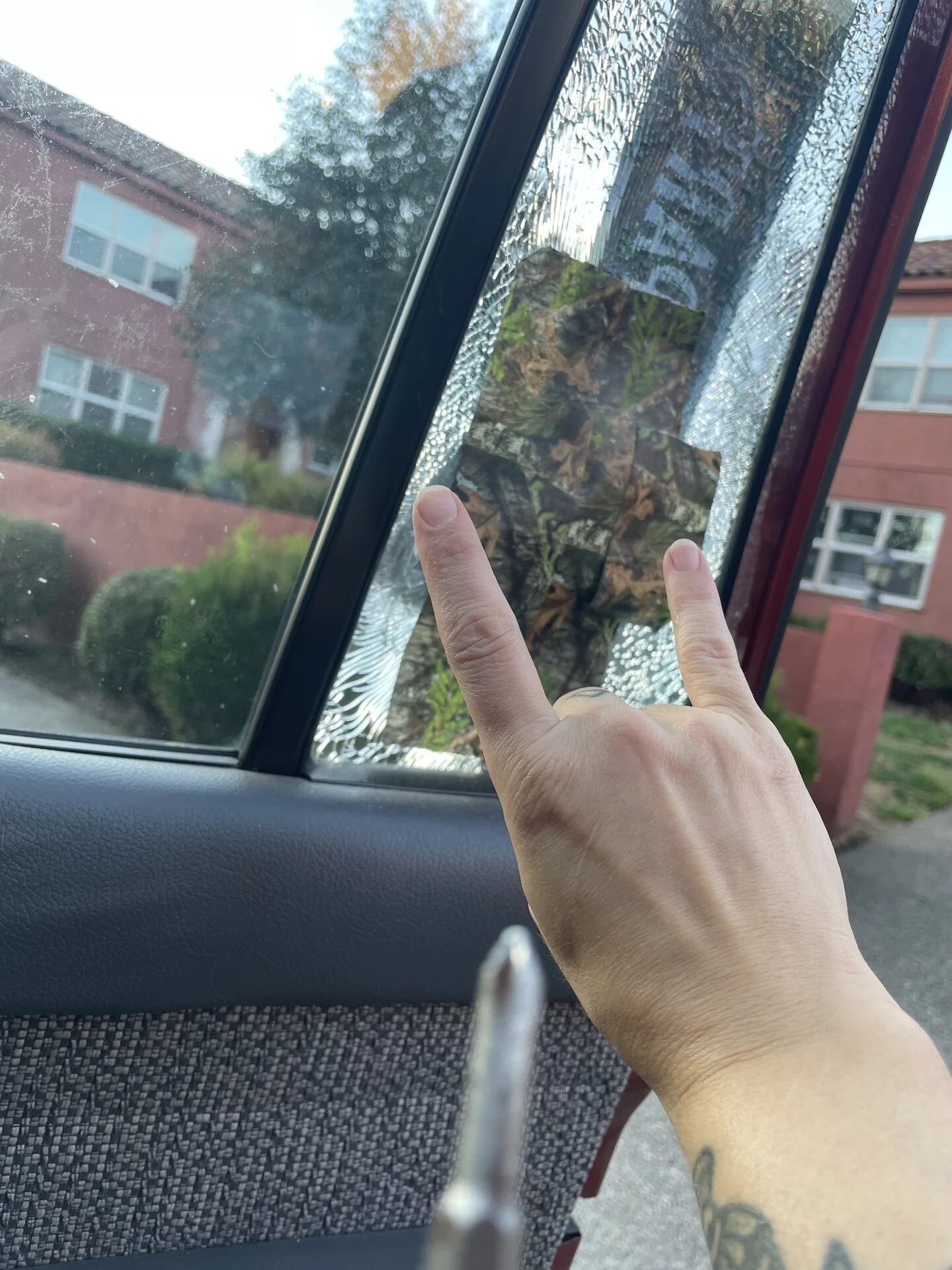

Some absolute mother****** threw a ******* brick through my rear vent window. I took out the old window and bought the replacement - popped off the door panel but am stuck - anybody know how to get the new rear vent window back in?
Rear passenger side of a 1991 Landcruiser.
