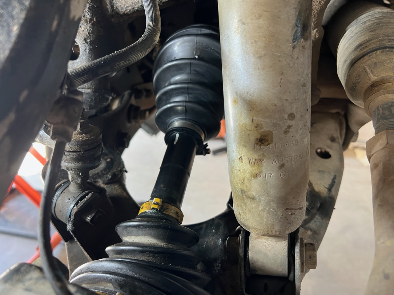

It looks like I tore my passenger upper cv boot yesterday. It flung out a bunch of grease. It’s torn at the small end first bellow. I’m tempted to clean it as best I can and wrap gorilla tape around it to try to keep grease in. It is driving fine with no clicking/issues. Any other ideas?

Well, it definitely looks redneck, but hopefully holds. It tore right near the clamp, so I took off the clamp to help hold the tape down. I’ll need to look for the silicone tape.
Well, first day was a success.
I’d try using self fusing silicone tape (aka Rescue Tape). It’s sticks on itself without adhesive so it doesn’t matter so much if the boot is greasy.
However, because it sticks to itself, I’d probably put of layer of something over it all, maybe even spray paint or grease.
Well, I replaced the inner boot. Although the repair held up well on the trails, it pretty much tore itself apart on the 800 mile trip home at 80mph. Despite the ugly tear on the boot, it still had a remarkable amount of grease inside, and never flung anymore out after the duct tape.
