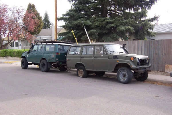

I've had two and a half 2.5" spring setups.
1) Alcan (heavily overbuilt)
2) Man-a-fre
3) Man-a-fre fronts Alcan rears
1) the Alcans were really stiff, but that's what I asked them to be. 300lbs over on the front, 600lbs over on the rear. Did fine for what I asked them to do.
2) The PO of the truck noticed how much the springs were sagging after only a few years. He rebuilt all the packs with an add-a-leaf. The fronts rides okay, but the rears started to sag bad. Here's a picture (it's the one with the roof rack). Sagging with no weight in the back.
attachment.php
I eventually gave the springs away to another forum member who rebuilt them and used them for stock height springs. Enough said.
3) I had Alcan build another spring set for the rears, 400lbs over stock and an inch longer on the shackle end. I REALLY like these springs. They ride well, flex well, and still carry the weight.
I would order Alcans again. They usually run $205 for rear springs and $200 for the front.
