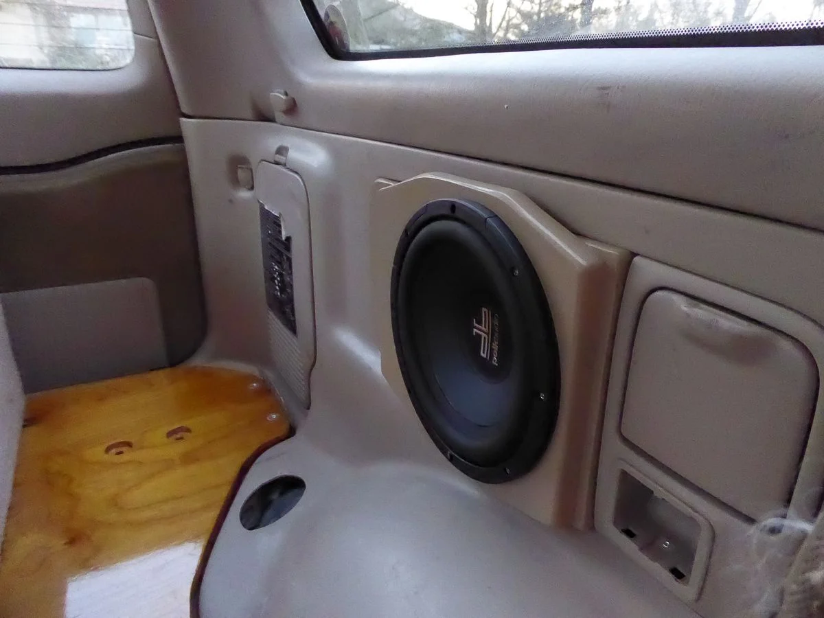

I have an 8" Polk in stock location with two pieces of 3/4" plywood to space it out. Took out plastic enclosure that was behind and insulated the whole space. You might get a shallow 10" in there with three 3/4" spacers.

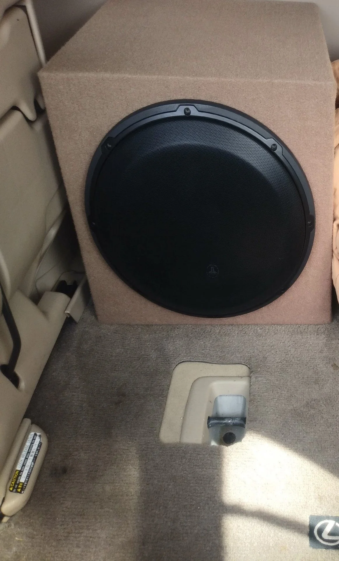

I know.. the majority think that we can't enjoy good solid bass in these rigs. If it is a sin send me to hell now! 😈 Here is my 13.5" JL sub nicely tucked in the corner.
Do you have picture of this setup? Also, you basically run sub without enclosure?
8" subwoofer - I removed the stock "box" behind the dual 4" speakers and insulated the whole interior of the space behind panel so the effective box is now at least 2 times the size of the stock one. Also all the interior panels have a couple layers of sound deadening on back side.
I do a lot of overlanding and with all the gear did not want to use up space with a external sub box.
Photo of it without the speaker grill. Mounted on two pieces of 3/4" plywood to give depth for speaker cone.
Speaker is a Polk Audio DB 840 DVC - 4ohm dual voice coil, 30-200Hz, 250W, Polk recommends a box size of about a cubic foot.
Running it on the factory amp. Has plenty of volume, bass is tight which I like. Expect sound would improve if I replaced the factory amp with more power.
Not a setup for pumping out the thump, but produces a natural bass for my music.

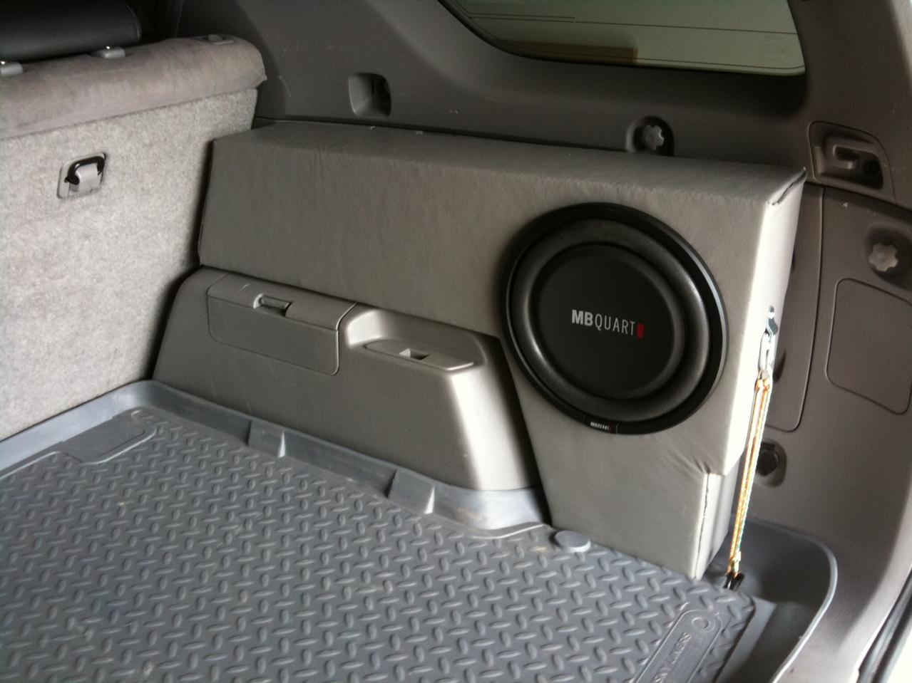

pic below. In this pic I think the owner could have built the s box to the window line and fit a couple 10’s or 8’s versus one big sub to the rear. However this, Single sub to the back in a Landcruiser might create the opportunity to consider portedoptions

Space behind the panel is the enclosure, I put sound insulation on interior surfaces.
Photo of it without speaker grill. Mounted on two pieces of 3/4" plywood to give depth for speaker cone.
So I am confused... did you use the stock "box" in the fender and then build it out to fit a 13.5" sub? Seems like the volume for the box would then be SUPER small for the size sub. But definitely like the way that you handled things.
No. He just uses space behind as "box". Not really sturdy box and really "ported" but hey :)
