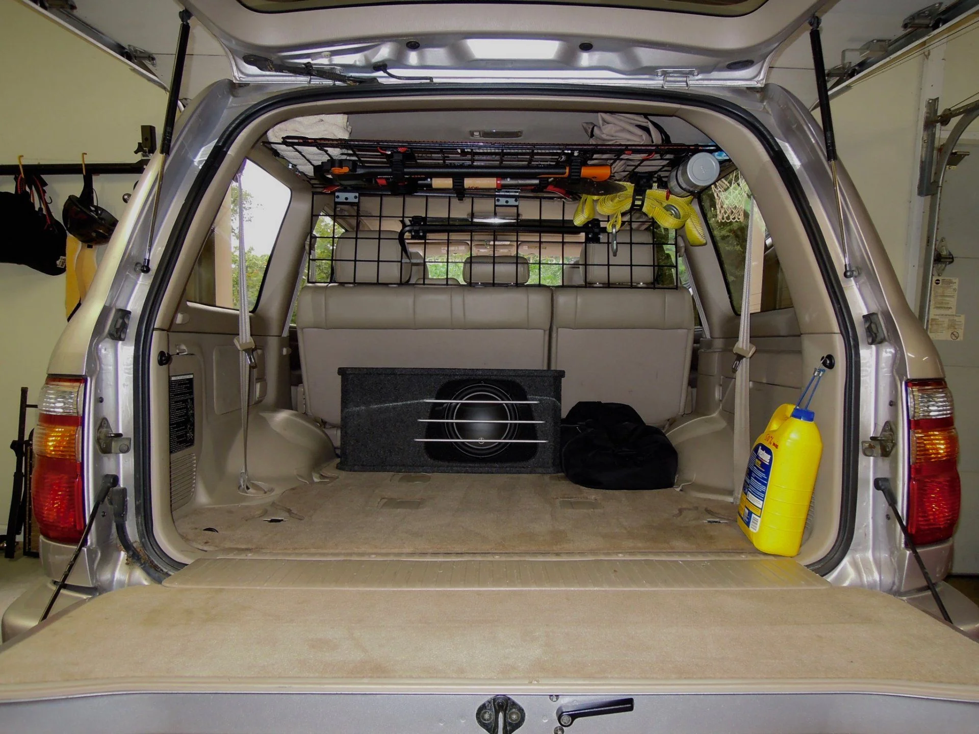

Decent spots/considerations
1) box mounted over wheel well. The depth of the wheel well if you test below window height and adjust width for required space should allow you a decent 12 or smaller or multiple smaller subs.
2) If you don’t have drawers you can wedge it between your rear seats folded up. Just do quick disconnects and you can remove it on trips.

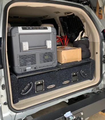

3) been impressed with the drawers system enclosure builds that guys been doing. Think the key part is ensuring there is not excessive rattle.

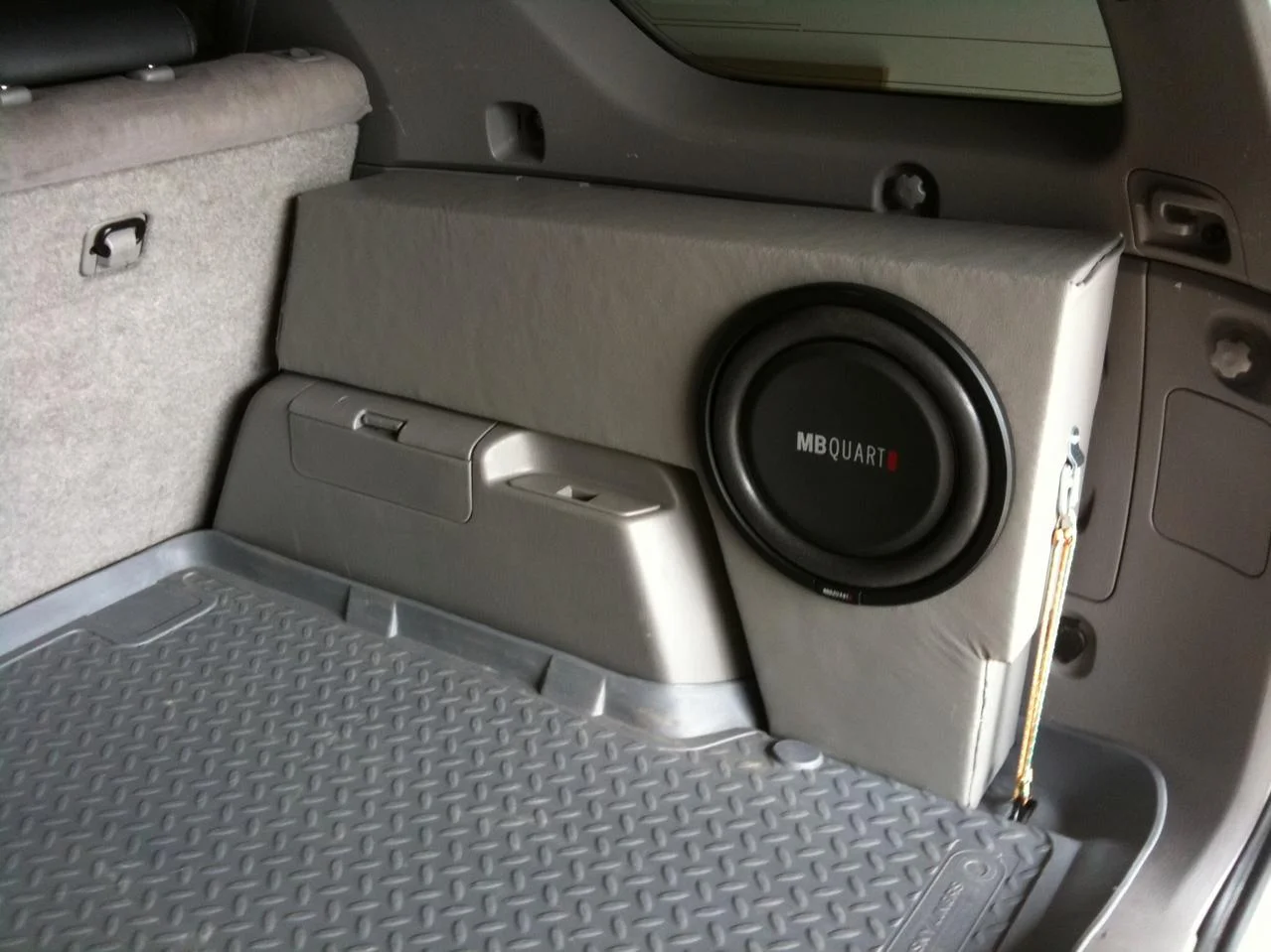

pic below. In this pic I think the owner could have built the s box to the window line and fit a couple 10’s or 8’s versus one big sub to the rear. However this, Single sub to the back in a Landcruiser might create the opportunity to consider portedoptions

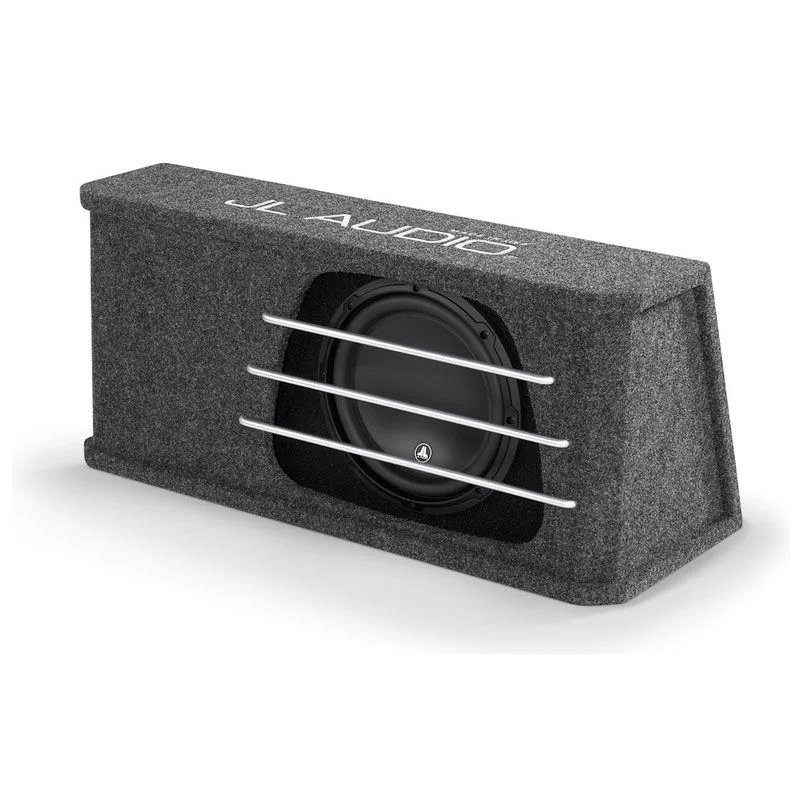

10” shallow mount ported enclosure with a slanted back so it tucks up nicely against the rear of the second row. The aluminum bars serve their purpose to protect it well
I had an up firing ported Dual sub setup In my sequoia and I utilized a wedge design to the angle of the backseat. Only thing is that my not matching the wedge with the seat angle you have space and for the amps/wiring and the camp can stay relatively cool. But those wedge designs maximize space available pretty well.
I've thoroughly enjoyed it. It's JL's "High Output" line (JL Audio HO110RG-W3v3) so even though it's a 10" it beats like a 12". You're right on the mismatched angles but the gap on mine isn't bad at all, maybe 1.5" at the bottom. I really like it though because I put banana plugs on the ends of the speaker wires so if I want to remove it I can have it out in about 15sec. I've had to do that a few times to haul gear for longer trips or large loads of pea gravel.
ive been quick disconnects or die on every system I’ve ever owned for that reason. Nothing like wife getting on your s*** about not being able to help move something cuz of a big enclosure. I said the angle thing because so many guys are diy’ers on this forum. A wedge sealed won’t be that hard to make assuming the builder skips the cosmetic protection wall.
those ho jl boxes Pound for the relatively low power that jl subs ask for on an rms basis

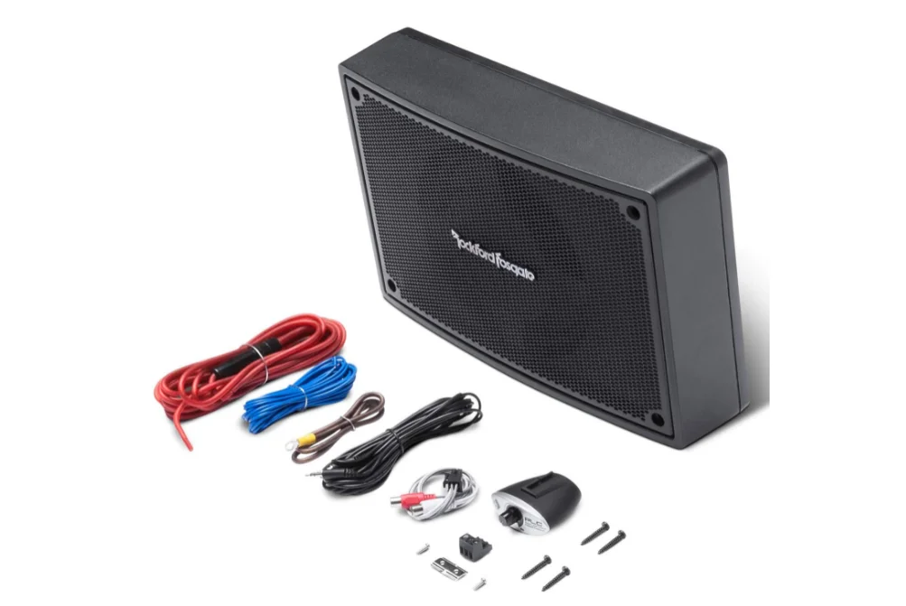

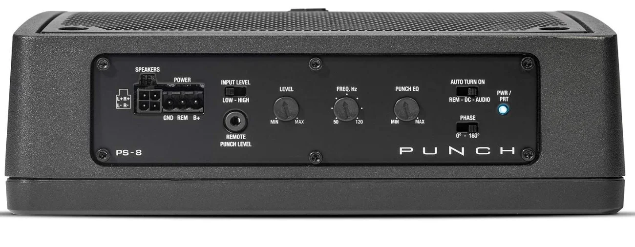

Rockford Fosgate P300-8P Punch 8" 300 Watt Powered Ported Subwoofer System Amazon product ASIN B07FN75M1V
I'm loving this Fosgate PS-8 powered sub in this location. The front seats a catch a nice vibe from the location. Driver and passenger can feel the bass.
The location makes for some very interesting sound imaging having the sub sit in the middle of 4 other Fosgate P1650 door speakers. Yeah, I know it's kind of old school center channelish -- I am too.
Since I rarely have only one rear passenger, the location won't be a problem. I may cover it with some tan grille cloth so it blends with the other tan trim and carpet to keep dust out of it.

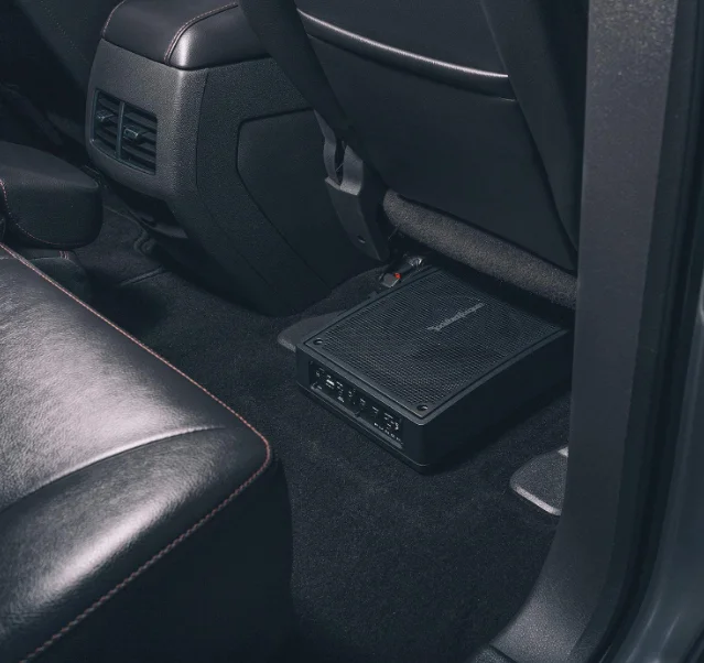

A common placement for this type of self enclosed sub is under the passenger seat. I have setup this on another car with a JBL powered sub and really enjoy the sound and location. I just didn't have the clearance to do this with the 100s under passenger seat mounted AMP. I replaced the factory amp with a Fosgate PBR400X4D 4-cnannel amplifier for the door speakers.
Installed the punch level control in the ash tray opening.

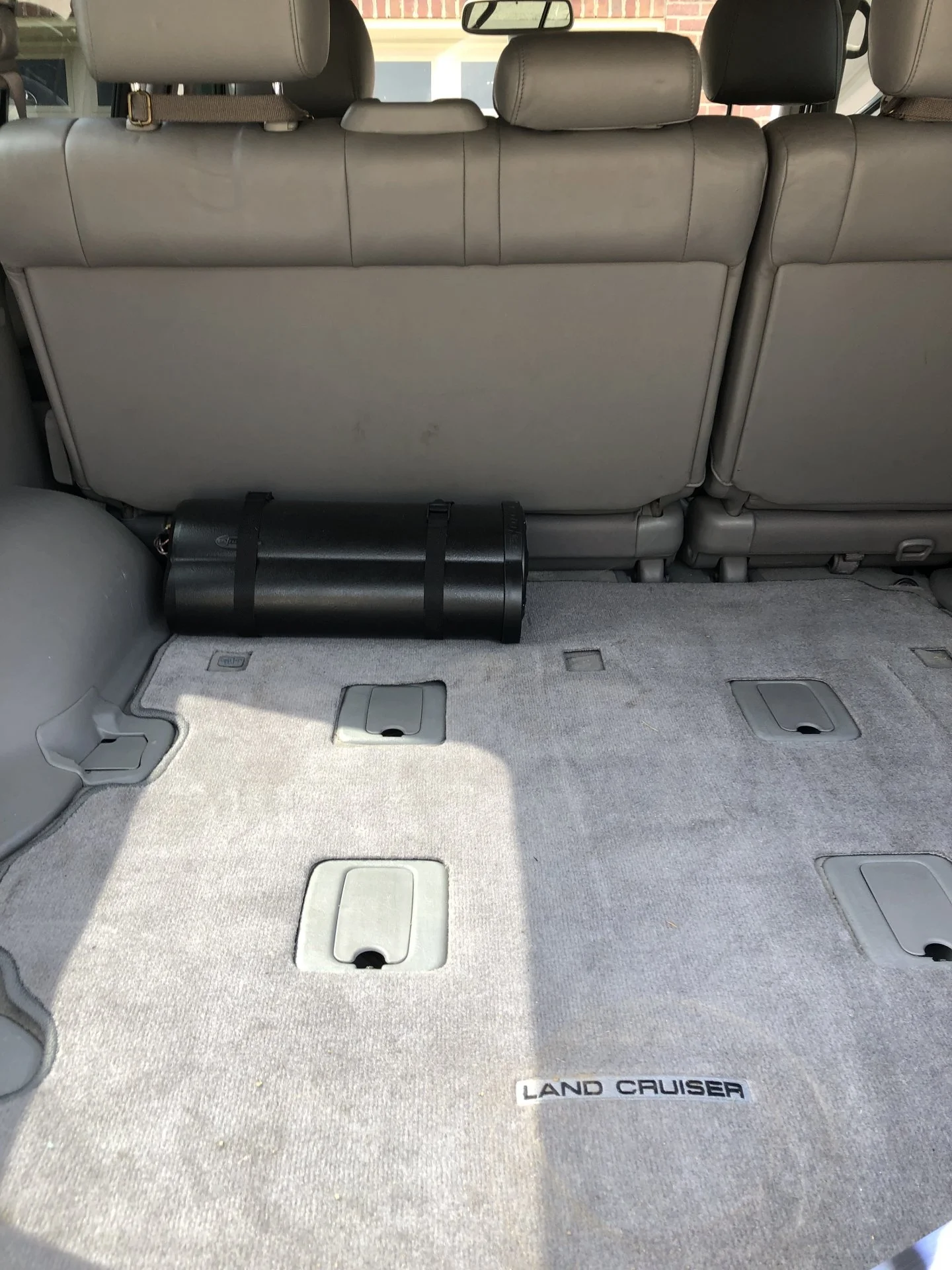

I installed a dvc 6” Bazooka tube running off of the stock amp, and couldn’t believe the difference it made. I am still amazed at how much deep tight bass it produces. For the price, I can’t imagine any alternative sounding better. It’s pretty small and can be mounted in endless configurations, and is easily removable.
Thanks for sharing. I was thinking about this for another vehicle.

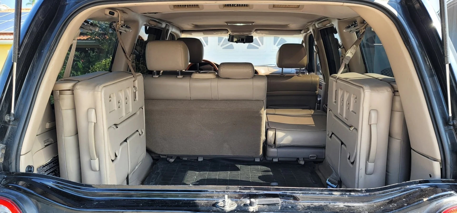

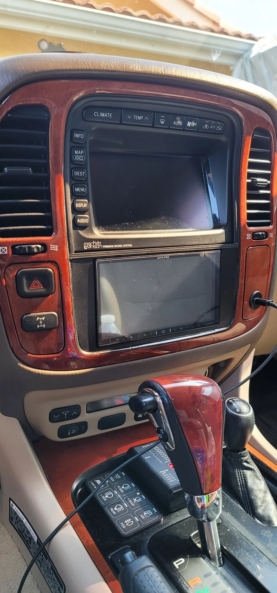

Here is my end result.. after a year of work
Got every speaker, subwoofer and tweeter swapped out to Alpine. Added a touch screen. Relocated some oem buttons. and finally put the subwoofer behind the 2nd row seat. It makes the 3rd row a little smaller, but that space is never really used
now the sound system is banging :)
Lovely! What is that magical creature where the stock ashtray panel lives? Can you share the design with @BenCC ?
