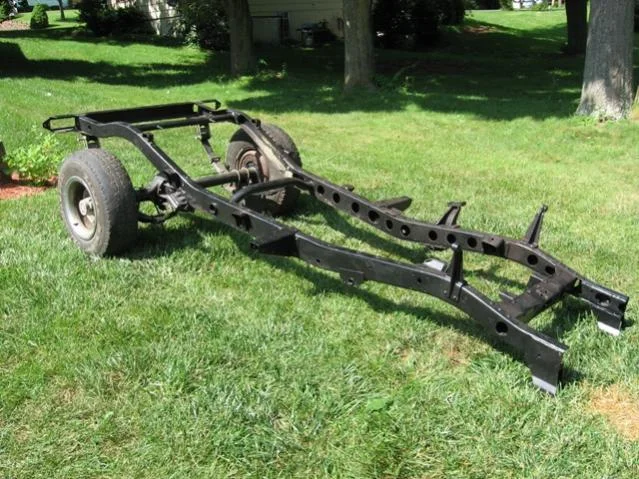

That frame work looks nice!

sooo much progresss!!! the pics will tell the story...

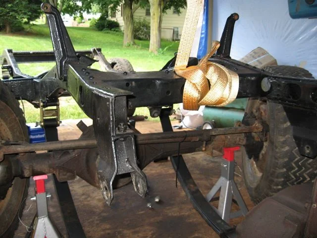

finally got to finishing taking the frame/suspension/axles apart..
but first i had to get the driveline off.. sold the tranny/transfercase to a great guy named Jim.. he along with my father and my neighbor helped me get everything off.. safely..

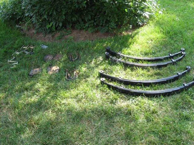

probably just going to blast the springs and paint them as packs.. they are bran new and only have a little bit of rust from sitting for a couple of years..

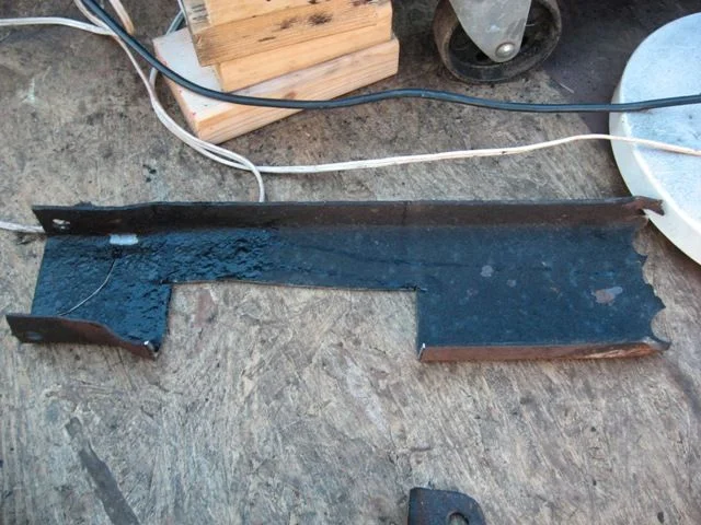

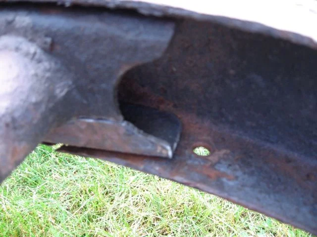

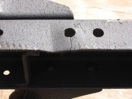

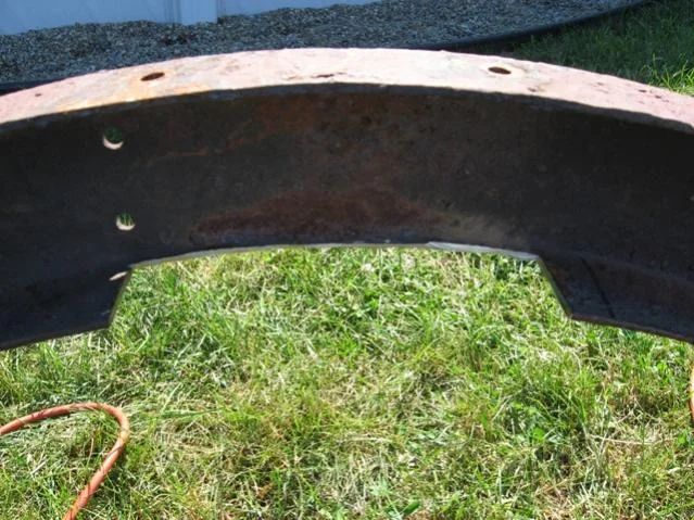

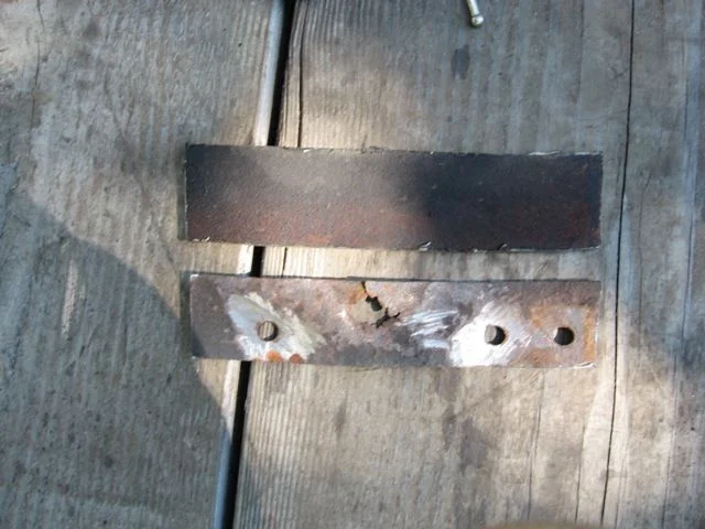

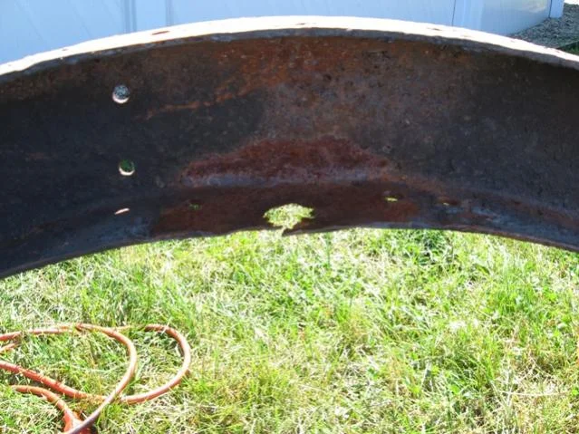

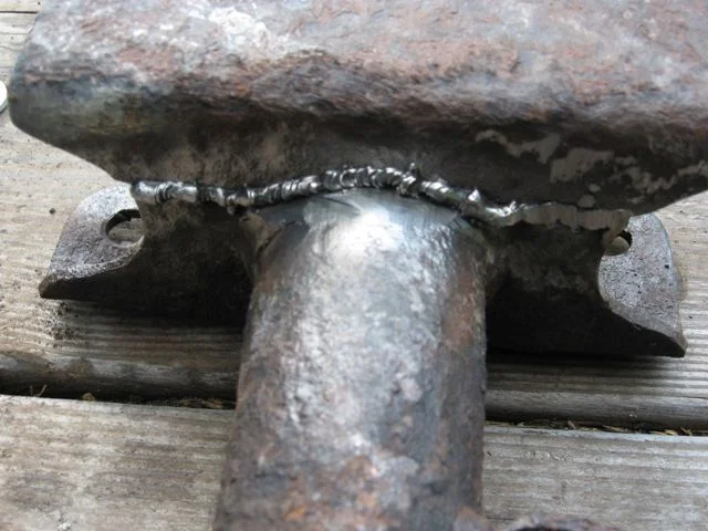

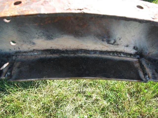

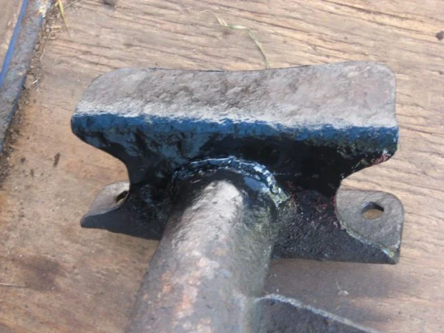

it's a lincoln 140C.. i know i know.. its not a 220 but it served me well.. and it was a ton of fun. this is the work I did on the frame.. please criticize anything you think is not right..

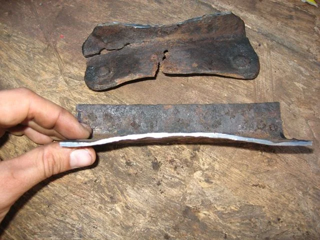

here i'm fixing the upper shock mount crossmember.. one of it's tabs was completely rusted out.. cut a basic shape from a scrap piece of frame i have.. beat it with a hammer to get the curve.. then ground it to the right shape..
and.. now a question.. now that i've repaired the crossmember and the frame.. the crossmember won't fit in easily.. i wanted to get the frame blasted and powder coated to save me some time and since it will last longer than a rustoleom paint job, but i had wanted to do the crossmember separate since it is already apart - if i do that i'm worried i will scratch the powder coat trying to get the crossmember back in... so my question is do you think it will be alright if i bolt in the the crossmember and get it powder coated bolted in? I think it's my only option but just wanted to get some other opinions..
oh and the concert was awesome... went to see mindless self indulgence at the webster in hartford (never heard/seen them before) and they were pretty darn good.. damn i love the mash pit..
If it is bolted in and then powder coated you should be fine. I might spray some weld through primer in there before you reinstall it, but more than likely the powder will seal between the crossmember and the frame a little bit (not THAT well though).
I really don't think you can go wrong wither way, but if you choose to install them after powder coating them separately the powder should still be flexible enough that maybe it won't scratch too much. You could also use a little soapy water to help lubricate things as they go back together.
Really I don't think it matters much. I've done both ways, and been happy with both. I won't powder coat stuff apart that is pretty close tolerance though, as then you end up sanding the powder off anyway, which sort of negates the benefits of powder coating it separately in the first place.
Dan
Dan - yea thats what I was thinking about doing.. thanks for the confirmation on that.. i just don't want moisture to get trapped like what happened in the first place. I'll probably do the primer and then get it all together.

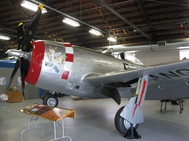

colorado was sweet though - got to see some nuclear launch facilities and silos (saw the silos from a distance) and got to see where they make the atlas rockets which send satellites into space - good times. also glad i didn't go to the academy :) got some pics down below... a picture of the chapel.. a view from eagle's peak (9200 ft) and one of a restored plane (yea i forgot what it is.. P-47?) at the Peterson AFB museum.. it was restored by all volunteers.. quite and amazing job.

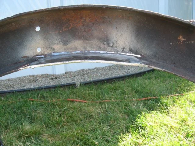

well this isn't cruiser tech but it is what i was working on all week.. my mom wanted me to trash it but i can't stand to get rid of my S10.. the rear end blew and when taking off the axle to replace it with one from the junkyard i found the rear spring/shackle hangers were toast so it ended up being a lot of work... and then i went overboard with cleaning up the springs/shackles,axle housing and new brakes all around - man it is a lot cheaper than a cruiser (a wheel cylinder only costs $6.00 :) and the drums auto adjust since i got an axle from a '87
here are some pics - i start back on the cruiser on monday.
