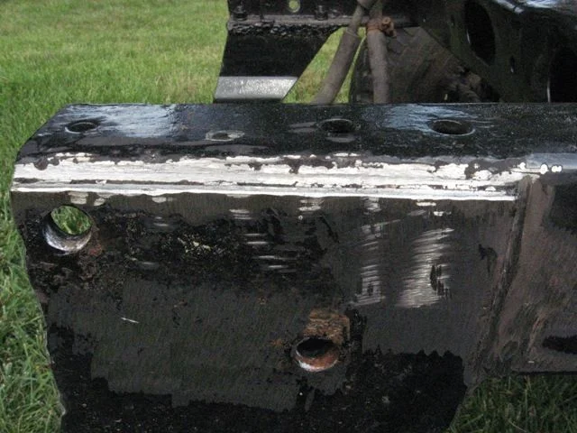

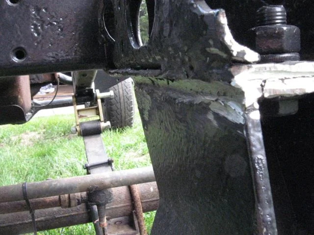

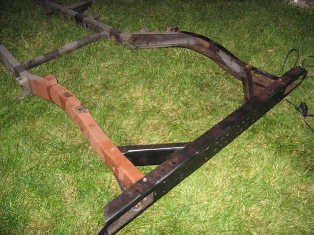

then i went to start grinding off the crappy welds from the PPO.
also found out that the frame is not a 78 frame.. and that it is a 71 frame..... not that big of a deal to me since i have a late model rear end for it.. but you guys are the experts here - will I have any problems? i'm thinking this crossmember might be an issue once I actually have mounts for the engine and bellhousing on there will the transfercase be too high?
and some before and semi after pictures of grinding the welds.. it started to rain when spencer came over so I didn't get any final pictures in..

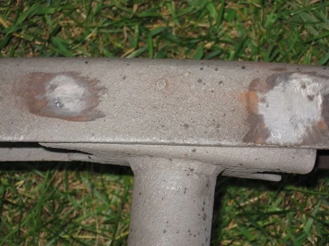

frame paint
for the frame you might want to check out rust bullet I used it --it's real thick and you have to topcoat it cause it is not uv stable but it appears tough as nails. The thickness might fill in some of the pitting and you can use their top coat in satin black
I used por chassis black
Eastwood does some stuff too
You probably will need to cut the crossmember and rotate it for clearance if you are running a 4-speed transmission.

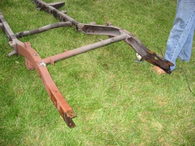

alright once again i changed my mind.. but you'll understand i think.. the frame i was going to use.. ended up being a 71.. so the frame that i got from dentdepotsales.. which is a 78 is the one I'm going to use since I won't have to worry about issues fitting everything up.... The 71 frame might have worked but at least this way i'll know it will work for sure.. so i got to work on it - grinding off the rivets in the rear end and drilling them out so that I can fix all of that rust..
my dad even helped me out! he broke a lot less drill bits than i did... WD40 helped was key when drilling out the rivets. I used BLU-MOL drill bits and they cut through the rivets like butter - i used a small bit, then a medium sized one.. and then the 3/8 bit and it got the rivets out no problem.

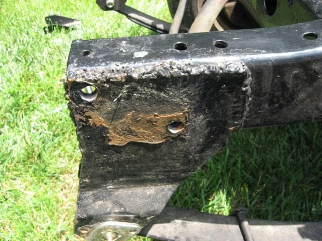

the only other place of rust on the frame is the rear upper shock mount crossmember on one side.. aparently i didn't take pictures so i'll take some more to show you all how bad it is - my welder comes in tomorrow so if it's nice outside i'm gonna see if I can get some practice in on scrap metal...

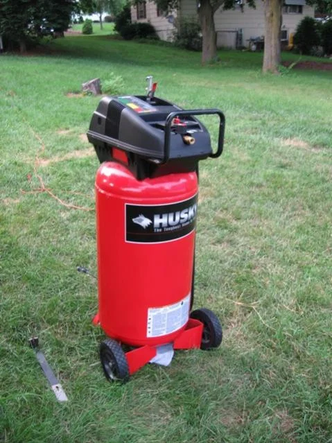

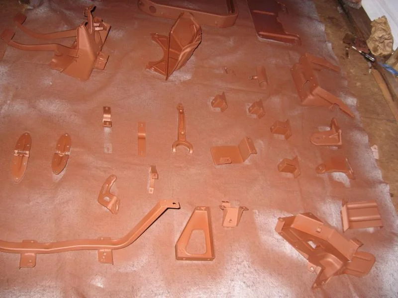

now for the frustration part.. i got my 40 lb pressurized sand blaster from HF and i couldn't get it to work for the life of me.. I had some media from my friend that was probably used stuff and i didn't sift it out.. that didn't work so the next day i tried walnut shells that i bought from HF.. WAY to big for the machine so i need to return them.. anyways the thing was clogged up in every valve possible with walnuts so it took forever to clean them out. finally i found a screen door and just bought some playground sand at homedepot and the damn thing started to work!! that was yesterday.. after 3 days of dicking with the thing... anyways on monday when i couldn't get it to work i decided to try out my other new tool.. a HVLP gun from lowes... worked awesome!!! that is the rustoleum rusty metal primer...
as you can see above i only have a 1.5 hp 26 gallon compressor.. it doesn't last very long at high pressures.. but it did work well on my aluminum stuff at like 30 psi :cheers:

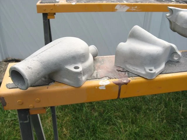

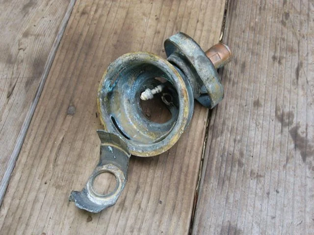

i'm not going to rebuild this engine.. just taking off all of the parts to re-seal them up and give them a cleaning/painting.. check out the thermostat...

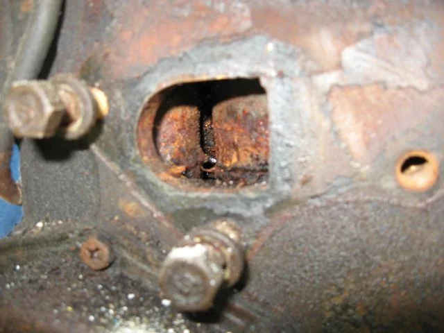

also anything i can do to clean out the cooling system? it looks pretty rusted inside the block.. i think i'm going to get one of those inline cooling system filters so it doesn't get clogged up..
