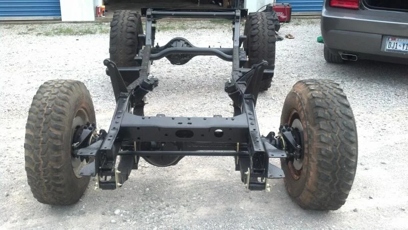

let's see... I've got the chassis rolling - I rebuilt the front axel/knuckles with a FJ60 front end. I've got the motor all cleaned up with tons of new parts... enjoy the pictures

The front tires look alot farther out from the rears. Is that from the 60 knuckles, spacers, or am I seeing things?

I think it is a difference in backspacing in the rims that makes it look wider in the front...
