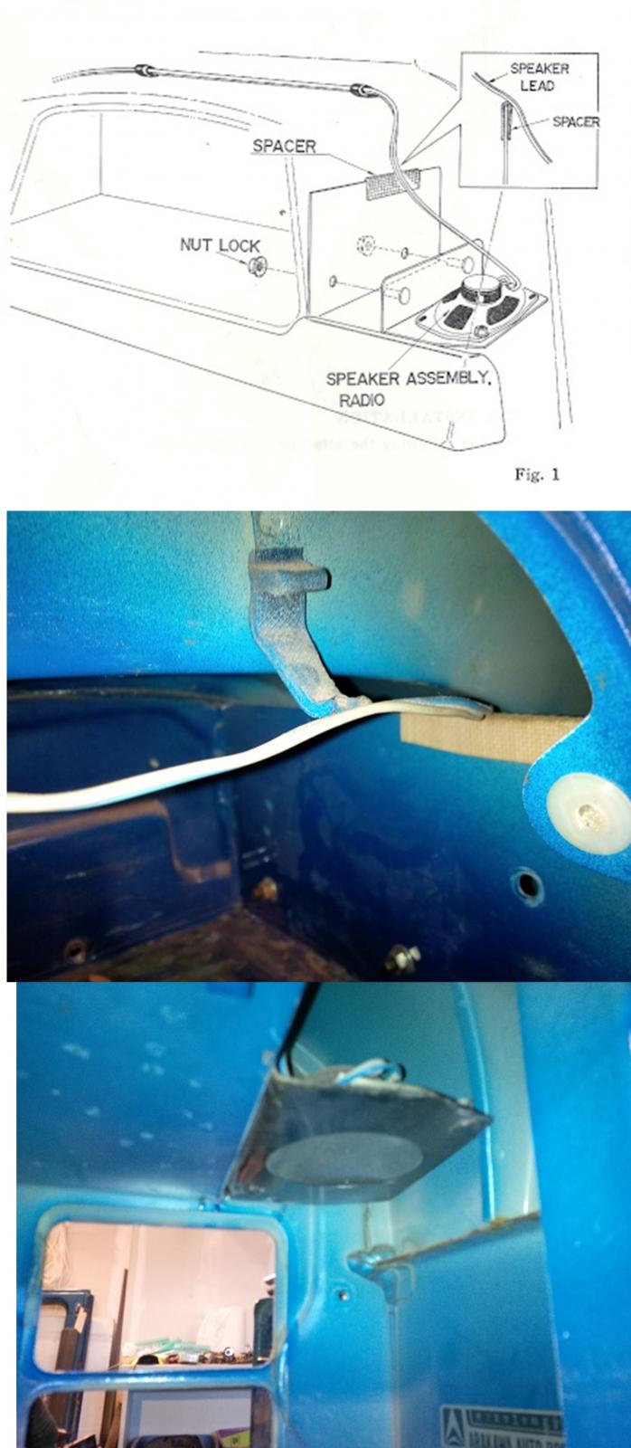

I think I cracked the myth about where the Antenna should be.
I have a left hand drive 1979 BJ40. As per the catalogue, note the wire loom/firewall grommet and spacer (avoiding contact with metal parts):
The same wire loom/firewall grommet is there again, and the spacer is called up near the speaker:
The same arrangement for spacer is shown here (sorry for not referencing as I downloaded it years ago):
SOR shows wire loom/firewall grommet on both sides:
So I think it is okay to conclude that the Aerial will be near the glove box, i.e right hand side.

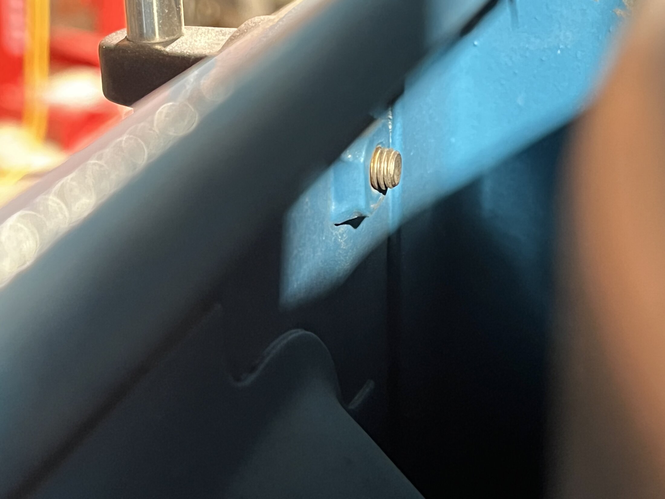

Do you have photos of weld nuts inside the cowl apron? May be the aftermarket panels don't have. It would be nice to see for comparison.
Here is a picture of the upper weld nut. The lower isn’t visible to my camera.
