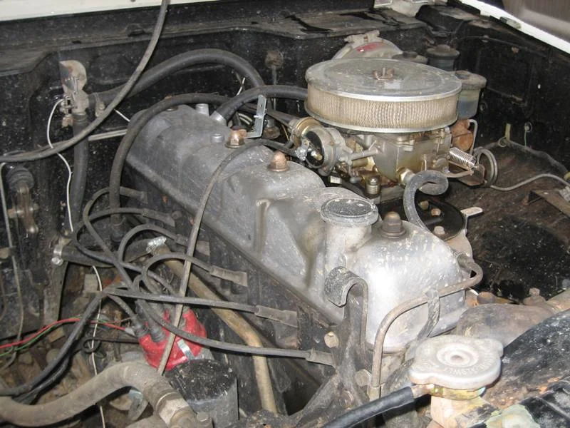

Original '74 1/2 f engine was on its last leg so I dropped in a good 2f complete with man a fre header, mallory dizzy and motorcraft 2100 carb.....pigmtr.webp
While I had the engine and drivetrain out, I wire-brushed the engine bay and underbody and coated everything with POR 15.

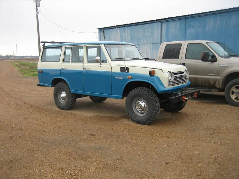

The pig has been a great family hauler/grocery getter for the last year, but I wanted to make it more trail worthy. Naturally, I needed tires and lift. I had originally planned to go spring over, but over the past year, I realized that I wanted to keep the good street manners, and I'm not really that interested in hard core wheelin' anyway. After much research, I decided to go with the SOR heavy duty 2" springs and 33's. I wanted to keep my stock wheels and hubcaps so I went with tall skinny BFG 33 10.50 15's. The 33's really improved my off road AND highway driving.
Here's a poser pic with the lift and 33's

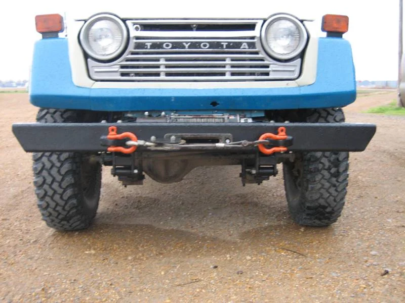

Most recently, I built a custom bumper with recovery points and a winch mount. I mounted the winch low, behind the bumper, and mounted the solenoids under the hood, to keep the front grill "clean".
Other recent mods: custom built shackles(2" over stock front, 1" over stock rear), new exhaust, new shocks, POR 15 on interior floor, rebuilt door hinges, shoulder seat belts in front.

Ahhh - what dreams are made of - outstanding job Battle and nicely balanced between stock and the other end of the spectrum..... have you got all the visible rust issues dealt with?
thanks. As far as rust goes, I feel pretty good about everything except the rear fender lips. I'm getting some paint bubbles there that will eventually need to be addressed. Front fenders, rockers, body mounts were all rebuilt/replaced with new metal, so I hope it's good for another 30 years or so. I use this pig offroad, pretty often in the mud; I have made it a practice to clean it up asap after getting it muddy. I think keep it clean and parked inside when not using it, really helps keep the rust gremlins away.
