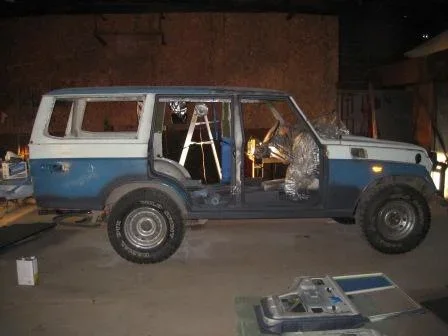

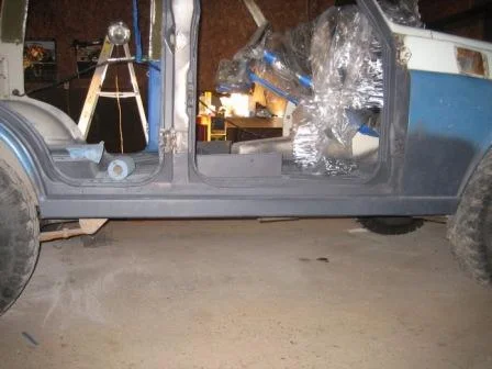

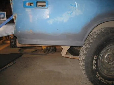

Been checking out this ite for a few months now and decided its time to tell y'all about my project. It's a '75 that had typical rust for pigs-front fenders, rockers, lower rear quarters. Finished up most of the body work last week and have been working on interior since then. I'm planning on keeping it stock except for axle upgrades and low spring over... primerpig.webppigrocker.webppigrrpnl.webp
nice looking pig!..........my rear wheel openings look like crap!........did you replace the rust with steel or fiberglass patching?
I pretty much replaced all the rusted out areas with new steel...
on wheel wells, there were holes rusted through in the flared part, but there was enough metal left to put a patch behind the holes and weld them up with a mig. I had to cut away parts of the inner fender and fit some little 1" x 2-3" curved peices behind the holes. I then put a thin layer of body filler on top to smooth things back out.

I modeled my rockers after the rig in toyota trails march/april issue-was that your truck?
