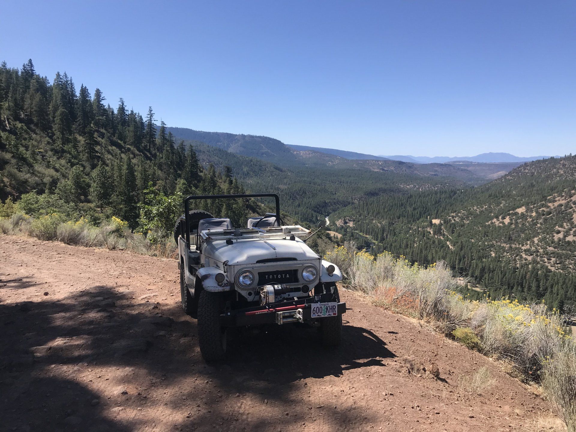

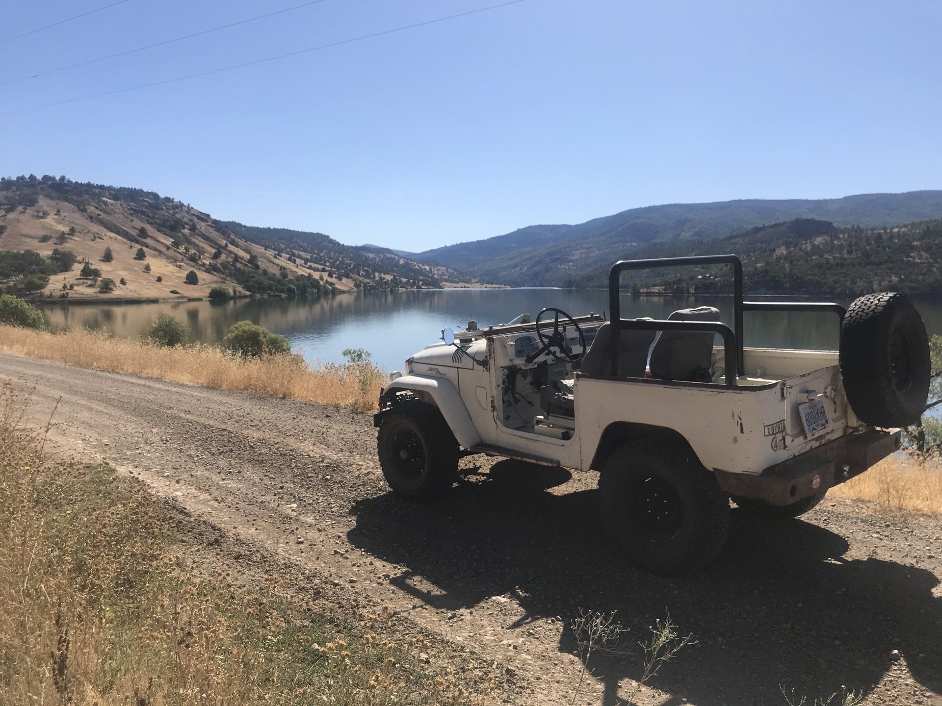

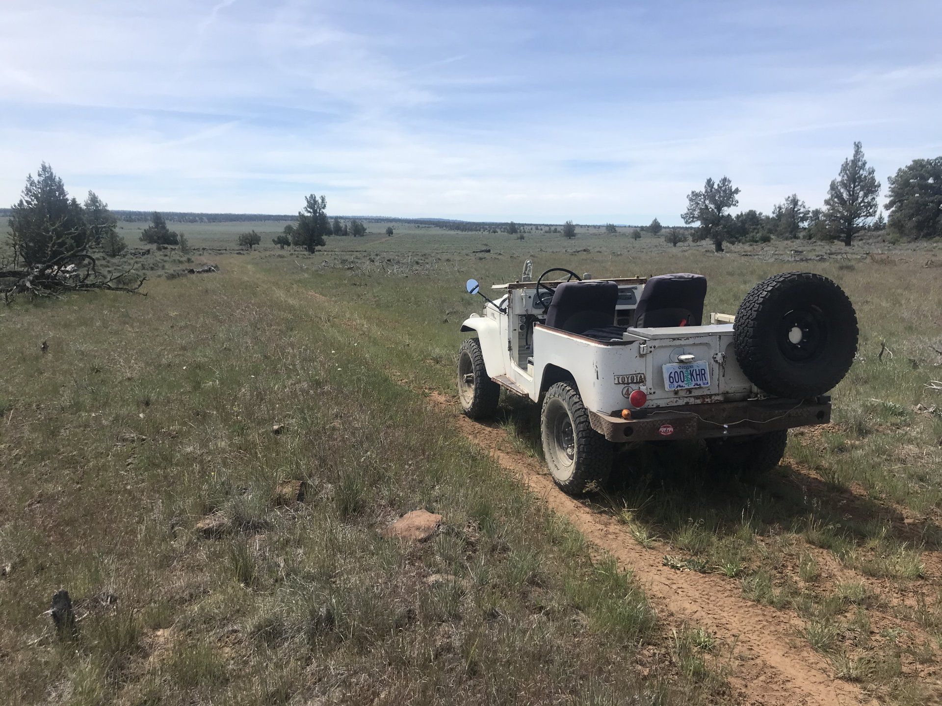

I did finally get a chance to take it out on some easy trails, and it performed well. It crawled better than I anticipated, and is very smooth at low rpms. It doesn’t have the torque the F motor does, but it has enough for the moderate wheeling I use it for. It does thrive on backroads, I haven’t accurately calculated the MPGs, but it is in the 25 mpg range. With a 20 gallon tank, that gives a comfortable range of over 400 miles. Here are some pics of that trip:

A couple of action pics from when the days were warm and long....

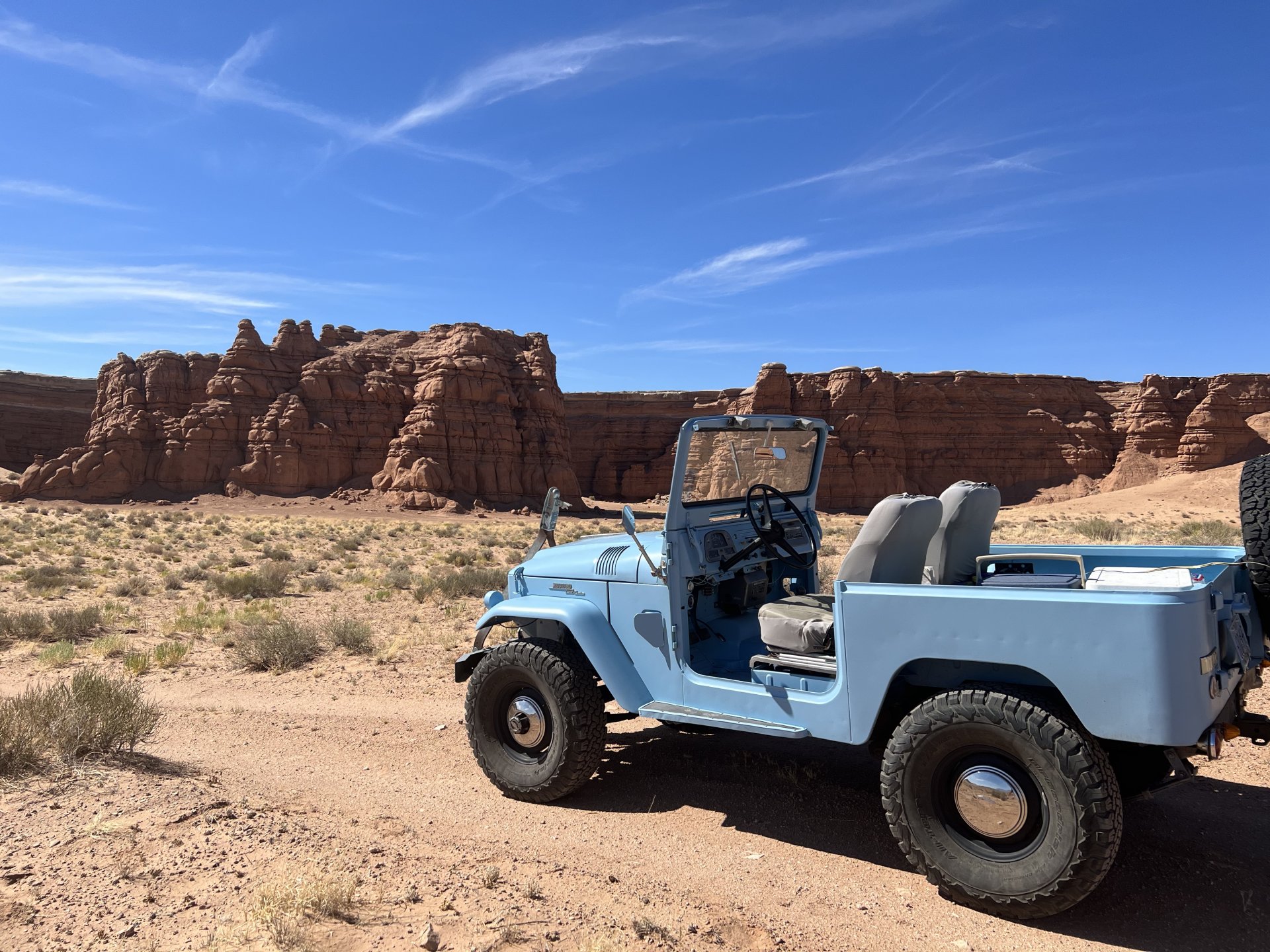

Sheesh-looks like it has been almost two years since I posted an update in the diesel forum. Still super-reliable and comparatively efficient. I recently took it to Moab and the one issue was that it runs too warm under extreme conditions (100+ degrees, long grades) Temps got up to 220 or so. In my conversion I used a budget three-core aluminum radiator. Should have forked over the extra $ for a five-core. If anyone else is considering an OM617 swap, I recommend not skimping on the cooling system.
