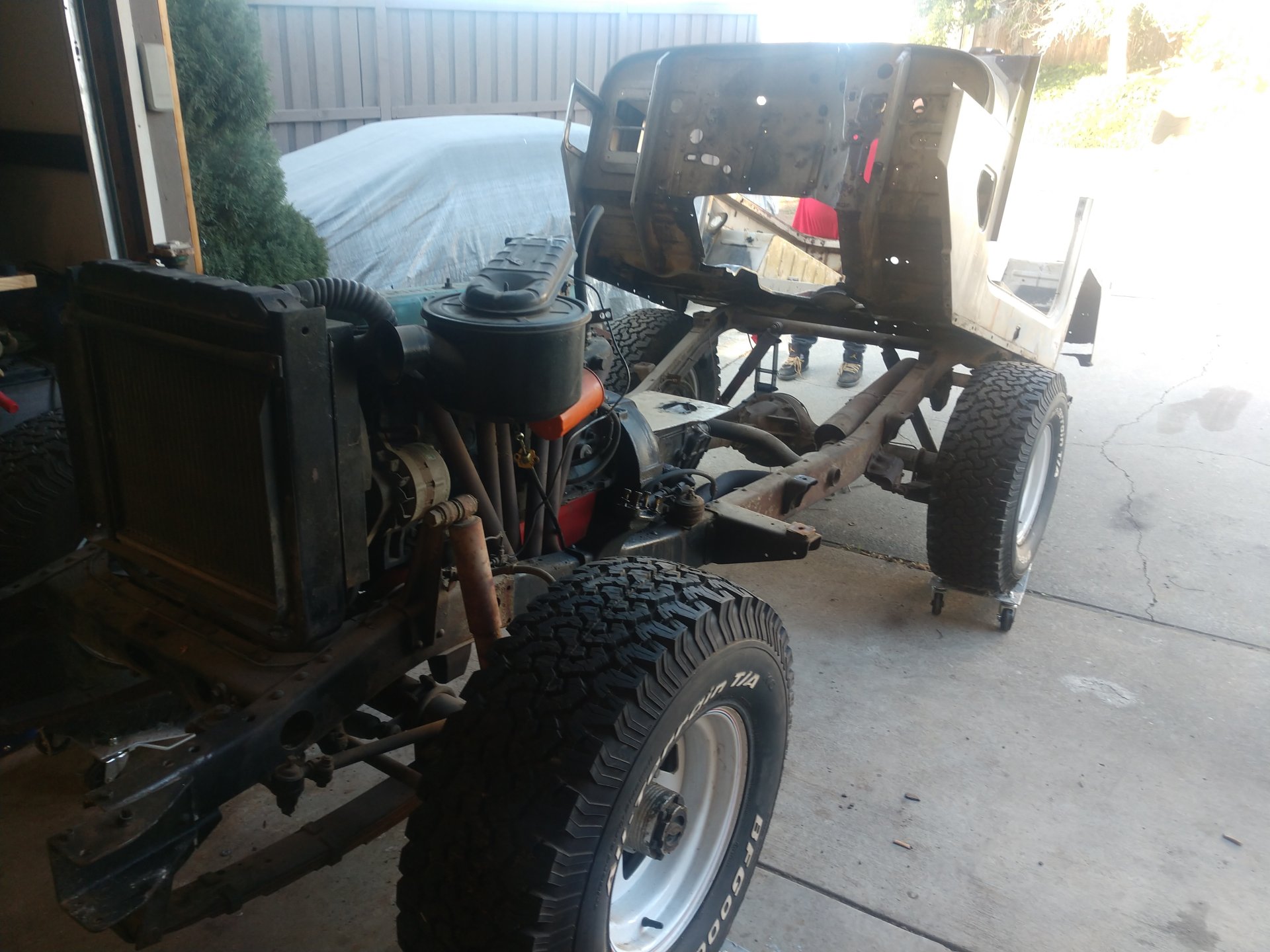

Its a father and son project. The plan is to bring it back to showroom floor condition. We've currently got it torn down and have a lot of work to do. From replacing the rear sill, rockers and quarter panels, going thru the engine, tranny and transfer case and probably some upgrades. I figure its going to take a while and about a half a ton of cash to get it to where we want it to be.... Back in the the mountains, better and badder than ever.
After the first few days of the teardown. Got the doors off the lid off, the sides the rear hatchback door off and roll bar and seats out.

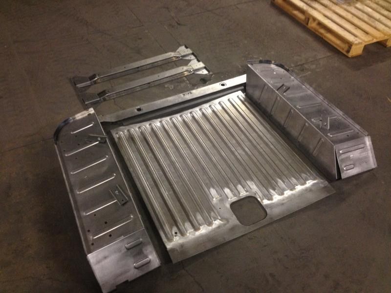

Real steel out of chicago is cheapest place to get body metal from.
Thanks a lot Shipmag! I greatly appreciate the advise. We'll be needing a rear sill, both rockers and both rear quarter panels. The rear sill was solid rust and the rear quarter panels had enough bad cancer on the lower areas and covering the ends of the sill as the previous owner (The guy I got it from almost 40 years ago) had just slathered bondo over the rusted areas without any surface prep. I'm sure that it just kept rusting away all nice and hidden. Then I found that there were nice 3" areas in the center of the rockers that were done the same way.

Get in touch with Dan@4wheelauto.com for your Awl_TEQ rear sill. Had them in stock last week. Best price and quality around from what I can find.
Thanks vfrer!
Nice! those are the best looking sills I've seen yet and they come with the sill cover to. I was wondering if I was going to have to attempt to fabricate my own and now I know.

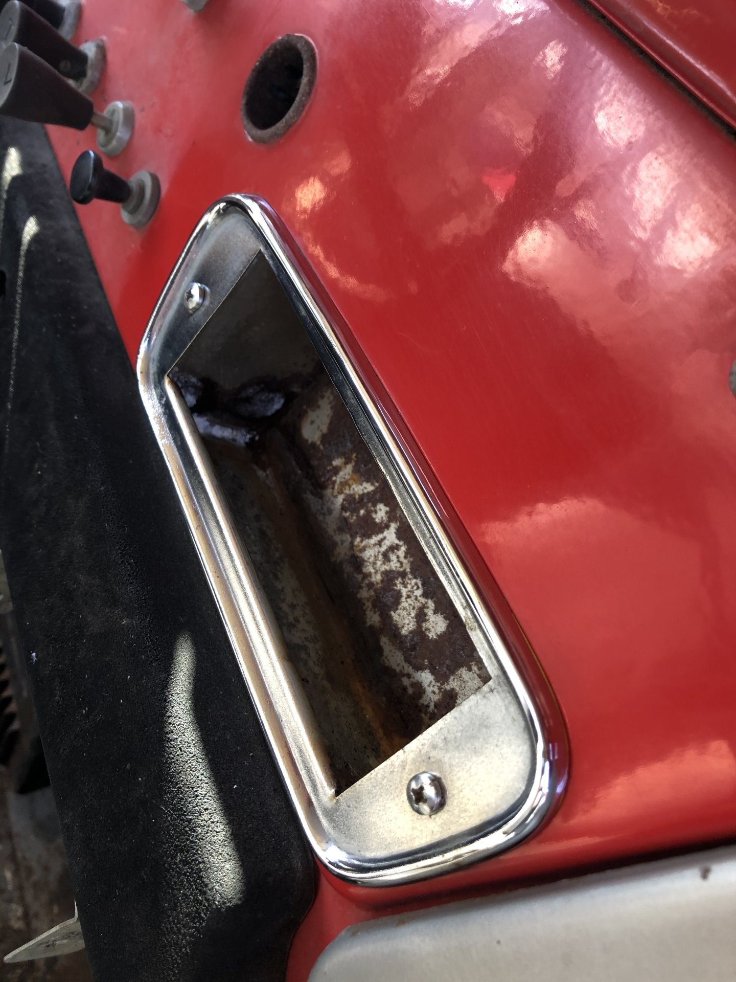

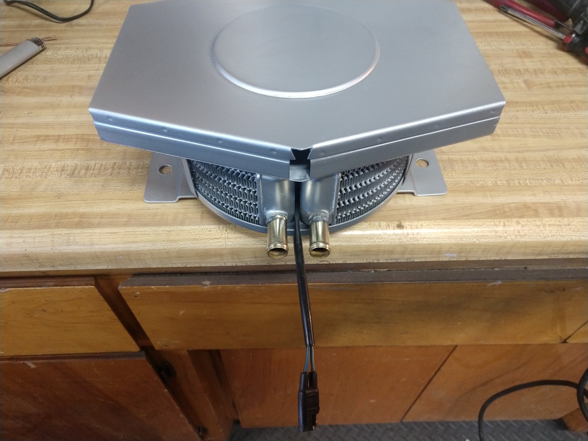

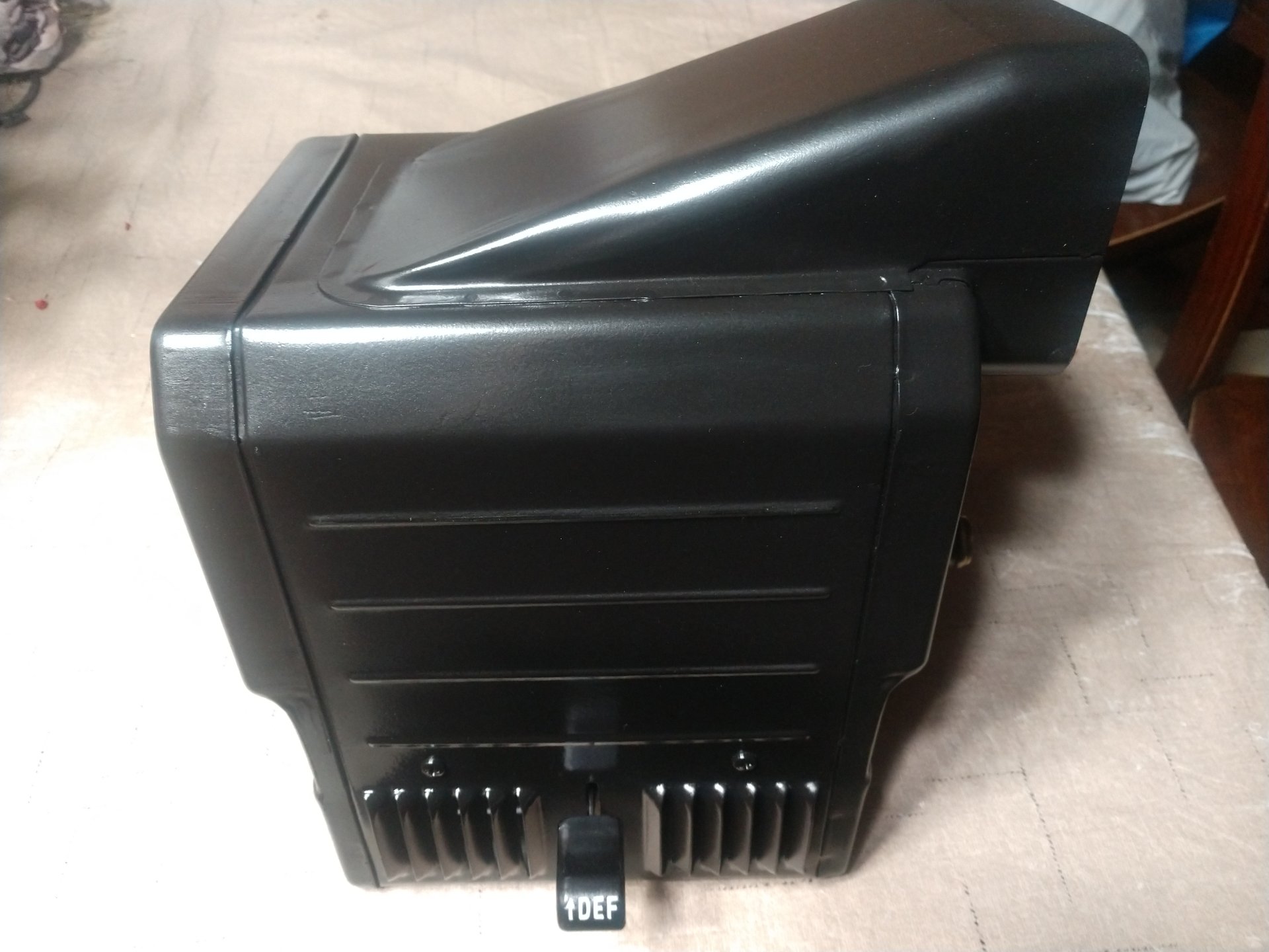

I've been working on smaller components since we're waiting to take a 3 hour drive to grab a compressor that will work with our media blaster. Figure we'll do that in a couple weeks. In the meantime things like the glove box door, ashtray and front and rear heaters are in process or completed
I think they came out pretty decent considering they shape they were in before I started.
Looks great. What color did you use ? I just did mine as well and look pretty much the same
