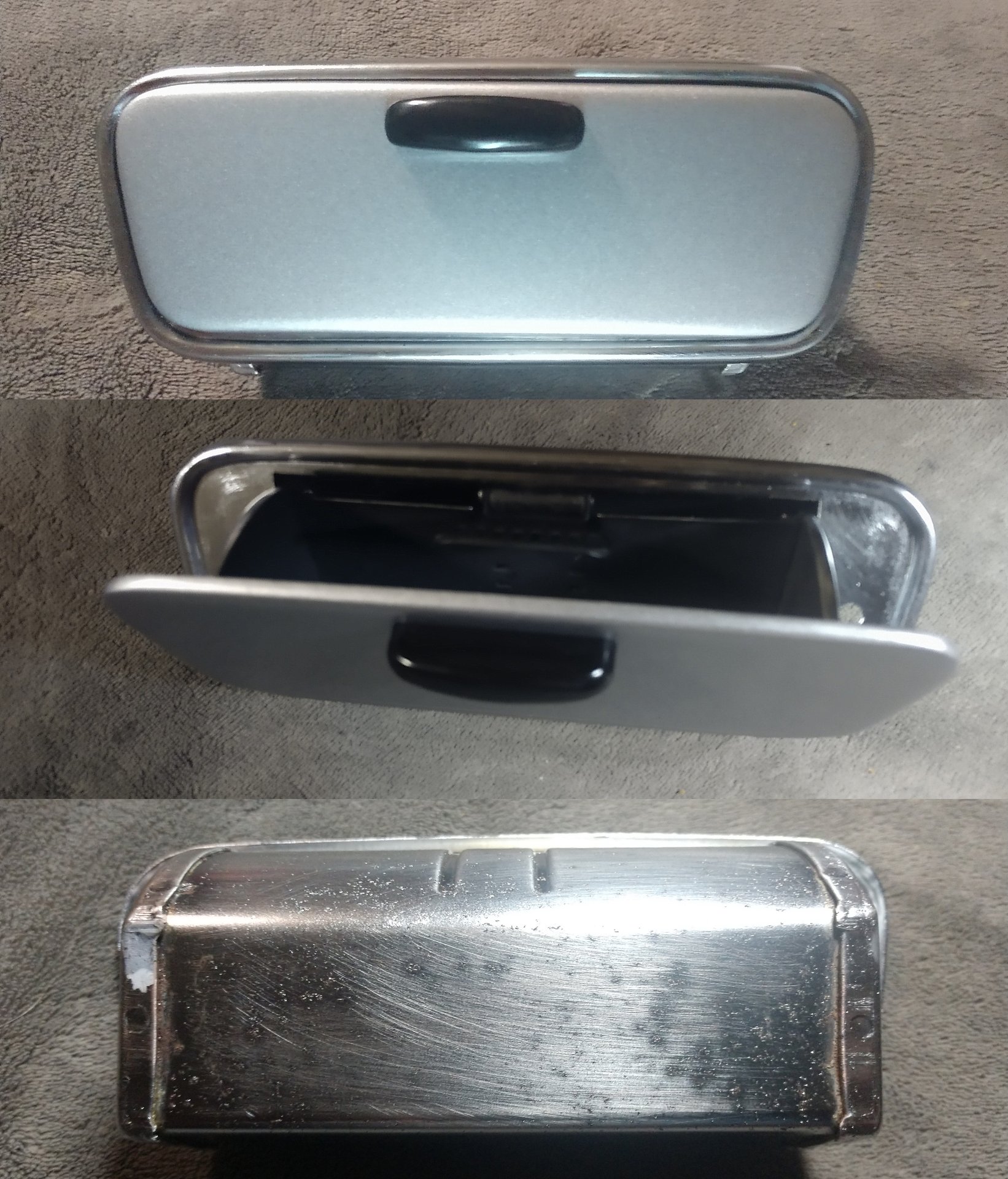

I had a fair amount of rust on the backside and the inside of both the dash part and the ashtray itself. I spent quite a while using a Dremel and doing my best to get rid of as much rust as possible. The used Rustoleum Rust Remover to eliminate any rust that remained. Since its an ashtray I decided it needed to get a bit of Rustoleum 2000° Ultra High Heat Black spray on the inside of both parts. There was a little pitting on the grate so it received some cleaning and a coat of the High Heat Black as well. I was careful not to paint the roller which as in pretty good condition. The front plate got a coat of primer then a couple of coats of 1E7 Toyota Silver Mist and a couple coats of clear topcoat on both sides. I'm going to be using that for all the components that were factory silver. Its a bit brighter but looks good. For the grab I darkened it with an Acrylic Black Dye and then used a Clearcoat designed for plastics. When it came to the Chrome areas that would be visible I used some 6000 grit buffing paper and then ultra fine steel wool prior to applying a thin topcoat for protection. I may eventually decide to acid wash it and re-chrome those areas. For now it looks pretty good.

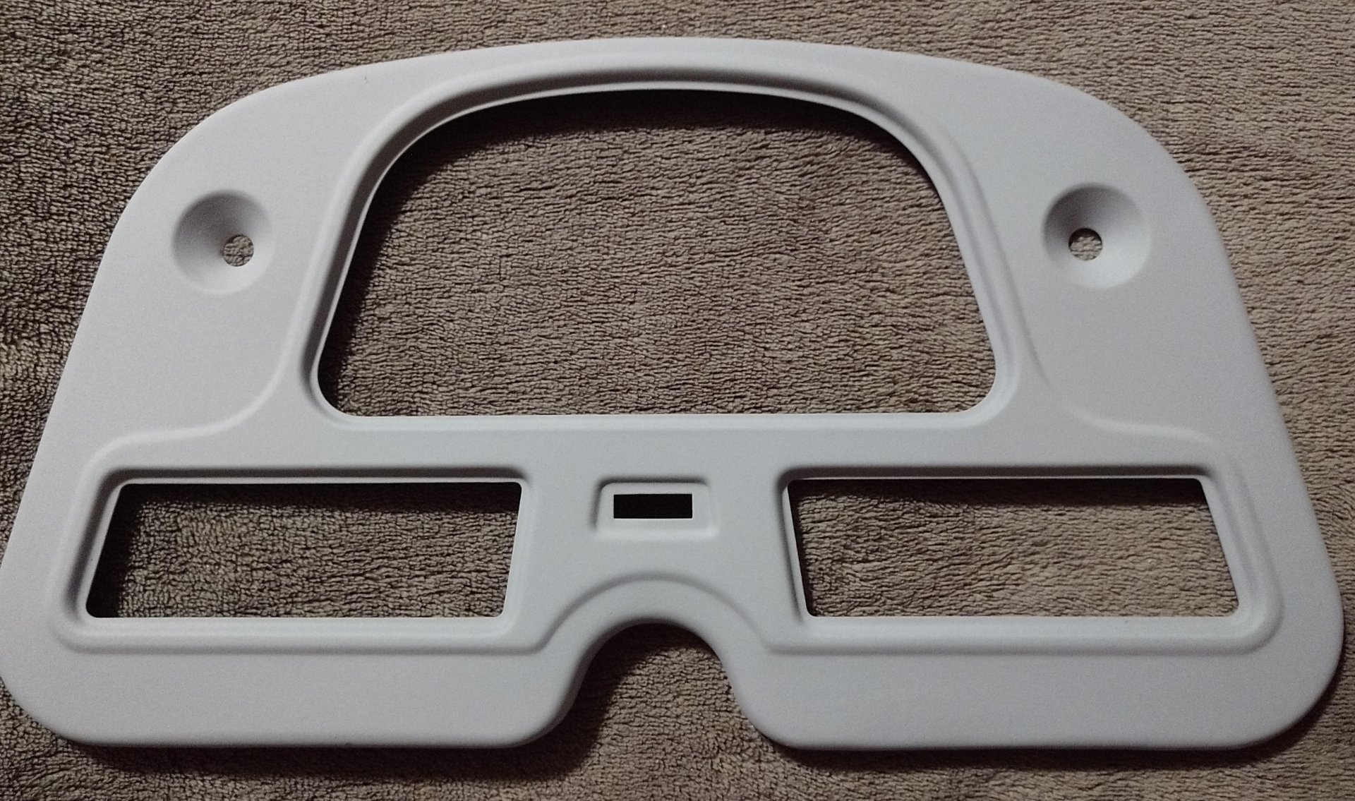

UPDATE... I was able to boil the entire Front Instrument Cluster plate and apply glycerin, wash, rinse, repeat and the glass seals softened up enough to remove the glass. I was then able to remove all the seals from the plate itself. The Fuel / Amp side seal was a little to cracked and a couple of small areas broke off. At this point I've been able to remove most of the dent below the Fuel / Amp gauges and have applied a super thin glaze. I'll be sanding and priming it in prep for 1E7 Toyota Silver Mist and clearcoat. More photos to follow.
Dent repaired and primer applied. It came out pretty good I think.

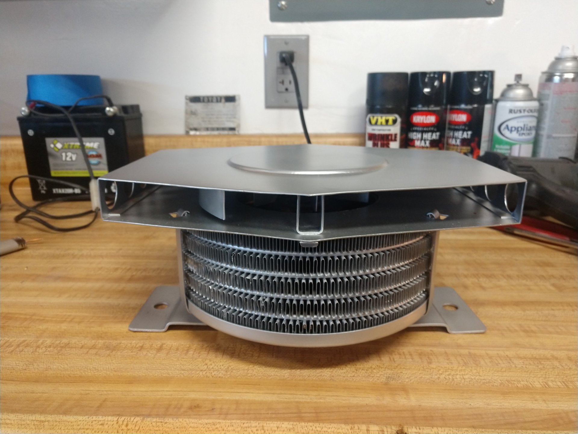

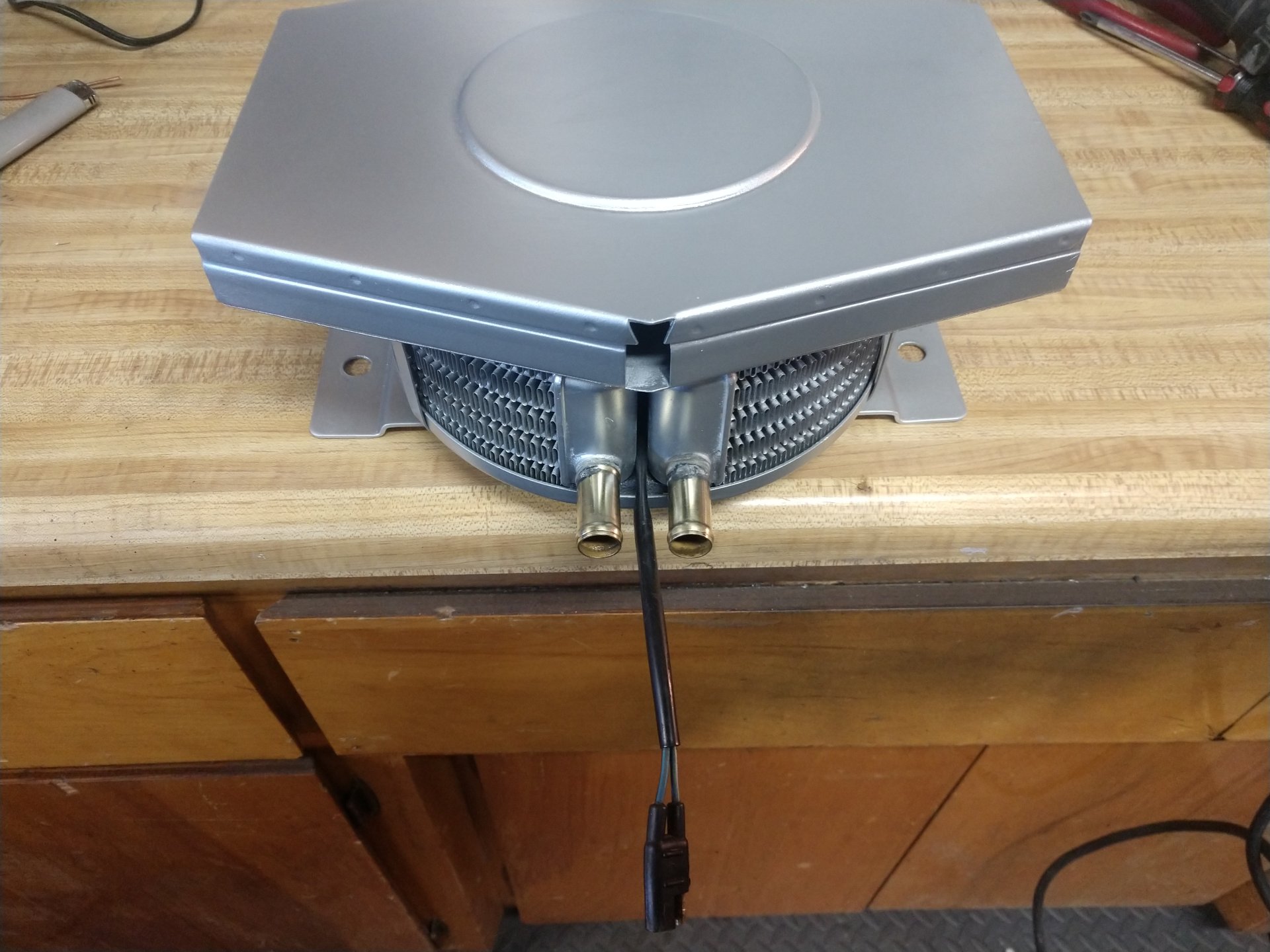

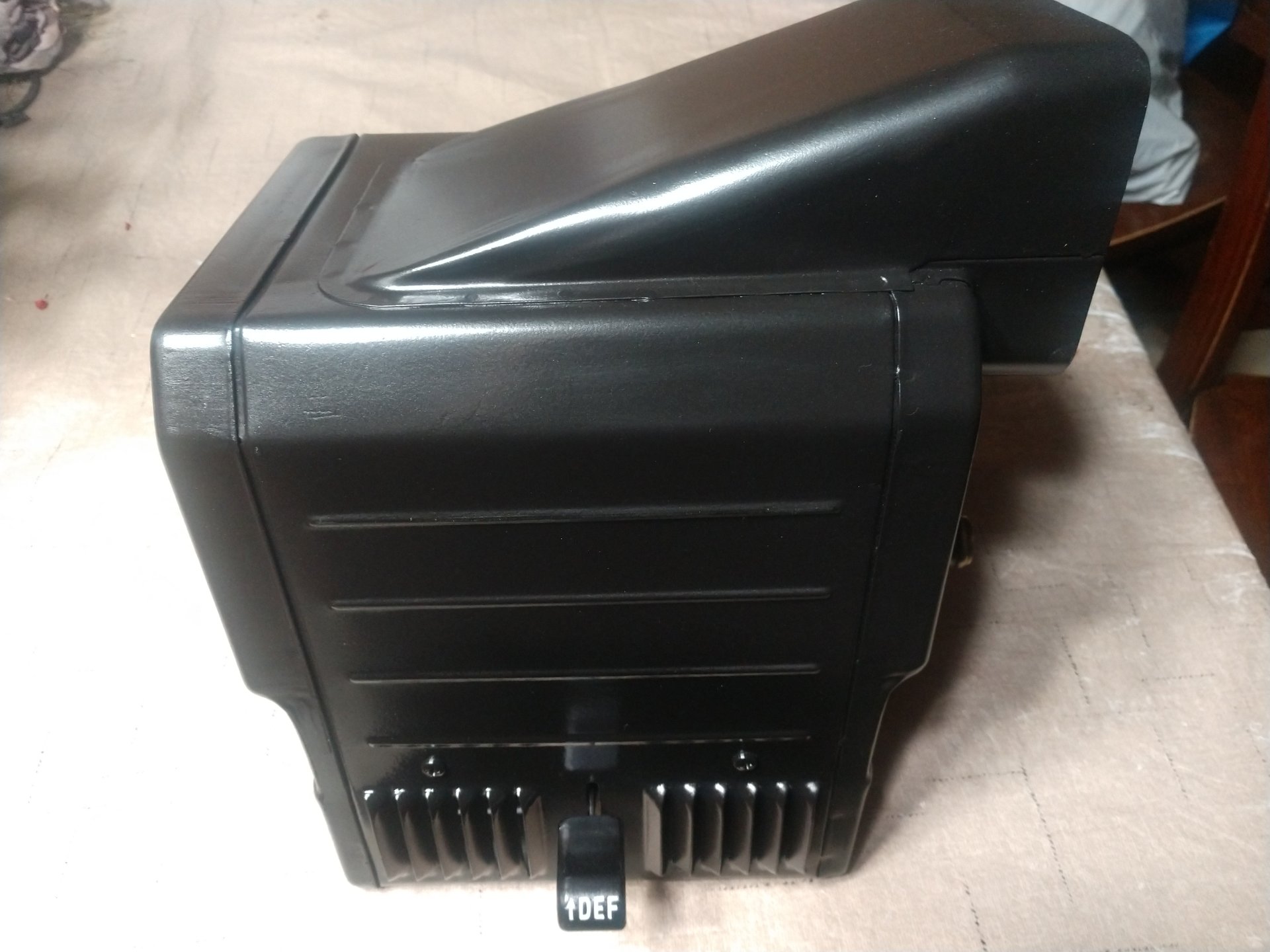

I've been working on smaller components since we're waiting to take a 3 hour drive to grab a compressor that will work with our media blaster. Figure we'll do that in a couple weeks. In the meantime things like the glove box door, ashtray and front and rear heaters are in process or completedView attachment 2959425View attachment 2959429View attachment 2959431View attachment 2959432
I think they came out pretty decent considering they shape they were in before I started.
that's the best heater I've ever seen! great job!
