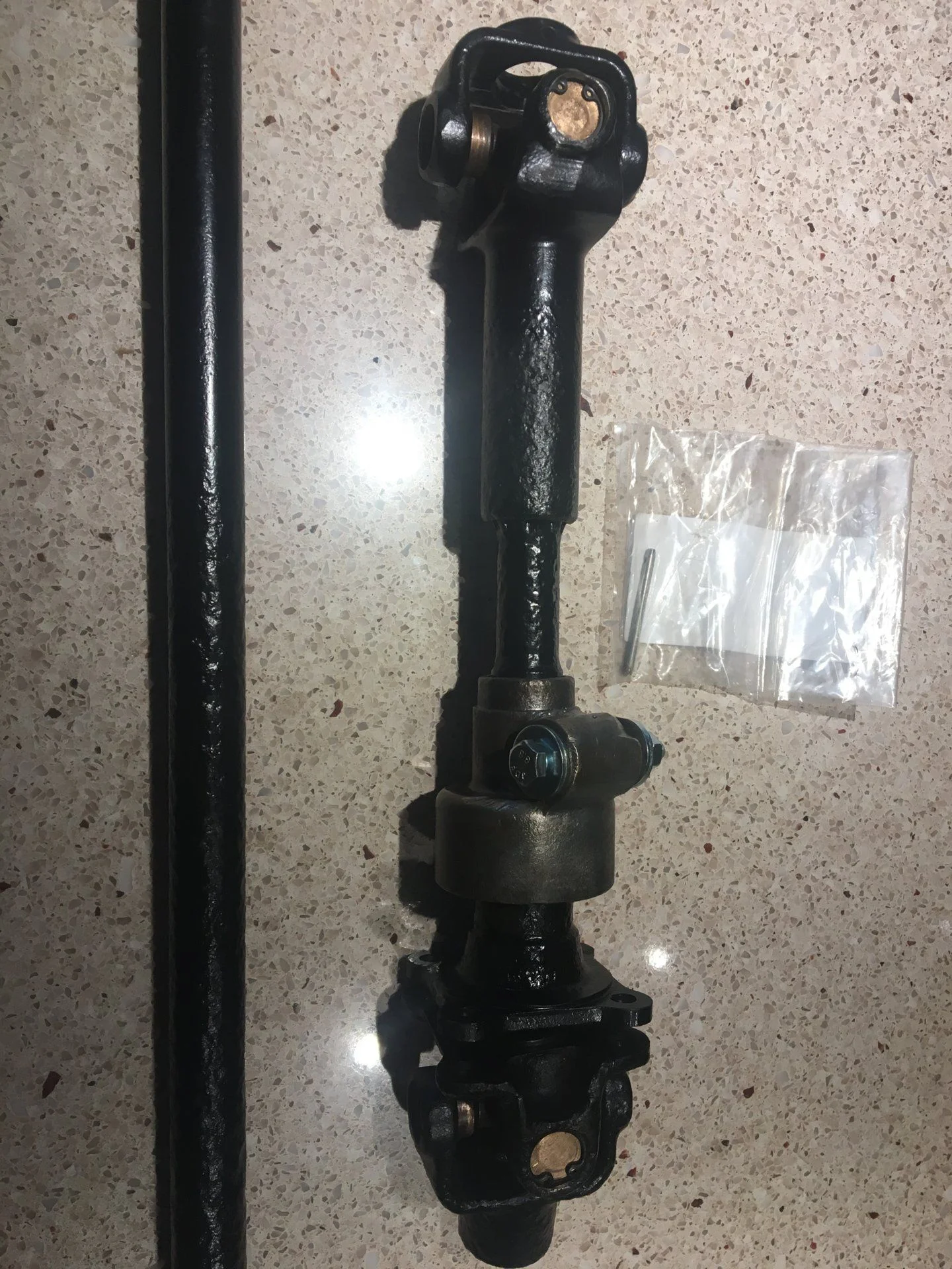

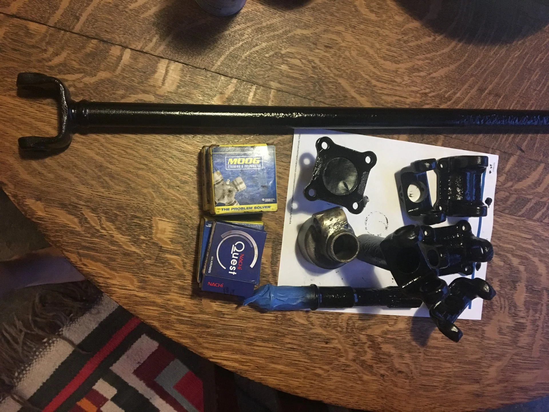

PTO shaft ready for reassembly.
As has been previously discussed (but I obviously missed). The early pto ujoints are NLA and the 395 joints are for the newer shafts. So I ended up cleaning and reusing the original joints.

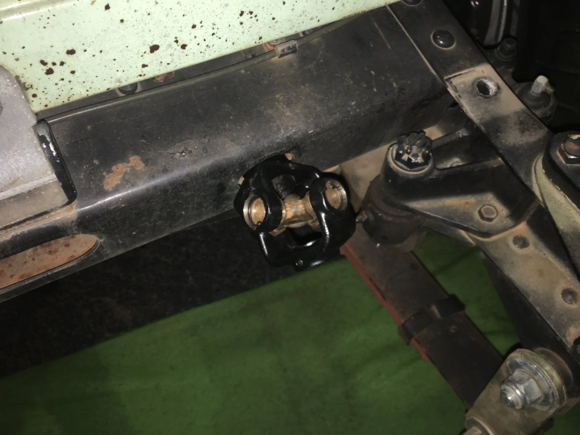

Ready to install
One step closer. I just realized the shaft is from a 4 speed so I have to shorten it about 4" and I should be up and running.
One step closer.
More than a year after I bought it, it's officially operational.
