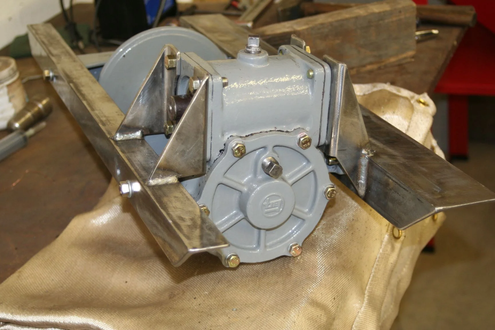

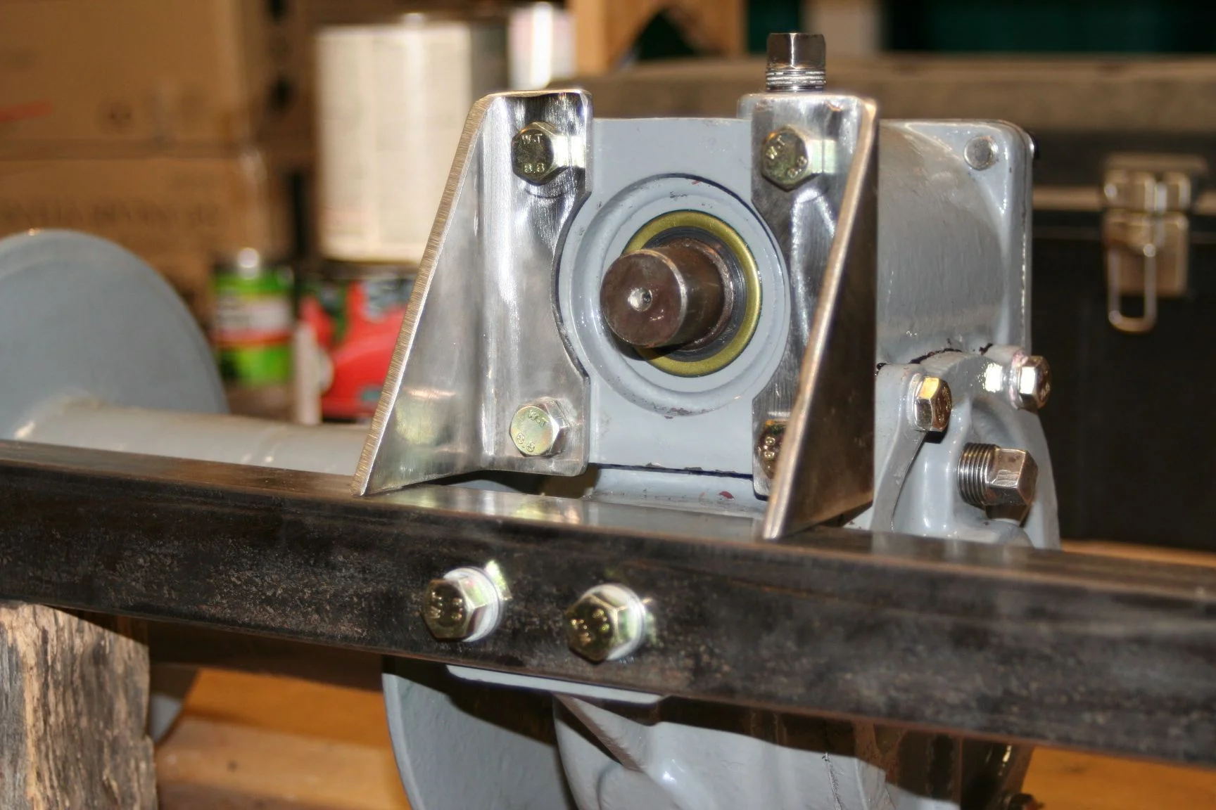

Here's a neat idea I stole from some of the guys on the forums. Braces for the gear box, keeps it from cracking the mounting feet...

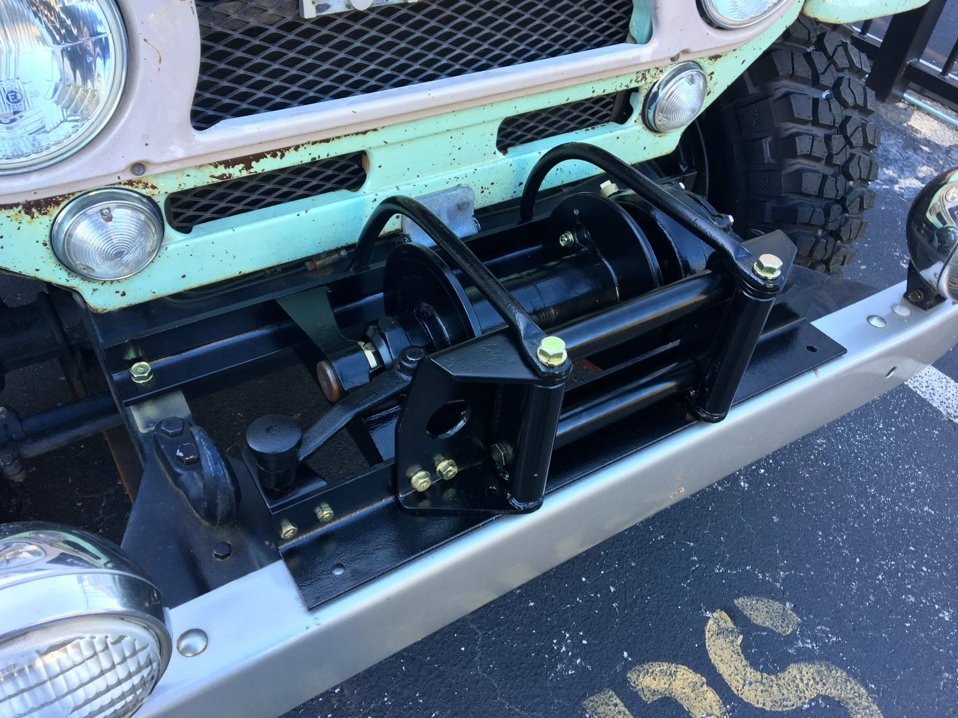

Can you take a few more pics and provide some details on the brake booster/master cylinder you are using? Looks like it fits, and you didn't cut the firewall rib.
Thanks in advance.
Spacer is from Mark A. The booster is a mini truck booster with a non ABS 80 master. It only fits with an F manifold. The 2f manifold sticks out to far and the carb hits the master.

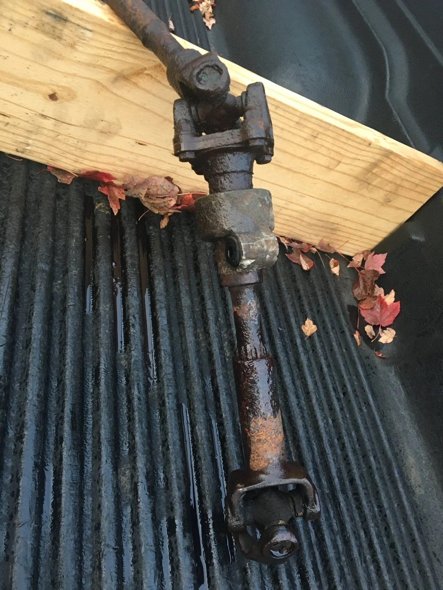

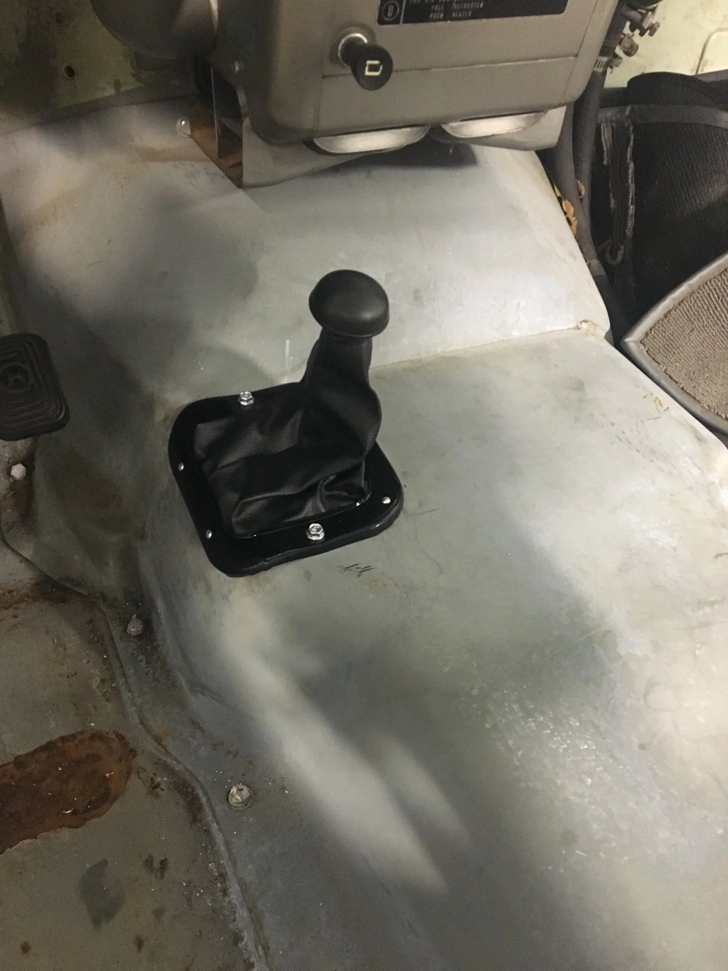

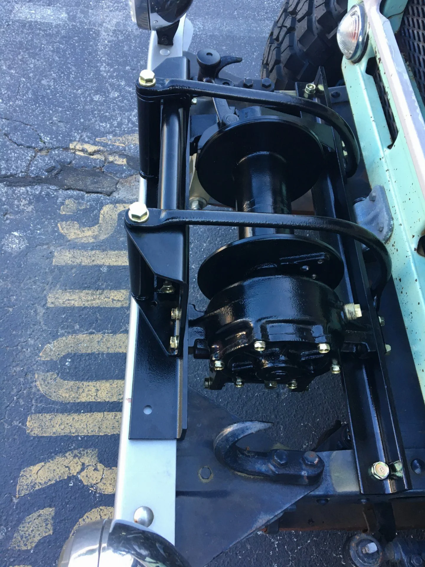

Finaly got my OEM manifolds and down pipe installed to make room for the PTO driveshaft. Shifter installed.

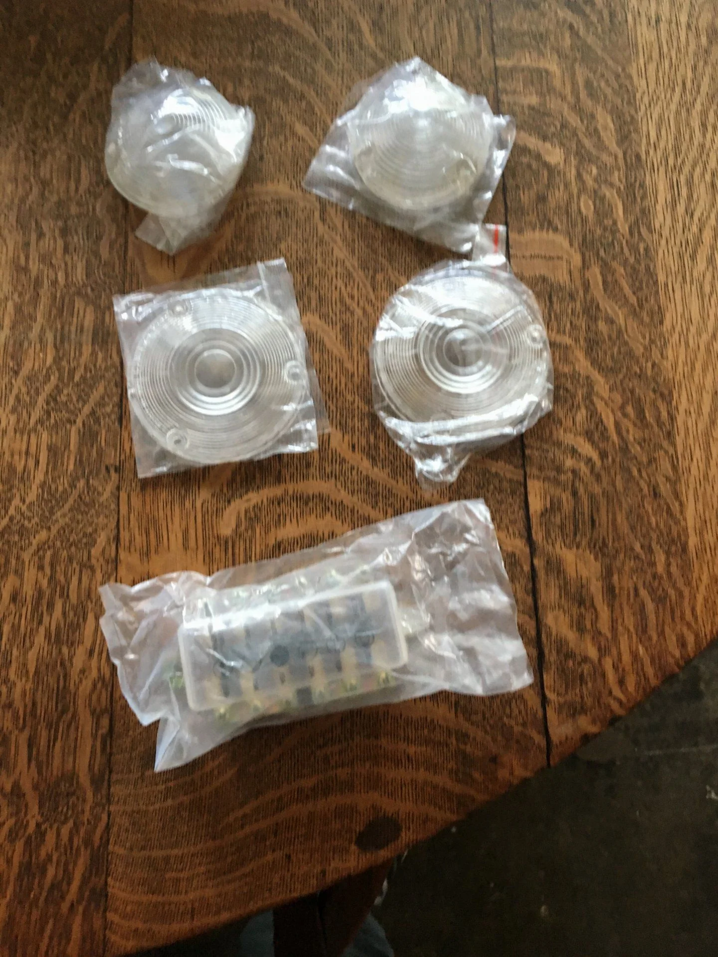

I also got my original housings and new lenses installed.
I bought one fuse box from OZ and one from @Racer65. Despite the price diffference they both look identical to the OEM piece.
The last piece of the puzzle. Now to order ujoints and a bearing.
It is oem but I have only seen a couple and am not sure what years / models they came on. That one came from a 66 fst.
