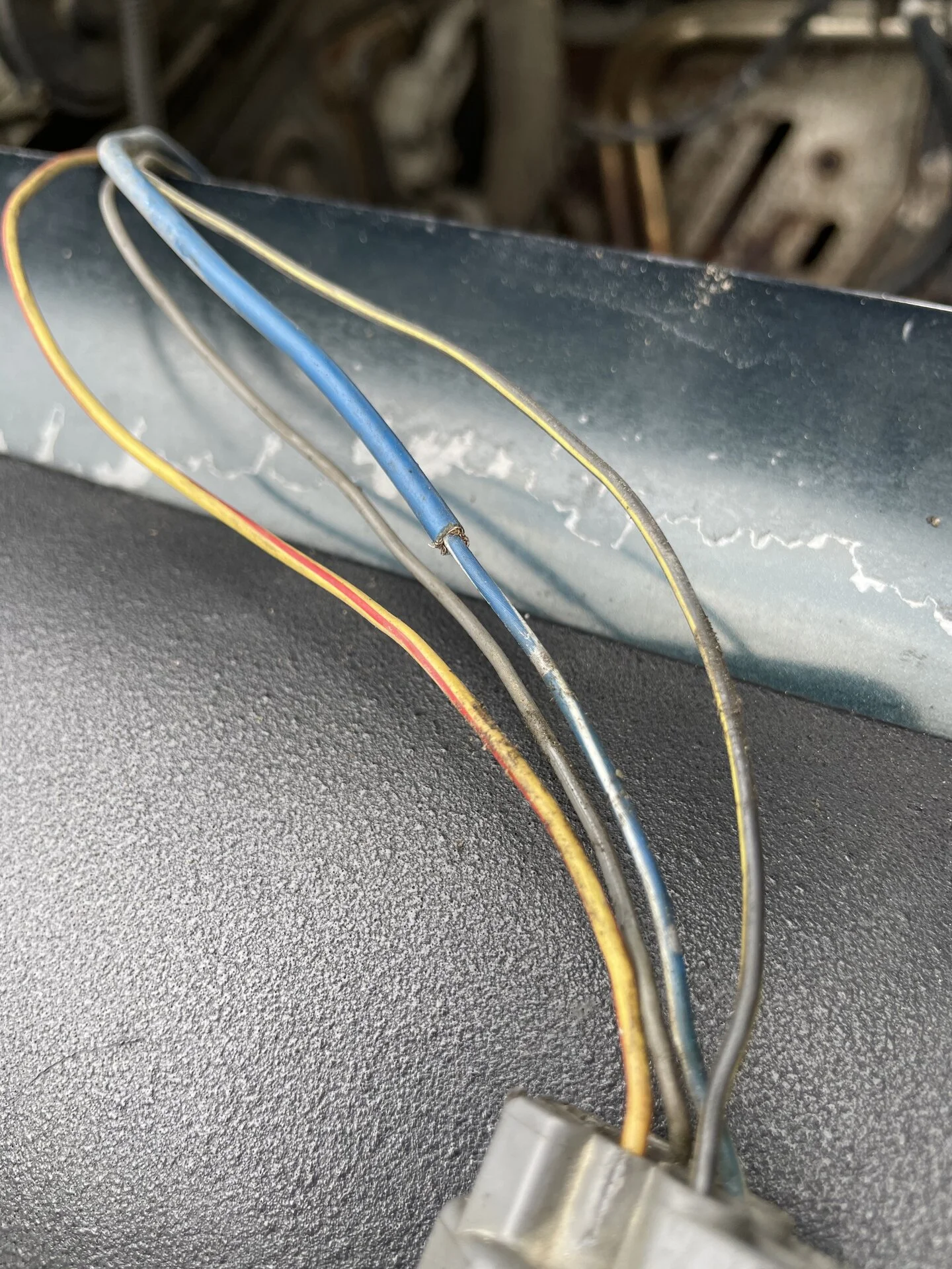

Is there his wire normal? The blue one? O2 sensor #1
Look on the connector housing it should have a 5 digit number, you can try the OEM ones not sure about availability. Ballenger motor sports sells really nice connectors and they will have it.
