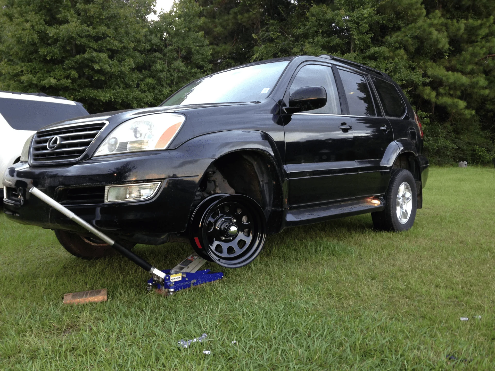

Scratch that. 17" and there isn't enough clearance to wedge my finger in between the caliper and wheel barrel.

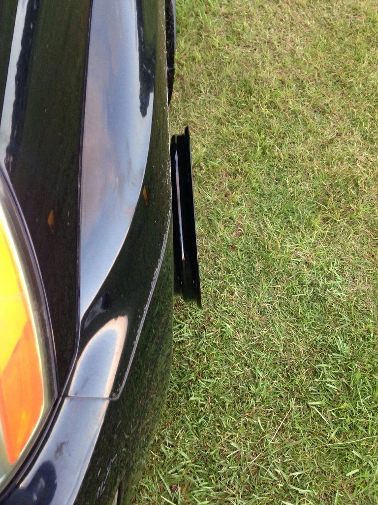

Wheels came today. They do not fit due to the spacing for the front caliper. It took two 1/4" spacers to clear them but left no room for the normal lug nut. I happened to have some of the skirted/extended lug nuts and used it to hold the wheel up to have a look see. It ended up spaced out beyond where I wanted them to be and just aren't going to work. They looked good...to me anyway. Exactly what I was wanting it's just too bad they won't work out.
I believe I'll hold off on the tires and have a look at to how high the OME springs land out at. I may just run the OEM wheels and go with 285/70 tires. There's no FJC steelies anywhere near me ATM either. The center of hub to the front fender was right at 21.25" and the rear was center to hub 22.5". So it's close to what I'm expecting/hoping from what limited information I could find. I also went ahead and ordered a front set of 887s the other day so that I won't have to break down the OEM strut assembly. They'll go into the shed with all the other old parts.

Too much poke
