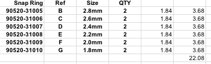

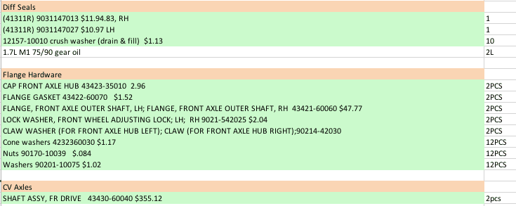

Heres the complete parts list: (Prices may have increased since I did this)

This is EXACTLY what best case scenario looks like. It isn't cheap, but you won't be dealing with the issue again most likely.

Many thanks, @abuck99 .. did the same as Bamabrock and having that list handy saved the day!

Are there any additions or substitutions to @abuck99 ’s great parts list above in post #3 ?

Thanks a ton for putting this list together.
Just want to confirm all 6 snap rings (per side) are recommended? I have an FSM arriving in a couple days.. might be clear once I have that anyway. But looking to order all this asap (since shipping currently is terrible everywhere).
