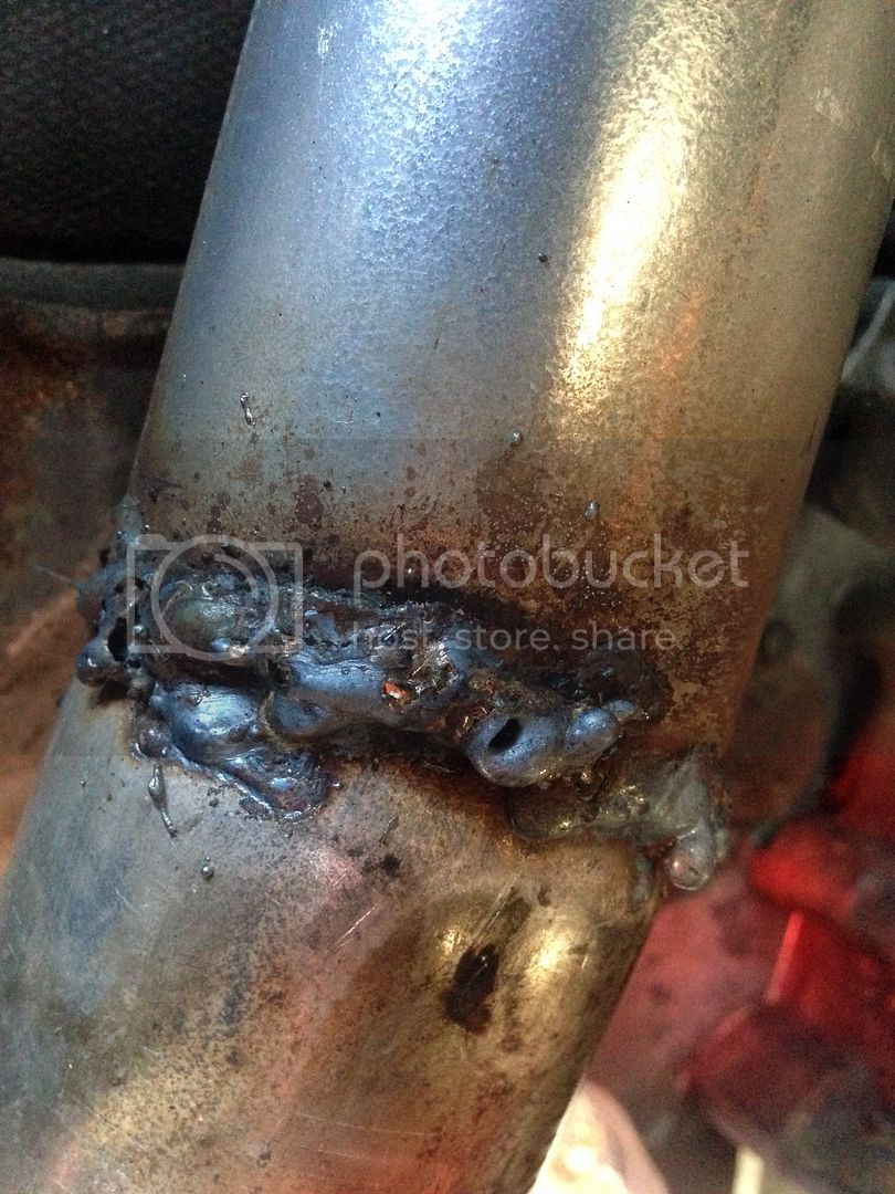

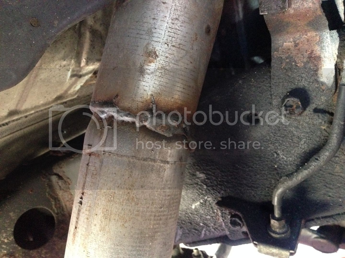

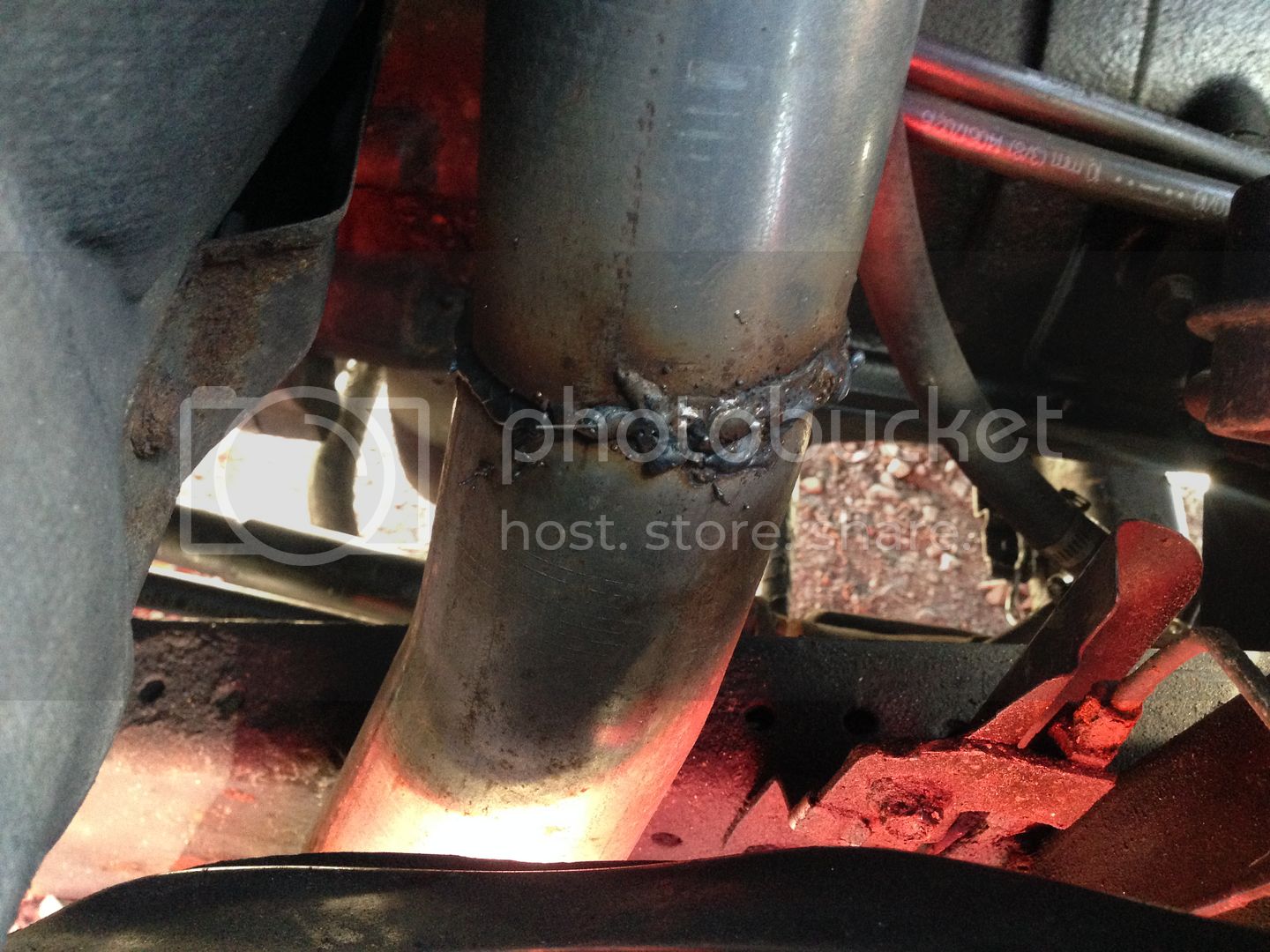

My 11 year old son welds better.. Ghease I wouldn't have left the shop with that!
I honestly think JB weld would have turned out better even if you were blind folded while mixing and applying it!
