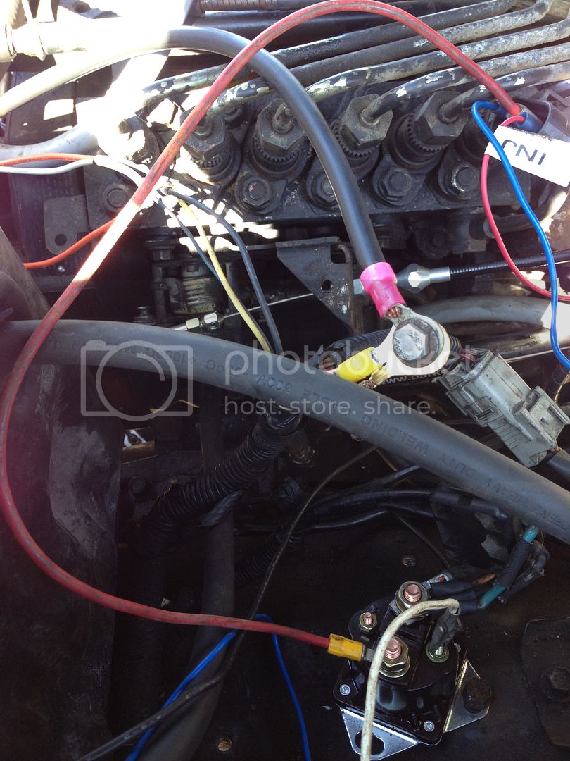

I didnt get the alarm disconnected, I found out that it was the way I wired up the fuel solenoid off the starter, it was drawing too much power and not allowing the starter solenoid to close and it wouldnt pull the fuel solenoid open. So I went from the starter to a solenoid on the wheelwell that Dustin used as a battery post, to the fuel solenoid. Starts everytime!
red wire that's tagged "inj" is a "hold" for the fuel solenoid and is on while the key is in run, it holds the solenoid open.
blue is ground.
red from the solenoid is "pull" it opens the fuel circuit.
white alligator clip comes from the solenoid on the starter and powers the "pull" wire only as the motor cranks.

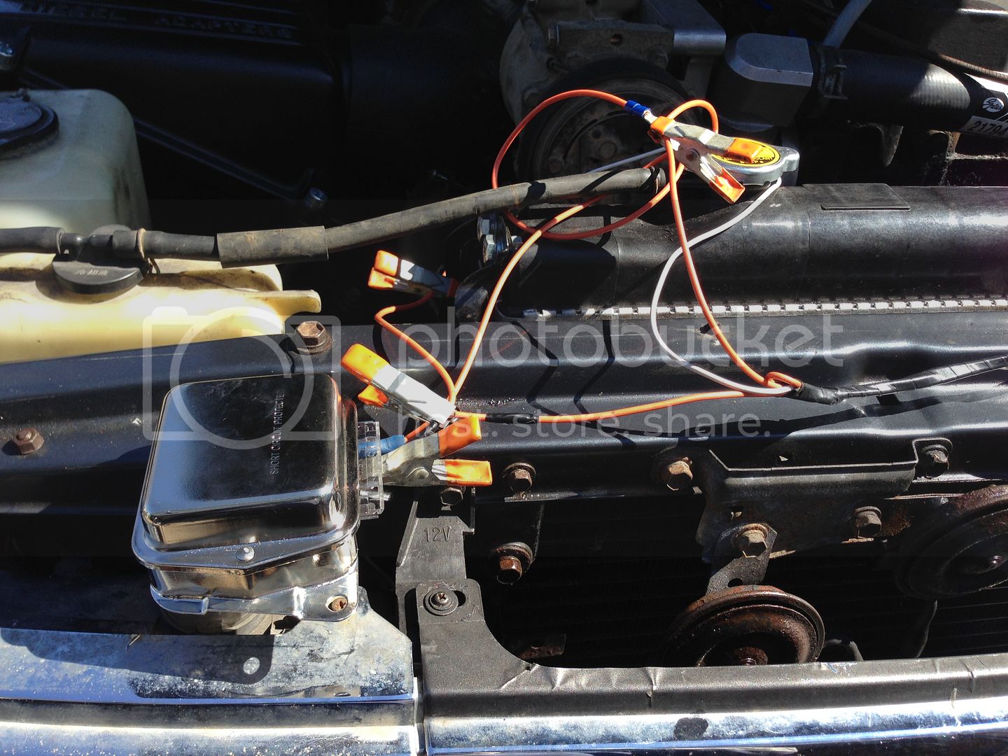

spent a few hours messing with this trying to get a voltage regulator working for my alternator.
gave up put it back the way I had it with the yota guts in it and the damn thing started working properly, charging at 14.4V.
