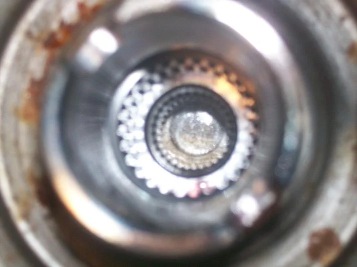

I had to do some shopping with the kids but it is out. I have some pics but you won't be able to tell but the teeth that engage with the convertor are good but there are pieces laying inside, so the pump casing or retaining ring broke. DAMN when I break it I do it right:grinpimp: First pic inside the convertor. It is OK. Second pic if you look close you can see the pieces in the bottom of the pump.
Last ones are how easy it was to drop.
I will get pic's of the failed pump when I get it tore down.
