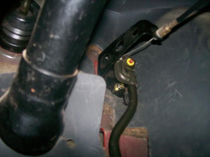

The GAS PEDAL
Here is the modified pedal. Basically a plastic clip for a door/grill screw inserted in the original hole. Also the throttle lock bracket fits over the Lokar cable nut. Also one of the shifter done. It also shows the pedal mod on the left.

Does the pedal still go through the fire wall? Mine as it sits will occupy the same space as the header on that side. From the picks it looks like the cable is routed back up into the dash, or where ever, and the piece of the stock pedal going through the fire wall can be cut off? Am I seeing the right thing?
