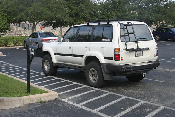

It was great to see such a nice FJ62 in person, I still miss mine!
Thanks - I put a lot of hart and soul into it, but it's gone..:crybaby: I drive a nice FZJ80 now.
That bumper is a JK custom special, Jason does great fab work, I guess we can just ship your truck down to Austin when Randy is done, and Jason can put some bumpers and sliders on it!

mmw: Your '62 is nice. Too bad it ain't your '62 no more. :crybaby: Of course, your '80 is pretty nice, too. :D
