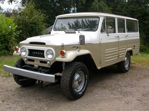

Very Cool Whitey!! That body sure does look nice and clean, I'd be curious to know the vin because as a '63 it would have to be one on the earliest LV's in the US. On the drivers side fender is that a mounting bracket for the early style fender mounted mirrors like on Land Pimps Jimmy wagon?
good eye JP,I have never seen a fender mirror or bracket,and didnt think the lvs got them here in the us,but this looks like a factory piece,it has a support bracket underneath.Now if I could only find a mirror and arms! The vin is 3-fj45-14502,it also has the short rear seat stays which are an early clue.It has what I first thought was a nippondenso heater but it is some other manufacture(need to clean it to identify)

So with yours a 14502 it would likely make it the second oldest LV known, and that is something to be proud of :cheers: Also that heater sure does look just like the denso "clam" shell design, I don't know what else it could be if it isn't.
Here is a photo of Landpimps LV with the factory mirror, from what I have read the fender mirrors were only on the very earliest LV's 63 to early 64. As my late 1964 LV did not come with one. Landpimps is has a sightly different mounting style, but I believe yours has to be factory maybe it is just an earlier version.

That is the one,it does say denso on the doors,probably one of the coolest designs,I will get a better pic of the ducting and there is even a grill on the lower cowl area.I noticed the fender bracket is different from landpimps,but this thing is factory because the fender actually has a brace welded to it underneath.I knew this was an early example,but not that early.i am going to keep digging and see what other clues there might be.I really need a tailgate and hatch to complete this rig!
