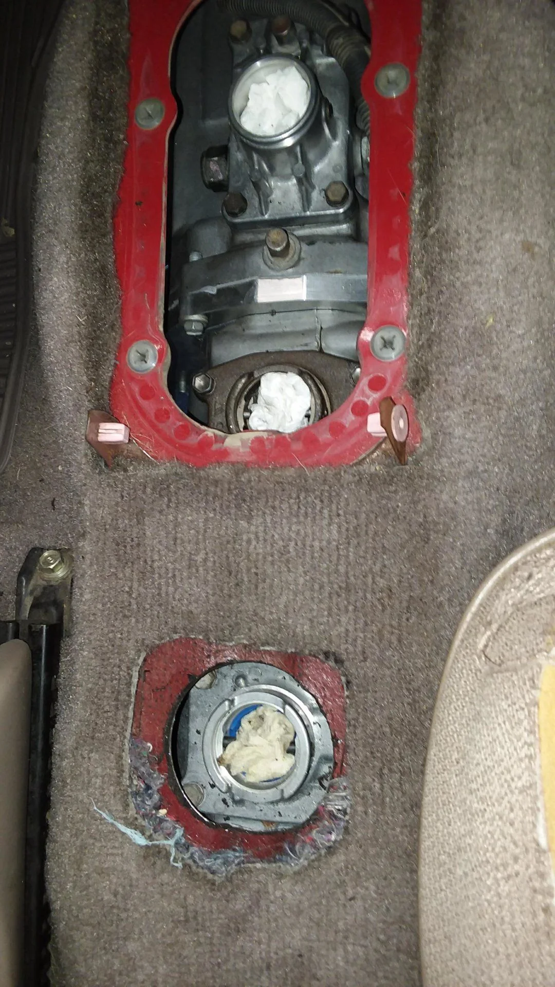

Hole drilled for the extra shifter

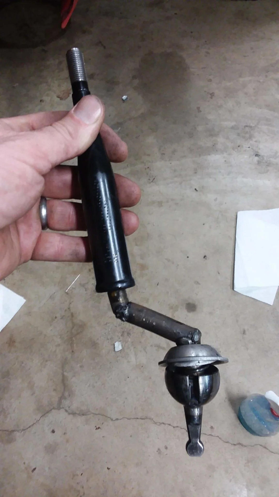

Front shifter modified (with bootyfab welds)

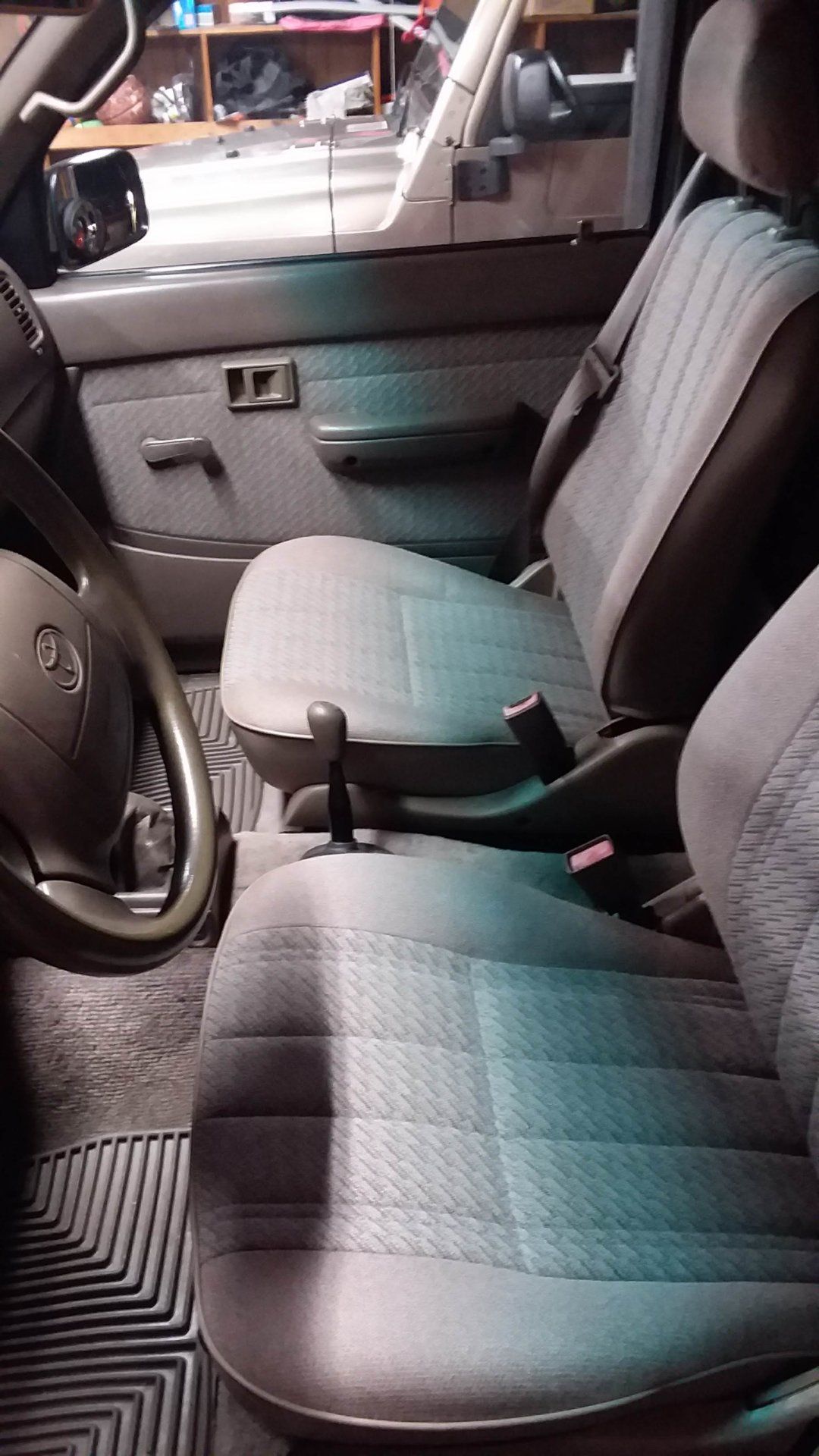

All buttoned up - even installed the new seats I've had sitting around for 8 months or so!
All cleaned up and ready to go!
My oldest son Adam really helped me with wrapping up the details. While I was working on the shifter last night, he cleaned/detailed the interior and removed the old seats. He is really getting into it lately!

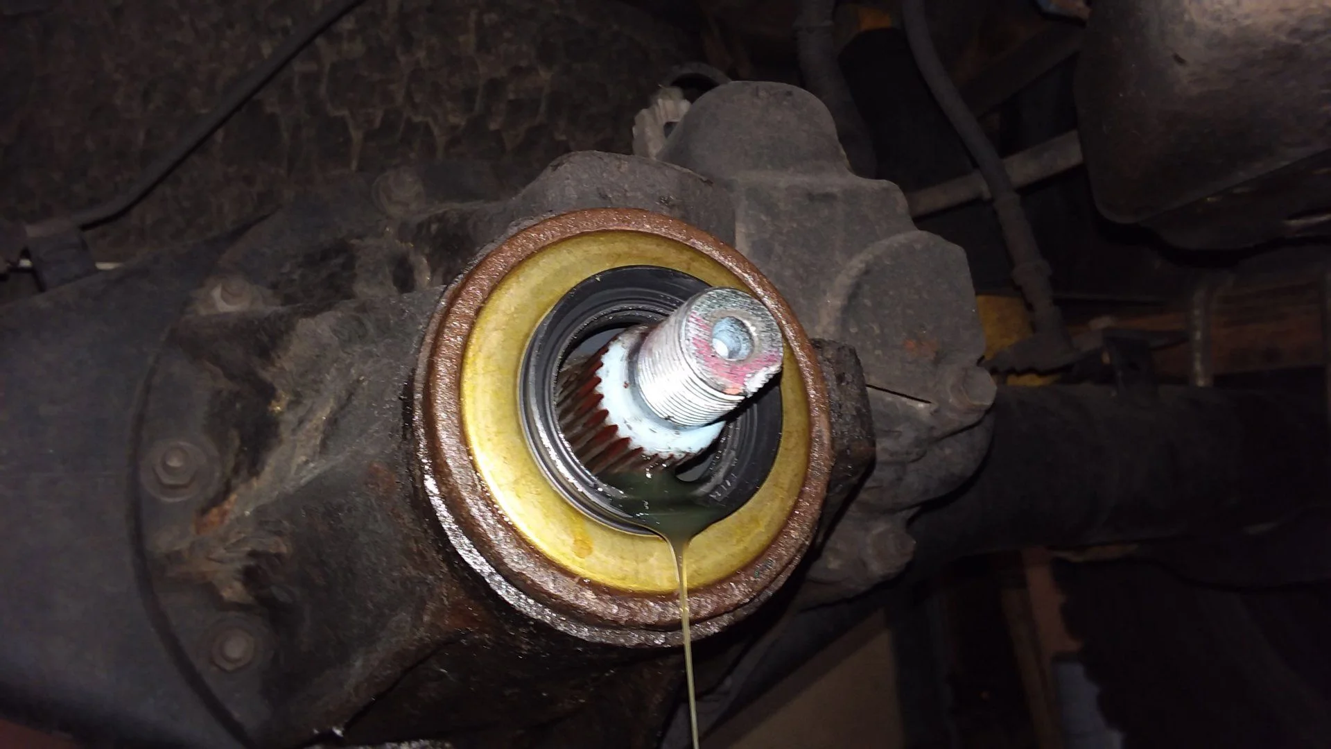

My pinion seal has been weeping, but not too bad. I came out to the garage the other day and found a puddle underneath it!

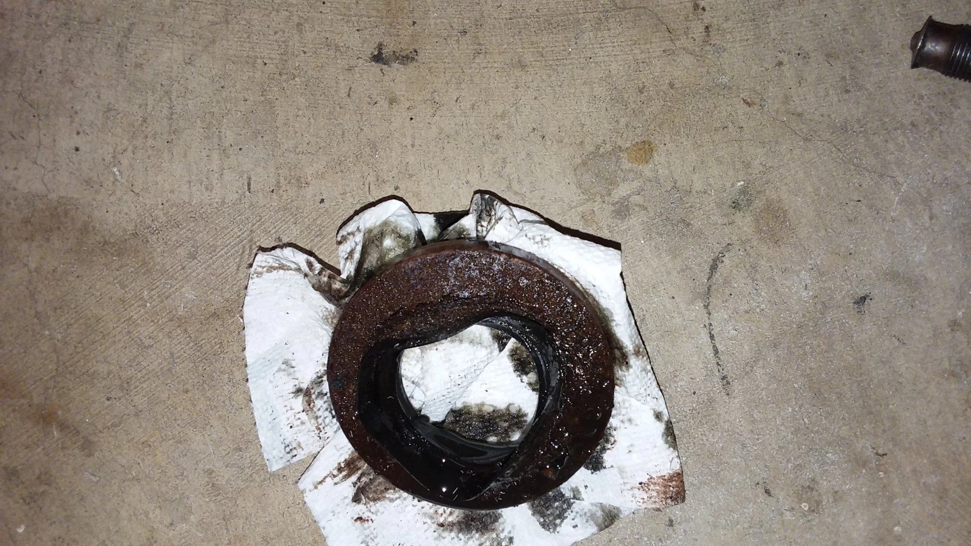

I didn't feel any unusual play in the pinion, so I decided to do a booty-fab repair and just replace the seal.
Turns out that the seal was pretty crusty and looks like it could have rusted through! Hopefully problem solved and lots of happy miles to come.
