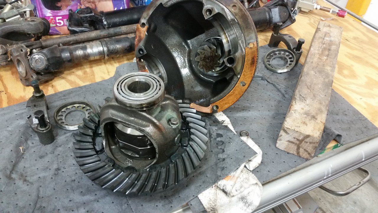

Looks like a Lock Right or a LR clone.

No big deal, I figured your plate was full! As far as the locker, this just adds more work to get mine back on the road! I might just remove it from the great rustbucket from 73 and stick it on a shelf in the garage. Looks like I will need to find all the guts from another diff to replace everything once I remove the locker though.
I ran that same locker for a while until I could afford an ARB. It was referred to as an Aussie Locker and worked great. Only problem was if you lock up one wheel when that idiot in front of you looks up from his iphone and panic brakes for no reason. It made a terrible banging when one tire stops and the other keeps rolling. Basically it tries to lock but the shock of different rotational speed caused it to complain. Pretty minor but a little shocking the first time. I thought someone had hit me from behind!

Pulled the locker from the rear diff this evening and cleaned it up. No real identification anywhere on it. Meh, the price is right. The humidity set back in mid 90s in the garage with humidity numbers around 70%. I hate it.
