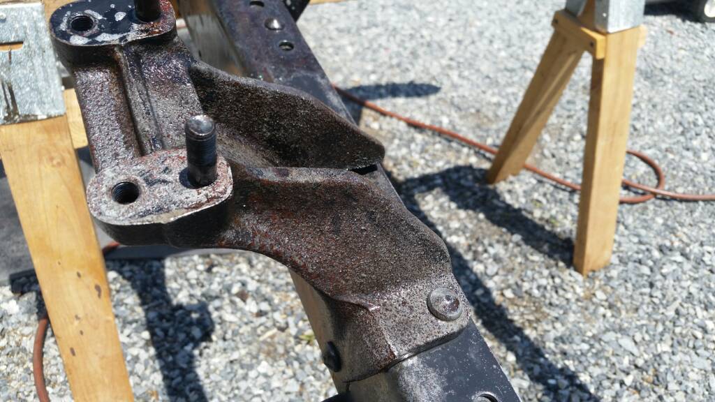

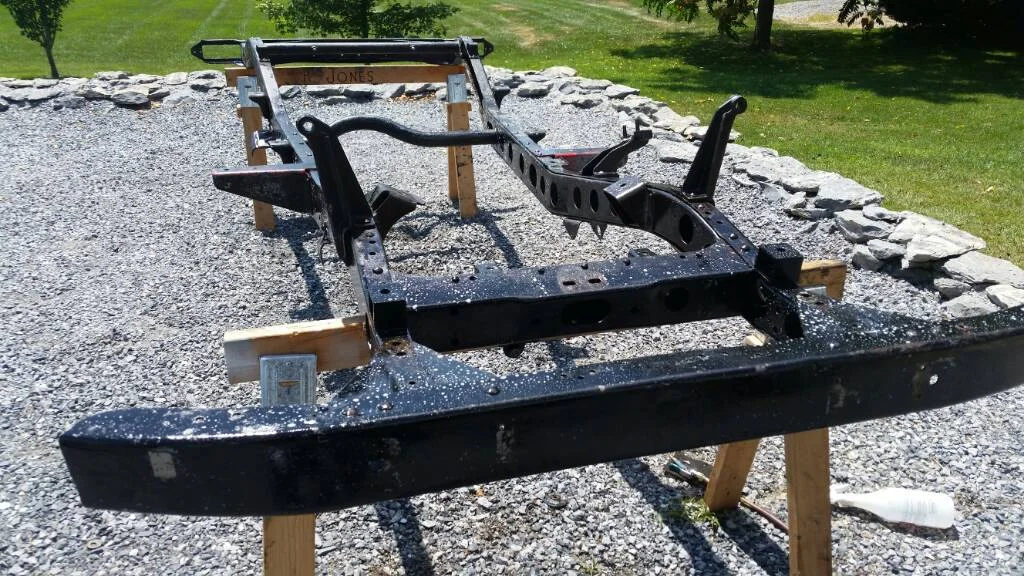

Sprayed the frame down with the Metal Blast from Rust Bullet this morning, paint coming soon.
What did you use to clean all the crap out the box frame. I bought a 4” stainless chimney brush. I have not tried it yet though. Want clean out spray it with rust blaster and coat the inside with master coat AG111. Any thoughts.
I'm thinking I probably used my pressure washer and some elbow grease here and there to clean my frame, it was easy with it being stripped down.
@wngrog I believe uses compressed air to blow everything out of frames, that and some wire brushing. Less messy apparently. Hopefully he'll chime in with his tactics.

Thanks. Please elaborate on lessons learned. I value the experienced pro opinions. Experience beats any book knowledge.
I already have rear 3/4 of the tub off, I degreased and power washed that section. The apron, bib, and firewall are next to be removed. I am systematically videoing, tagging and bagging all parts. I guess what has happened to me is the same as you … “an accidental frame off” restoration.
I think what I will do is use the pressure washer sand blasting technique for the frame, then use the rust blaster then the AG111 product. I did use the Rust Bullet on my 77 40 and it has worked phenomenally, still going strong since 2006. My new project is a 81 42. I will try something new this time.

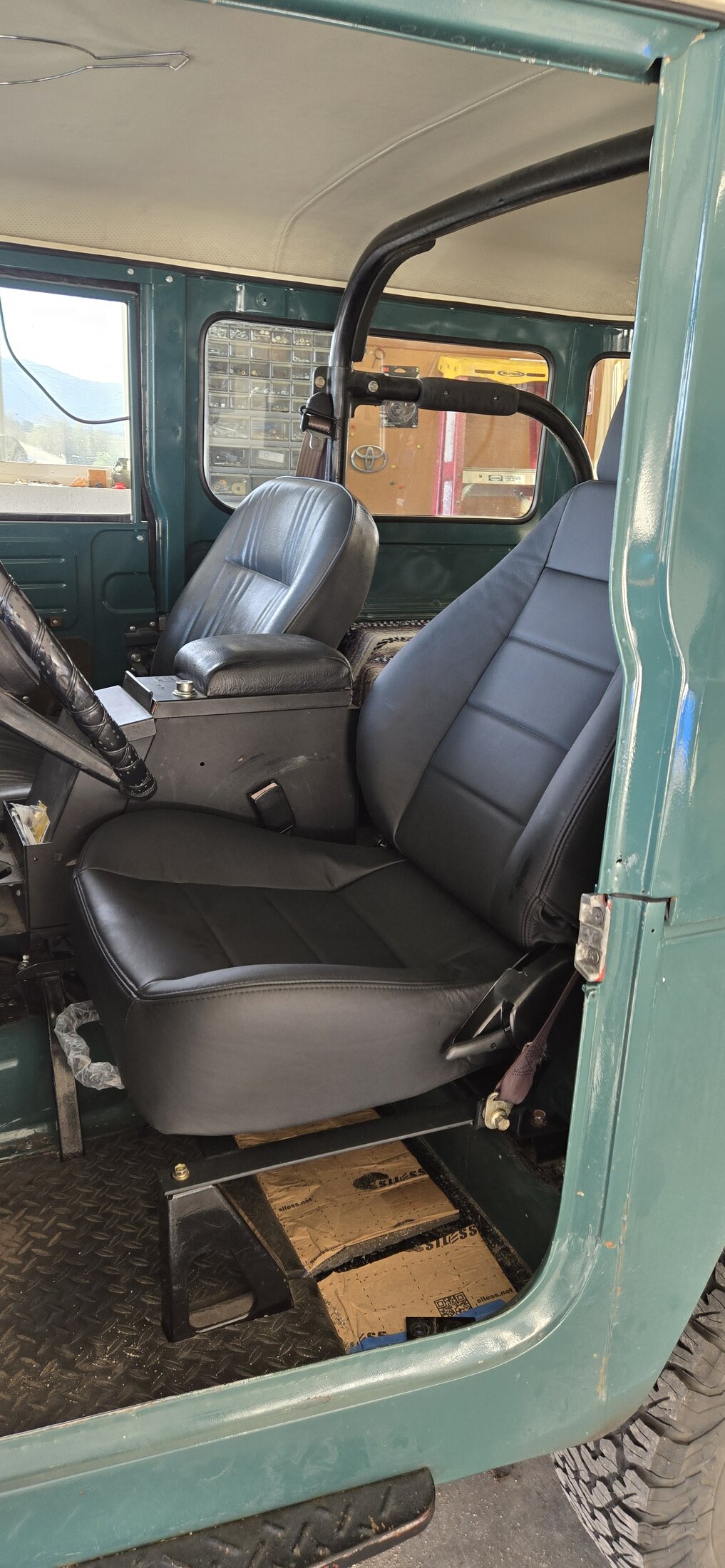

Those look comfy.
I'm going to have to relocate my speaker box to allow the seats to recline further, aside from that all the clearances look good. The passenger seat will be an experiment, my plan is to bolt it up with the Corbeau mounting bracket and check the height/comfort/feel, then decide whether or not to fab up a bracket that is a bit lower. We'll see.
In the meantime I'm going fishing, I hear there are salmonflies hatching on a nearby creek.
Nice. Are you selling the old seats? Are the old seats OEM?
I will eventually sell the seats, once I am fully sold on the Corbeau seats.
Yes, they are OEM seats.
