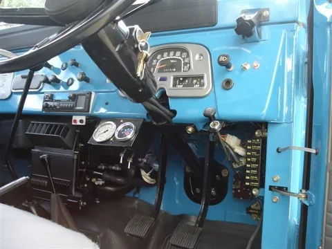

I was very tempted to follow Dkroth's lead and convert my useless ammeter to a voltmeter. (That's such a nice job!)

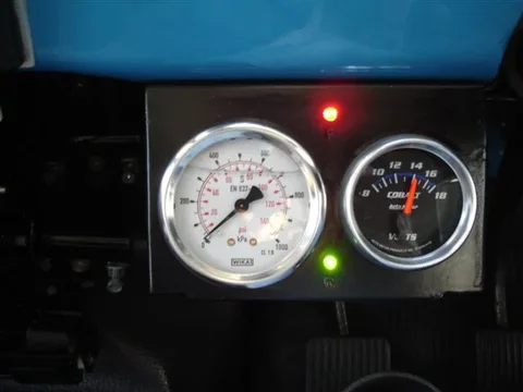

However I need to have an air pressure gauge with my future ARB diff locks. So I've decided to combine the two.
This is the result:
Ignore the 3 coils of wire tucked under the dash. ... They will eventually go to 2 diff lock solenoids and an aircompressor solenoid/relay.
(And the little red and green LED lights and chrome switches are for the diff lock stuff too.)
So I'll now be able to rest easy on all my long-distance night-time driving (provided the voltmeter shows good charging voltage all the time - which I'm sure it will).

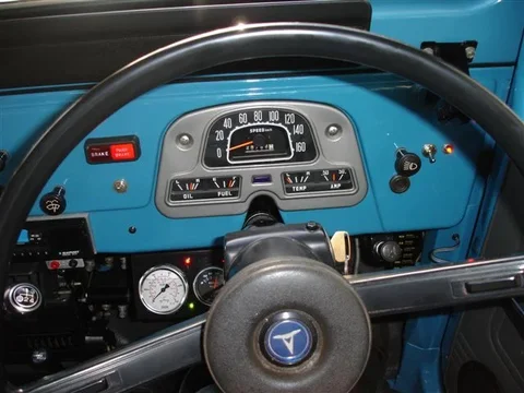

In the past I've often worried that perhaps my alternator may have secretly "shat itself" while I'm driving ... and that therefore I won't be able to restart next morning.

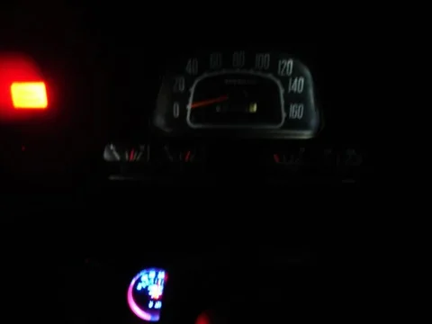

Only one problem - The backlighting in the voltmeter is way too bright for my liking!
It makes the combination meter lights look so dim. But in fact they're NOT! They're now the ideal brightness (after I swapped in LED bulbs).
Dash lights should not be "distractingly bright" in my opinion.
I guess I'll live with it though (rather than try and dim it) because at least the voltmeter is obscured from my view by the steering wheel unless I either:
  • lean forward slightly, or
  • turn the wheel for a corner.
Very convenient.... I think I'll pretend I designed it to be like that! ;)
